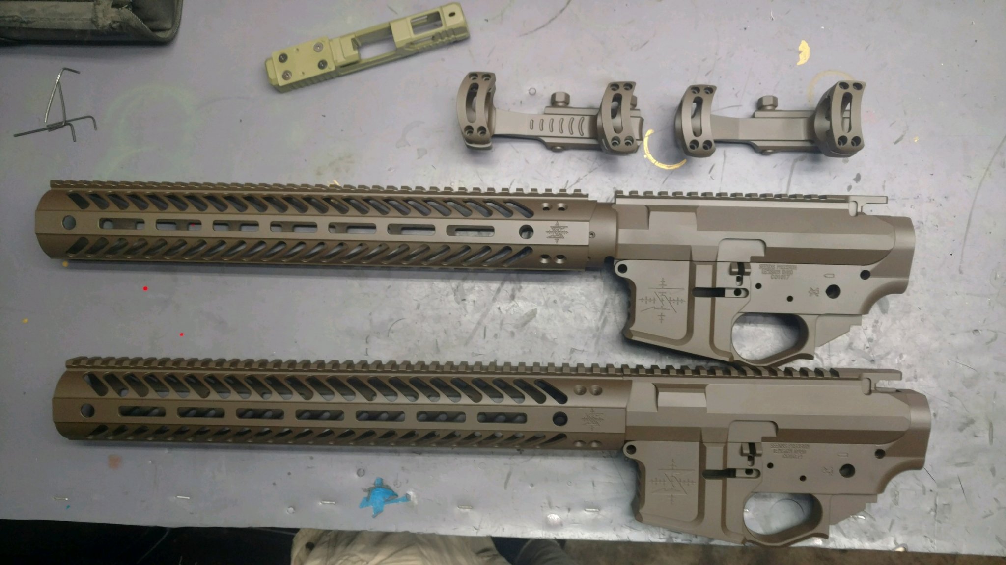

I’m doing a 20” Grendel hunting rig and was going to do a 18” ARC hunting rig - Grendel 120’ish gr for deer and ARC in the 80’ish-90’ish gr. range for varmint, but I’m going to hold off and do an 18” .223 Wylde instead of ARC. Think I’ll let ARC teeth for a bit and if it turns out to be the second coming, I’ll rebarrel then. I don’t roll my own at this point, either.
I’m still interested for sure, but I’m a gas block and suppressor cover away from my Grendel being ready to sight-in. I’m also heavily invested in 5.56, so with the vast similarity between 6.5G and 6ARC, I’m sitting back and seeing how this plays out now.
