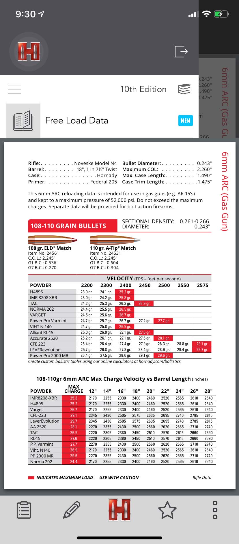

I am very curious about load data that will eventually come out. I'm eager to find out what the velocity would be out of an 18" and 20" using the 110 grain SMK bullet.
Hornady is giving away FREE 6mmARC data for their 108 and 110s, so I am taking the liberty of posting here. (Posted originally on the 6mmARC.com forum.)
I know hornadys big selling point is the super high bc bullets for this cartrige but I really hope to see some loads and data on 95gr to 100gr bullets. I think getting some of the velocity back would help this round at intermediate ranges.
Thank you for posting the load data. That's absolute gold. I've been digging for this kind of data since the launch of the ARC.
As far as heavy bullets go if those velocities are doable in real life that will open up a ton of options.
On another note Hornady said several times in the launch that light bullets are definitely an option. I think the data is slower to come out for those light bullets because most of the people seriously looking at the ARC are focused on long range applications.
FWIW, it's available in the Hornady Reloading application on your phone, you just select the free load data. It may not be there forever, though, so good to take a screenshot if you need to save it locally.
