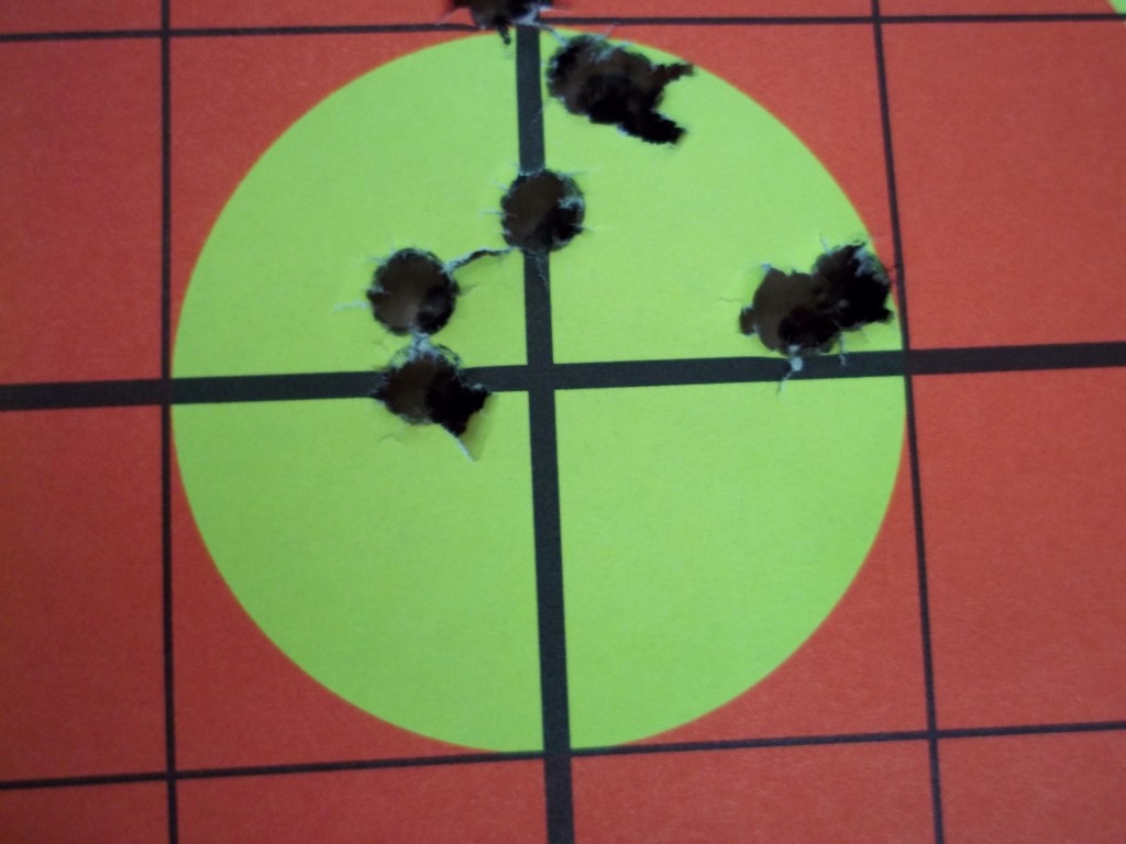

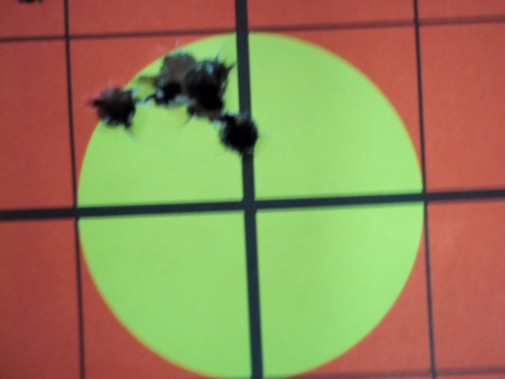

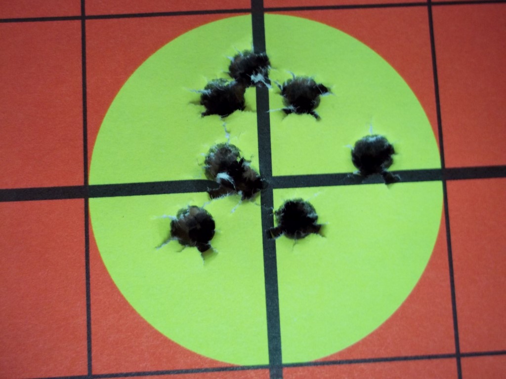

Nice, the 6ARC showing its 6PPC lineage. This is what I expect out of this cartridge! Nice shooting @Dino11 and great work on that barrel Odin.
You’re expecting 1/3 moa from a gas gun with factory ammo? If that’s a legit result, Hornady and Odin have a good thing going. Most ppl have trouble getting half moa groups with a gas gun and handloads, so forgive my skepticism.
I read it as he expects good accuracy out of a cartridge based on the PPC, not that he expects 1/3 MOA or better all the time from every rifle and ammunition combination, which is obviously unlikely.
I just got an invoice/shipping notice from Brownells that the Faxon 20" barrel I ordered right out the gate (June 2) is supposed to ship tomorrow. It will probably take me some time to get my 6mm ARC upper built, but its good to see at least one necessary part is rolling in.
No doubt that a 6PPC lineage cartridge should be able to offer precision of that level, although precision will be driven by the 'weakest link' in the system: shooter, rifle, cartridge, with shooter being the biggest variable. This is especially true at a distance like 300yds, where MV variation isn't going to be a major factor in the vertical dispersion. Also the 300yd difference between 1/3 moa and 1/2 moa is only about 0.5" and I would say we don't have enough info to say if this is a 1/3 moa or 1/2 moa 'system'. I would say we do have enough to say its 'nicely under 1 moa', which is what I would want.
My 6.5 Grendel, another 6PPC lineage cartridge, with handloads and a barrel from Satern, could print these types of groups at 300, when the nut behind the gun was up to it (which wasn't often).
If it was fired at 300yds and not 100yds, I would agree.
Something just seems off for this to be 300yds with the factory 105’s. Maybe jamming them into the lands several thou lead to better than anticipated precision, but to have so many rds (6 based on the other targets) go into the same hole at 300yds, with an AR, with factory ammo and a Viper HST scope just seems a bit hard to believe.
Those 6 shots are what, <.1moa? Just doesn’t pass the smell test.

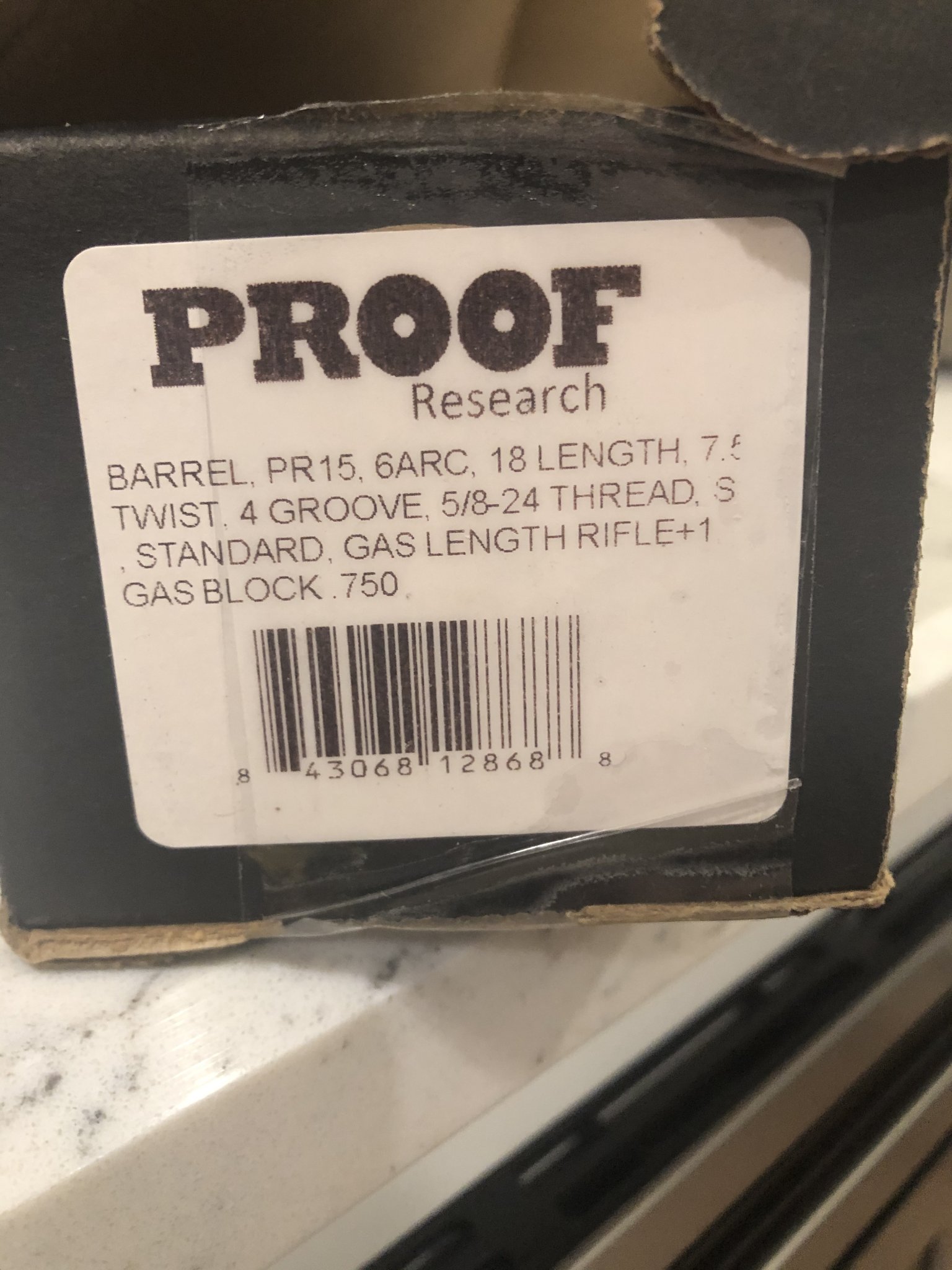

Proof 18” SS just shipped! Now I just need some ammo... and maybe a rifle +1 gas tube. Both of which are like hens teeth it seems.

My 18" Proof AR barrel is doing 2596fps Avg with 108's. Averaging 23fps per inch difference between that and my 28" Mausingfield barrel, so I'd expect 16 inchers to be in the 2525-2550fps ballpark.
