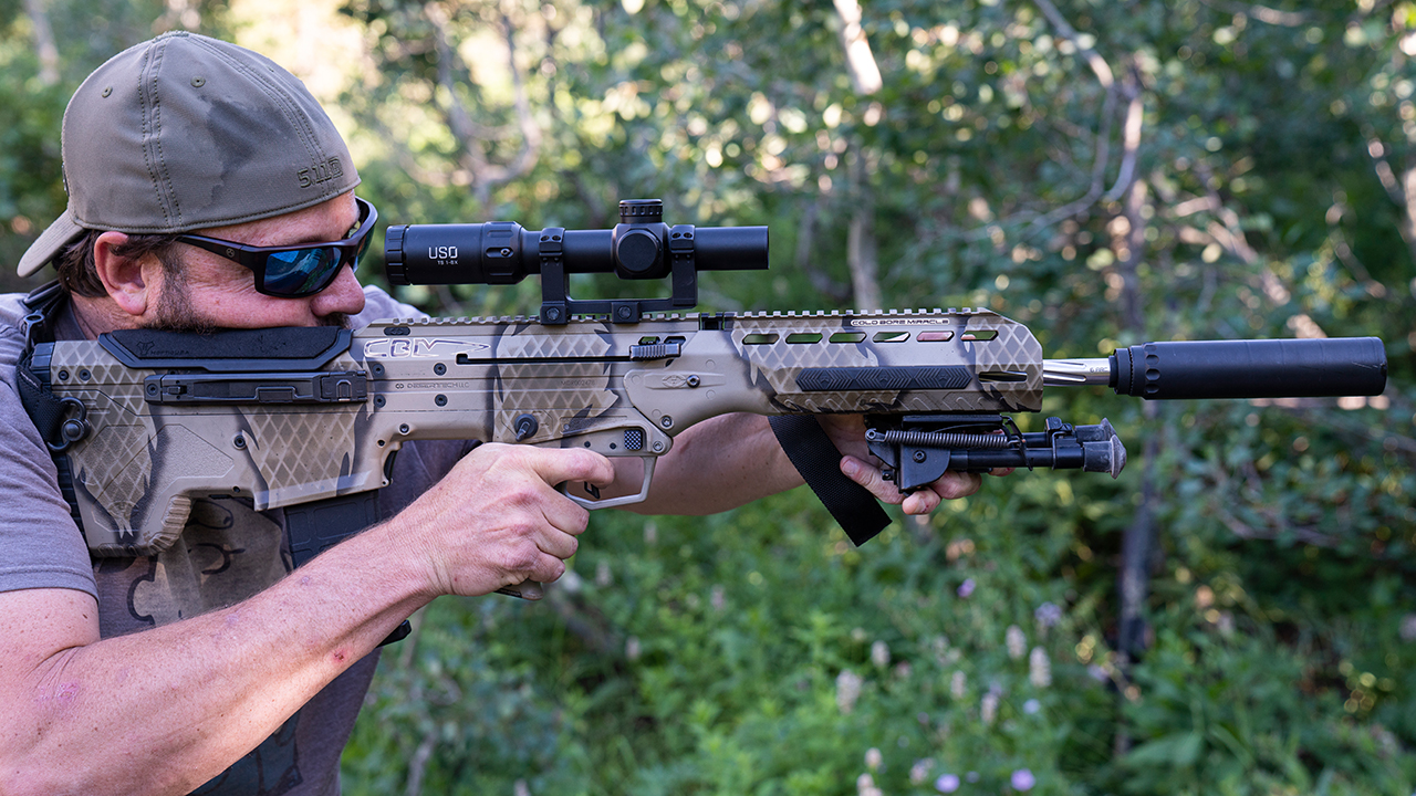

I just finished a 6 Arc barrel for my Desert Tech MDRX, absolutely my favorite by far.

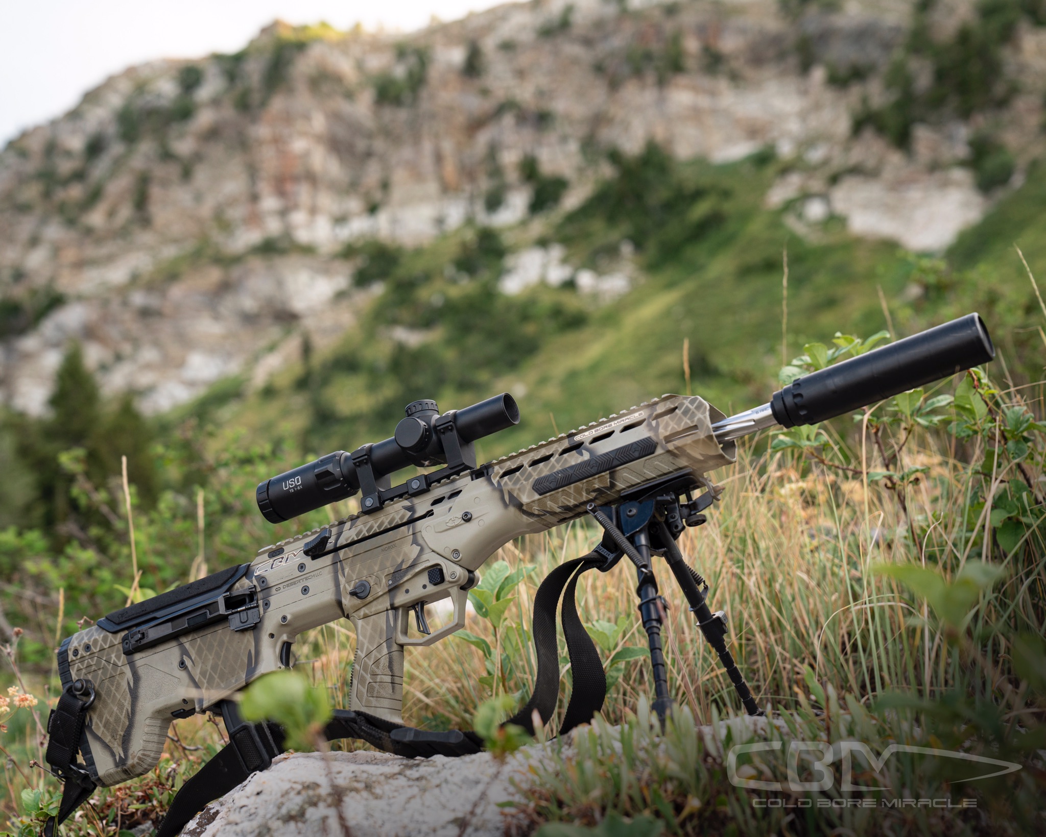

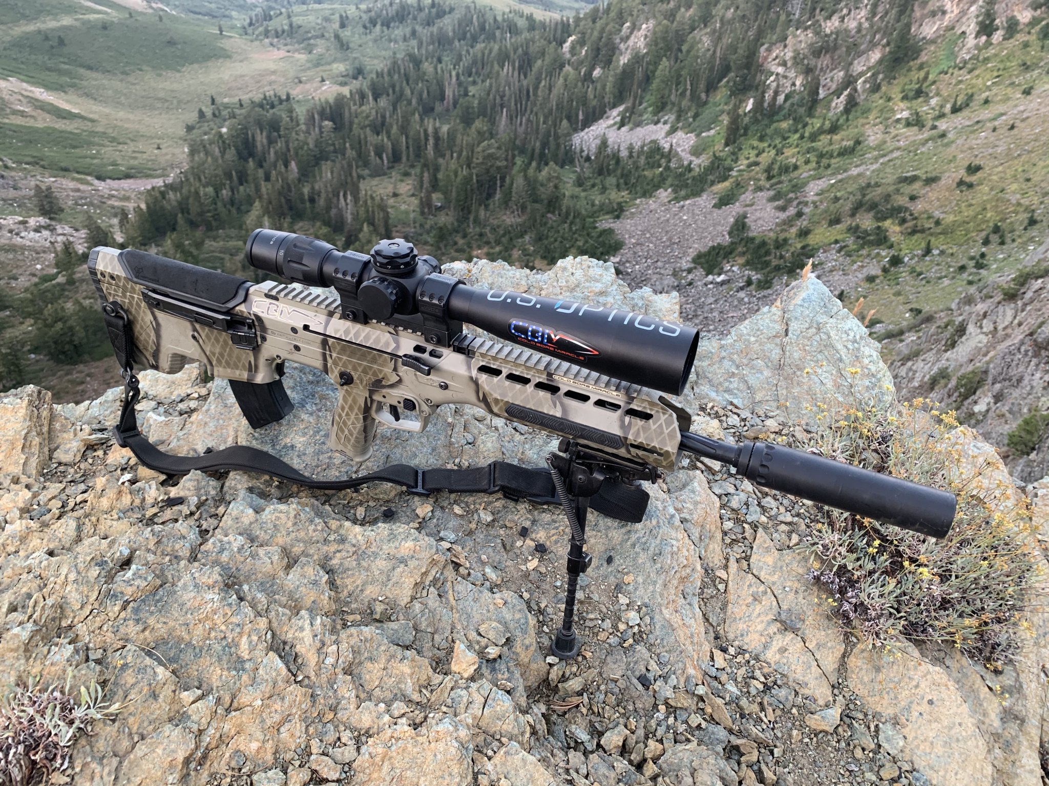

coldboremiracle:
That is a great looking build. I have to know more about the barrel like manufacturer, twist and length. Also very interested in the details of the ammo you are using. And, GREAT SHOOTING!!!
Henryrifle
coldboremiracle:
Henryrifle
Thats a 20" K&P 7.5 twist, it LOVES Hornady 105 BTHP's over 28 gr of BLC 2. I need to chrono it still, but Im guessing its right around 2700. Ive taken it out to 1200 so far with pretty good results.

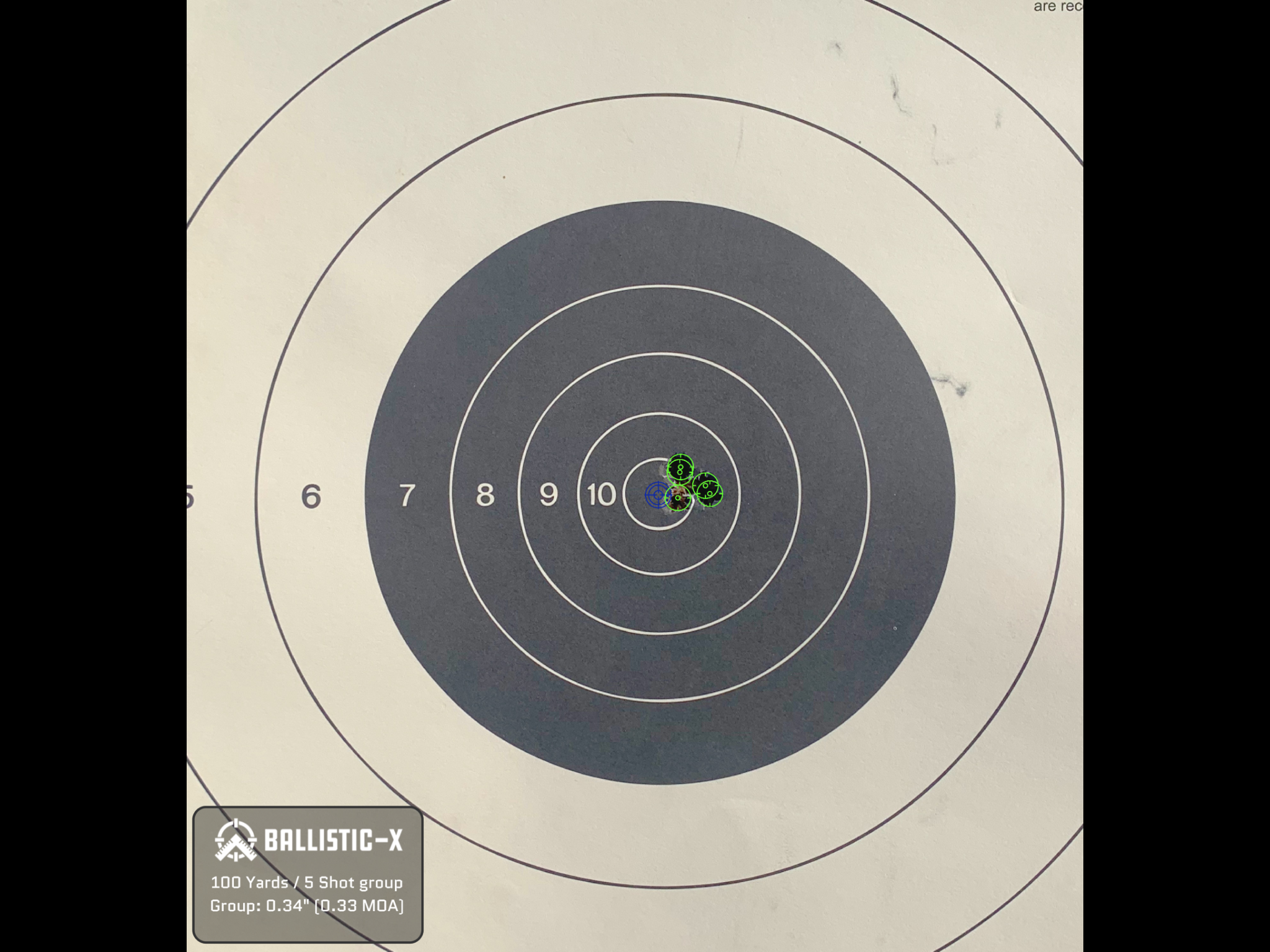

Inspired by @coldboremiracle, I loaded up 50 of my most consistent load, 28.3 grains of CFE223 under the 108 ELD-M and headed to the 1000 yard range. At 100 yards this consistently groups in the .7 to .8 MOA range at 2590 FPS. I am not at all happy with this group size but I know it is consistent and that is what I needed for today. I also decided to get back to the basics using only a Harris bipod, rear squeeze bag and prone shooting mat. Starting at 200 yards and putting two shots on each target, the hits looked to be about an inch apart at 200.
Using the Applied Ballistics app, I moved out cleanly to 300, 400 and 600 yards without any misses. the rounds were hitting a little high by 600 yards so, at 700, I stopped and ran the ballistic calibration within the app. There was also a 5" gong at 700 that was fun to put successive hits on in almost "rapid fire" succession.
The 800, 900 and 1000 yard gongs are all 20" and provided little challenge for the rifle/load combo. There was a 1/2 MOA or 5" square at 1000 yards. That did prove to be very challenging. I was running low an ammo and didn't want to end such a fun day on a miss so I loaded a 10-round mag for the 5" gong. Only 3 out of 10 for hits but, you could easily see the splashes around the target and make a good correction for a reasonably fast follow up shot.
The remaining rounds I shot at 700 to 1000 yards without any misses.
Takeaways from today are that this is easily a 1000+ yard capable cartridge. There were no failures of any kind with the rifle today; it is relatively light weight, very manageable on a bipod and produces very little recoil allowing the shooter to spot hits and misses.
Will continue with more disciplined load development but happy with the knowledge that I can have fun on the long range while engaged in the minutia of load development.
