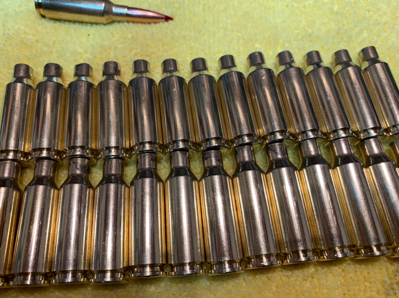

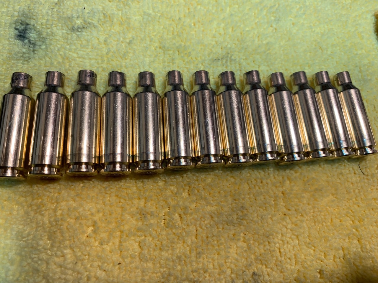

Well I think I know whats causing the ring in my gun. I just put a faxon match barrel with a JP enterprises grendel bolt on my gun and when I measured the headspace, it came out to .006-7" Which is equivalent to a field guage headspace. The case is stretching too much and I suspect pushing the bolt slightly to the rear starting to unlock causes the case to bulge at the back of the chamber. I will have to have a bolt custom made if If I want to tighten up the headspace.
No, that’s not enough headspace to cause a ring. A case head separation ring (which is what headspace causes) is a different thing than the belt being discussed here anyway; two completely unrelated things.
Also, “pushing the bolt to the rear” does not start the unlocking process; that’s not how an AR works. The carrier has to be pushed rearward by gas pressure inside it, and that unlocks the bolt by causing it to rotate. None of that has anything to do with headspace.
That amount of headspace might pose a problem eventually after 4-6 firings of the same piece of brass, but not with one firing of factory ammo. If you measured a bunch of factory ammo for various rounds you’d find the base to datum length often leaves a lot more headspace than that anyway.

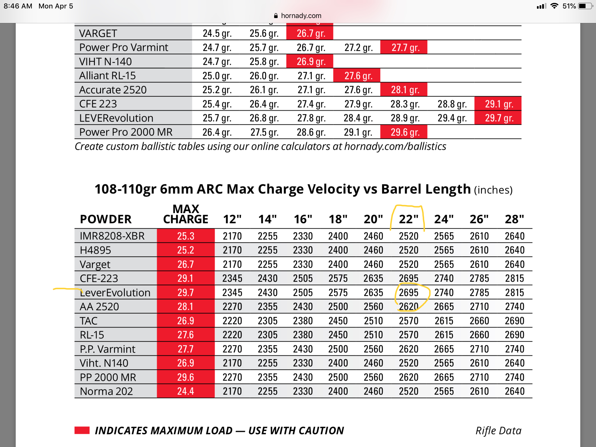

I am confused. I am still pretty new at reloading and the data from Hornady and Hodgdon that I am looking at is quite different for the heavier bullets (107-110grains)
Hornady (for gas guns) = max varget charge of 26.7grains
Hodgdon = max varget charge of 25.8C
For Leverevolution it is:
Hornady = max is 29.7
Hodgdon = max 28.2

Velocity with my load is a bit faster that what Hornady says is the velocity for their max charge.
My load =29.6 of Lever producing avg 2740 (aprox 65 deg temp)
Hornady max data = 29.7 of Lever producing 2695. (For a 22” barrel)
Should I back off some or do you think I am ok here? Even with the warmer temps of spring/summer?
No pressure signs. Not quite a compressed load but close. I thought I detected a little crunch once when I seated the bullets a little deeper than I am now with a COAL of 2.260, which gets them about .063 off the lands.
I think @Henryrifle and some others have mentioned some primer tests, but I just started playing with Lever, and groups and ES with CCI 450 primers were so-so compared to my standard H4895 load.
Then I switched to CCI 400s, and holy crap! Both groups and ES shrunk significantly, and MV increased 10-20 FPS per charge. YMMV...
Thank you Yondering!
Hornady's data is based off an 18" barrel, which will give your barrel the advantage over theirs if your barrel is longer.
Do you have a 22" Odin barrel? I have one of their 18" barrels and it gives me more velocity over another 18" barrel I have with the same ammo. I also have a 20" barrel and the velocity of the Odin 18" pretty much matches the 20". I think that the tight chamber and the +2 gas length attribute to it being a little faster
Reactions: Yondering
As Dino said, gotta keep in mind barrel length when you're comparing load data velocity numbers. Hornady pulled a switcheroo with their 6 ARC data, using an 18" barrel for their AR data (when most other data is for 24" barrels) and then used a 24" for their bolt gun data.
In theory Hornady's 18" AR data should run about 100 fps faster for max loads with a 22" barrel, although that can vary quite a bit depending on the barrel and components.
I have a 22” Rock Creek from Craddock Precision. What you and Yondering have said makes sense.
The velocity I posted (2695) for 29.7 grains of Lever was from Hornady’s max charge listing for a 22” barrel.
I was able to get in a day of shooting yesterday and this load (29.6g Lever over the 109 Berger’s) was terrific. It was cold (high about 37) and very windy on top of the a ridge in SW Va. Gusty 10-20mph. Shooting steel, after 1 ranging shot, hit the 1200 plate 6x in a row. This bullet was (I thought) very consistent in the wind, and I had repeated follow up hits at 1200 holding 6 MOA for wind. Very consistent at other ranges inside 1200 too. This was my goal (accurate to 1200) in putting this AR together.
I had the magneto on for the first 5 shots and found the speed of 29.6 of Lever had dropped down to an avg of 2690 when it was still about 29 or 30 degrees out. For my rifle, so far I have been avg about 2740 in the 60’s and a bit more in the low 70’s. So it was also a great day to start building a data set for the velocity of Lever with this load due to temperature changes.

No, that Hornady data is for an 18” barrel, not 22”.
That’s what I was trying to point out to you earlier.
I see that. I was not writing clearly. I do see the Hornady test barrel was listed as 18” Noveske model M4.
The velocity I referred to (2695) was the velocity Hornady listed for 29.7 g of Lever in the 22” barrel on that same page. I assumed they tested at that length, but maybe not?
Anyway, very pleased with it so far and I very much appreciate all the information and help I get from the posts on this thread. This cartridge is my first foray into reloading and while it has certainly been frustrating at moments, I would probably still be cussin’ and breaking things if I didn’t have this as resource.

Ok guys, I have a question for the experts, why the hell am I getting ejector marks on brand new FACTORY loads!!!! Not only that the brass is now JUNK!! I can damn near push the primer in with my thumb!! I am using a can but that should not make a difference and I have not had this issue before shooting the factory loads!!! I am really getting frustrated with this damn caliber. I love it but brass just sucks!! I am now using LVR and am at least a grain to grain and a half below max load. I am still having issues when sizing my brass. Even though I don't get the "Belt" but when the brass is resized it will chamber but I can NOT eject it. I have to use a hammer handle and bang the stock on the floor to eject the brass.. The base of the case is .440 to .441 after sizing. I ordered a small base die but it has not even shipped yet. I am at my wits end trying to figure this damn thing out!!
Ejector swipe and loose primer pocket sounds like excessive pressure. Often times the ejector swipe can be fixed with an adjustable gas block. I don't know if it will solve the loose primer pockets. I've been running 60-65ksi loads in my bolt gun for 8-10+ loadings and they're holding up great so I don't think it's the brass (Hornady 6mm ARC brass-- if you're using something else I can't speak for that).
Sticking resized cases is a head space thing most of the time. Get a comparator gauge and measure the shoulder before and after sizing. I like to decap the case before measuring the "as fired" cases, and file off any burrs from ejector swipe, extractors, etc... so you get a legit reading. With AR's I usually do a .002" bump then check a batch of 10 to make sure they all eject easily, if not I run the die down until they do.
Reactions: RMB and raptor99
I could understand if it was my reloads since I did have issues with my Varget loads and finally just gave up on Varget. But this is FACTORY Hornady ammo!!! Junk after one firing!!!
Right. What I'm getting at is unless QC slipped and they loaded hot ammo (not impossible, but fairly rare), something in your rifle is causing timing (gas system) or pressure (fouling) problems. I'd give the barrel a good scrub and try adjustable gas.
