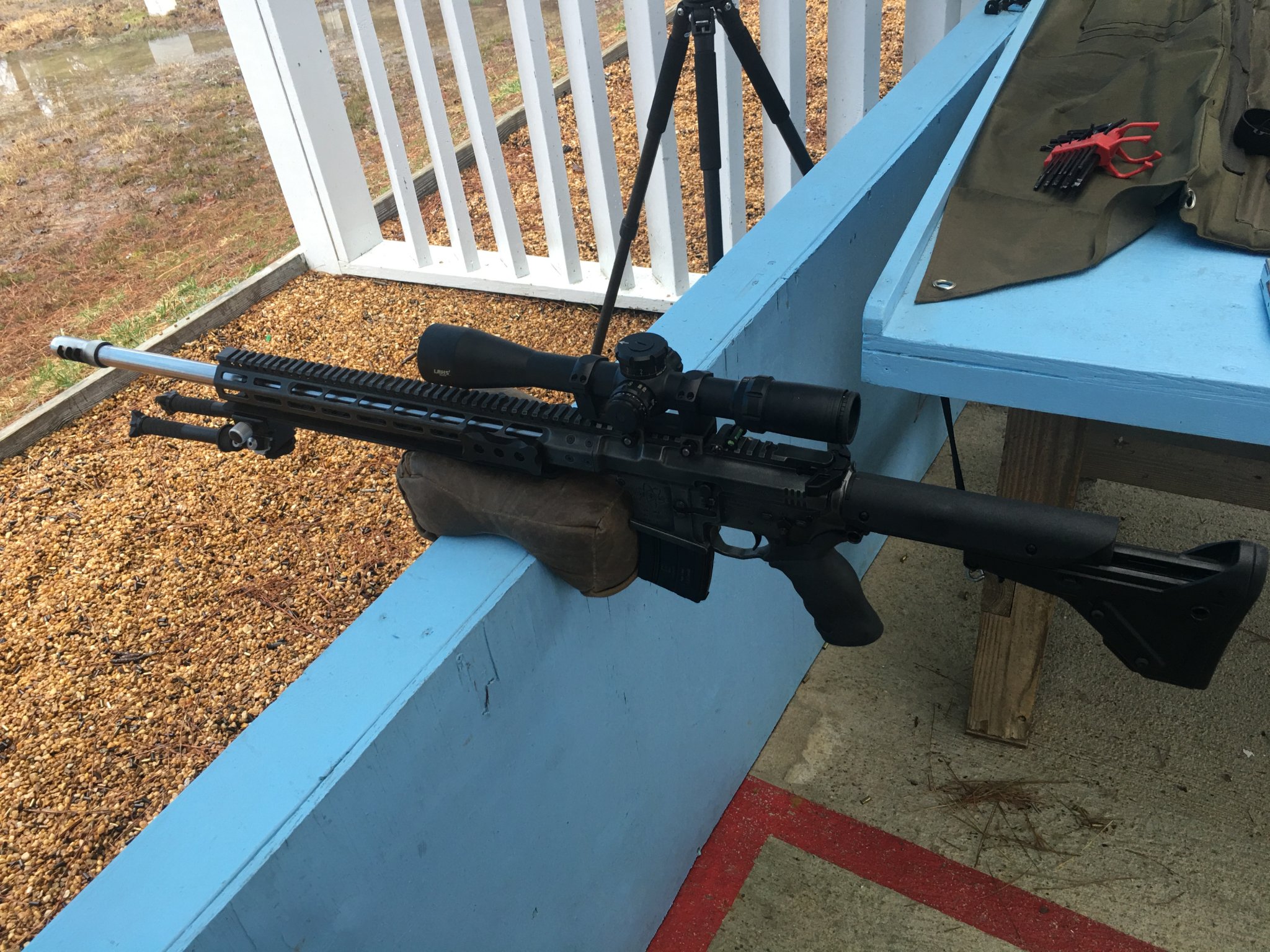

Finally got mine put together.
Mega MML receivers
Bartlien 24” barrel from Craddock

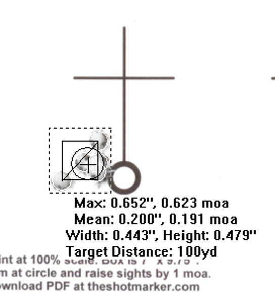

Only 60 rounds of factory Hornady down so far. Accuracy has been excellent. My Young’s NM carrier did not play well with the one piece gas ring on the JP bolt. Not getting a good seal. I replaced with standard rings and it’s been flawless.
Velocity with factory Hornady 108 match is right at 2700 with SD under 10. Does that sound about right? I was expecting a little faster. Maybe the barrel will speed up a bit too.
Sounds about right I think. From what I can recall about the velocity others who posted got out of the 108s that seems in line.
I have a 22” Rock Creek from Craddock. It is a button not cut rifle like the Bartlein. I looked back and after about 60 rounds I averaged around 2690. But my barrel definitely sped up with my hand load after I passed about 150 or so rounds down the pipe. Haven’t measured speeds in the 108s lately. Might do that tomorrow if the honey do list isn’t too long.
Paul Craddock does a great job doesn’t he!
Out of curiosity, what length gas system did you go with on your 24”?
Rifle +2 gas on the 24”.

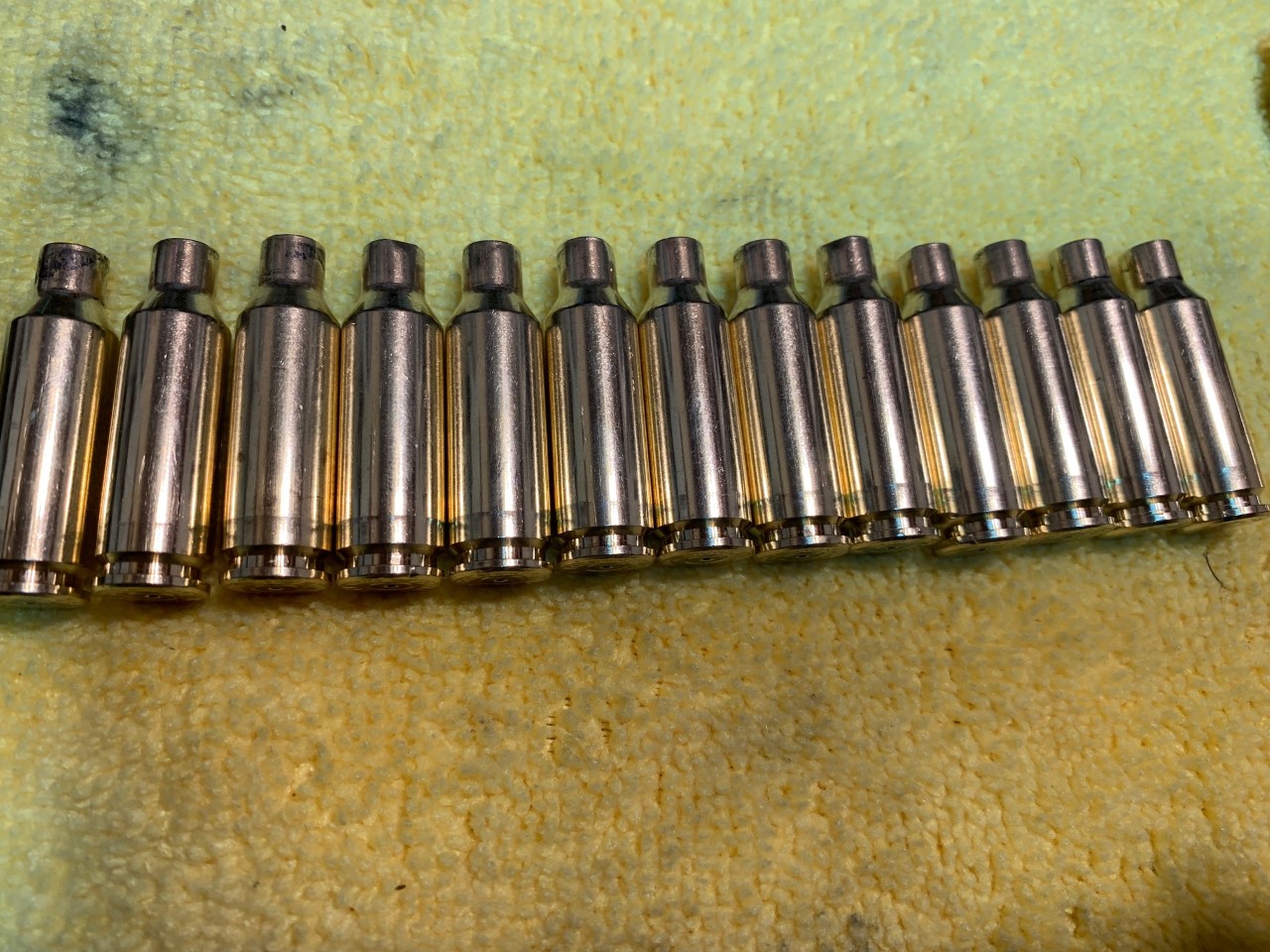

@raptor99: I may have missed some pictures but your cases with 'belts' doesn't sound good to me. I have learned a lot from @Yondering and would defer to his knowledge when it comes to ARs. In bolt guns, however, a hard extraction and measurable expansion of the brass at that point, often called the 200 line because it is about 200 thousandths from the case head, is called a clicker because the bolt clicks open as it contacts the extraction ramp and has to be forced all the way open--different from a high pressure bolt opening. The cause is either because the sizing die wasn't set to size enough of the case OR because the chamber is cut short and there is not enough chamber to support the brass. This means that too much of the case is protruding out of the back of the chamber and the only thing holding the pressure is the brass. If this is the cause, the brass will separate and cause problems very soon. The headspace could be right and that still be the problem. Any possibility you haven't check the headspace on with your bolt/barrel combo? Have you tried a Go Gauge in it? It should close on that fine and you can start adding layers of Scotch tape to the back to determine when it won't close. Each layer of tape is about .0015 to .002" thick. You should get 2 to 3 layers of tape on before the bolt won't close. If it takes more than 6 layers of tape, your headspace is not right.
You can also take your barrel out and see how much properly sized brass is poking out of the back of the chamber. Much more difficult to see on ARs as the barrel extension is largely blocking the view.
Here is an example of this problem on a bolt gun. The Go gauge should be in much further--right at the start of the extraction groove:
There are multiple problems with this chamber but it illustrates the point of not enough case support.

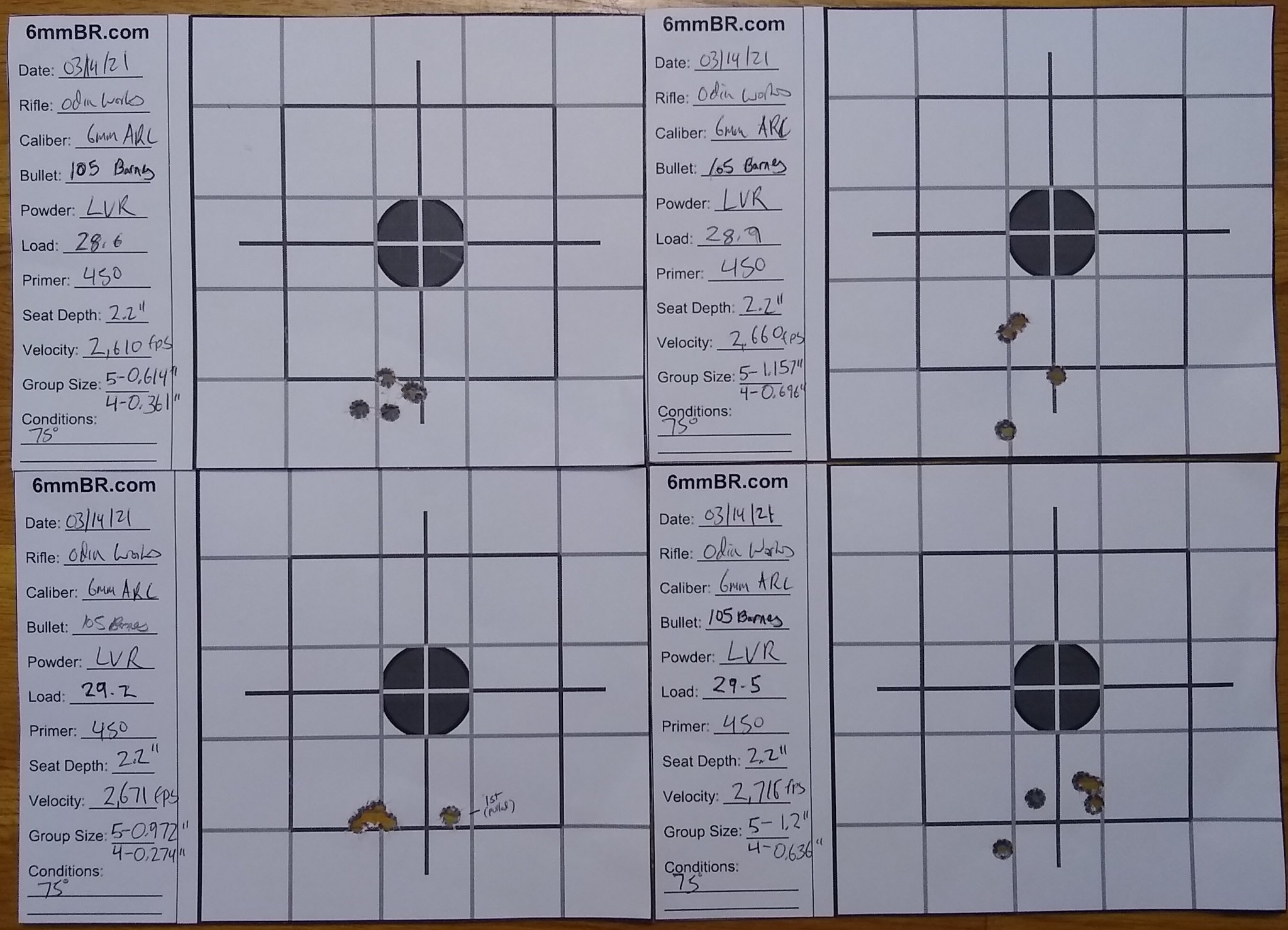

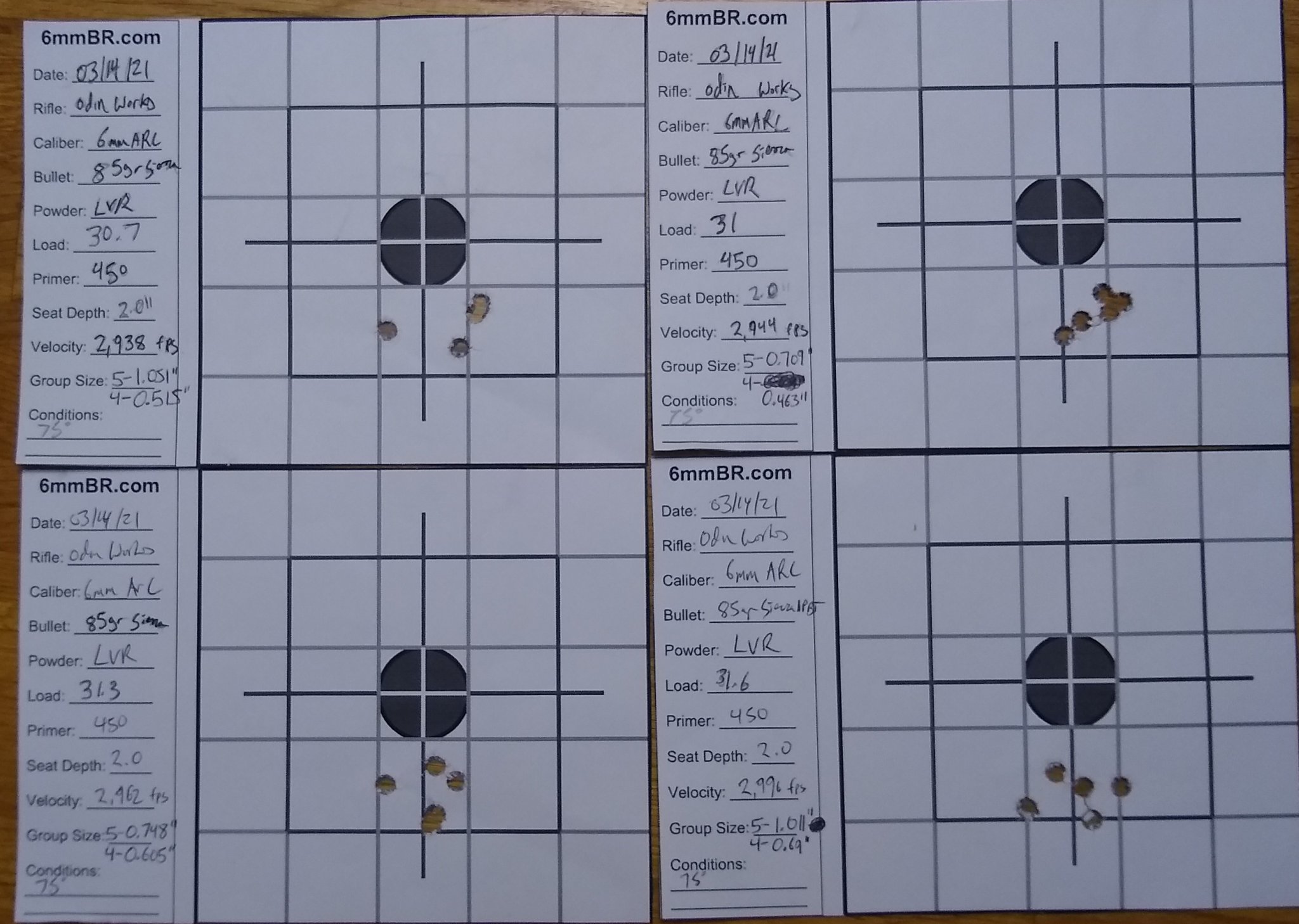

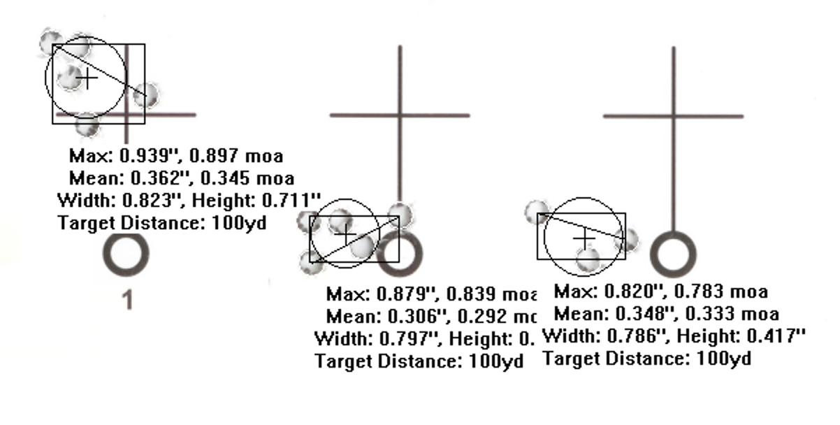

A lot has been written since I last took a look here. I got a chance to shot my 6mm ARC today for fun and was happy to see that my 29 grain load of CFE 223 behind a 108 ELD is still shooting well. It shot a .62 at 100 yards with bipod and squeeze bag. I had about 42 left over from deer season:
These shot at 2643 FPS today in 67 degree weather. The last time I shot them back in October, it was 75 degrees and they shot at 2662 FPS. Maybe the velocity change is to be expected.
I also had several leftover 28.3 CFE 223 loads. They shot at an acceptable .83-ish average at 2564 FPS. Both produced SDs in the 8.0 range.
Here are the 28.3s:
As always, a fun day with the 6mm ARC.

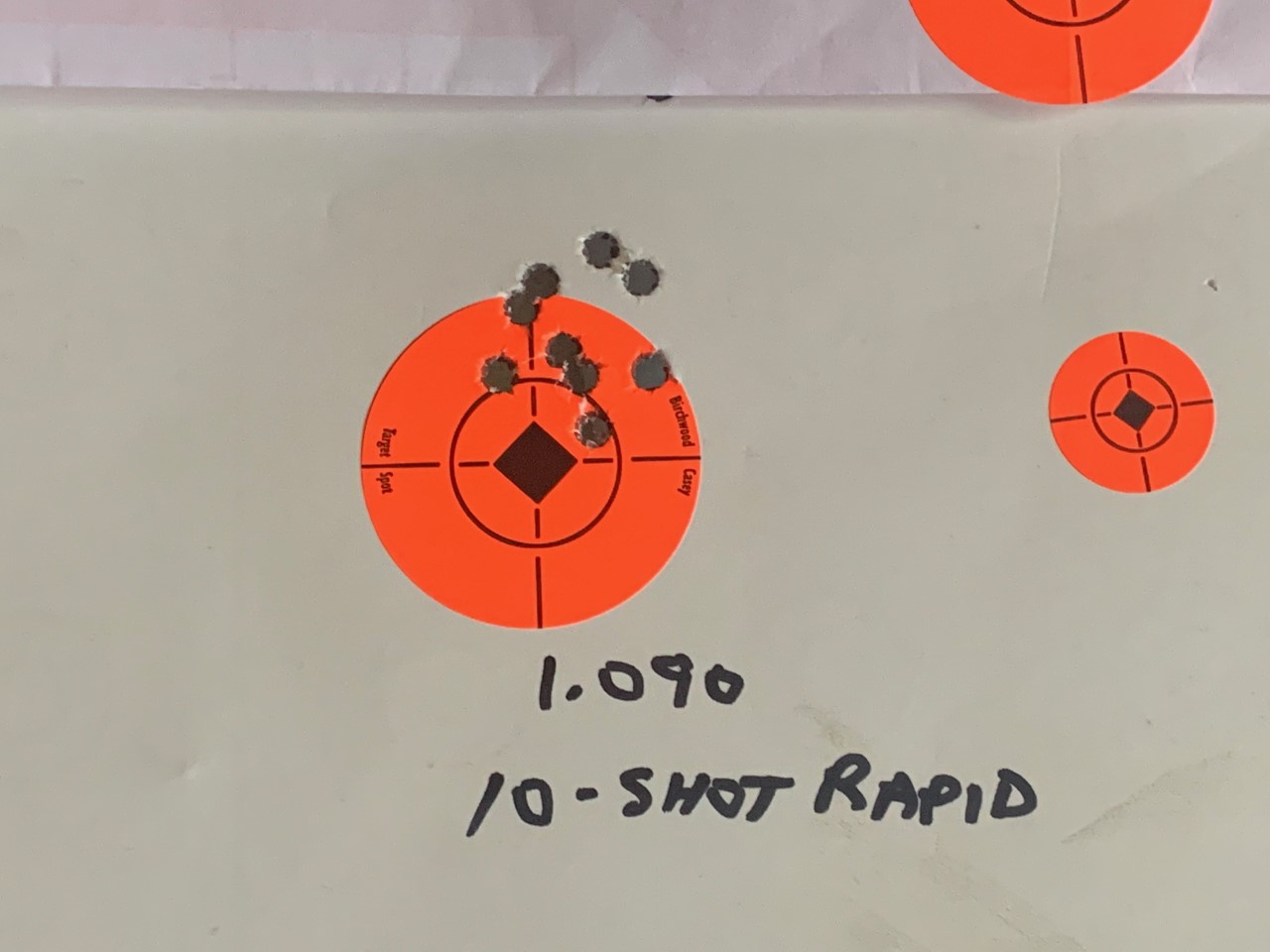

Side note, accuracy is looking to be very good. First 40 rounds shown here. 5 rounds to zero at 100. five groups of 5, and one group of 10 rapid fire. Getting some Leverevolution today, as well as some die bushings. Now the quest starts to find some projectiles Ugggg

Thank you for the reply. I don't have a go-no go gauge or know of anyone who has one. I know that part of my issue is excess pressure for a combo of using a can and going by Hornady load data. I was loading at the top of their recommended data and today I got a copy of Hodgdon's reloading data. According to "Their" data I am over max recommended loading by up to a grain+ using Hornady's data. I had a couple of loads with Varget that were .4 to .5 groups with both 87VMAX and 108ELDs. But if you have read this you know the issues that I have been having. I was using 29.5grs of Varget with the 87s and Hodgdon says the max should be 28.1grs plus you add a can and you have pressure. I was at 27grs of Varget with the 108s and Hodgdon says 25.8grs is max!! I loaded some loads last night that would be a grain to 1.5grs lighter with the 87s and 108s. I used Varget for the 87s and LVR for the 108s. The 108s were just fine but the Varget loads still showed just a trace of the belt but nothing like before. However when sizing the case I did get a small belt again. SOoo... Varget is out. I am going to start over with LVR and CFE to see if I can get some of my accuracy back with one of these powders and not get the famous "Grendel" belt. I actually cut a case in two and looked at the inside of it. There were no signs of any case head separations starting. As a side note I don't think it is a head space Issue since I don't get it with factory loads. Thanks again Henry and to all of the others on here for helping with my issue!!!
Adding a suppressor does NOT raise pressure. You keep talking like it does.
Like I said, you are not seeing pressure signs, you're seeing early extraction signs. That early extraction is caused by adding the suppressor. NOT the same thing as increased pressure.
If it is not increasing the pressure then why am I getting the belt when using the can and I don't get it when I don't use it?? What is causing it to want to "Unlock" to early if it isn't excess pressure???
Because the suppressor increases the back pressure into the gas system, making the bolt unlock faster. That's a totally different thing than raising peak pressure, which happens while the bullet is still in the barrel and drops off before it ever makes it to the suppressor. There's no way for the suppressor to affect peak pressure when the bullet is still in the barrel.
If you blocked off the gas system, you'd see no difference in the brass between suppressed and unsuppressed. The effect of suppressors on gas systems is a known entity that most who shoot suppressed look for ways to deal with, and is the entire reason for things like the Bootleg and Gemtech switchable carriers.

Out of my 21" barrel, 108gr factory loads chrono'd at an average of 2,663 fps.
First loads were some 85gr Sierra GKs I had laying around and 105gr Barnes, both over LVR.
Not terrible, except when I loaded up some varying oals for 85gr with 31gr LVR, and 105gr with 29.2 gr LVR and went back, things fell apart for no apparent reason. Only real difference was that the second trip was about 30 deg cooler than the first. I almost always use temp insensitive powders, so my experience with sensitive ball powders is very limited, but I wouldn't think there's any way a 30 deg temp difference could change velocities enough to throw you out of a node? I also wound up having to turn up the gas on the second trip a few clicks. Admittedly I set the GB up so the rifle will run suppressed but not otherwise, still, no failures the first trip, but it started feeling sluggish and failing to strip the next round (only with the 105s, 85s cycled fine) on the second cooler trip. Alternatively, I may have just been shooting poorly the second trip. More work to be done, but ~ 2,950 seems pretty healthy for 85 gr though!
@Gtscotty Hoping with careful loading, my Odin will preform as well as yours is showing
Side note, tossed the 40 pieces of once fire Hornady 108 M from the initial sight in and function testing in the Thumbler. A bit of a surprise as around a third of the brass exhibited that slight 'Grendel Belt' discussed, measuring in at just under .001. Suppose I had forgotten what suspect brass they make in Nebraska, learned that about ten years ago fooling with Hornady cases in another project. Thinking I should start looking for some Lapua 220 to convert, and eagerly awaiting other brass manufactures to jump on board with the caliber.
View attachment 7592175View attachment 7592176
That "belt" starts pretty far from the case head; looks like your chamber's feed ramp was cut/beveled too deep (that's a good example of what LedZep was talking about earlier), or the rifle is extracting prematurely due to being severely overgassed.
Also, you'd want to form brass from Grendel cases (Lapua or otherwise) rather than 220 Russian, unless you want to waste more components in fireforming.
I had the exact same ring on about a third of my first firing of factory 108s as well. I'm using the RCBS SB dies (gotta use what you can find) and they ironed out the line pretty well. I was thinking it must be a sloppy chamber or long headspace. I can still see a line on about a third of the brass after my third firing, but it's pretty faint, and the balance of my cases don't have it, which seems pretty weird if it's a sloppy chamber. I think I'm pushing the shoulder back about 3 thou, maybe the factory loaded cases were under sized? I have some left, I'll have to check some time when I think about it.
