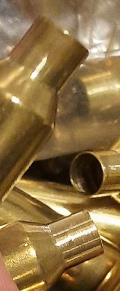

Down to last 25 pieces of brass to neck turn. I have found about 10/20% have differences in the neck thickness or have the necks pulled off center. If you look at the picture close the top brass has a spot on the neck that has not been touched by the blade. The brass on bottom is a comparison where the entire neck was cleaned up. I could have gone deeper, but I figure since this is 1 or 2x fired, I can seperate out the different necks and use them for practice or turn them further.

What brass are you using?
Also, what do you mean by separate out the different necks? How do you do that, and why?
Finally, do you have links for the mandrel and press set you are talking about?
All starline brass.
as for the Us, I *think it is just neck uniformity differences, not the necks being pulled off center - but I'd like to make sure of that.

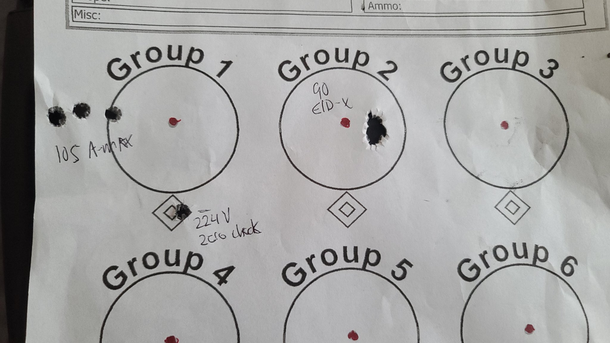

Reporting back on the CLE Bartlein over the past two relatively short outings with some 90gr loads. 4 shot groups @100
10/31
Last weekend's results. Both were loaded at 31.0 gr as I found a good flat spot and combination of velocity I was looking for between 30.8-31.1gr of Lvr. I did find myself shifting fore and aft a bit trying to find proper eye relief during shooting these past few groups. I feel this was the reason I had those single errant fliers in both groups. I ended up moving the scope back a little bit when I got back home and found a general sweet spot for eye relief that would work well in different positions. These groups were shot of a bench, rifle rested on a bag.
11/6
Decided to roll up some more 90 eldx and a few 105 amax for yesterday's outing. Excuse the single .224 V round, I was going yote calling later that day and confirming first round zero. Results confirmed my suspicion and the 90 eldx were fantastic right at .25 ctc The 105 amax was a middle of the road charge at 27.8gr just to get a feel, that yielded .75 group size, will work on that some down the road.
Over the course of testing, the CLE barrel has not produced any group size over one minute, testing thru 4 different bullet types over different weights, ranging from 75gr to 105gr. A few close calls but still keeping 'em under an inch. This is my second 6arc tube and I think I have found a winner with my luck and all on the first tube.

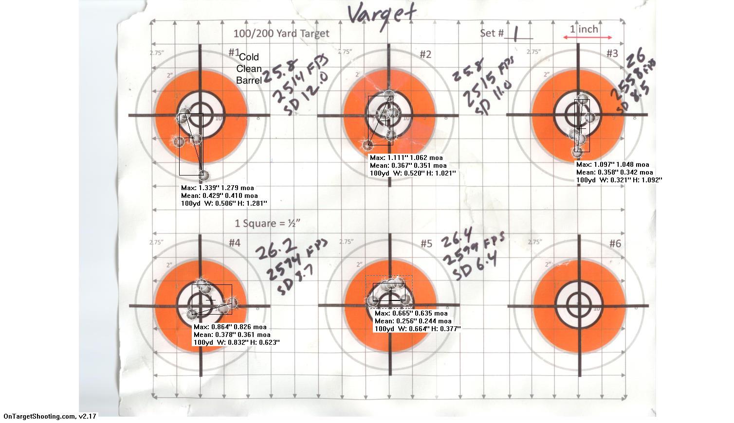

Alright. I am getting a little happier. Shot some tests today with Varget and CFE223, results above. Need to test a few increments more with Varget as it looks like the group was just starting to tighten.
CFE223 did okay today too. I need to test both a little less powder and a little more powder.
All of these groups were shot with Hornady 108 ELD-Ms loaded to a COAL of 2.260". I shot from prone with a Nightforce 5.5-22X50 scope using an F-Class bipod and rear bag and an Accu-Wedge!
It did start raining during the last few groups of the CFE223, and, to be honest, the rain was heavy enough to make the target somewhat blurry. The last target may have been somewhat lucky.

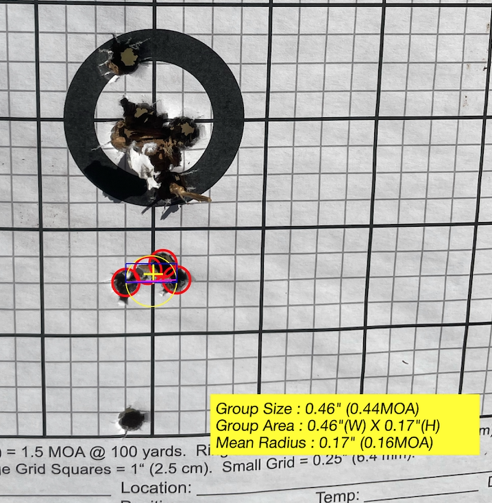

Finally got my 6 ARC AR build out today. I’m impressed so far for the first 30 rounds. Soft shooting but different recoil impulse than a regular 556 AR. It was a laser to 600. I can’t wait to get it out further and see how it works with some wind and normal conditions. I’m guessing similar to 308 beyond 600. Perfect weather to shoot in today. I only have factory ammo right now but will be ready to load for it soon.
The range is limited to steel targets at 600 yards so that was the max distance I could test to. Mix of animal, small swingers and silhouette or square plates. There was zero wind today so I could not check the drift.
108 Hornady ELD
2642
13.2 SD
.55 MOA 5 shot group with MS hanging on the barrel
2000’ DA
600 yards - 4.1 mils
Kestrel AB dope was spot on to 600 with .270 G7 and 2650 dialed in. Pretty much add a mil every hundred yards from 300 out.

I am getting ready to do some testing as well in regards to LVR temp sensitivity this weekend. I run only magnum primers with any type of spherical/ball powder used. .
I kept the charge weight the same but the only difference in load is the primer used. CCI 450 vs Rem 7.5 I have numbers recorded from this late summers testing and will see what temp effect has on each.
I can say definitively the 7.5 produce better numbers and accuracy when using LVR and PP 2000mr which I run in my 224V. If you have ever come across Mr Salazar's primer comparison it show the 7.5 has quite the fireball upon ignition which I feel maybe advantageous for ball powder stability to some hopeful extent.

I was going to go that route but didn't want to spend the time to see where the spread was at. We get 30* swings from 40s to 70s this time of year...My loads were developed in the 90s, will the drop be linear? Or is it gradual to a point and then a big drop at say 30*?
You are 100% correct, if I was married to LVR that would be the way to go.
Not linear. Usually from a 70 degree baseline going cold (-20 degrees) will be about half the fps/deg value that going up to hot (140 degrees) will with *most* rifle spherical powders. That being said, I think if you keep it under 100 degrees it would smooth that out a lot and make it much more linear. Somewhere around 1.5-2 fps per degree sounds about right for LVR, if you take a look at Lennyo's numbers.
