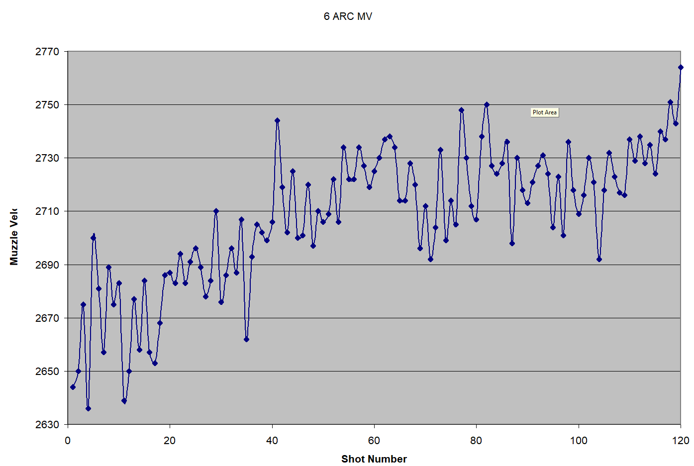

FYI, 22" Shaw barrel, Hornady factory 108 ELDM, 1st 120 rounds down the tube for barrel break-in. I'm seeing similar MV's in handloads with CFE223 and Lever with 109 Bergers and 110 ATips. Some of the dips, like around shot 70 and around shot 90 were cold fronts blowing through, so for sure I'm seeing temperature sensitivity. Around shot #110, I got a .65MOA five shot group at 700 yards so I'm fairly happy with the Shaw barrel. I think it's a better barrel than I am a shooter.

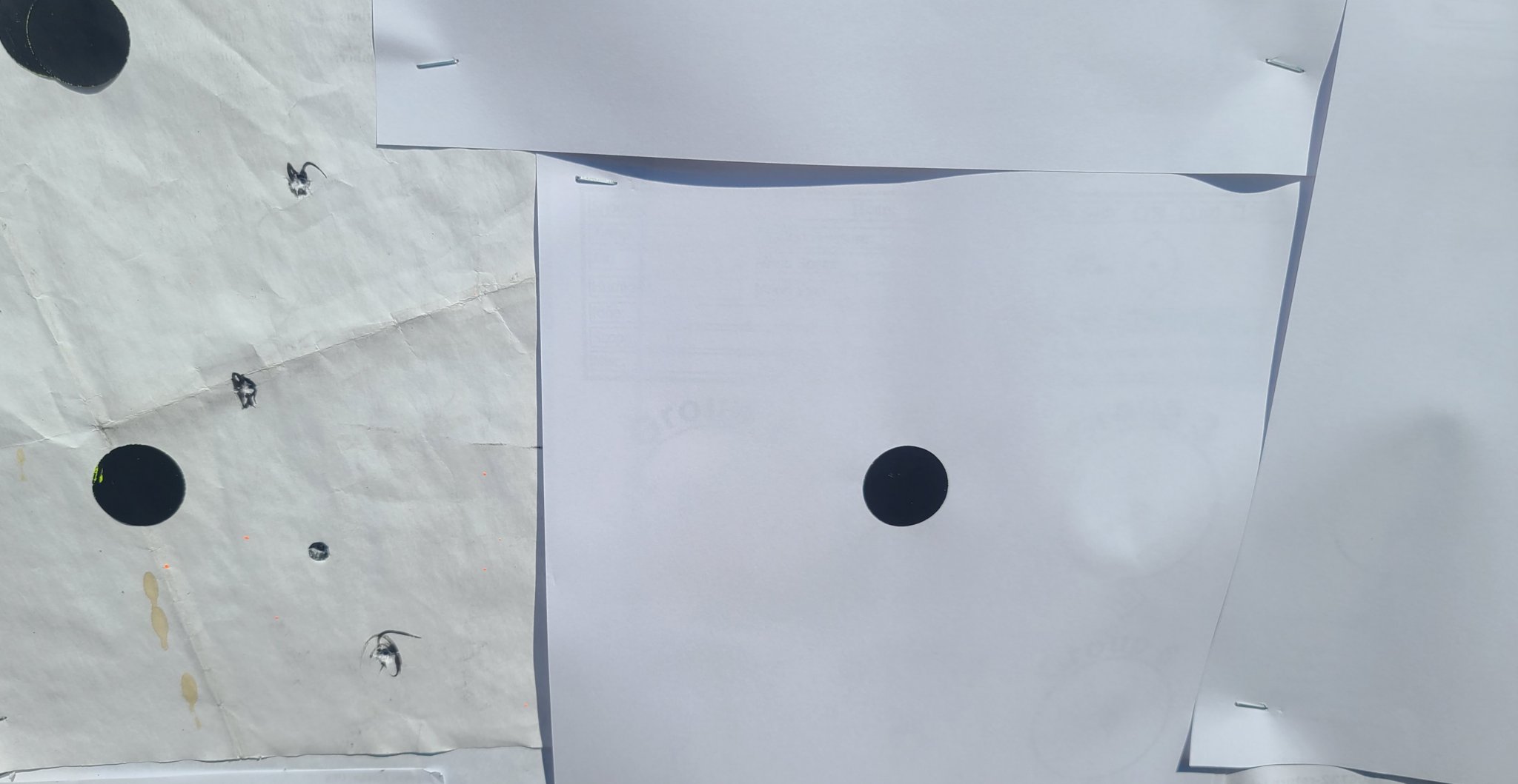

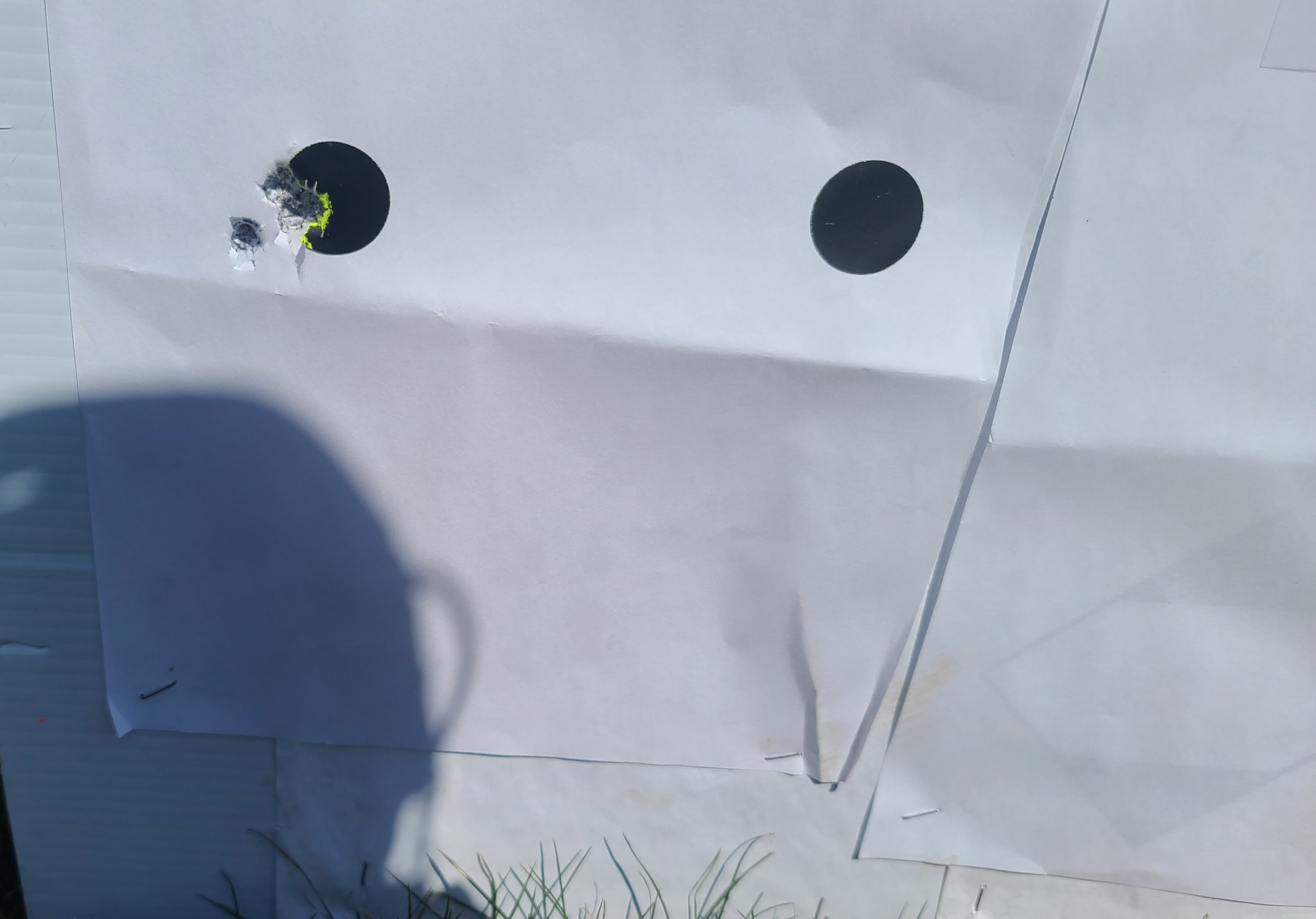

Well I had 6 rounds left over from load development for the 20" Proof..that one is a whole other story in itself. They were 75gr vmax at 32.3 gr LVR, Starline 6.5 and rem 7.5. I figured yesterday I would use them to get a half ass zero for full load development this weekend coming up. That and I also whipped up 3 Tubb tms rounds per my usual half ass barrel break in procedure.
Setup a fairly large target at 100
First shot, a bit left, elevation looked good, bolt locked back and the +1 gas system felt smooth with a standard a2 buffer and jp polished rifle length spring.
Made adjustment and moved on to a different 1" pasty and then shot another, about a .1 low and still 'bout .1 left, .2 would of prob been better. Made another adjustment and shot the remaining 4. Very, very pleased.

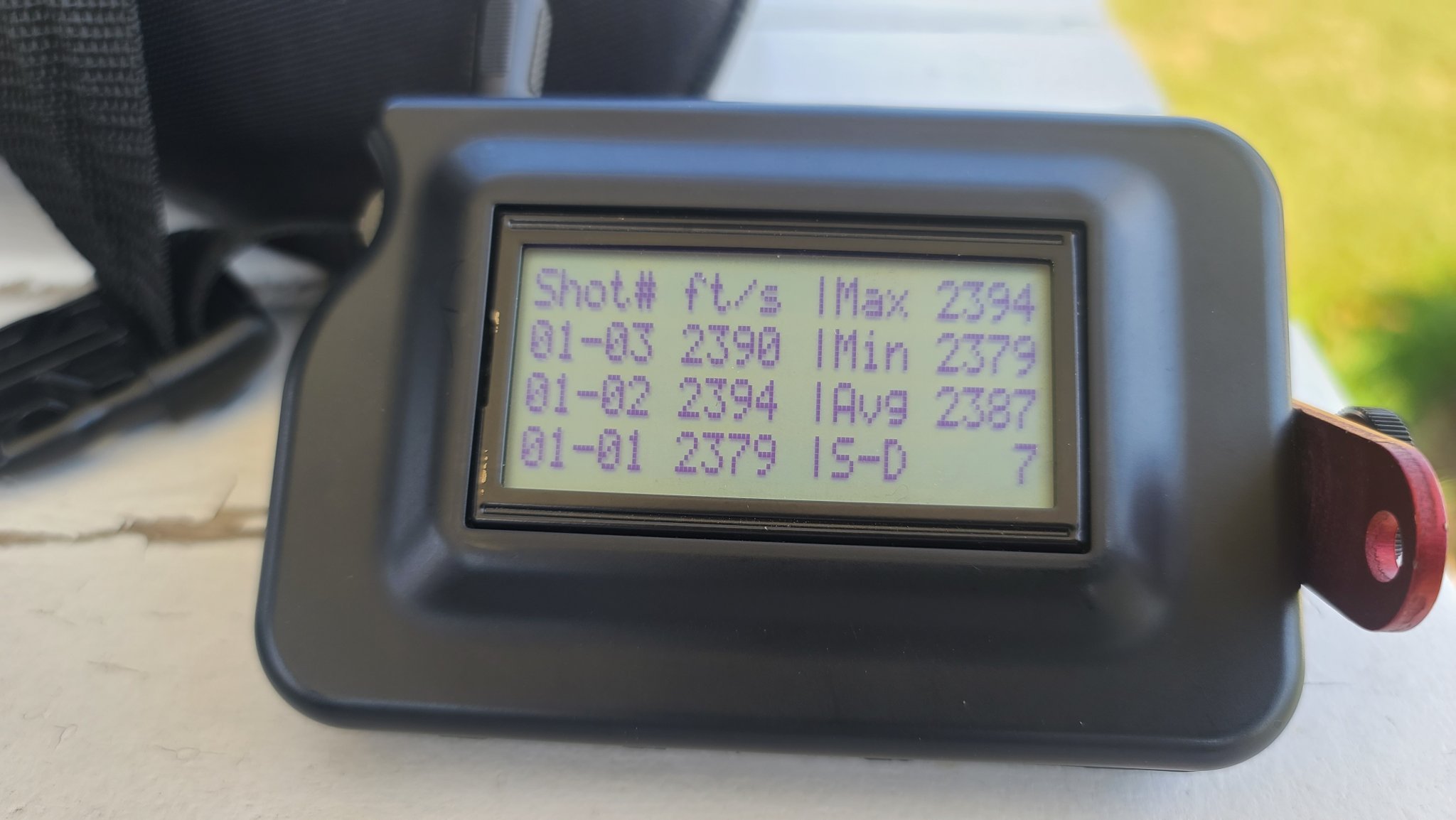

I chronyed the tubb tms rounds for s&g they were loaded per hornady gas gun starting load for the 105 bthp at 25.2gr lvr. Tubb uses 107gr smk.
I plan on loading around the 90-95gr for these, and a few 100 105 amax I have left over from my 6br days. Have a crap load of 105 berger hybrids but I'm loading those exclusively for the 6x47L. Looking forward to this weekend, so on tap is 90gr eldx. 90gr berger mt and some 105 amax, with LVR, Cfe and maybe pp2000mr, have loads of Varget and h4350 but starting with those powders for now I guess.

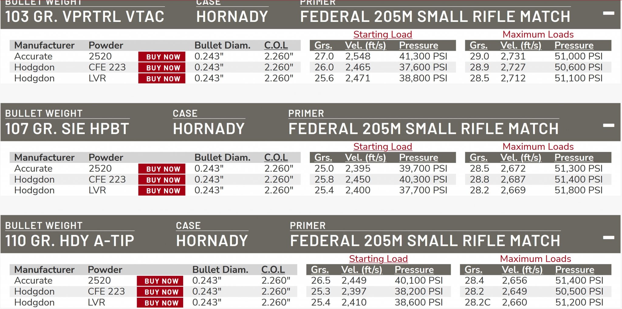

I am wondering if anyone has looked at Hodgon's reloading site anytime recently. Looks like Accurate 2520 is giving very respectable velocities (according to their load data).
Velocities match or exceed CFE223 and Lever in the listed 107 and 110 grain categories.
Wondering if anyone here has tested it?

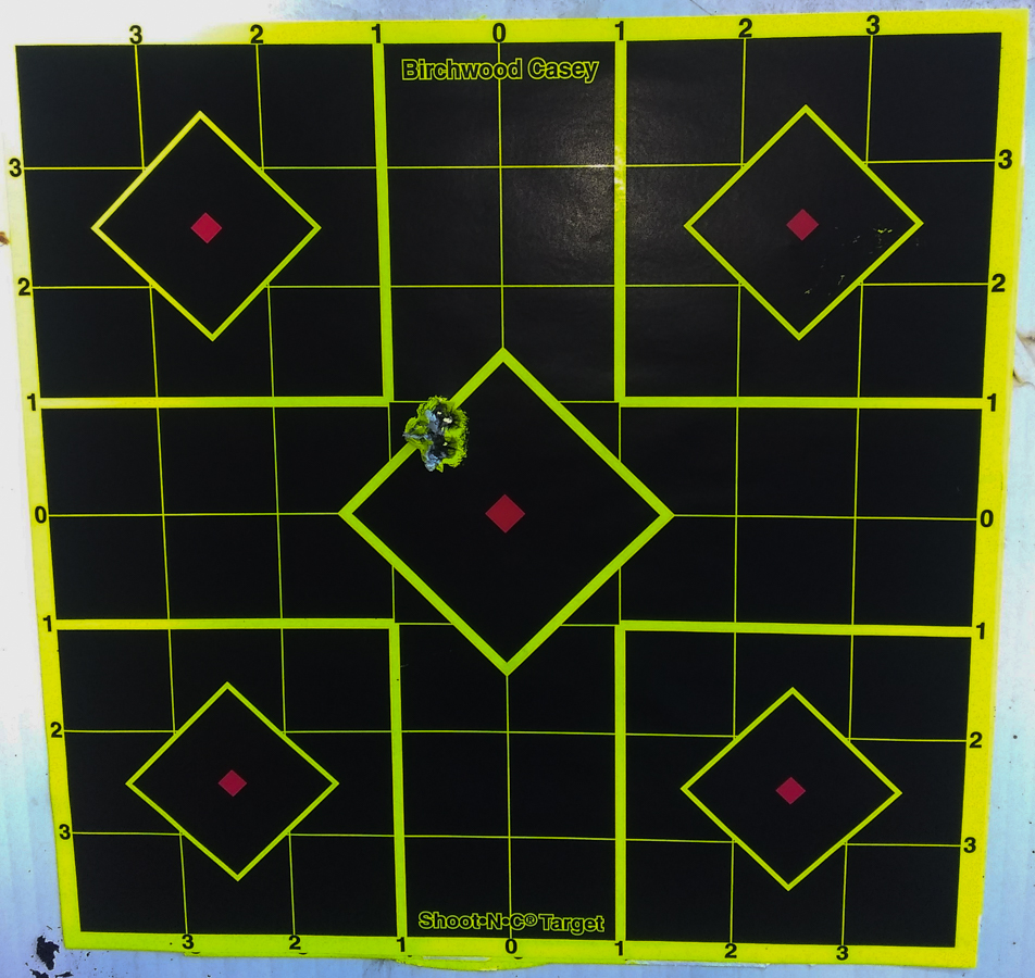

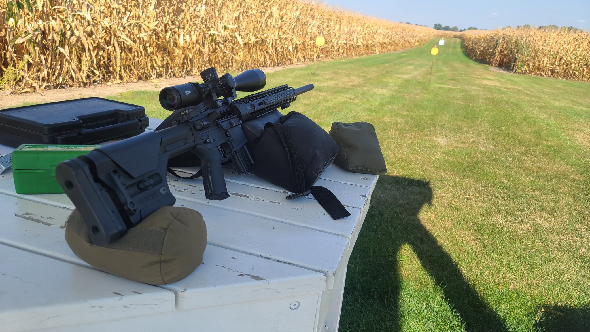

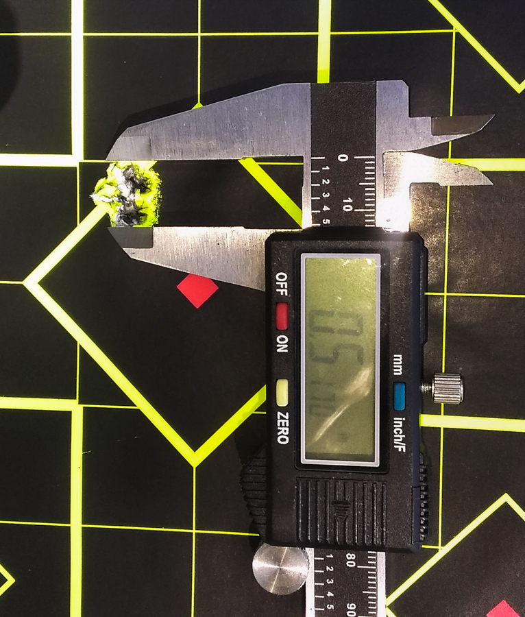

I have been doing some extremely slow testing. Part of it is supplies are limited because I can't get an assortment of bullets like I normally do. I started out shooting 112 grain match burners but the other day I found a single box of Hornady 108 grain bullets.
Today this was my very first load with no seating depth or charge weight tests done yet.
Five shot group was shot off of a bipod and rear bag.
The outside edges measured .517". Center to center that makes it .27". Since one MOA is 1.08", that makes this group exactly .25 MOA.
Straight out of the gate this ain't half bad for a semi automatic AR15 that people on the internet tell me won't shoot groups.

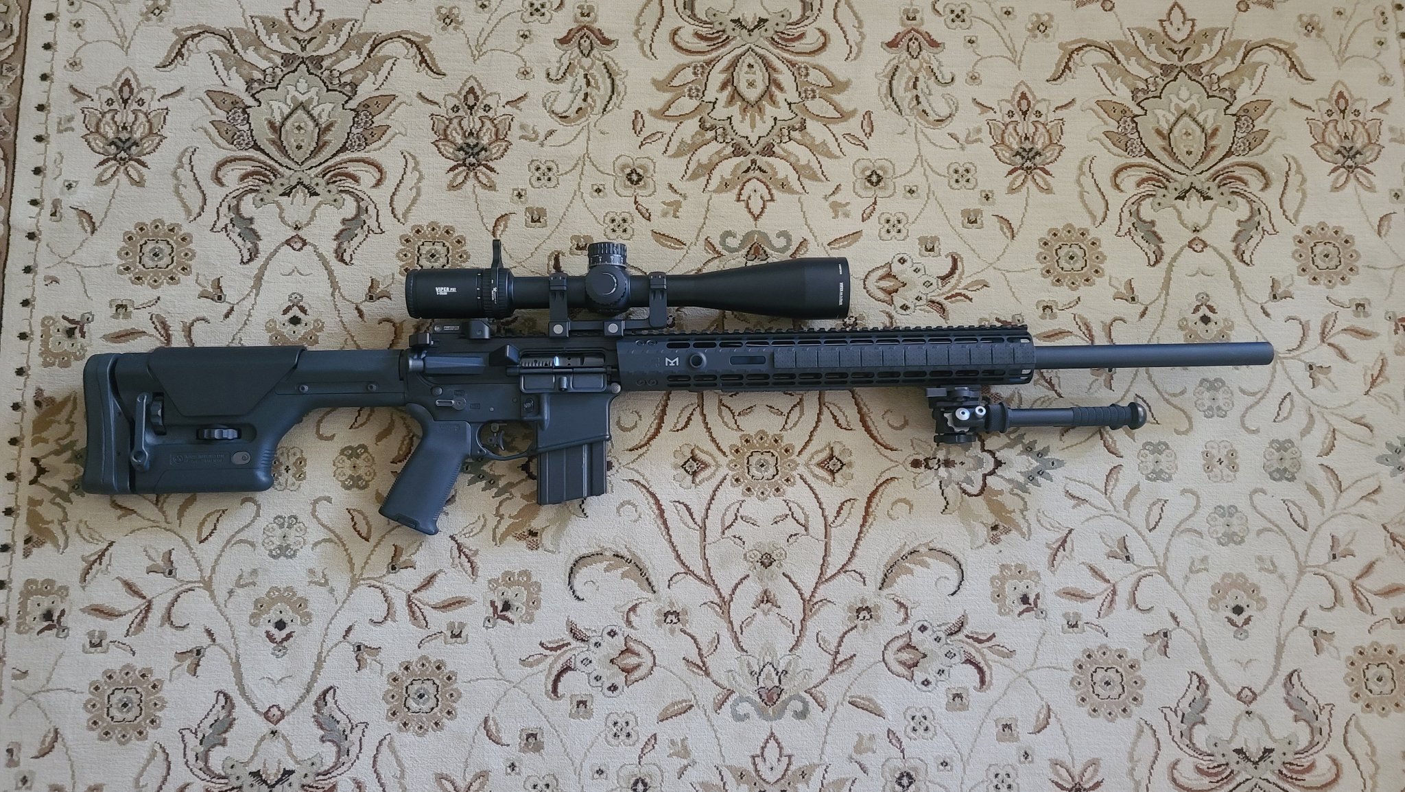

24" CLE Bartlein finally in and buttoned up...I'm running short on scope bases so this unimount will work for now. Also have a 20" Proof so be interesting to see velocity gains side by side.
Ah come on, man. Here I've been holding out for the past year or so planning to put together an 18" 6 ARC barrel for my current favorite "do everything" LMT MLR to make it even better. And then you post this and it reminds me that I have a lower sitting around doing nothing and "hey wait, why not build something similar?" Welp, time to start looking for uppers with long barrels...

Ran the Poverty pony out to a K today. Besides a couple feeding issues that I suspect are mag related (20 rnd ACS), it did great. The wind was mild and the LR pavillion was empty. Also shot the IveyTron on top of the new Bergara LRP in 300PRC , but that's another thread.
Next up for Arc is more neck turning and mag testing.

Snuck out after work for an hour or so to garner a quick range report with 90 eld x and 30.9gr lvr with 24" cle Barty.
Had 4 different batches made up one with cci 450 the other with rem 7.5. Two batches of each neck sized with 241 and 240 mandrel. All groups of 4 shots were sub moa the cci 450 averaged around .75 with 240 mandrel and a bit smaller with 241, but sd was meh with 5 shots in the double digits. 3025fps avg.
The 7.5 primed loads were outstanding, avg .5 moa with the best numbers, sd of 4 fps over 5 shots avg 3038fps. With the best group using .241 mandrel under .5 Again groups with 240 mandrel opened up just a wee bit. I can say that there is a consistent difference between the two with an improvement using the 7.5 and .241 mandrel.
This all with 3 times fired freshly annealed Starline brass allowing barrel to cool between groups.
Have 90gr Berger mt and 105 next up for testing.
