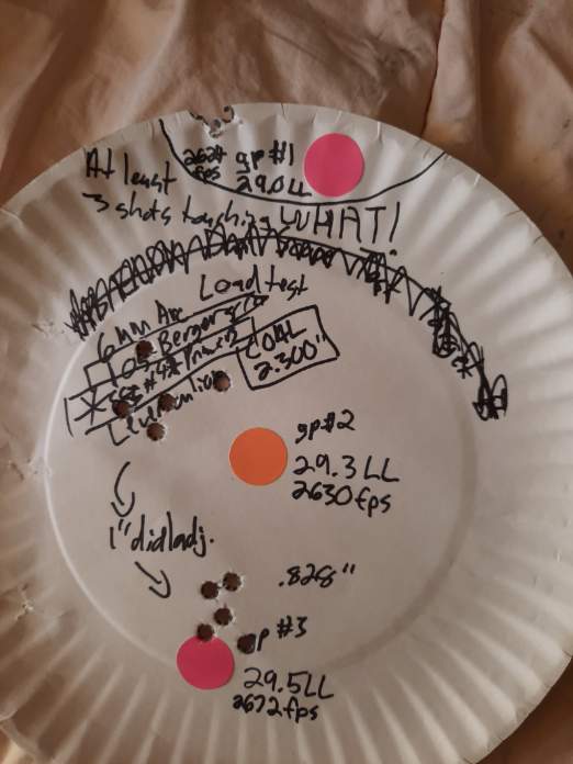

Here's my target from a couple weeks ago testing higher velocities with the CCI41 primers. My wife had my stapler, and I had limited supply of sticks to mount the targets so I decided to try and get some multiple groups on the same plate. one of my tricks is stapling on the side of the plate (assuming your rifle/bullets shoot straight).
Well, I was holding a bit high for 100yds(zeroed for 600). The first group had 3 or 4 shots cloverleafing (at least 3 shots touching), I'm not sure about the other 1 or 2 shots in that group. The bottom group is the fastest I'm gonna go and still sub MOA. I'm going to load up a hundred more in the top and bottom group and have see what turns out.
