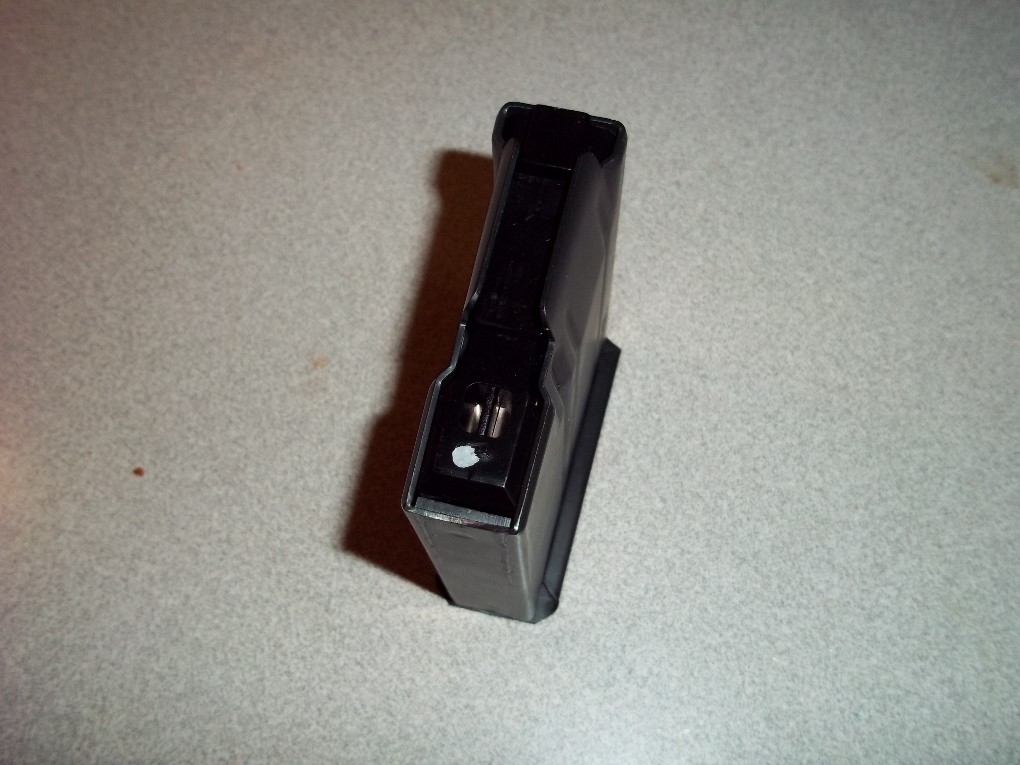

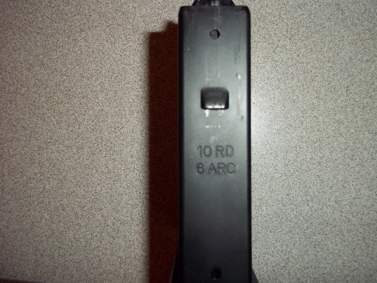

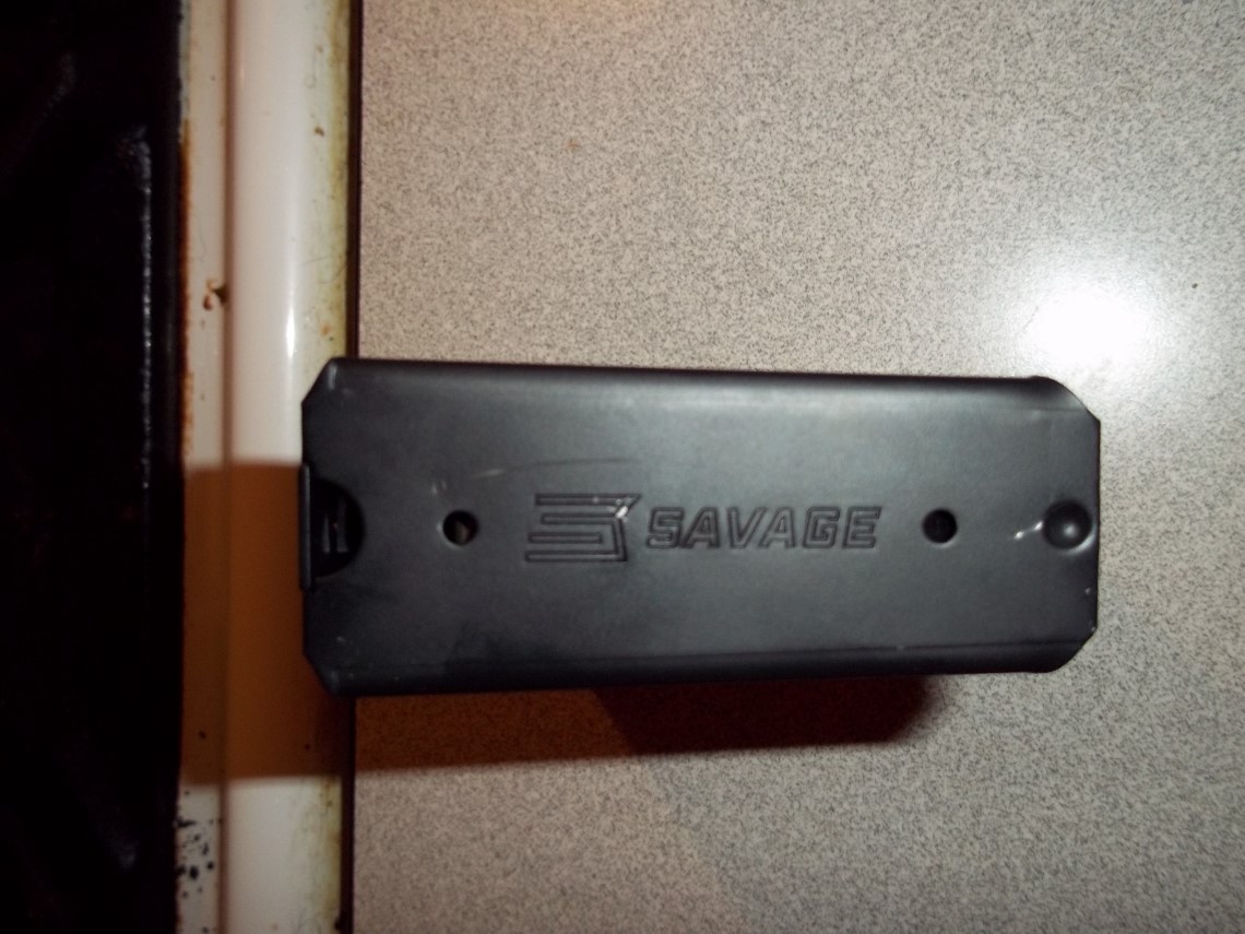

I tested some more ASC mags today, I got a couple more 10 rounders and a 25 rounder. I didn't get to test the 25 at full cap, maybe next time. I had about 10 or 15 when it got emptied on the 380 yd target.

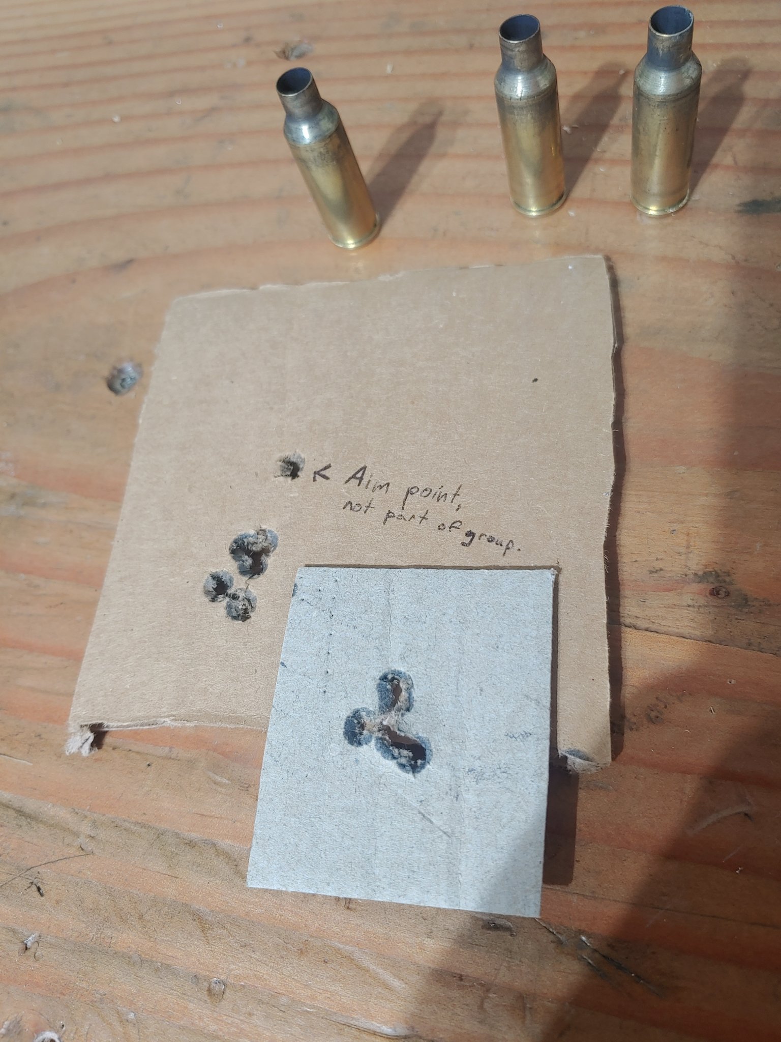

Loaded x 10 A-tips with 29.5 Lever = 2650/SD10.5 @100y .9" group / @300y 2.9" group. These were at 2.295/1.673 (max for the Brenton mags).
Not a mark on the head stamp.
Tried 109's @2.287/1.675, 2.290/1.678, & 2.293/1.681. Five rounds each @100 shot .830", .550", & .625". These were all loaded in Hornady brass & Lapua is a little more accurate due to the +.002 necks. Figures this gun would like the unobtanium 109's. Only have 500 & the 6GT loves them too.
I'm now going the other way with the 100gr TGK's (more jump). Loaded 2.265/1.690, 30.1 Lever = 2820 & put 4 rounds in .42", but of coarse I yanked the 5th making it .9".
