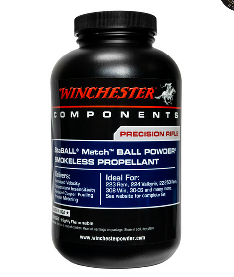

I've kind of got my hopes up for this one.
For sure, been waiting for that to come out for a while, the rumors started shortly after 6.5 STB came out.
