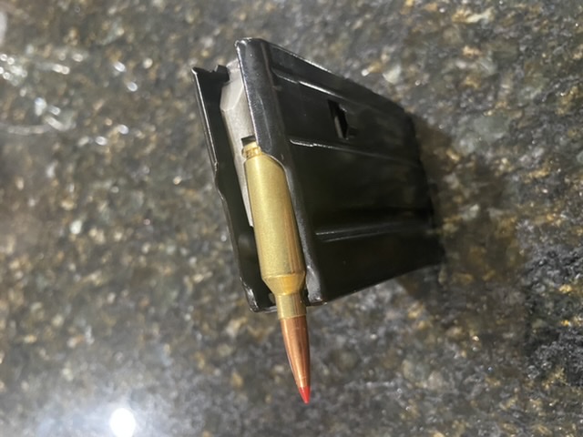

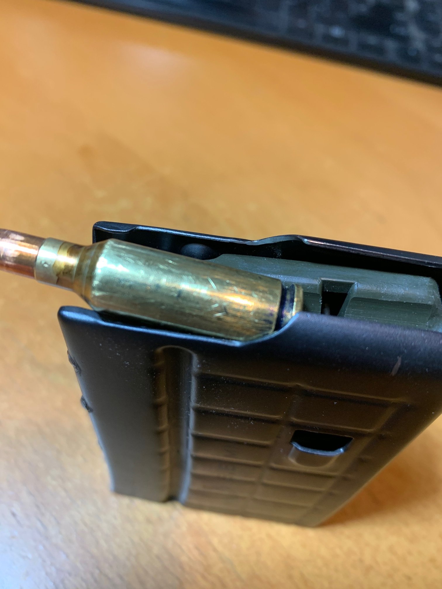

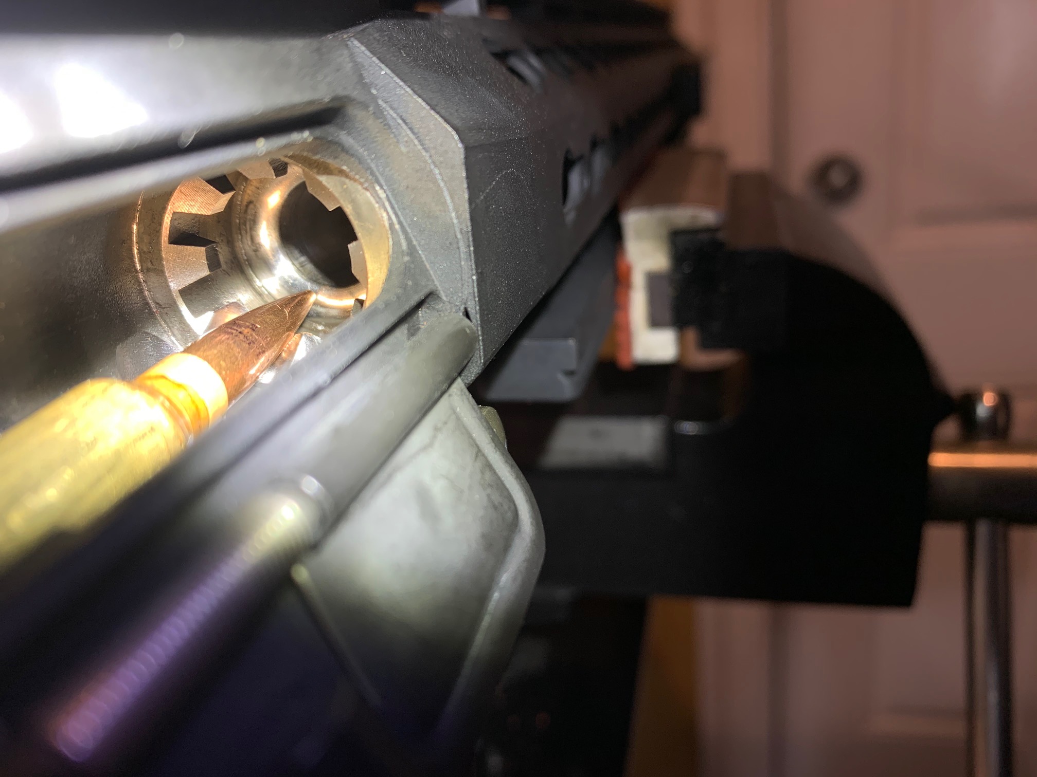

109 Berger's loaded out where I want them (2.290).
Edit: I didn't word this well before. At 2.290 the 109 Berger's hit the barrel on the low side of the radius into the chamber. The picture below is with a mock up round & was taken after riding the charging handle in, so pictured round is hard jammed with full buffer spring pressure against it.

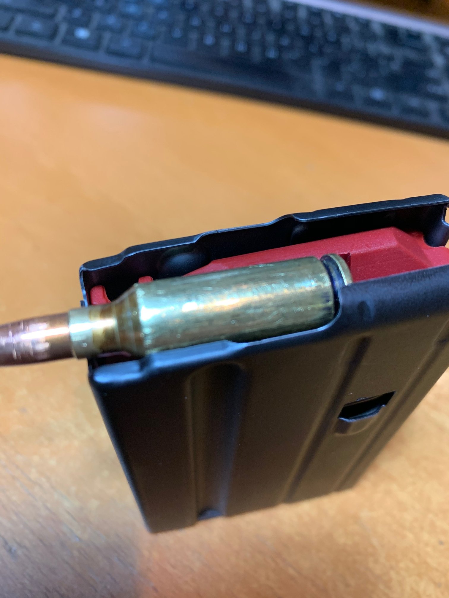

This may be why the 100gr PVA Seneca's were key holing on me. Those jokers are way longer than the 109's & the Seneca points are super sharp.
Unfortunately the PRI mags are only hold 5 rounds of the ARC before they start to bind up. They have this little lip feature at the front of the mag that lifts the nose before the feed lips let go of the round. The lips lift the 109's or anything shorter loaded less than 2.300 before the bullet hits the barrel.
The ASC, C Products, & Brenton's do not have this feature and allow the sleek little 6mm's to slide straight between the barrel extension feed ramps till the tip hits the barrel.
Does anyone have an Elander mag they could take a picture of??
Before I do any more load development on the ARC I have to get this sorted.
109 Berger's loaded out where I want them (2.290) hit the barrel before the feed ramp lifts the case.
View attachment 8023197View attachment 8023192
Elander will bind up on dust in any environment outside of a clean room. But, here is a pic of a 22 Grendel in an Elander Grendel mag. No, there is not much to push the cartridge toward the center.

Minor nit-pick on your terminology above: technically the feed ramp in an AR barrel is the chamfer or radius leading into the chamber. What you’re referring to is just the barrel lugs. I know that seems counterintuitive, but for sake of everyone talking about the same thing…

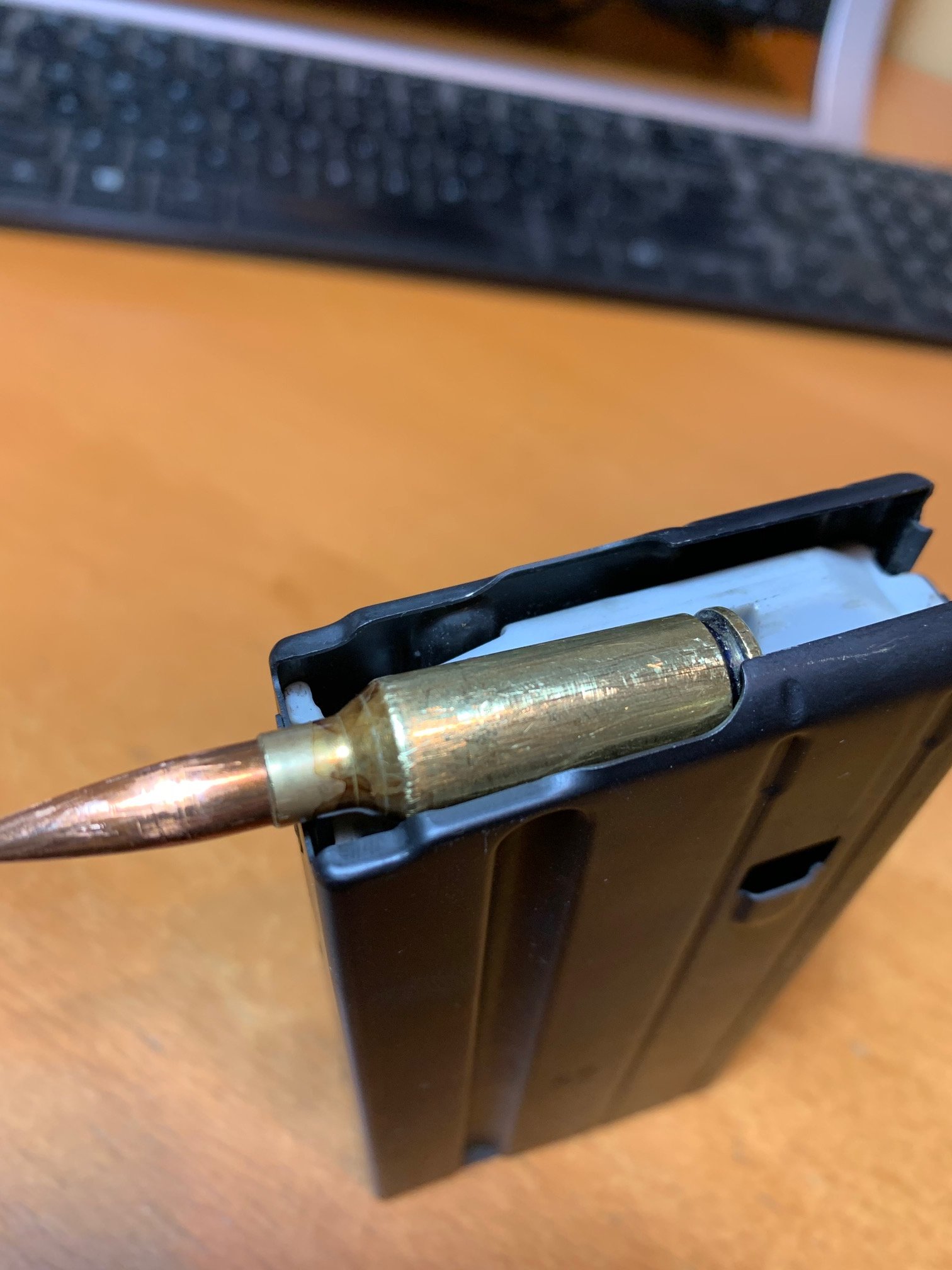

For long loaded rounds you’re best off with stainless ASC mags. If you need even longer, cutting the front out will get you to 2.355”, which is what I load one of my 5.56 rifles to with the 70 RDF. Don’t know if that’ll fix your feed issues but could be worth a try?
It is difficult to see from that angle, but it appears the bullet tip is ever so slightly touching the radius end of the barrel. Yes it is a beautiful picture of the lugs.
With the Stainless ASC mags & only the Stainless I have loaded my .223 out to 2.316 maximum. Have never done any cutting on mags.

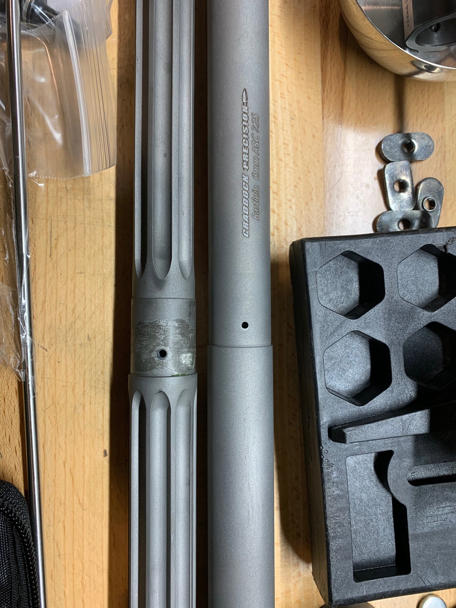

I've got a new Craddock Bartlain 22" Arc, but I keep getting sidetracked. New 22GT build last weekend & loading ladders for that. New Nuke 223 build this weekend & more load ladders. Good problems, no complaints!
Also FYI for the ARC guys. Apparently Rainier & Craddock definition of plus 2" gas is different. Not saying one is wrong but they are different so just be aware if playing musical barrels.
View attachment 8023136 View attachment 8023137
...now that is an interesting observation and pic about Gas system lengths, thank you for that pic..

I edited the post. Didn't word it well before. It does get a little confusing with AR's. You've got the "M4 feed ramp extension" and then the actual barrel feed ramp/chamfer as you pointed out. The latter we want minimized to better support the case, but that comes with a cost for feeding.
I'm going to see what I can possibly improve with some mag surgery.

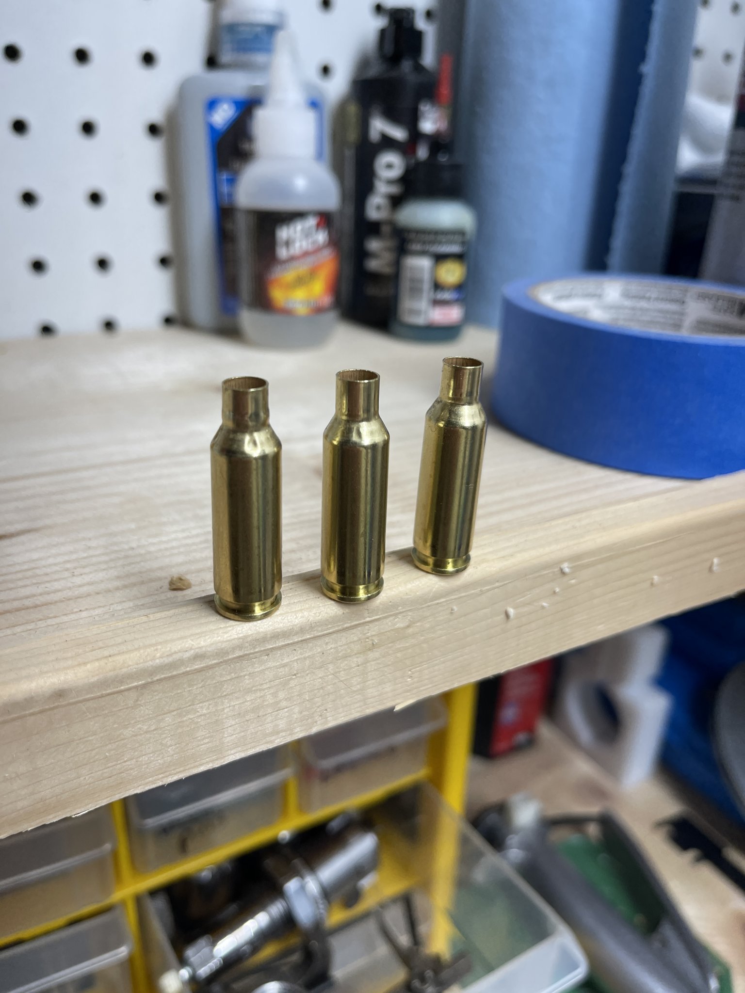

I got my rcbs matchmaster dies in today and tan 3 pieces of 6.5G new brass and all 3 sized very easy but all 3 have dents in the shoulder. What is this from?
EDIT: After googling... seems using too much lube can cause this? I cleaned the die with brake cleaner, and then hornady one shot lube/cleaner.
But I did lay the lube on the cases heavy, not knowing how tough it'd be to size.
Yep that is from too much lube. Trim and fire and you will have fireformed cases after that.

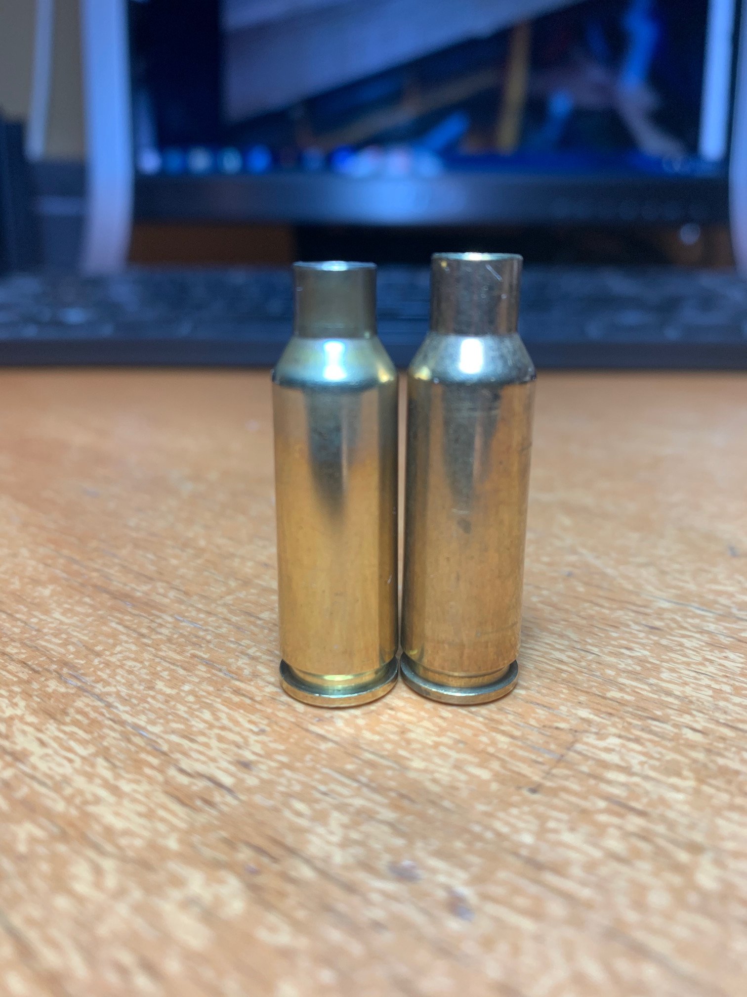

Yep to much lube. Are your dies bushing dies? If so what size bushing are you using?
The neck on the left case looks a little funky. After you trim, make sure you can chamber a case before loading a bunch.
I've got that same damn Lyman that didn't come with the Grendel bushing. Was also impatient and made it out of the 223 & then just replaced that one. That Lyman will give you a blister trimming the Grendel down. It works good enough till I can swing a Henderson.
For reference I'm using a .264 bushing with good success.
Case on left is virgin Lapua 6.5 sized to 6ARC & ready to load. Case on right is 6.5G
