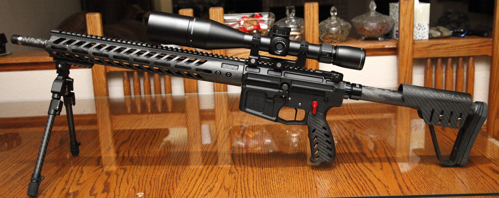

My second build is shown in this thread. It's an obsessive compulsive ultralight build with a Proof CF barrel. We've only 60 rounds of factory Hornady ELDX through it so far. It often places 4 rounds tight with a flier to stretch the group to .75 to 2 MOA, but ELDX factory is kinda like that. This is meant to be a hunting and EOW gun. I'm expecting handloads to tighten it up but I always start with factory for the first ~140 or so rounds, because I want to shoot a new gun right now.
I'm not down on 5.56 NATO, but by comparison, I think this cartridge is the shit. I have the parts in hand to build another, but I'm too busy working and having fun to put it together. I've reloaded factory Hornady brass with good results through 4 firings and have been working up a bunch of Lapua 6.5 Grendel brass. The Lapua seems more temperamental, but that may be my process more than the brass. I'm mostly handloading 109 Bergers and 110 ATips with Lever, CFE223 and Varget.

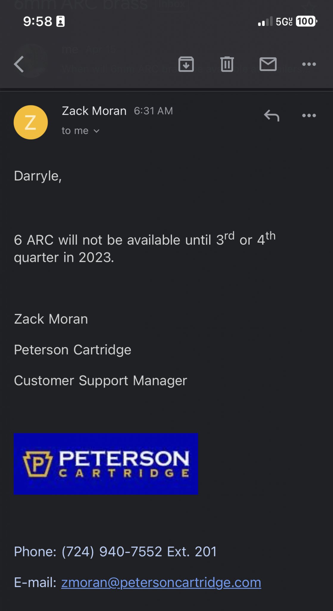

Just saw this. Thought I should share. Peterson Brass will now be manufacturing 6 ARC brass starting sometime in Q2 of this year.
They have pushed it back to 3rd or 4th quarter

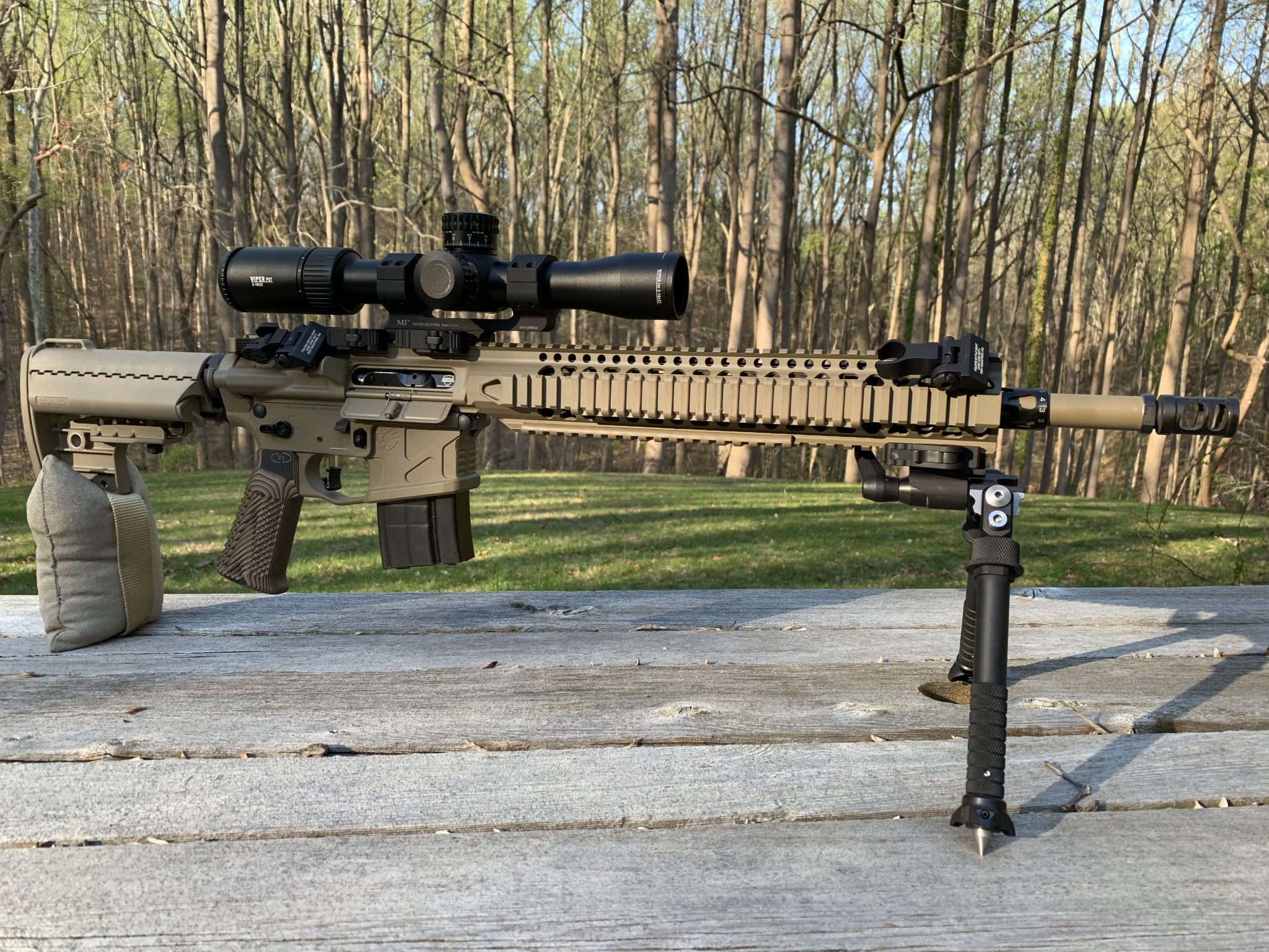

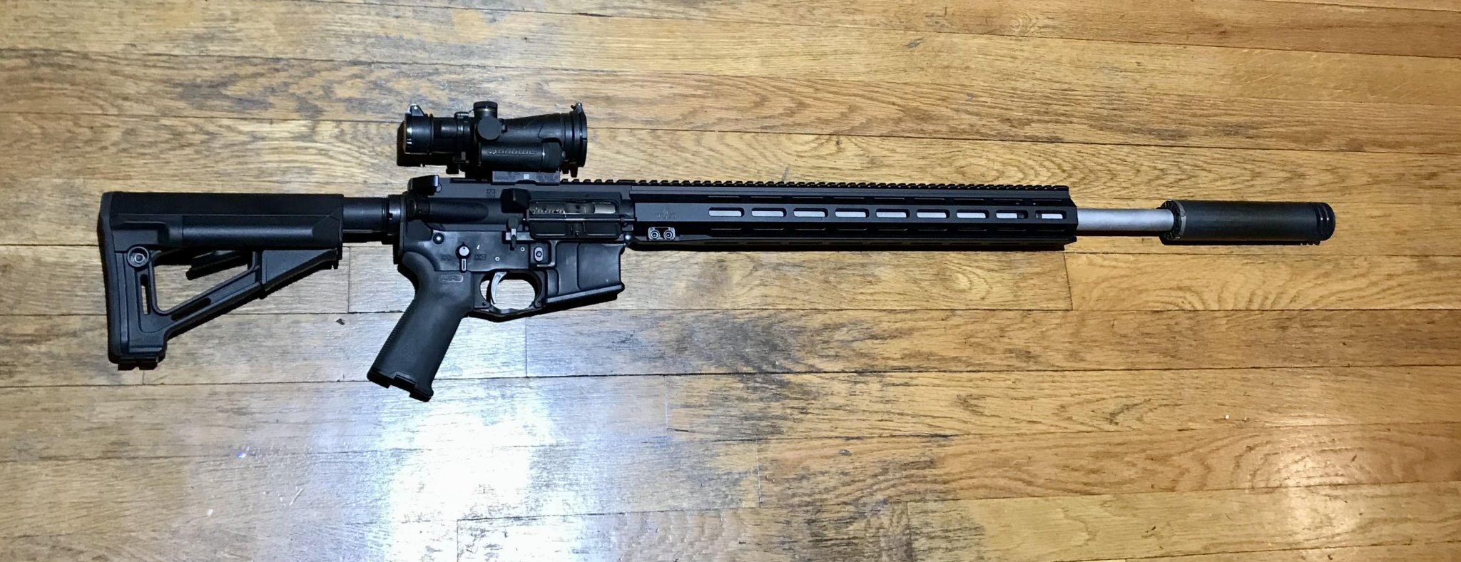

I'm normally very methodical and common sensical about adding a firearm to the arsenal. It's not uncommon for me to plan a year or more before making a buy. But weird times call for weird actions. All the bizarre politicking of the last 2 years caused me to go off on a tangent and throw down a bundle of cash on the parts for this build. I'm glad I did. I have not hunted since I was a kid if you ignore a little bit of varmint sniping now and again, but I'm ready to get back into it and thought a 6 ARC AR would fill in the space for small game and varmint hunting. Plus, if the SHTF, this would work great as a hybrid battle gun that could kill at a reasonable distance. I just got it put together tonight and plan to take it out tomorrow to sight in.
Wilson Combat lightweight billet receiver and BCG
JP bolt
Proof 18" CF
Smoke Composites stock, grip & forearm
Vortex 4.5-22 x 50 Razor LHT mil
NF 20moa Ultralight mount
Javelin Pro Hunt Tac bipod
(waiting impatiently for the Nomad Ti to arrive...)
I have not yet put it on the scale but for sure it's the lightest AR that I own.

I’ve been using the Aero gas block and so far so good. I only have about 140 rds on it though so I can’t speak for overall longevity.
I built with a 22 inch Rainier Match +2 gas, SLR gas block, Toolcraft standard weight Grendel BCG, A5 extension and standard a5 spring and buffer. Runs great with very little recoil. Just breaking it in but accuracy looks to be sub MOA with Factory 108 ELDM's.
Pictured with a Browe BCO just to get the feel of it. Currently wears a Reap IR2 35 Thermal. Whole thing is a heavy SOB but it's a tripod gun for Hogs and Coyotes and I won't carry it far.

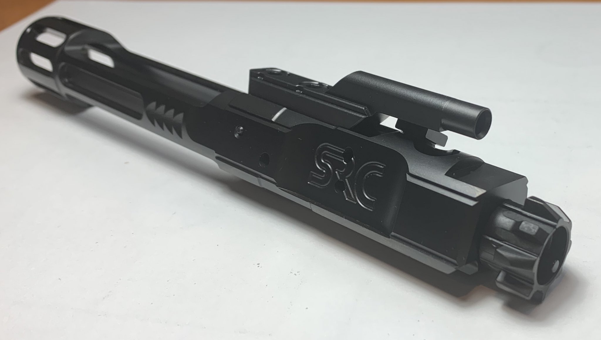

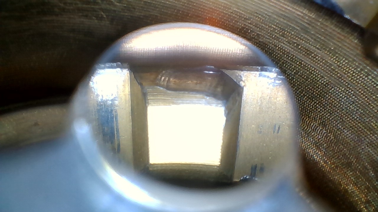

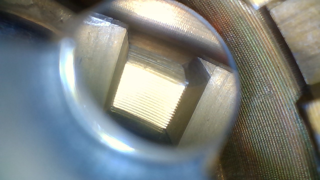

Update to my previous posts about the lug set back on the Rainier UM barrel. Rainier agreed the extension was soft.
Under 500 rounds. Below shows the contrast between the unused extractor lug vs. what all the others looked like @ +.013 head space.
Rainier replaced the barrel. The Maxim bolt went in the trash. I picked up a Sharps Low Mas BCG with the new Sharps Grendel type 2 bolt as a replacement. I'm curious to see how the DLC'd S7 Tool Steel bolt holds up.

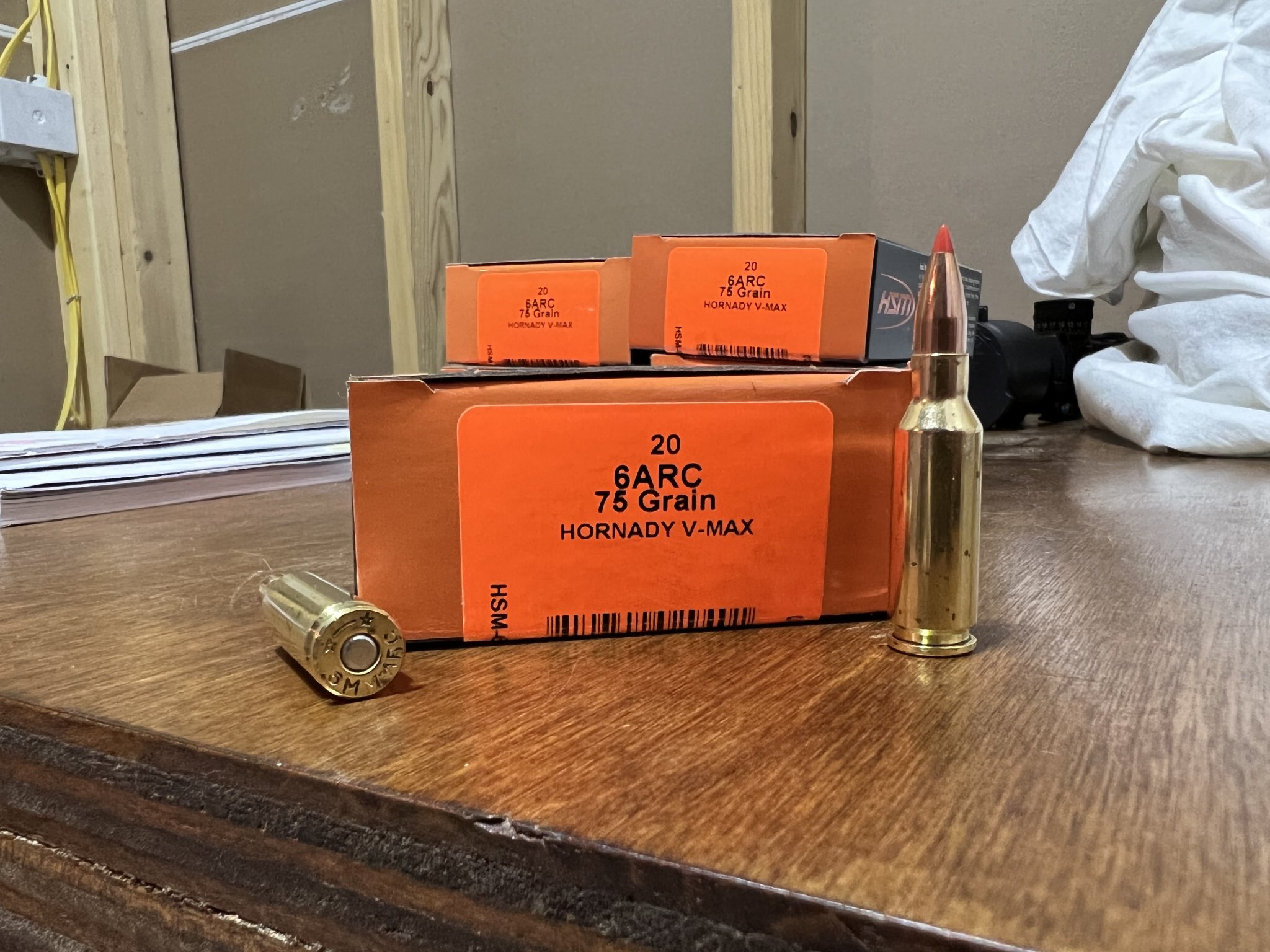

Looks like HSM is loading the 6 ARC as well. 75 gr Vmax, 95 gr SST, and 95 gr VLD. I picked up 5 boxes of the 75 gr Vmax and was happy to see it's loaded in Starline cases.
View attachment 8193670View attachment 8193671
This makes me happy to see. Now we can shoot "factory ammo" to satisfy the MOA guarantee of barrel producers and be left with starline brass. The only down side I see is they don't offer anything in 105-108gr range.
