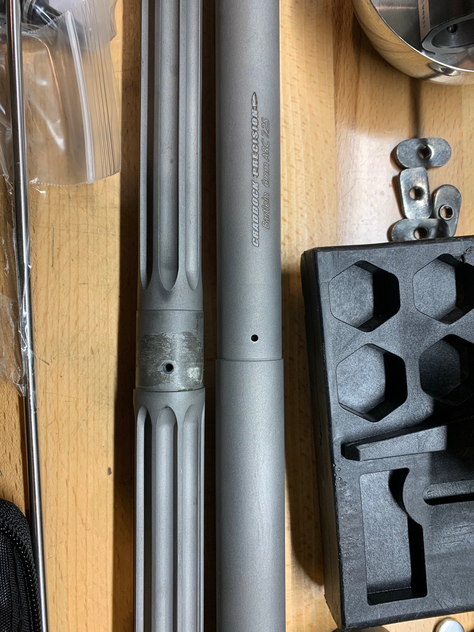

I've got a new Craddock Bartlain 22" Arc, but I keep getting sidetracked. New 22GT build last weekend & loading ladders for that. New Nuke 223 build this weekend & more load ladders. Good problems, no complaints!
Also FYI for the ARC guys. Apparently Rainier & Craddock definition of plus 2" gas is different. Not saying one is wrong but they are different so just be aware if playing musical barrels.
