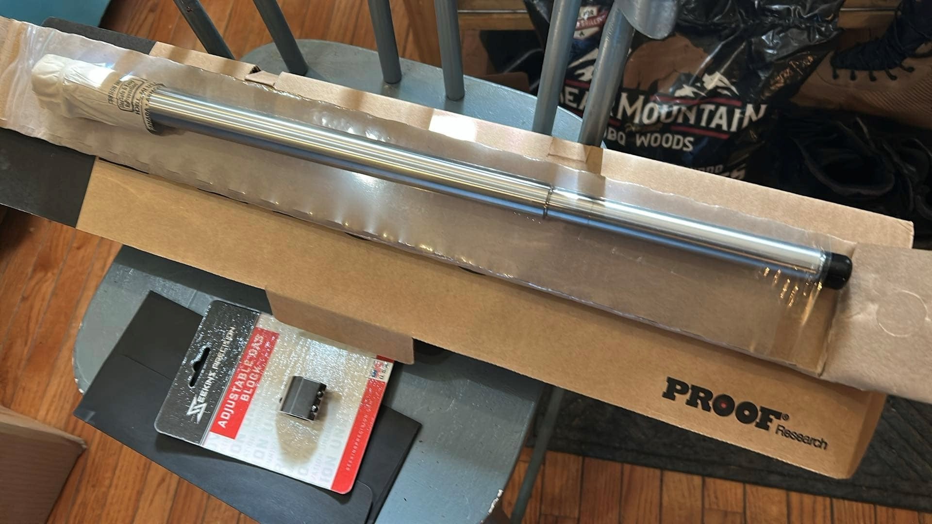

CK-SPR Elite series in 6 arc new barrel 20" proof research​

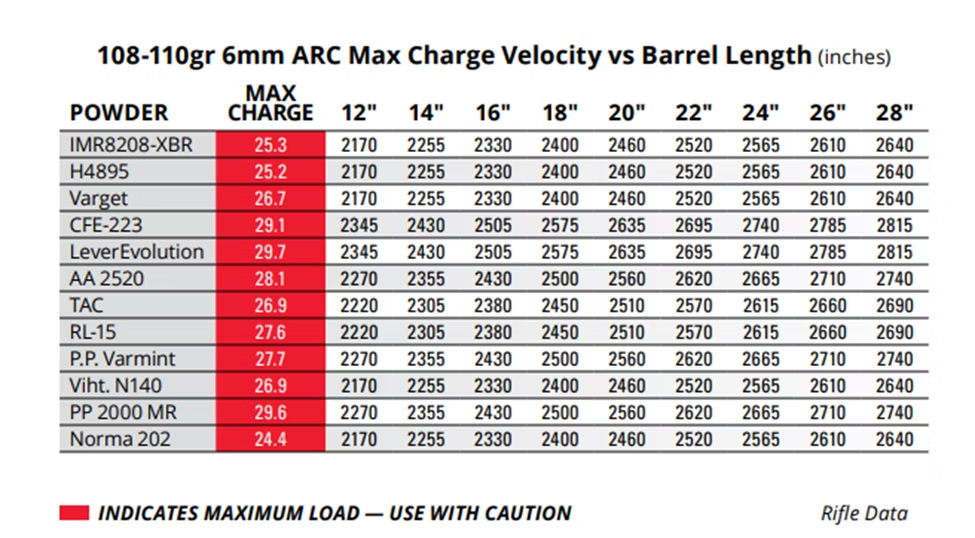

Has anyone been able to clone the 108 eld-m factory ammo? Id be really curious which type/burn rate powder they are using. Im guessing an extruded single base?
Pulled some apart to try a Mexican match with an 110 ATip and it looked like CFE223 to me. Similar velocity to my loaded 110 ATips and CFE223 also.
Reactions: LRBuck and WeR0206
I haven’t tried, been grabbing cases from Battle Hawk Armory whenever I start running low. They were selling 20 rd boxes for $23 a few weeks ago & even less by the case.

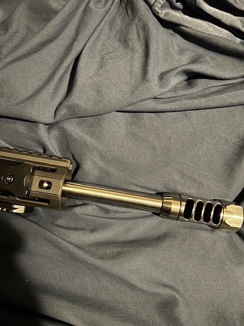

Another buddy of mine just put his 6mm ARC together with an 18" Proof stainless barrel.
Avg with 108gr ELD-M is 2523fps. Seems to shoot well, nice ejection pattern.
I just put one together with an 18” Proof barrel and SA AGB. Went full mass jp bcg and bolt like proof recommends. Also used scs from JP which is just the standard weight and I can’t even get the bolt to travel out of battery when I shoot. Gas is wide open. It takes considerable force to get the bolt to release and eject the shell by hand. I should be getting my borescope today so I can verify alignment. Hopefully it’s something dumb I did. Also running the huxwrx flow 6k. Not sure how long I’ll be using it though. It’s super loud.
You might need to try a different or lighter buffer, but I had the same issue with the JP bolt. I switched out their gas rings to standard 3 piece rings and that solved it for me.
I am running the same kit for a year now on both a 18" and 14.5" and I haven't any issues like that, something is off.
Agreed. 20 inch proof with heavy JP variable BCG and ‘H2’(?) SCS. VLTOR Upper if it matters. I’d say a gas issue, but if it has issues when you hand cycle it, sounds like something isn’t lining up? You don’t have the buffer spring retainer in do you? I ran an unintended experiment with it in, and that will increase the resistance…

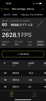

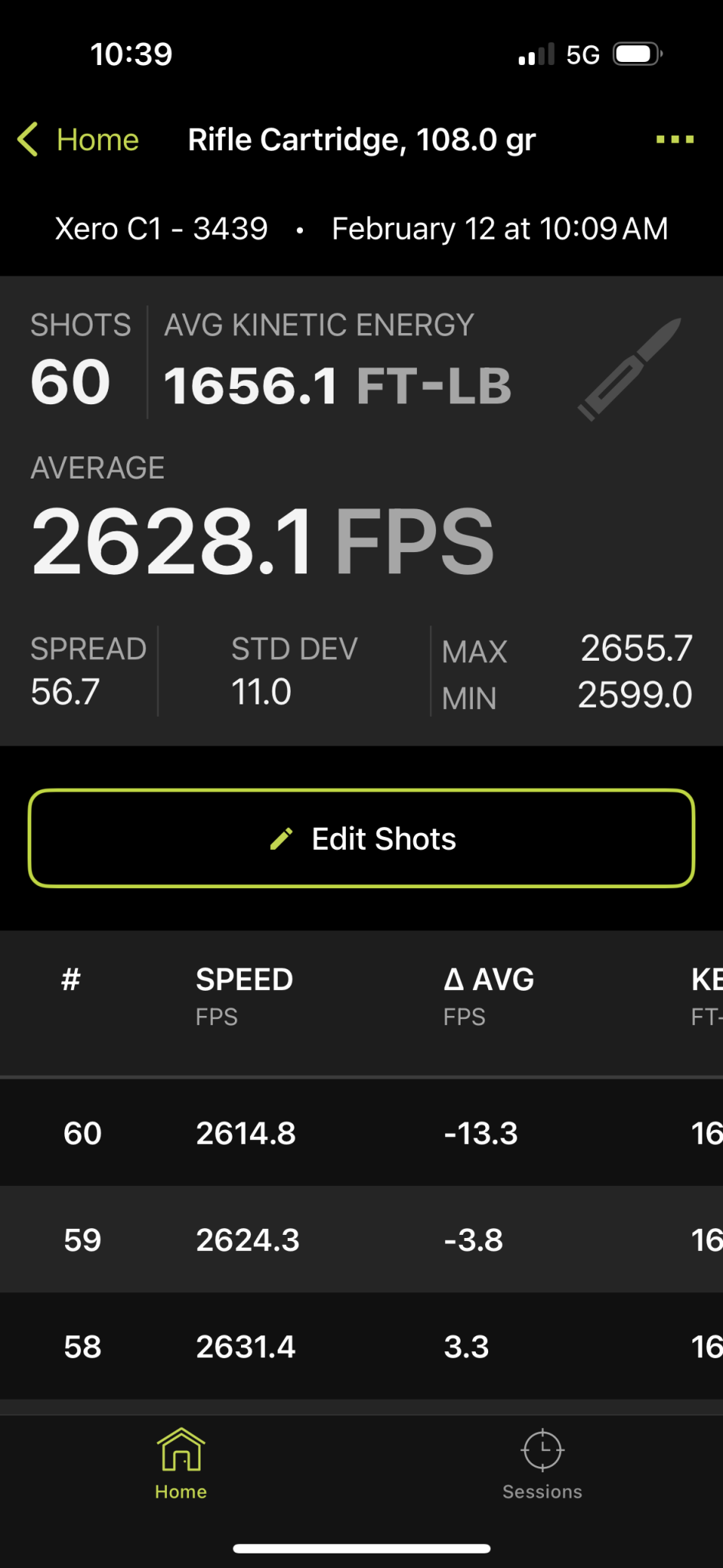

After the break in shots and a total of about 20, with Hornady 108 ammo out of a 20 inch Proof, I’m getting 2566Avg, ES29,S D11.8
It was an I’m an idiot issue. Definitely a gas problem though. It’s resolved and somewhat tuned now and it’s very nice.

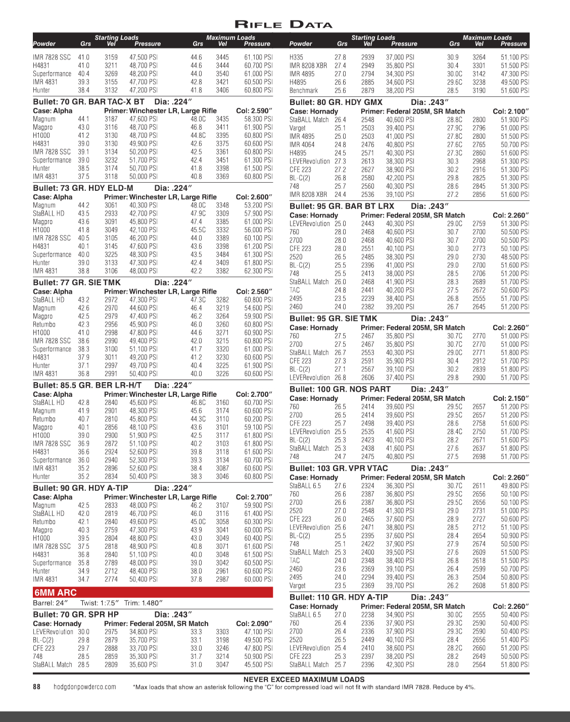

Just re-barreled my old SPR with a 20" Grendel Hunter 6ARC barrel. I've got some factory ammo to shoot first and might load some after that with Lvr powder/105's.

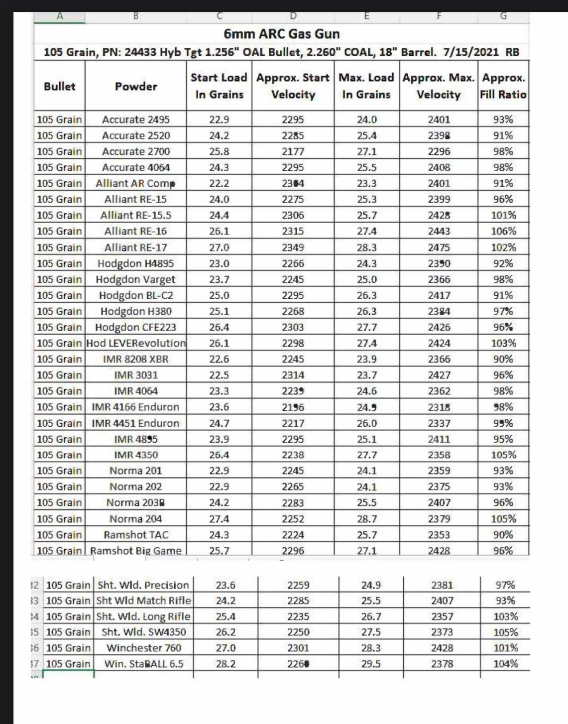

Is anyone else using Staball Match and 105's with any luck? I've scoured this place and the web and not found much info on SM. I know it will be slower than Lvr but I can't seem to find where many have even tried it.
Reactions: Jdowns0415
I personally haven’t tried it but here’s various load data (for gas gun 6 arc) with staball:
