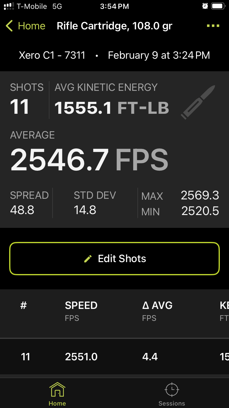

SD 12.5-18.5 in similar weather 1 month apart this fall. 64-72 F.
Garmin Xero 18” Proof CF AR
This was all one box. Not sure if the 12.5 I posted previously was a different lot or same honestly.
72F 40% 30.36in
Hornady 108 ELDM Factory
2504, 2506, 2480, 2472, 2445
2505, 2492, 2488, 2480, 2463
2498, 2517, 2511, 2513, 2510
2479, 2511, 2487, 2508, 2494
SD 18.5 ES 72 2”

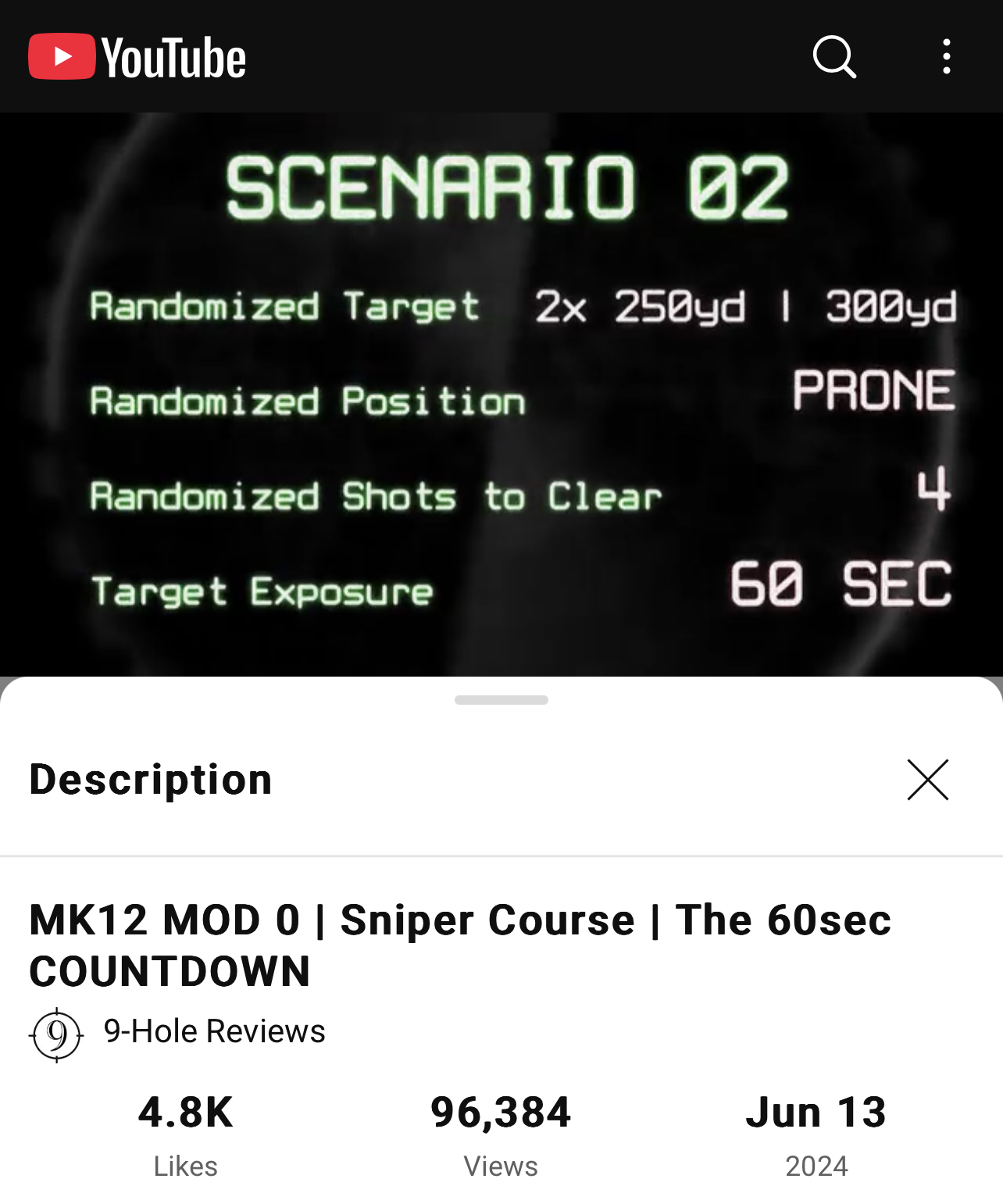

They have a newish format called Sniper Course / 60sec COUNTDOWN that has a randomized time (aka “target exposure“), distance, shooter position, and shots needed to clear.
I think they have to make it harder, but I like the idea.

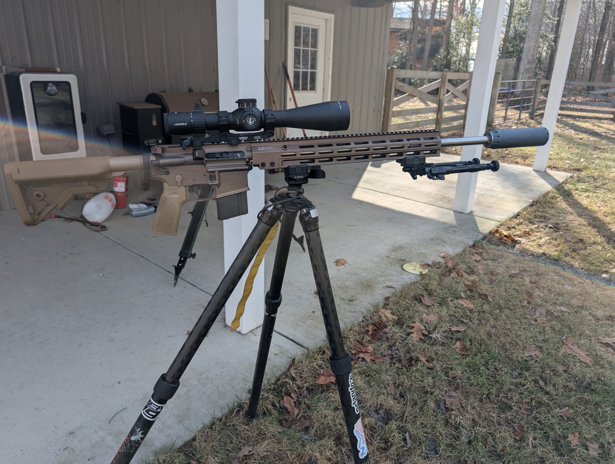

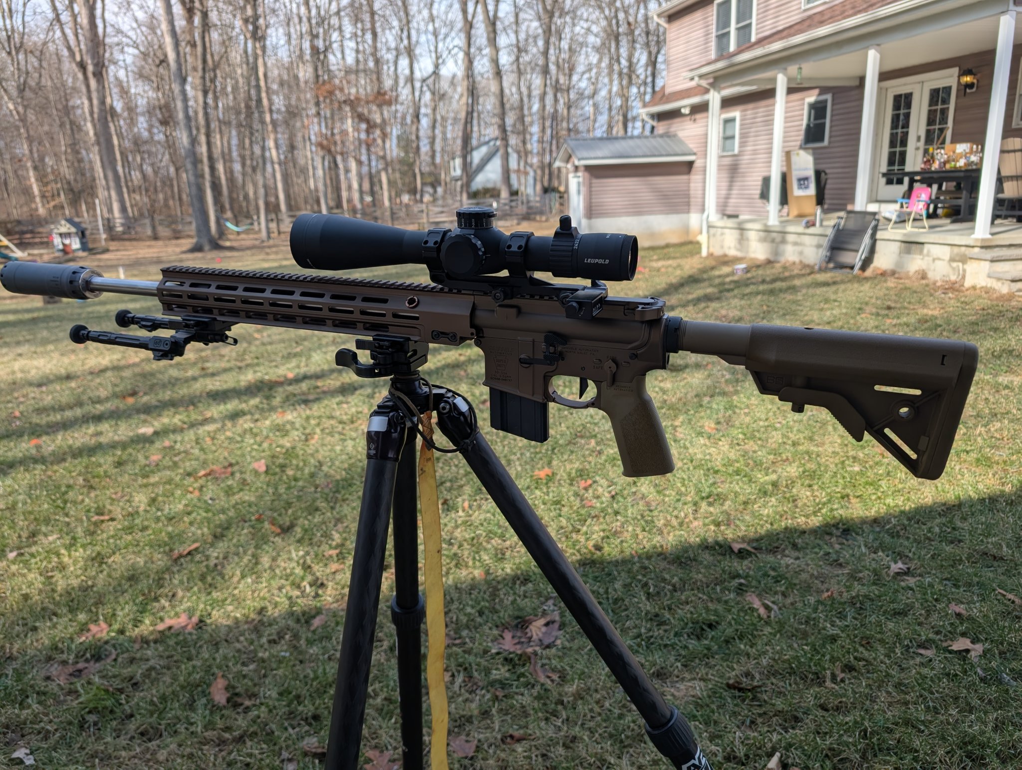

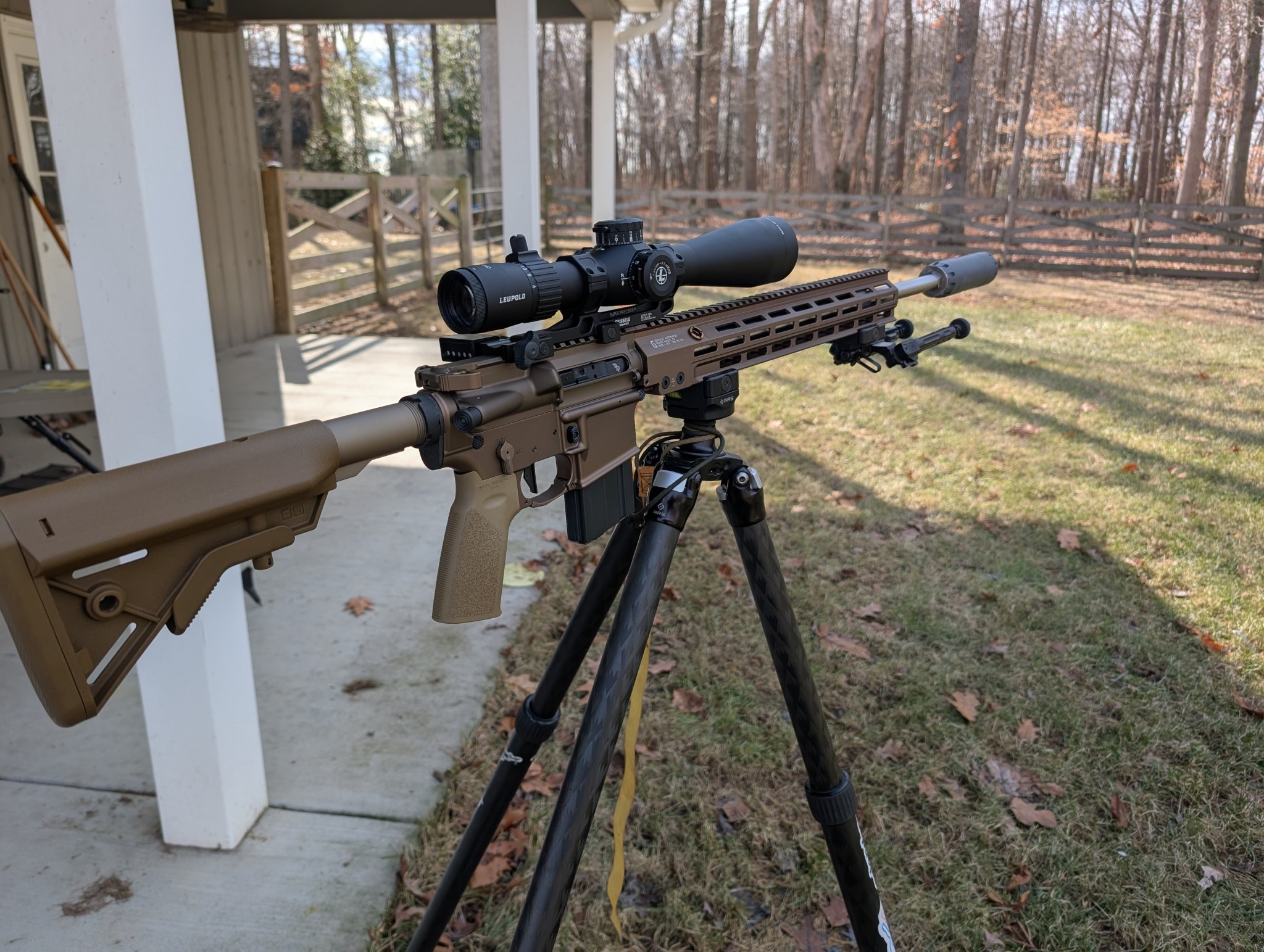

I posted this in an unpinned thread so I figured I'd share it here as well. I have purchased all the below parts just need to wait for them to arrive then assemble!
Mainly a BCM and Geissele build with an FN stripped lower and Magpul Furniture.
6mm ARC build:

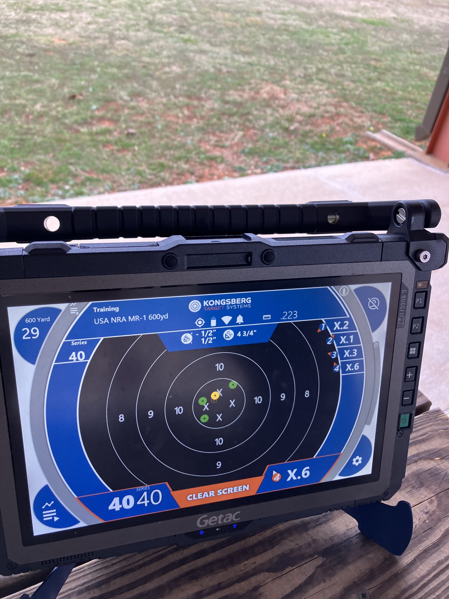

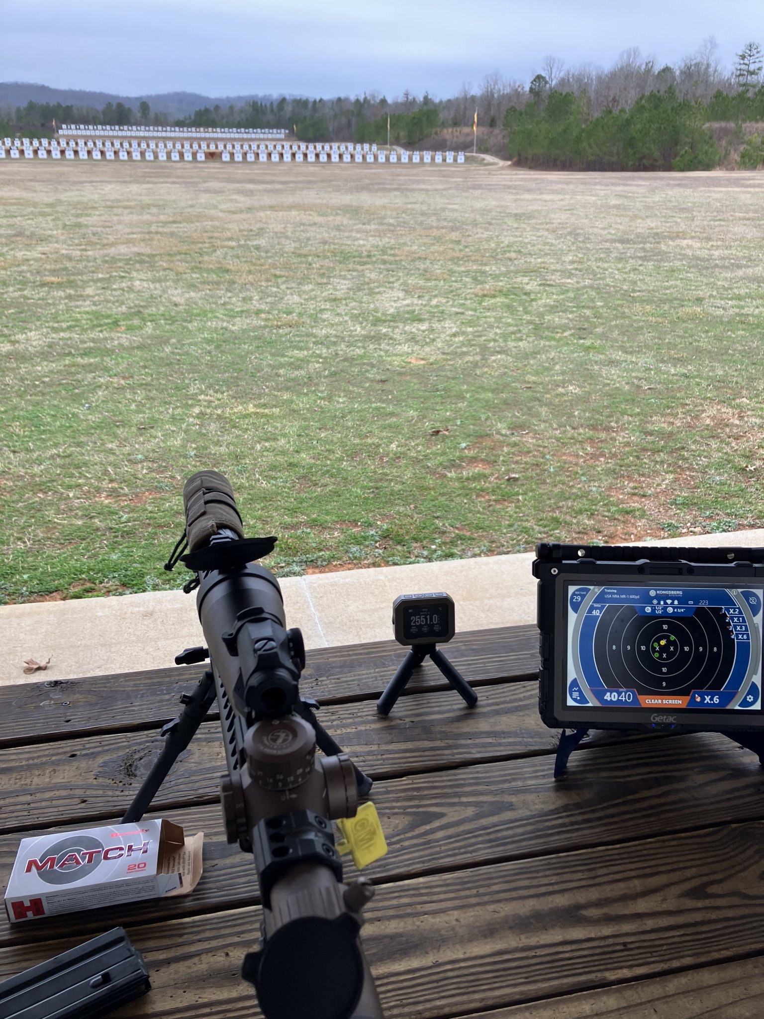

Probably would’ve been sub MOA if your gun was level.
JK. That’s a great group with that optic at that distance
Yea I couldn't really see the hits all that well at that distance, I just kept putting the center dot on top of the shoot-n-see pasty and sending it. Went down to check it in person after that string and couldn't believe it. I am not surprised as it has shot 5 and 10 round .500" groups at 100 in the past so the accuracy of the setup is there. I was verifying zero on a few different guns today and unfortunately covered it up with another target before taking a pic. My thermal rig was off by nearly 6" which was alarming.
