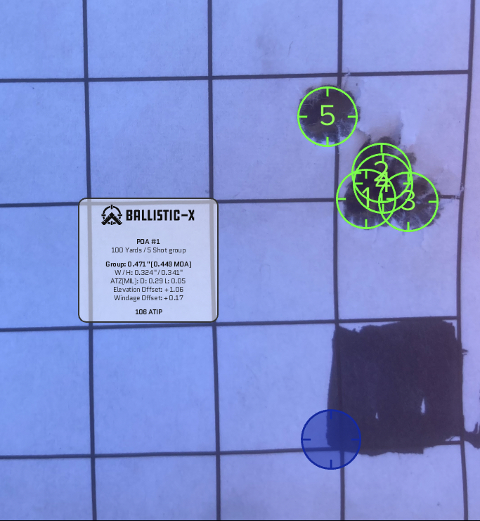

Has anyone tried the 106 gr Hornady TAP ammo? I realize there may not be a drastic difference between them and the 108's, but the guys on the 6prc page love the 106 blems in the prc.
I’ve shot a good amount of TAP. Velocities are similar to all the other Hornady loads. I haven’t gotten them to shoot as well as the ELD-M, -X or Black. I think 1.5 to 2 moa at 100yds. if memory serves, where I see .75-1 moa with the other loads.

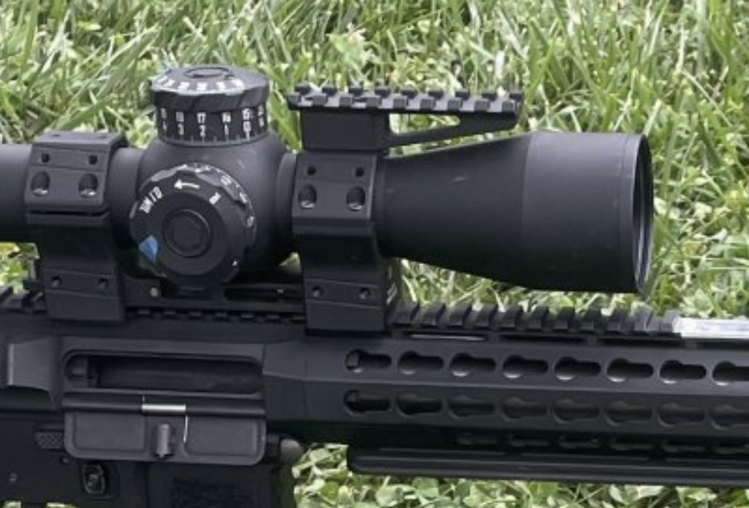

Looks like I won't bother with buying any TAP then. Should get my GFR in today. I haven't been this excited about a semi auto ever. I'm going to mount my zco 420 on it, any reason I would need a cantilever mount? I have a standard Badger COMM 1.54 mount for it and would really like to not have to buy another mount.
It’s not a mono receiver your gonna need a cantilever
I was getting a .4m high POI change from the 108s out of my suppressed 16” Proof.
Accuracy was not as good as the 108s, the TAP was 1-1.2 moa.

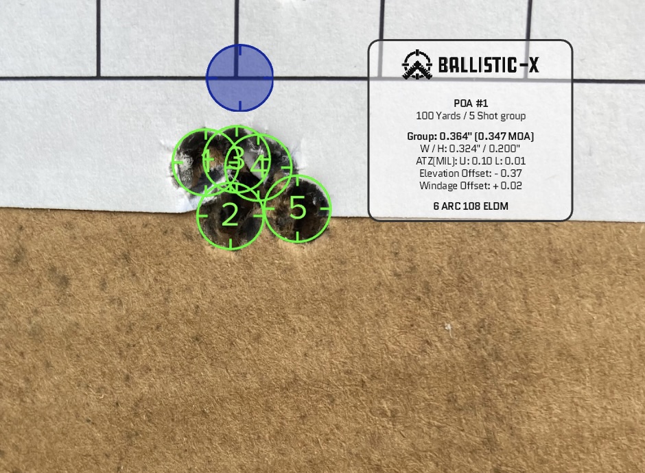

What’s everyone’s accuracy with factory 108 eld ? What barrel and length ?

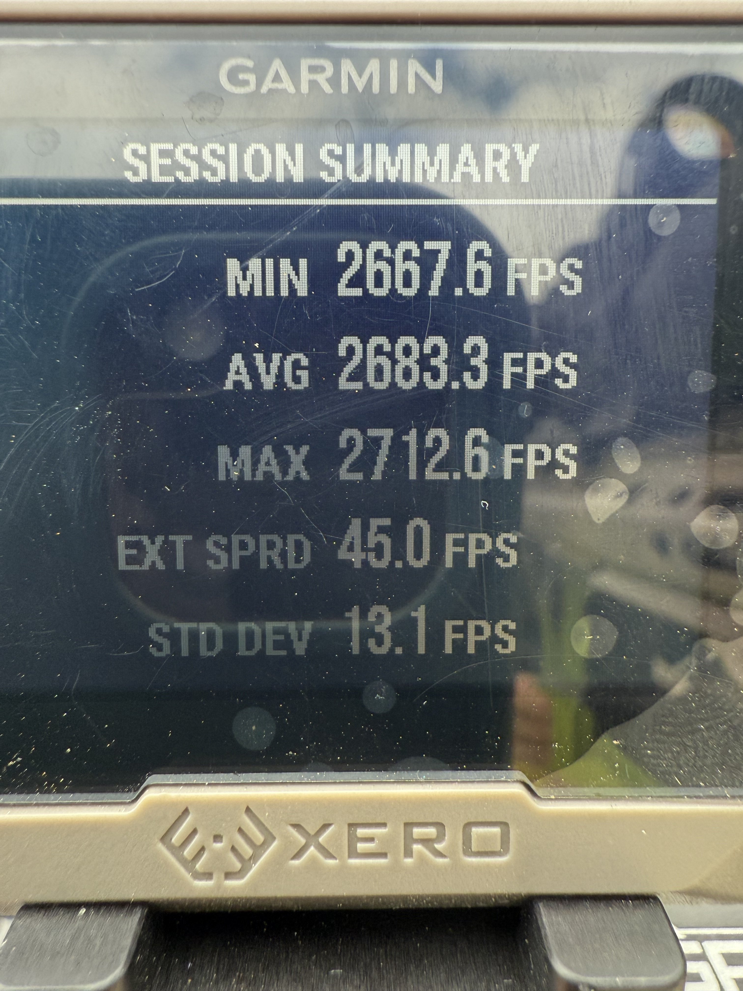

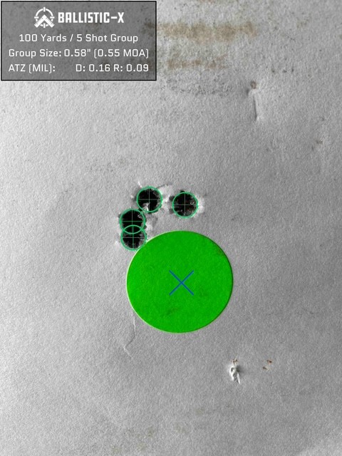

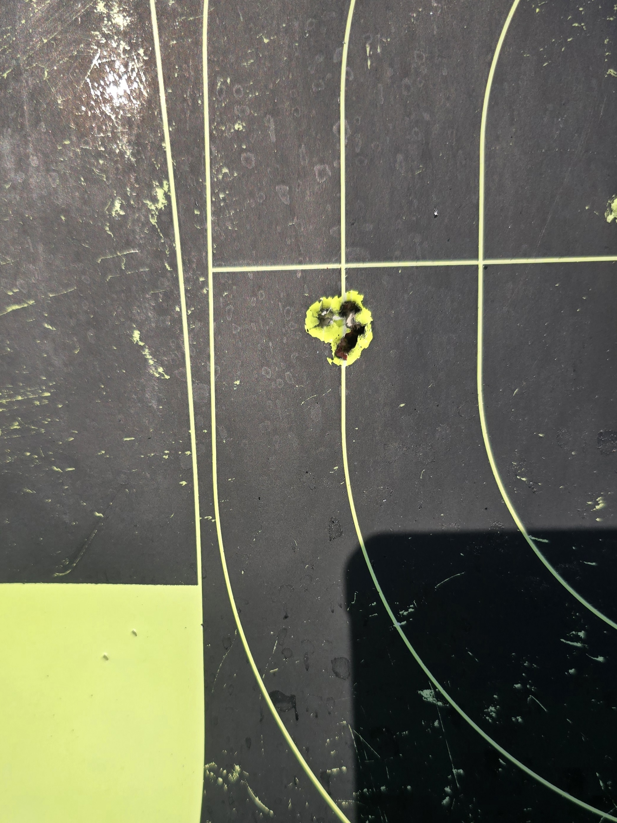

I'm getting less than 3/4 MOA with the lots I have in a 20" Proof carbon barrel. Typically around .55-.6. Good accuracy all the way to 1000 yards so far. It was stupid impressive at my local range at 600 yards. I really enjoy the rifle.
I hope when I start loading I can match it or exceed it. Velocity has been 2680-2690 as the barrel broke in. It started around 2640-2660. SD around 13, ES in the 20's for the small amount I tested.
Wow, those are pretty good velocity numbers, I would have expected something in the low 2600's for a 20"
I have an 18" that I'm about to run some factory 108 eldm's through and will post my results here once I get to the range.
Since I handload I will likely try to clone this factory load so I will pull a few apart to take a look at the powder, primer, etc..

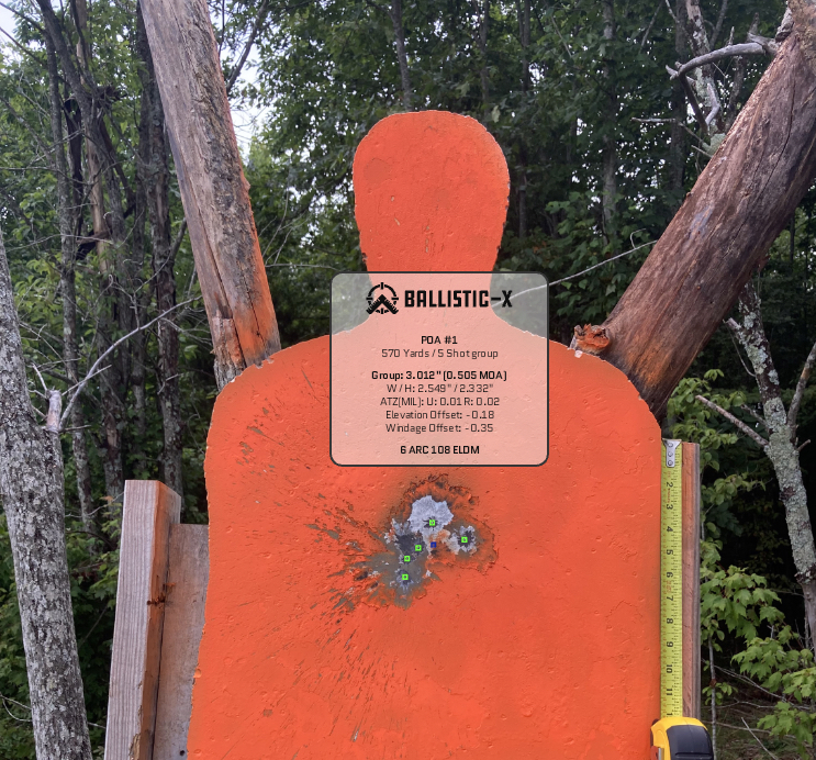

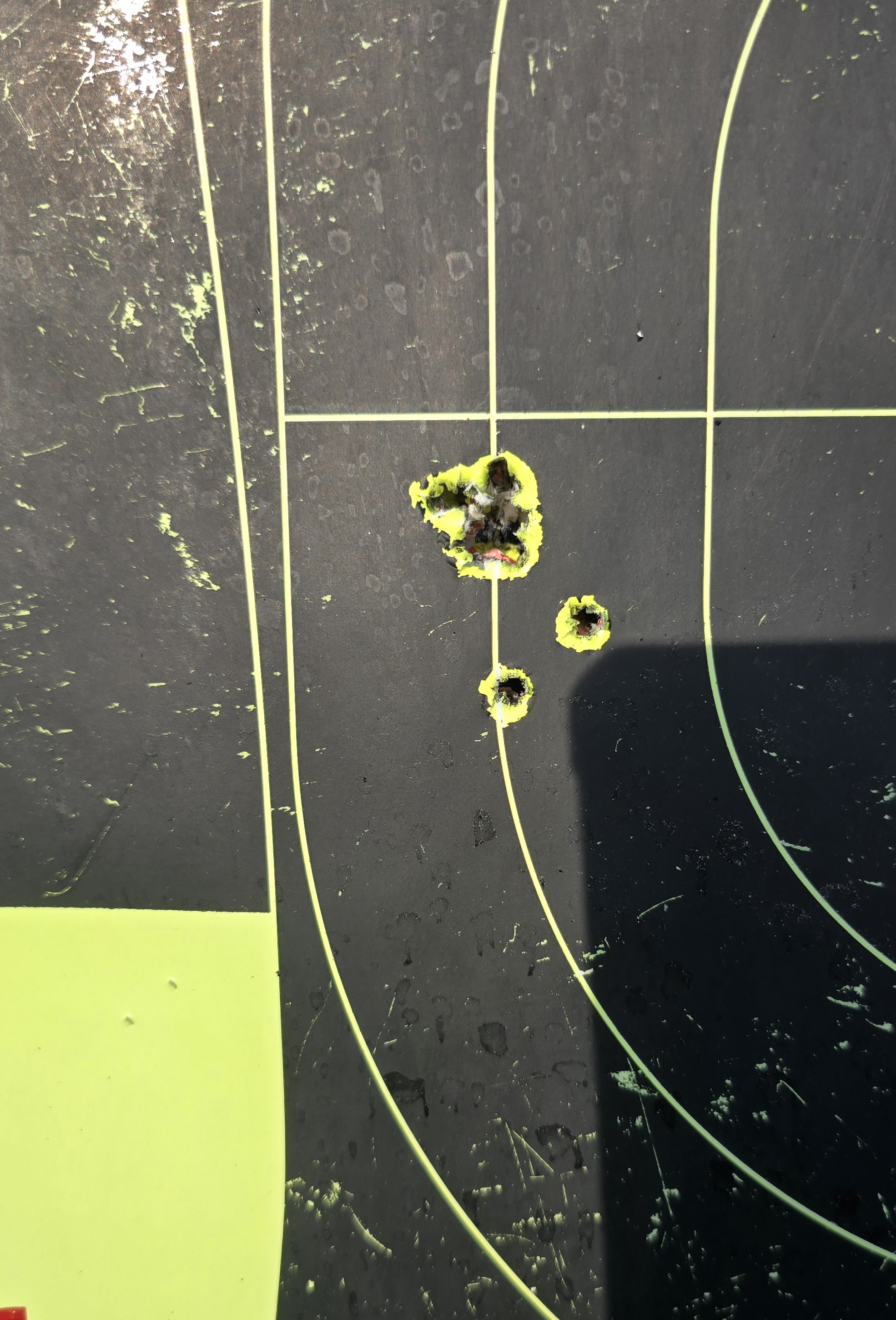

.6-.7 out of my 16” Proof. I’ve noticed that every 100-150 rounds I need to run a snake through it because it’ll open up to around 1 moa.
I’ve gotten some stupid good groups from some cases of the same lot.
This is from a scope tracking test:
T
That’s pretty incredible for factory ammo. Mine likes 103 ELD-X like that but hand loads.
That’s the best group I’ve gotten, definitely not the average. I usually will do a tracking test and check zero on paper, so I don’t usually shoot a lot of groups at 100.

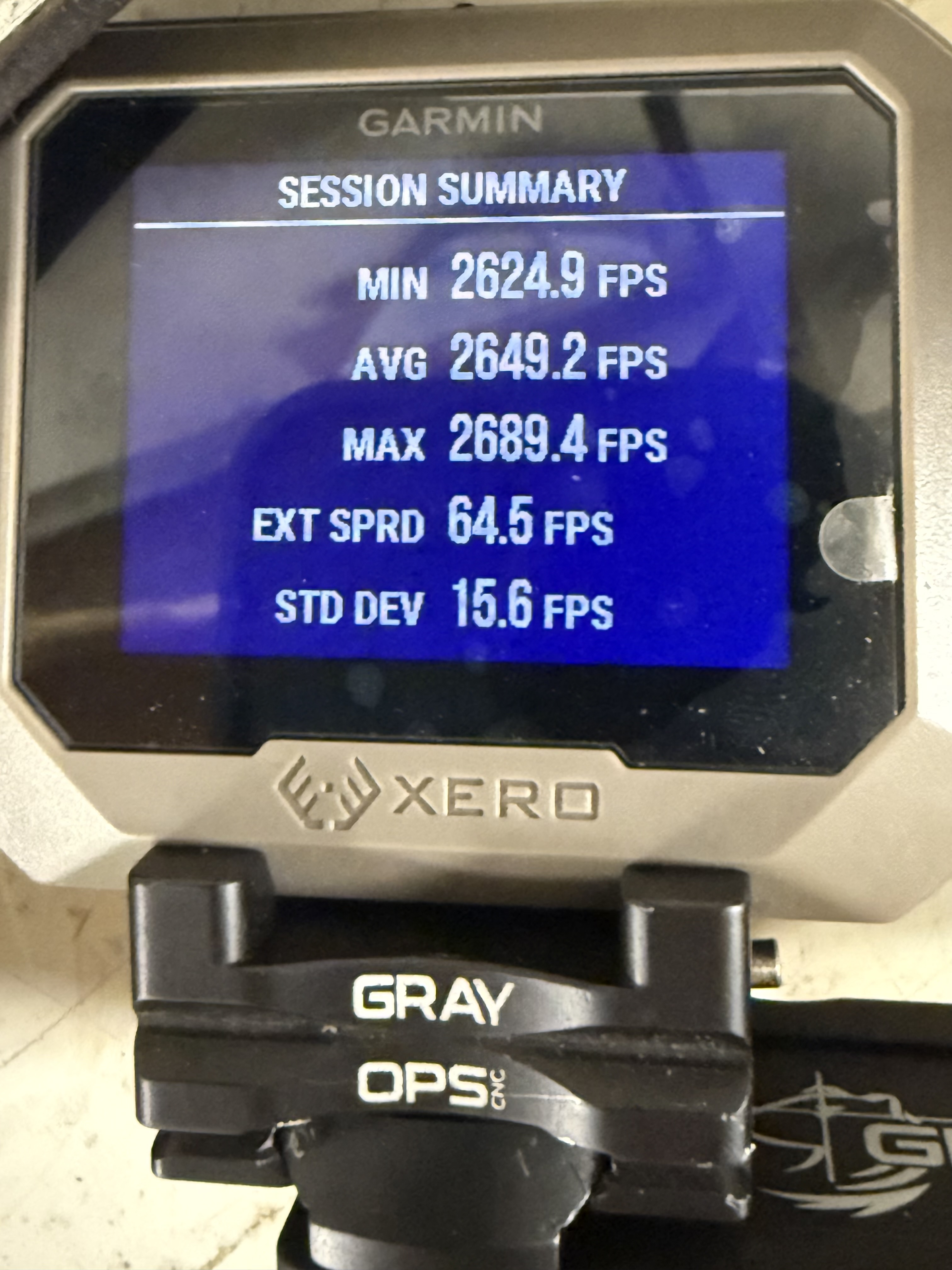

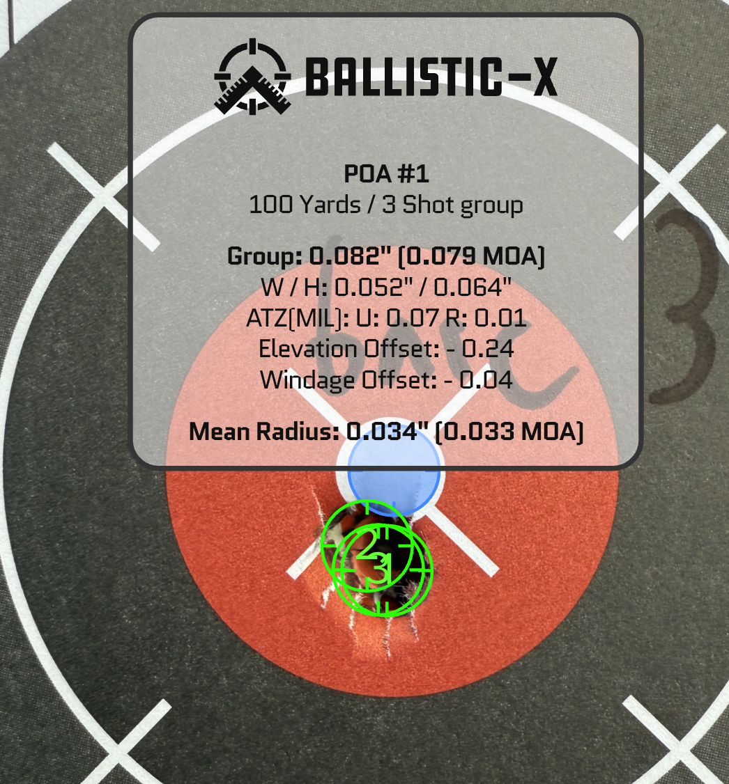

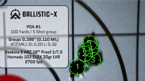

I found the pic of one of the early groups on the rifle. It had a whole 20 rounds through it at this point. Warm barrel with a Magnetospeed hanging off the end and a one minute call to cease fire on the line at the range. Not bad for a slightly rushed group at the end of my trip.
I have let some of my workers shoot it on a trip to 1000 and all of them had no issues. This was the first time any of them shot past maybe 50 yards. I warmed them up at 730ish yards first with no issues, then straight to 1k. So to let a handful of novice guys get behind a rifle and give them wind calls and watch every round impact the target was cool to experience. I wish I took pics of some of the groups at distance. Usually 5 shots about the size of my fist at 1000 yards on a zero wind day. With wind I had a little more spread, but very impressive for a gas gun and factory ammo.

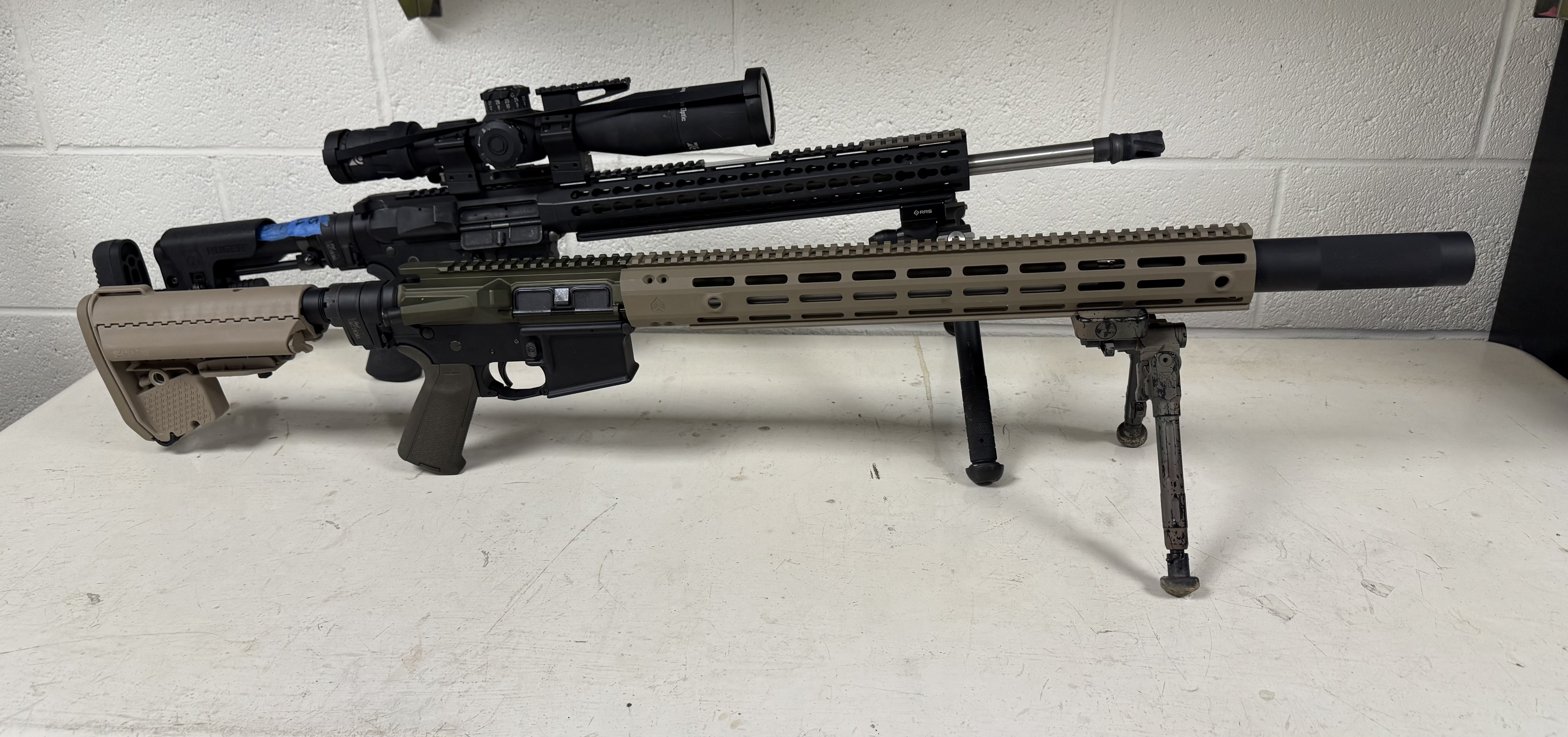

Got the area 419 mount in, what a superb piece that is. Still waiting on small parts, but it looks at home with the clipon. Gotta get this stupid brake off and then I can mount one of my cans up and shoot it.

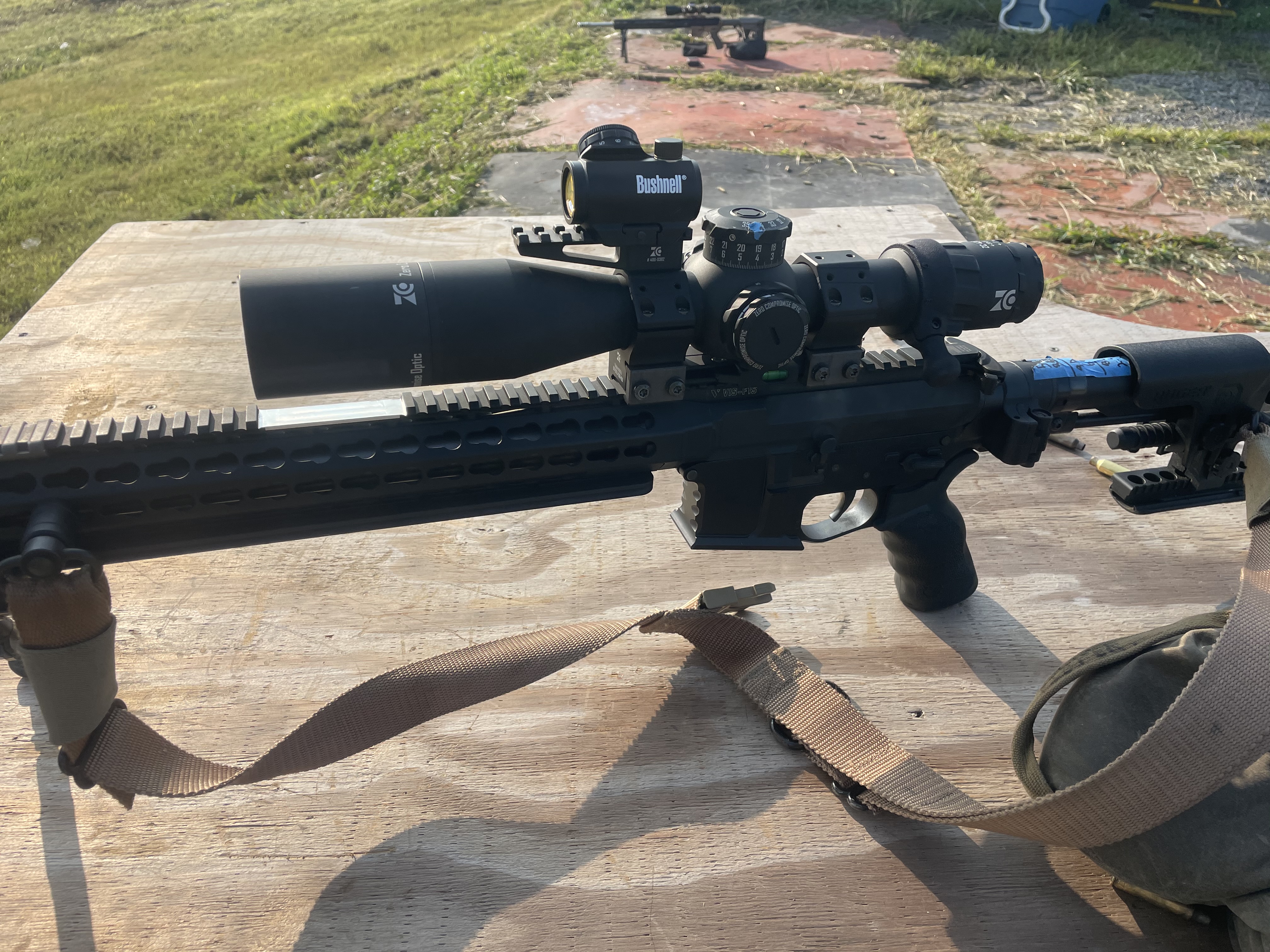

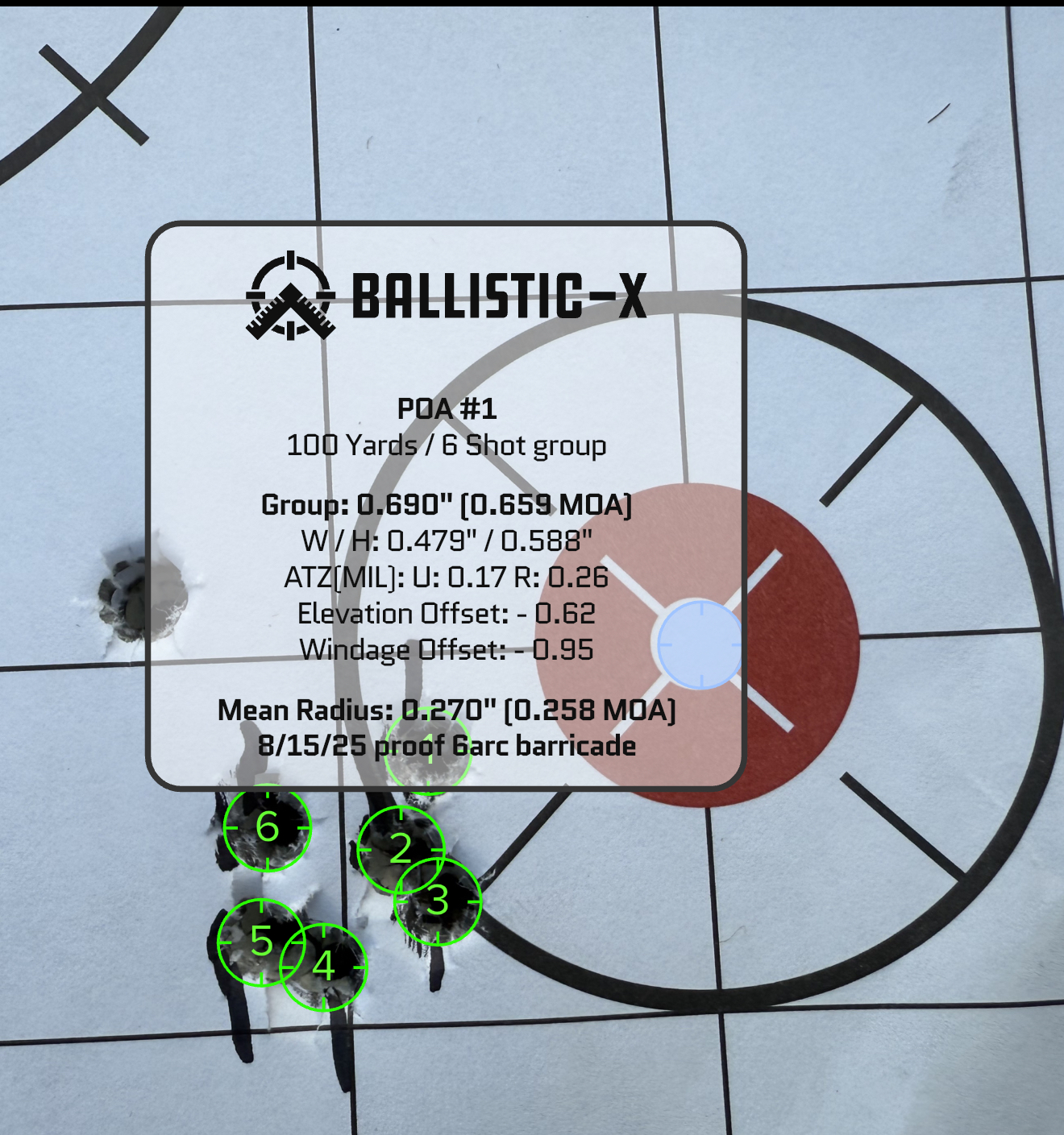

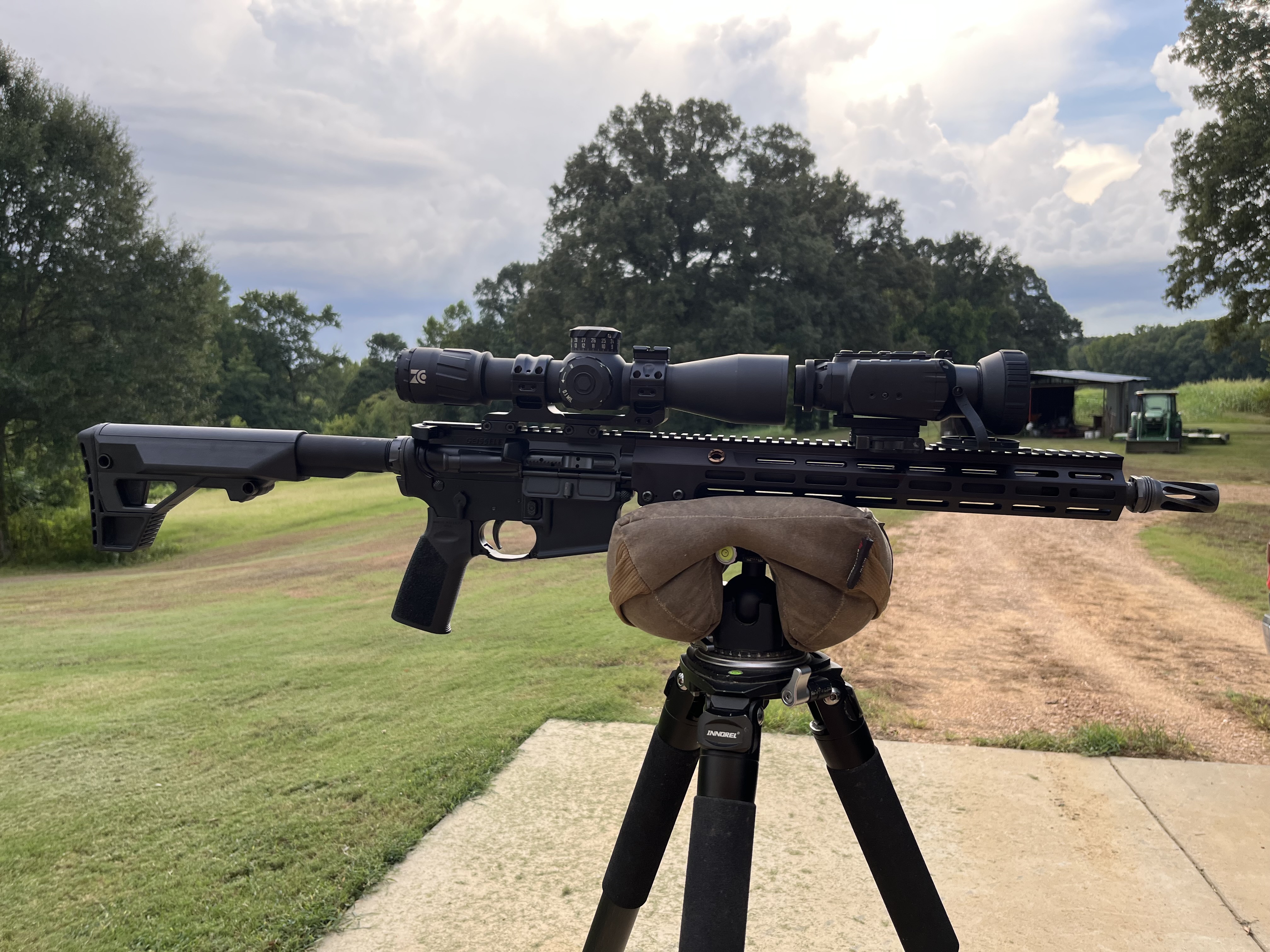

Hornady 108 seems to produce acceptable groups. And that’s with an upper I pretty well destroyed / tweaked putting together. Was expecting 5-10” groups . 22” proof.
6 shot group was off barricade. Ignore the varying poi, zeroing and lack of fundamentals.
18 shots and a range visitor

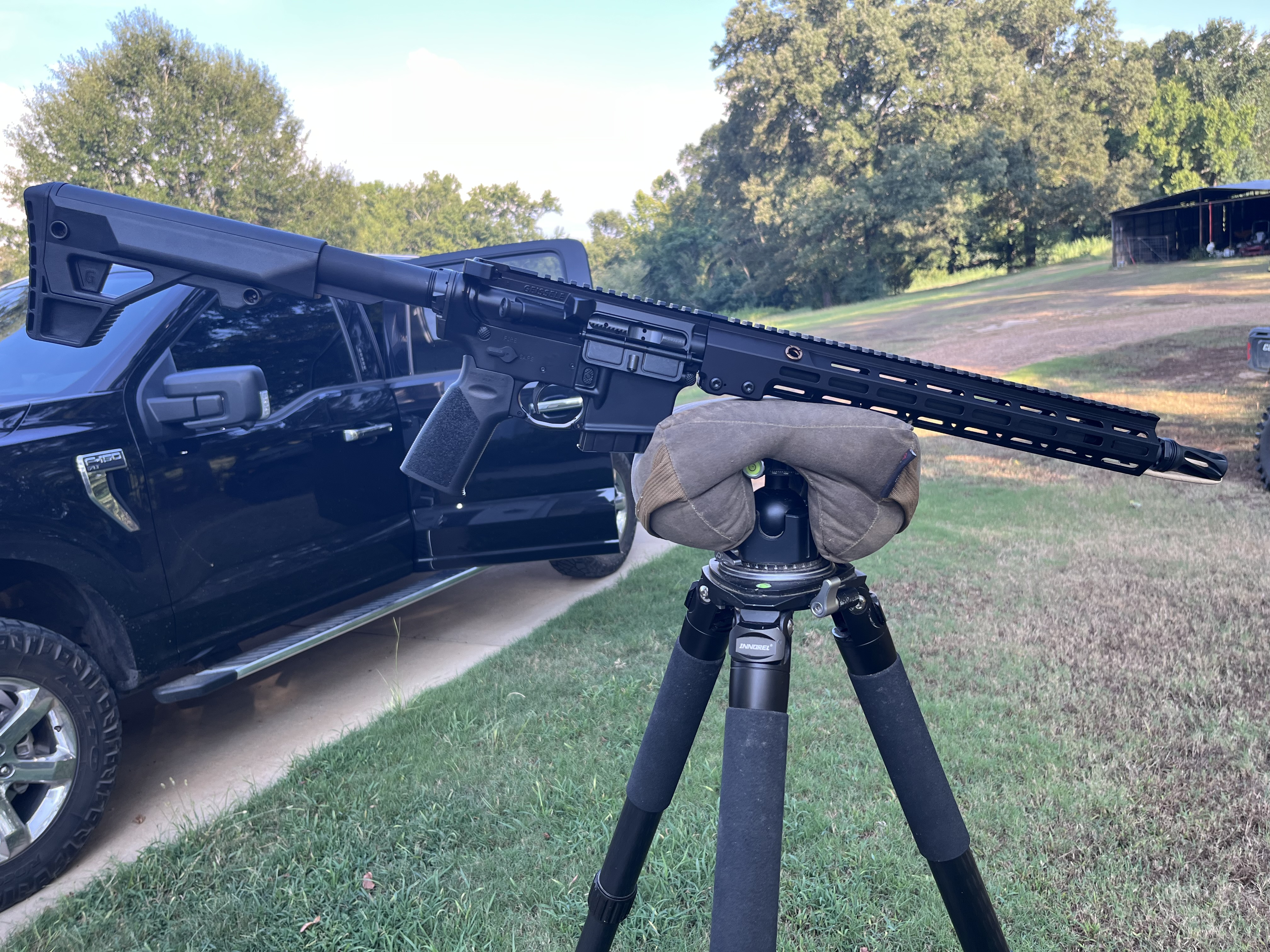

Got it running good with dominus. Everyone talks about 6arc being unreliable. What can I do to avoid issues / test it so I don’t have issues at a match.
Running Geissele mags
Got the AGB adjusted so it locks back on a empty mag then I added 2 more clicks

A 13 shot string this time with dominus to add to the data :
It was a bitch getting mine removed. Fairly certain they just went to town with red loctite. Did both heat and water not knowing WTF they used and reading other people's trials doing this.
Also fucking Hux uses 1 & 1/16" wrench so you're gonna need a larger crescent or hopefully you go larger than the standard 1" wrench found in most sets.
