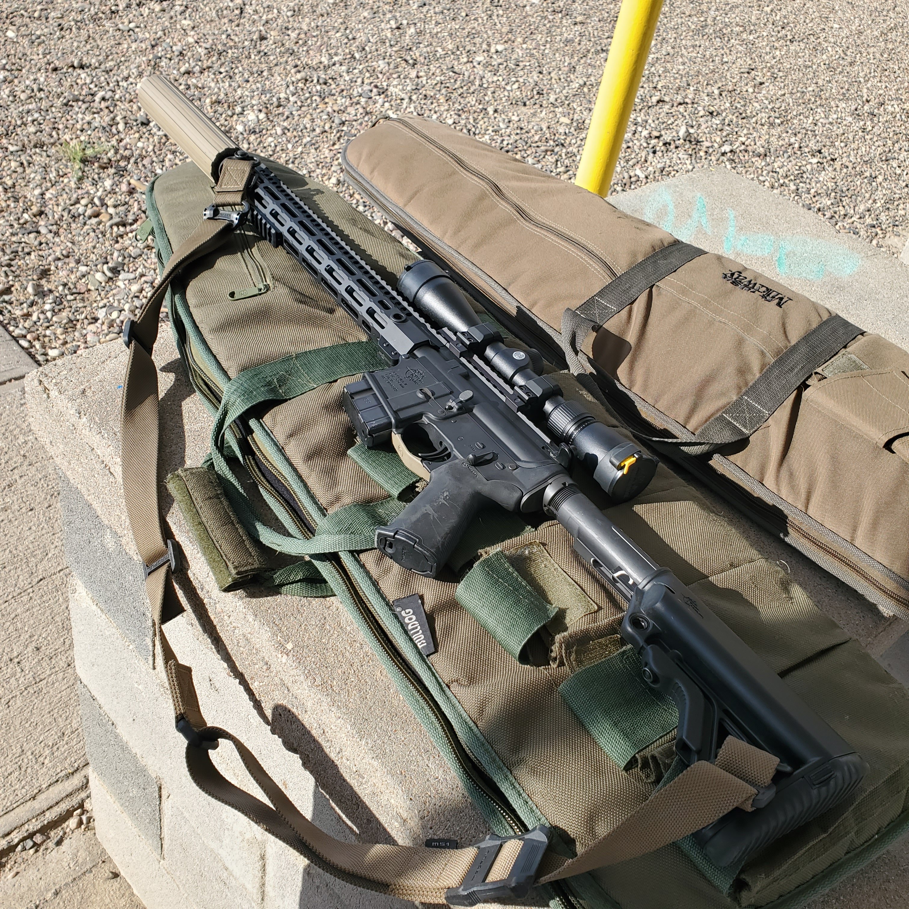

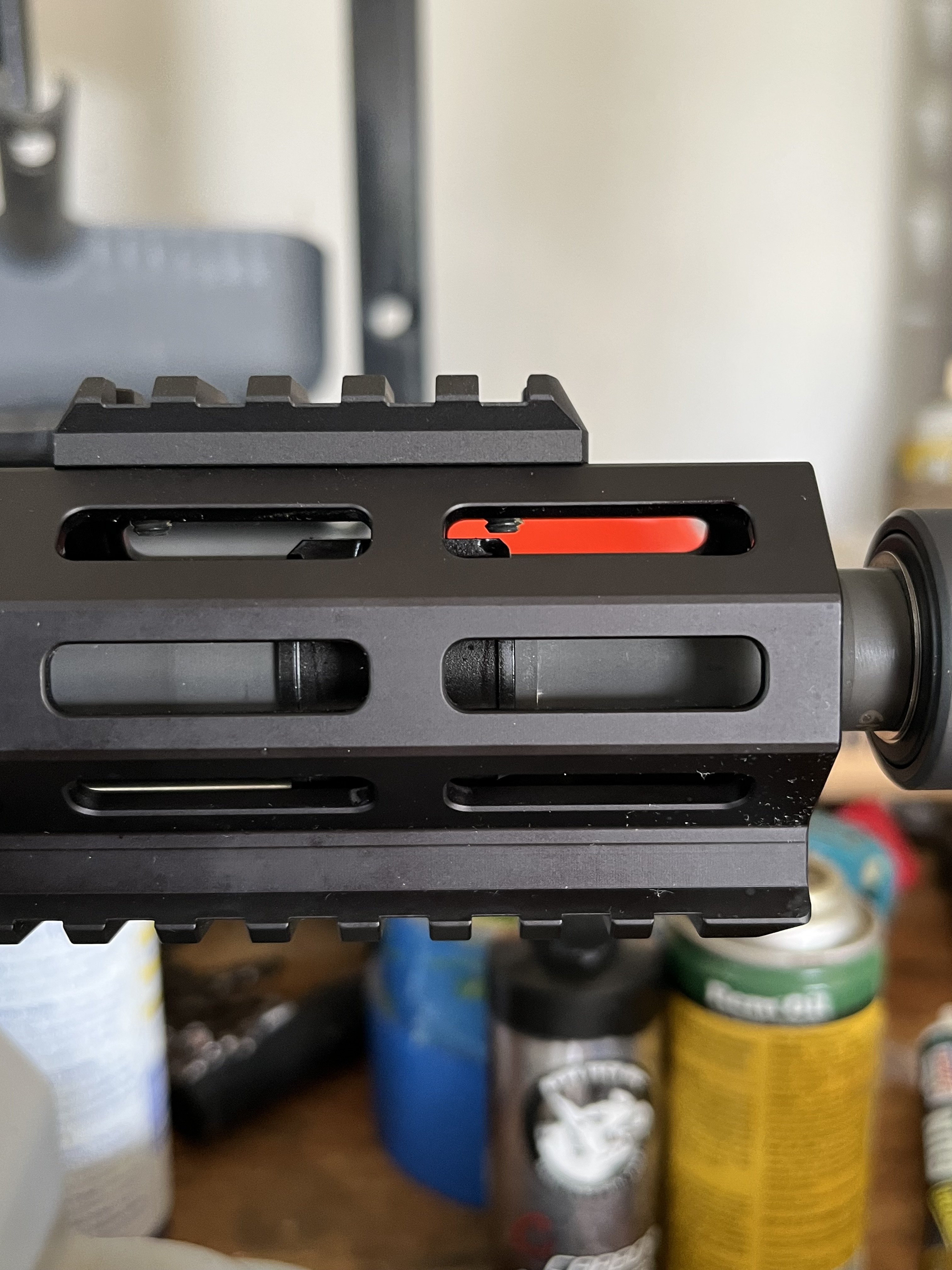

Opinions please. Rifle is upside down in pic. Installed this mlok pic rail for the bipod mount. Seems to be minimal clearance between the mlok screw and gas block. With the bipod installed if I push down on the barrel only I can feel it make contact, but without pressure there’s no contact. Is this going to be an issue, or do I need to grind the screw down or move the mount altogether?
I’d move the mount or get a shorter screw
Looks like you can loosen the mlok screws and slide the pic rail forward a little and then tighten it back down.
Just fyi, I have started running my bipods a little further back on the rail of my gas guns(toward the receiver)and I still get great stability but have noticed slightly less deviation on target than running the bipod all the way out toward the muzzle.
You can use a 7 slot pic rail and completely bridge over the gas block. Its what I ended up doing to make sure no contact.

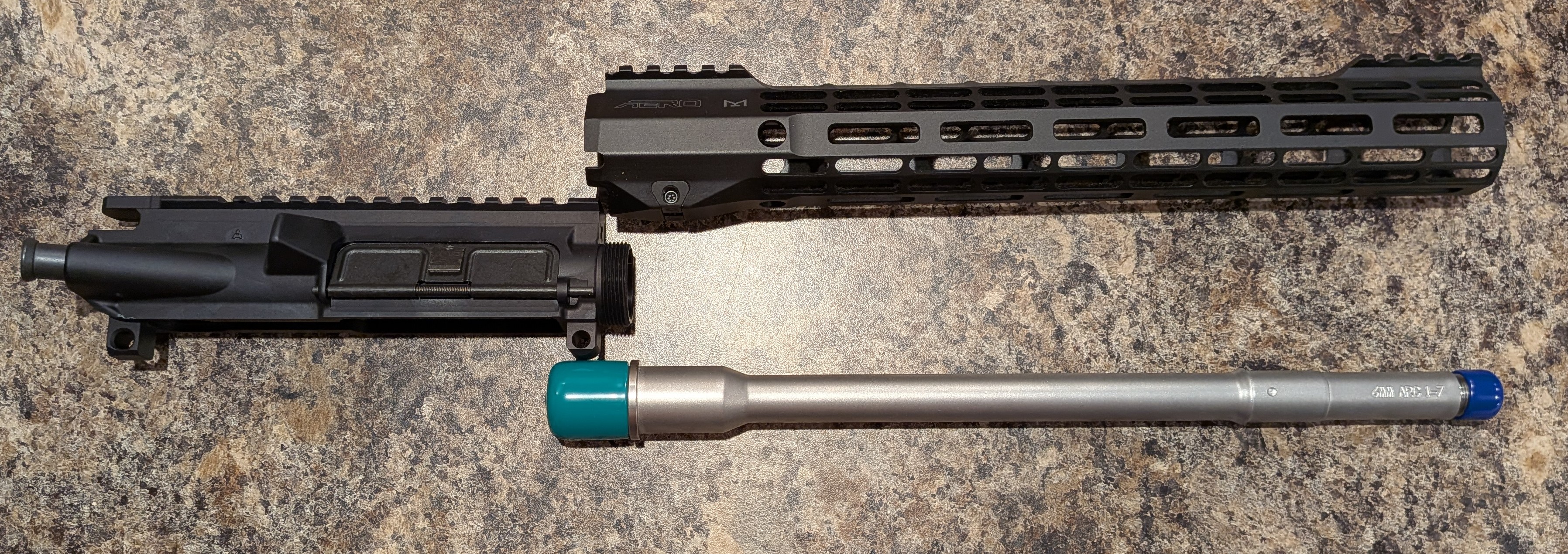

Finally got the X-Caliber 13", mlgs lightweight barrel that I ordered back in March in. Going to try a BFK Mod 0 thermal fit upper and reuse a 12.7" Aero handguard I have on this one. Waiting for Rexus Ultra bolts to come back in stock in the next few weeks and should be in business.

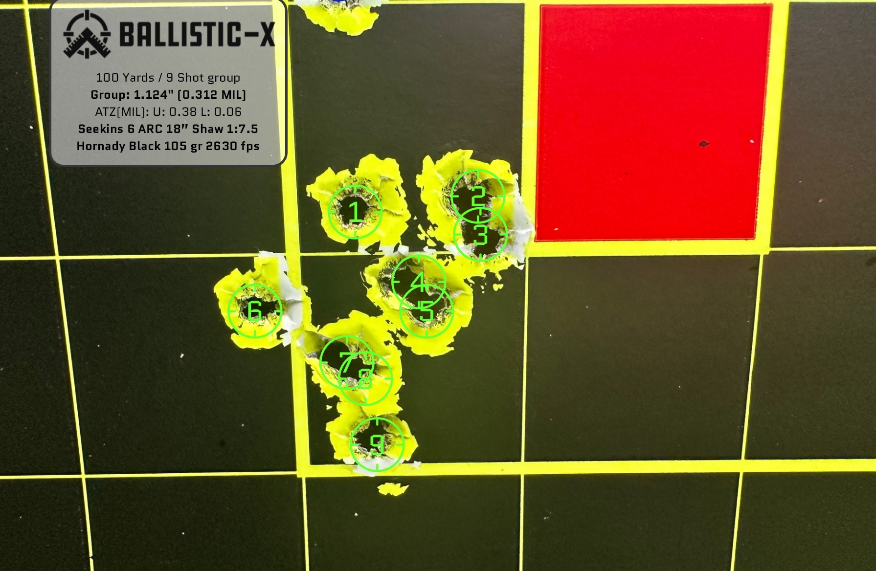

Mulling over switching my current 20" barreled 6.5 grendel AR-15 to 6mm ARC. From what I gather the brass can be sized down to 6mm ARC? Looking to do a 18-20" barrel threaded for a brake and prefer heavy profile but fluted. Is it worth switching as I currently reload and have all the dies and brass for 6.5 grendel. What barrels are available for the $500-$700? I'll want to buy a matched barrel and bolt. Thanks
Is it worth switching for what reason?
Check out Patriot Valley Arms AR barrels. 6 ARC , they will flute it for you and you can get a matched bolt. Not sure about the "HEAVY" profile though.
Craddock RTR. .875 gas journal. Or Bartlein but that would likely exceed your budget have a longer wait. My experience with 3 RTR barrels, 18 and 22” has been excellent. But agree with supercorndog - for what reason?

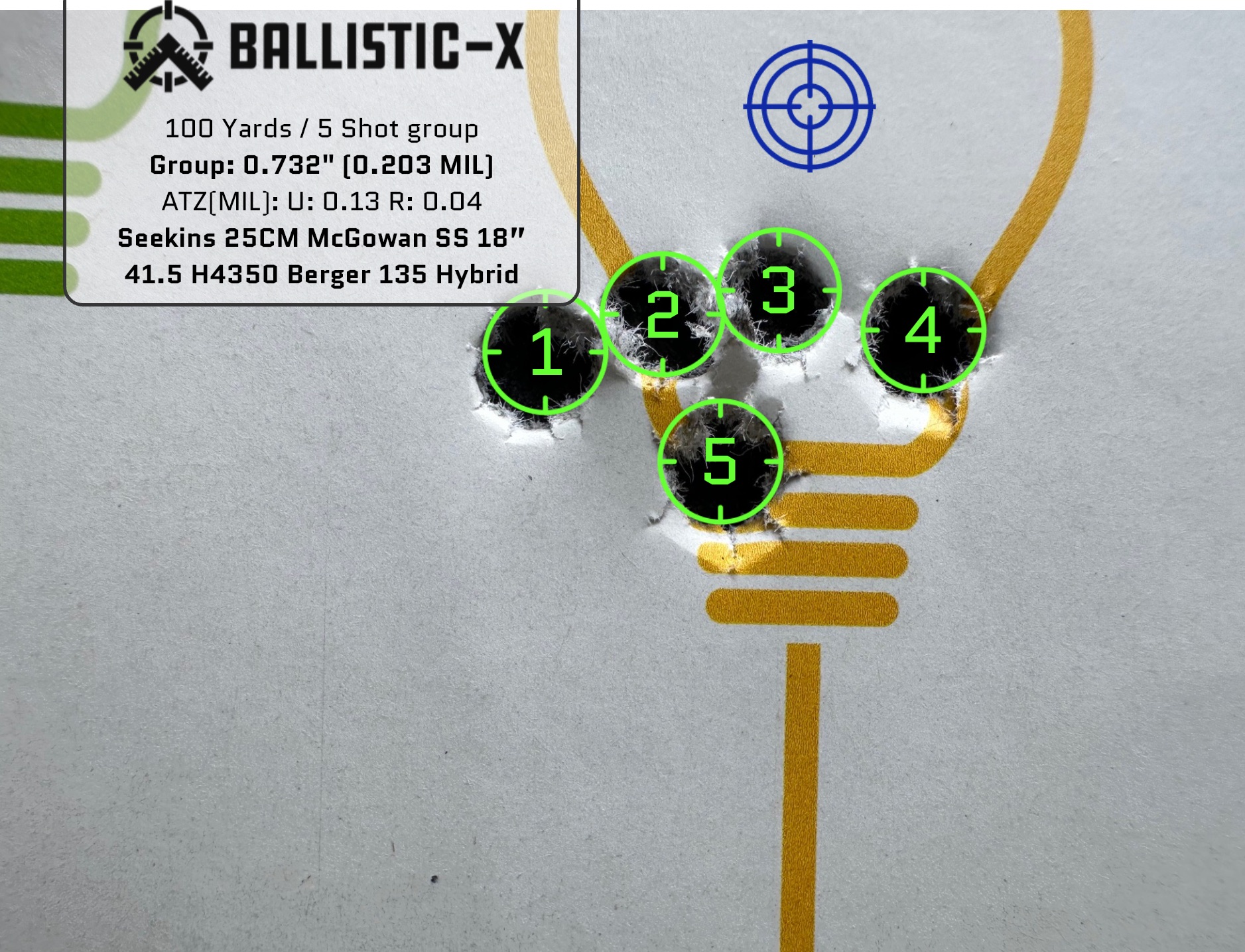

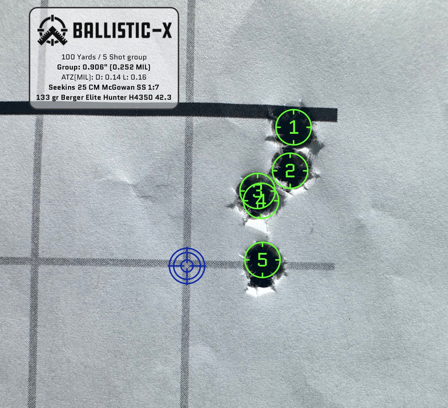

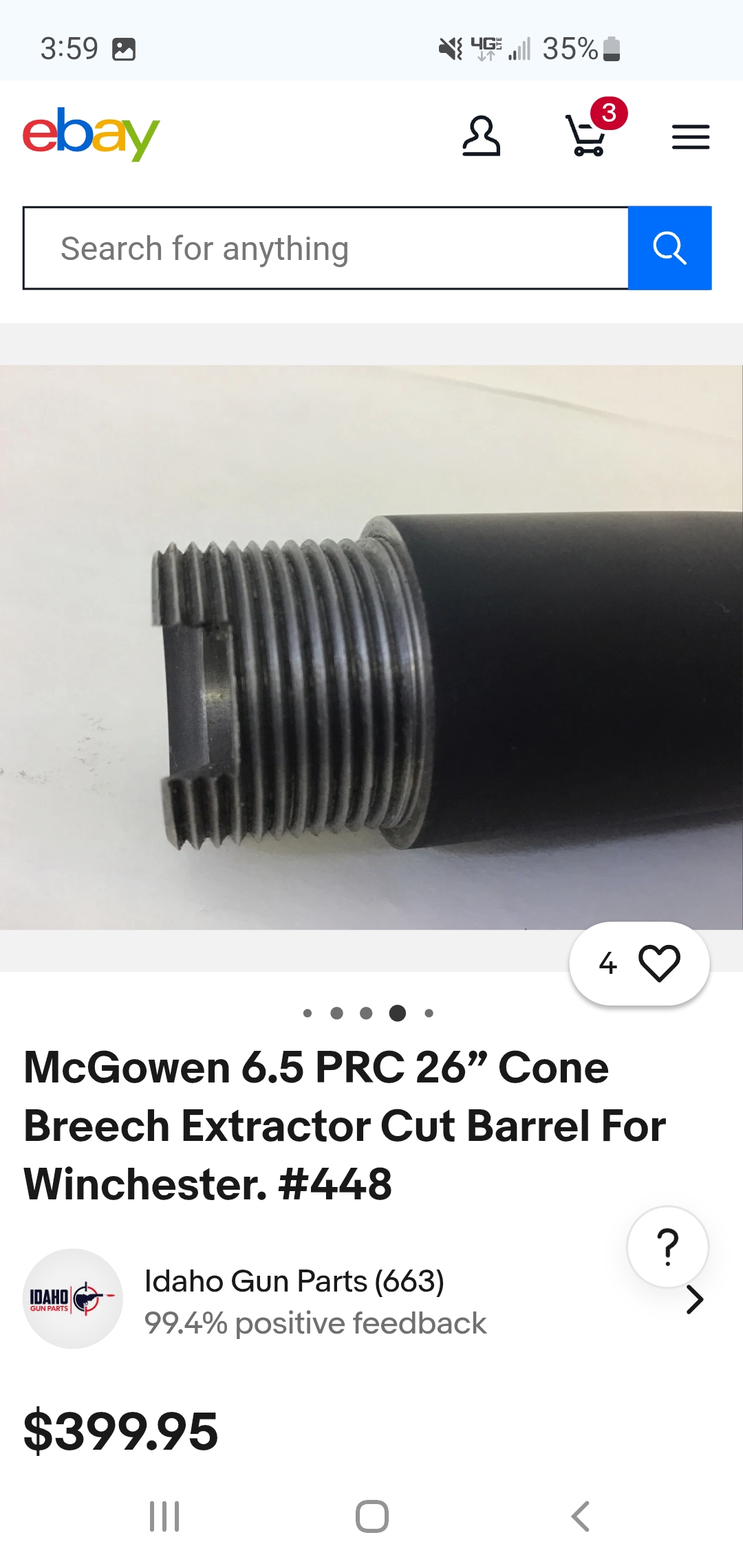

McGowan built barrels are hot garbage.
My 25 Quartermoor shoots great. I have read varying opinions on here and seem inconsistent barrels.
Also read the same on Shaw but again, I had a 6 ARC that was very accurate and consistent with 5 and 10 round groups. Only sold it to get a Proof CF, which frankly, isn’t anymore accurate. Or at least I’m not.
No need to play he said she said. Show me pictures of McGowan's threads. Show me pictures of their machine work.
And they made three of those barrels like that for me. I still have two of them under my bench. And those were replacement for a used barrel I bought of theirs that had out of spec threads on both ends. So that's 4.
And I have an ar15 barrel from them with similar looking muzzle threads and the indexing pin on the barrel extention stuck up about 1/4" past the lip. It shoots good though. Kinda scary to wonder if the thread interface with barrel extention is safe. So that's 5. I saw one in the PX with threads like mine and asked when it was built and it was 2019 or 2020. So that's 6, built over a 5 year time frame.
  • Wow
Reactions: WeR0206
I have seen factory savages with rail road track rifling shoot better than that. And I wouldn't recommend a factory savage barrel either. The machine work is going to be better than anything McGowan turns out though.
Reactions: BurtG

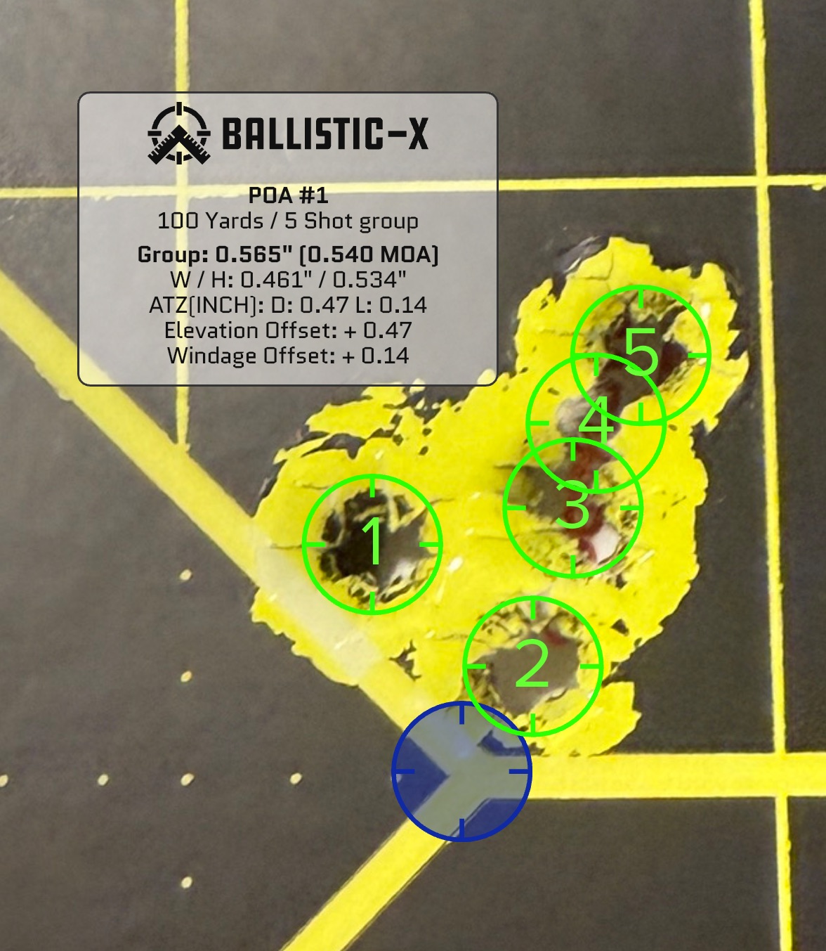

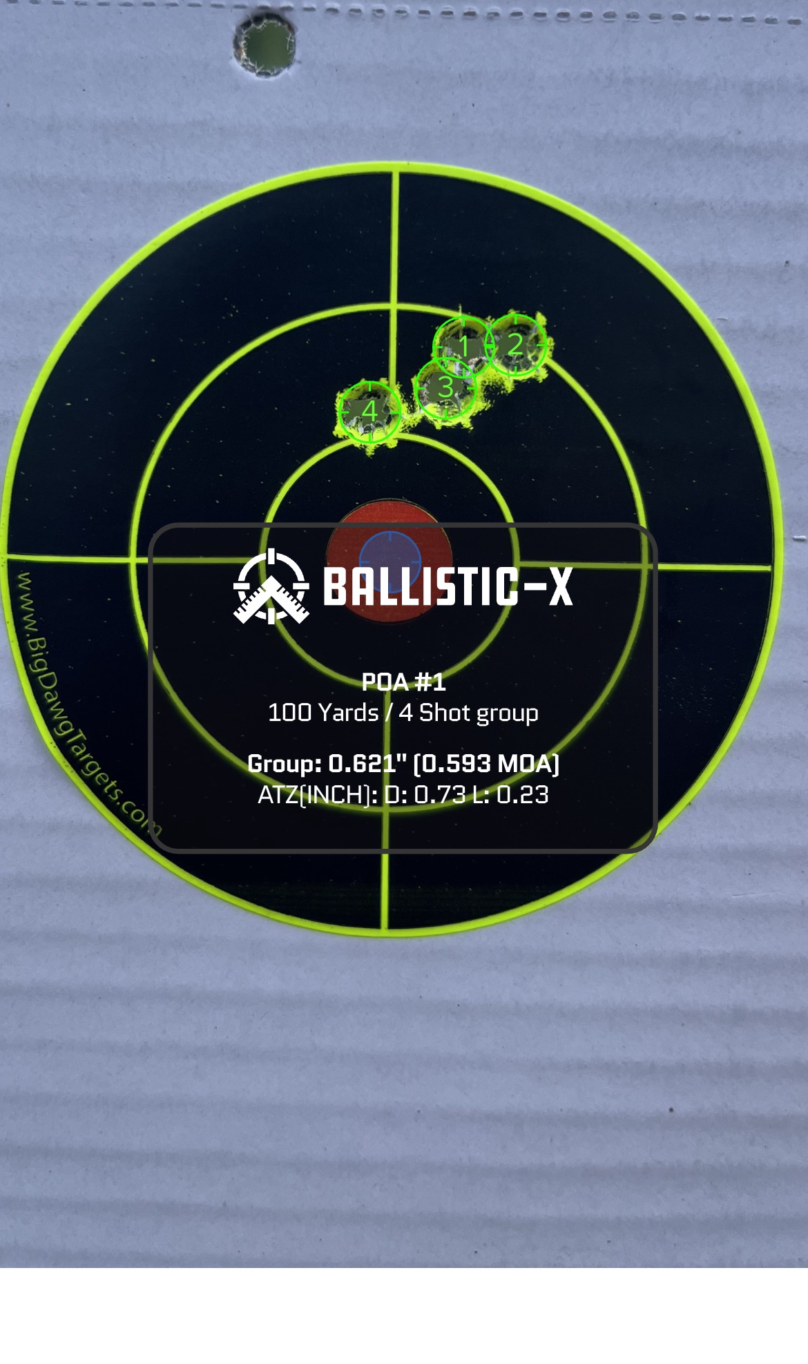

Shoot better than what? 0.732 MOA. Ok cool guy. Just because your barrels are shit paperweights, that for some reason you’re still holding on to, doesn’t mean they all are. That’s the point.
Ballistic-X-Export-2023-06-30 15:12:07.104604.jpg
Reactions: rpoL98
Yes, shoot better than 3/4 moa. Consistently, like the dudes that owned them would have cropped that group out of the picture, not cherry picked it. 🤣🤣
You didn't make a point. You continued to play he said she said.
So those pictures of their machine work....🙈🙉🙊
Yes, shoot better than 3/4 moa. Consistently like the dudes that owned them would have cropped that group out of the picture, not cherry picked it. 🤣🤣
Who gives a shit what the lands look like if the barrel shoots. You apparently. There’s threads and threads on long range hunting and here with plenty of anecdotal stories that have had positive experiences. Many where they felt the barrel had some internal flaws. Ultimately, they too didn’t give a shit because the barrel shot great. Your anecdotal story and barrel pics don’t equate to shit in the tens of thousands of barrels probably that McGowan has produced. 😉
Internal flaws. 🤣🤣🤣
Probably produced. 🤣🤣🤣
Here is some more awful threading on a McGowen barrel being sold on ebay. There are actually two just the same on there. For those that don't know, threads should not be sharp like that.

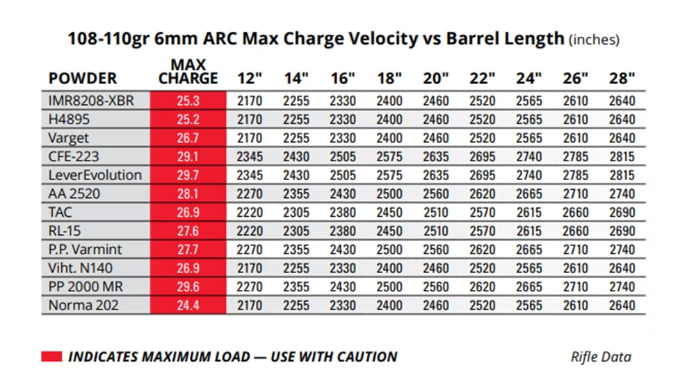

I’m being a little lazy as this thread is up to 74 pages, but has anyone worked up loads with 95-107 gr for these 14.5” 7 twist barrels?
I have 8208 XBR, MR-2000, Varget, Tac, AR-Comp, RL15.5, CFE223 and LEVERevolution on hand to test in Nosler cases. Would love to hear your experience. Hoping to get 2500 fps and 1moa out of the cheap Hornaday 105 BTHP or 107 SMKs, but would also be happy to use 95 SMK or TMKs.
Appreciate any feedback. DMR match is mid-October so I’ve not got a ton of lead time.

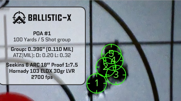

With 107 SMK's in an 18" barrel, Alpha brass, 29.4gr 2000-MR @2.260" I was able to get avg fps of 2,539; SD 12; ES 45. Group size was .941 MOA (10 shots).
As a point of reference the max charge for 2000-MR in the Hornady load data (108-110gr bullets) is 29.6gr and with 14" barrel they got 2355 @ 2.245" COAL.

Have you checked the fired H20 capacity for the Alpha 6 ARC?? I'm curious if it's giving up anything capacity wise. Lapua grendel formed to ARC is within .1gr of Hornady brass.

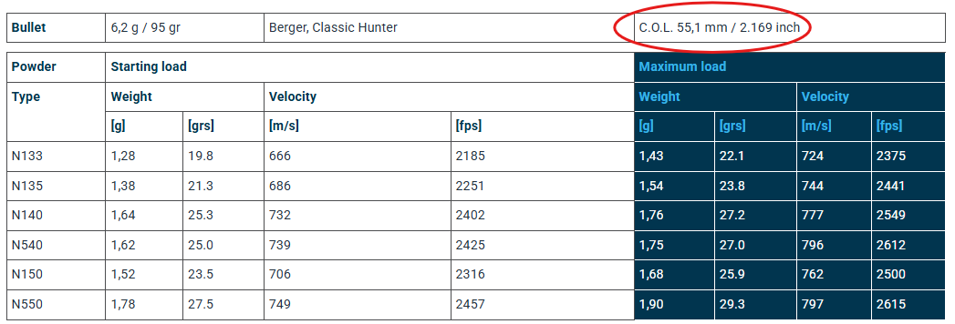

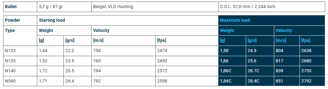

If you haven't checked it out yet there's some good VV 6 ARC gas gun load data here:
Vihtavuori
Not exactly what you're looking for but they have data for 87 berger VLD's:
and 95 Berger classic hunter:
