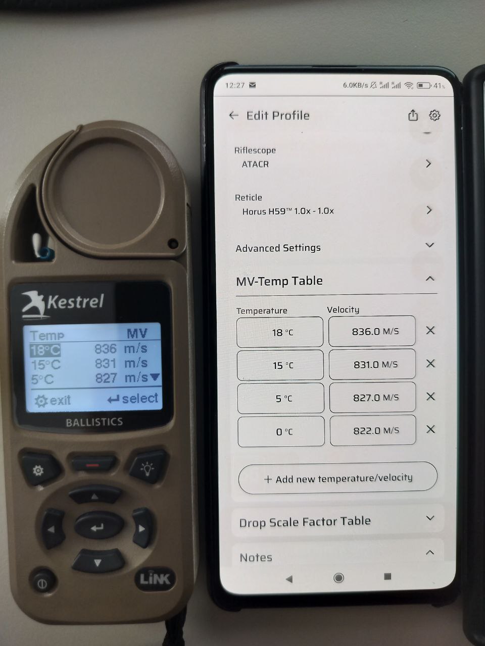

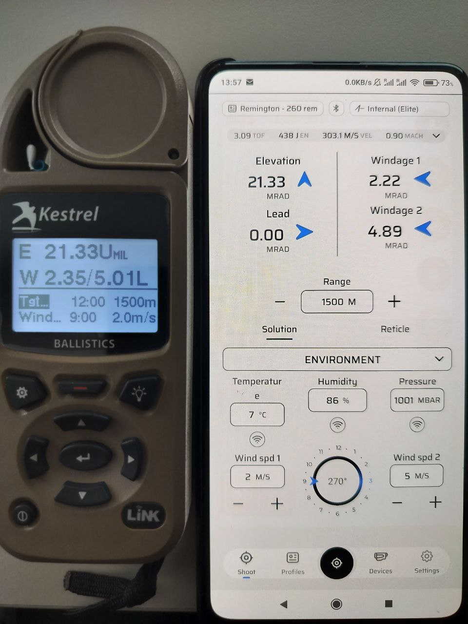

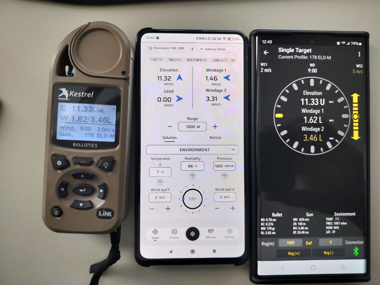

I noticed some discrepancies in elevations and windage . On Kestrel and AB Quantum I set absolutely identical parameters of the rifle, sight, environment. But the readings are different.
Looks like elevation is the same, but windage is different. I would suggest double checking target data. DOF, Incl, Bullet Length etc.
