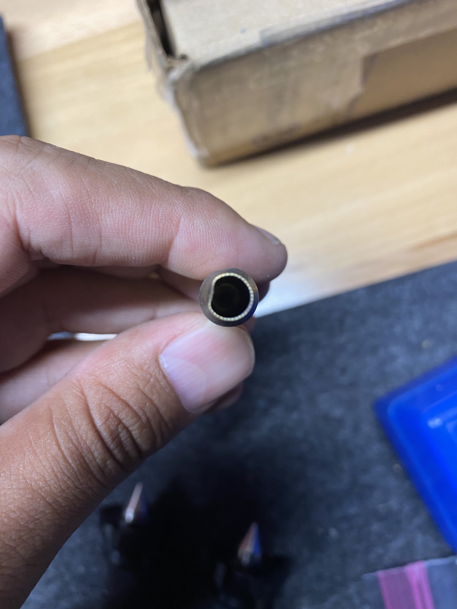

Hey guys so about a month ago I decided to put my first AR together and for the most part am pretty happy with it. Only issue I have now is that I think the buffer (Armspec SRS 3.8oz) might be too heavy so bolt is not locking on the last round but gun is cycling fine with the 3 different types of ammo I have ran thru it. Just got back from the range and noticed something strange and was wondering if I could pick y’alls brains. Picked up my brass to inspect and I notice a dent on all of them (see pictures) any idea what could be causing this or if I should even worry about it? I shot .223 norma 77s and frontier 68s today the dents are only on the frontier casings, norma brass looks fine.

Bolt lock has a better chance of being mag related than buffer tube. AR’s are tough on brass. If it is cycling fine, but not locking, try different mags. 90% of semi automatic issues are mag related.

The dent is probably caused by the case deflector behind the ejection port. The lapua brass probably doesn't have it because the pressure is different so therefore it has a different ejection trajectory. The lock open malfunction could be the mags, or the recoil spring could be too heavy. Test all your mags to determine if they will trip the bolt catch manually. If the bolt catch binds on the magazine just trim the mags with a knife or needle file. You can test the magazines by removing the upper and inserting empty magazine to see if the mag trips the bolt catch or insert empty mags in the rifle and charge it to see if the bolt catch captures the bolt.

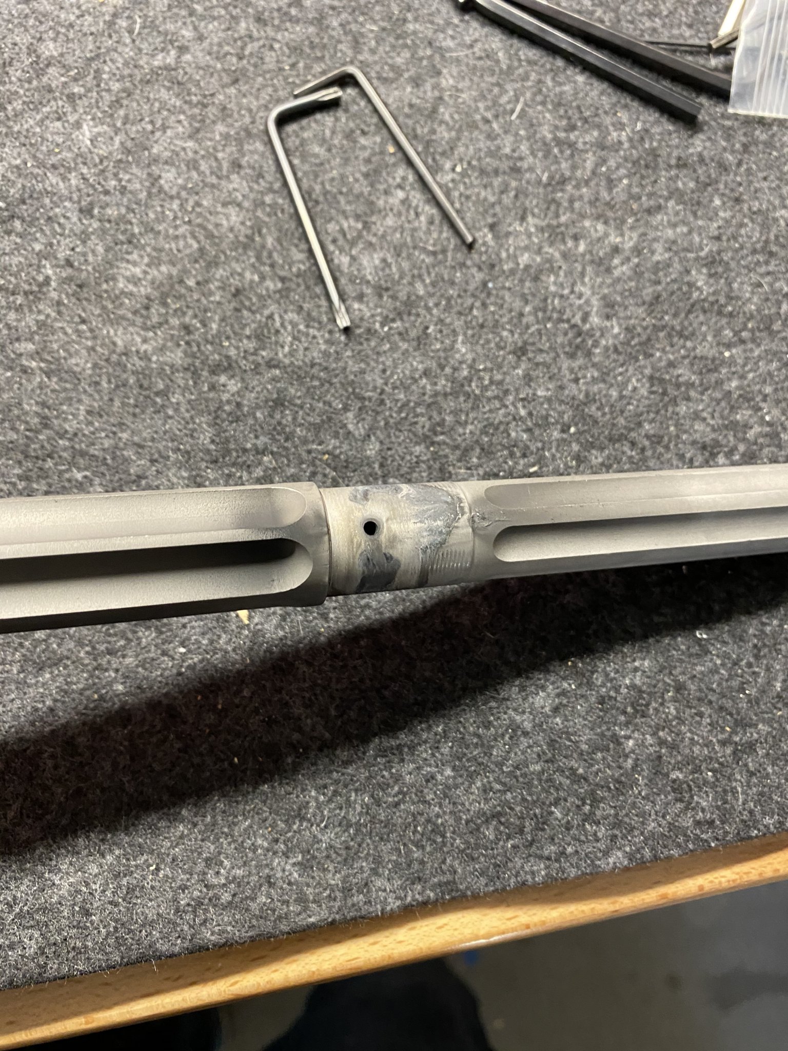

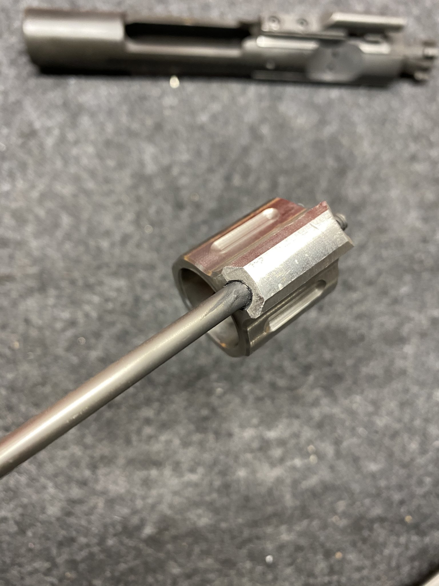

Ok so I replaced the buffer spring kit to a lighter one (3.3oz from 3.8oz) and messed around with my adjustable block a bit today and same result. Bolt just wont lock and experienced some FTF maybe 8 rounds out of 60 that I shot today. Also I removed my gas block when I got home to check alignment and noticed that my barrel and block were quite dirty, don’t know if its a leak or because of me adjusting the block to try to find the sweet spot. Even when its open all the way bolt won’t lock back. Am considering moving to a low mass BCG. Any suggestions?

Looks very leaky. I would buy a clamp on to try after cleaning the area up. Can you mic the barrel and block by chance? How does it fit? Does it go on easy, or is it fairly precise and takes a bit to slide on?
Reactions: Islas82
Fits easy. I just plugged my barrel (chamber side) and pumped some air in. I can feel air coming out of the gas tube fine, didnt feel any air leaking out.
If your measurements are accurate you couldn't get the GB on the barrel. They are NOT accurate! You have a set screw GB. Don't worry about the leak. If you shoot it enough it will seal itself. Things like this happen when you put unproven game gun shit in a rifle.
