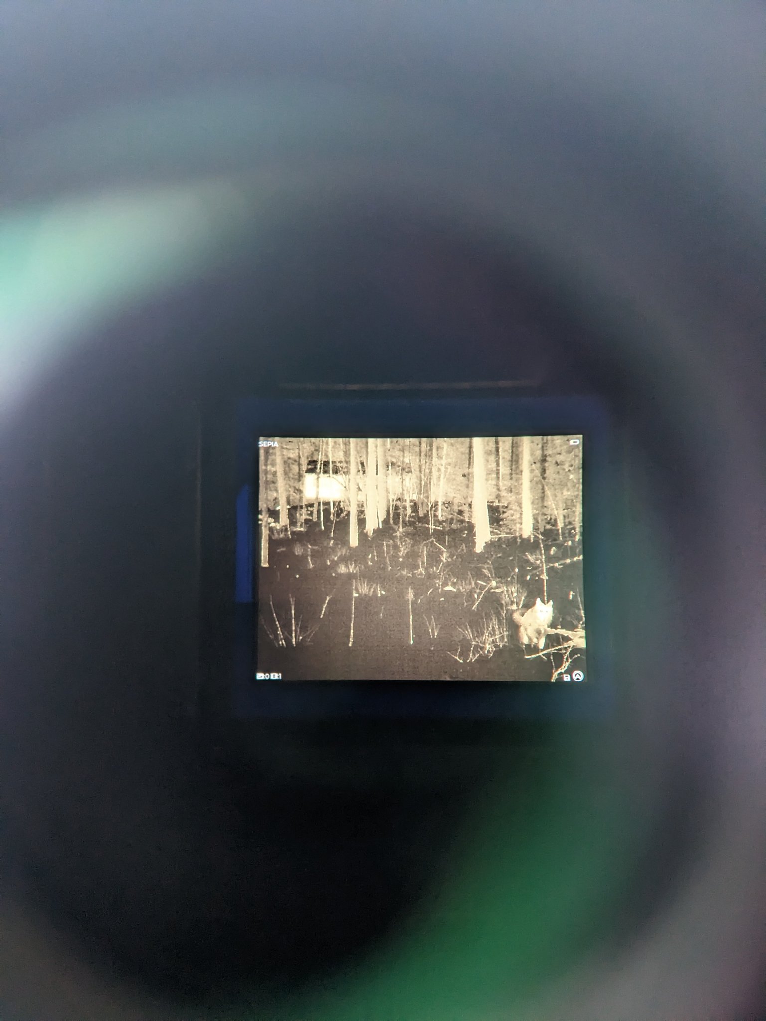

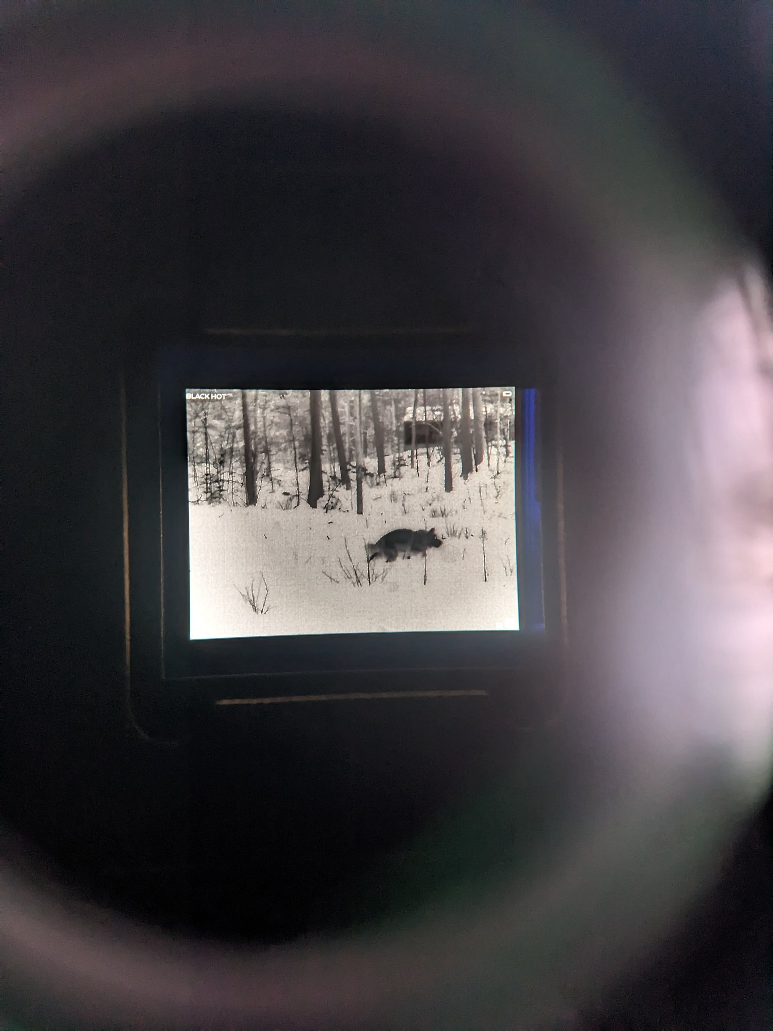

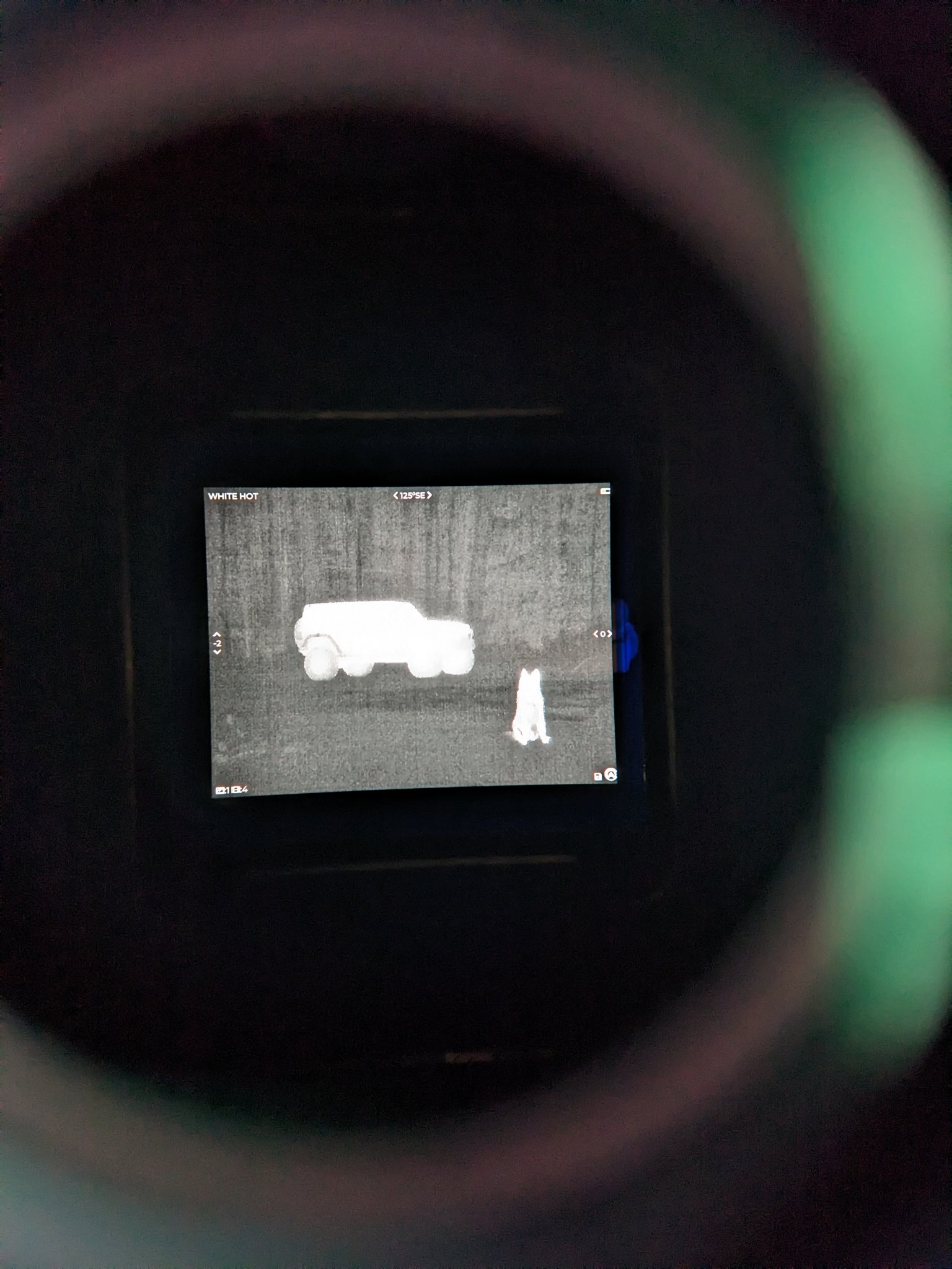

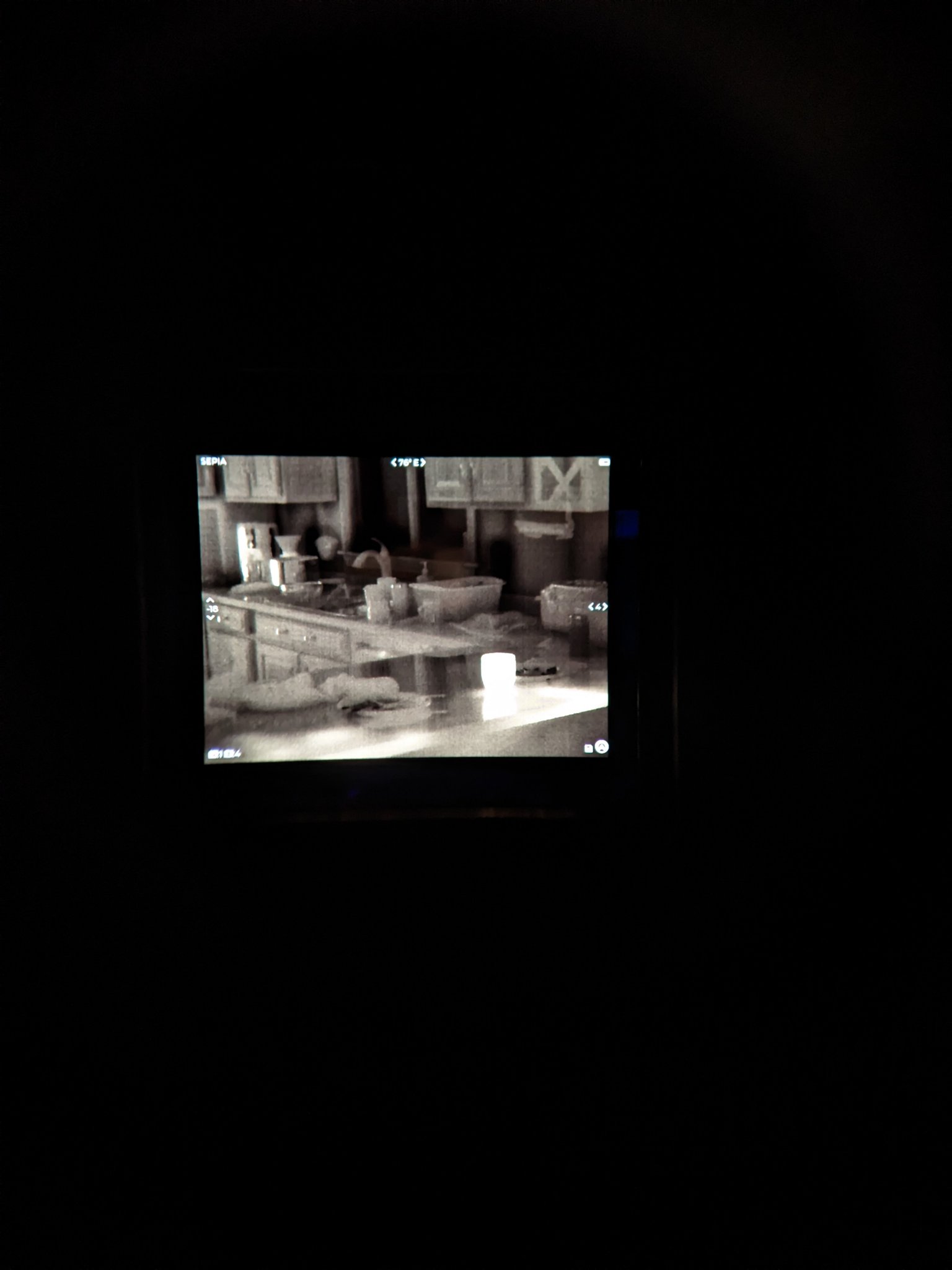

Got my updated one in last Tuesday and was initially very disappointed. Conditions however were pretty bad for thermal. It was 34'F and 90% humidity. The 6" of snow was baking off everywhere. So when I went outside to see anything, sure, I could pick up the dog in the yard, but I could see anything behind him. All the trees and landscape inside of 50yds blended into a gray blob. The first two photos show what I saw with the naked eye vs the Sidekick. The 3rd photo was just inside where the unit performed totally different (hint hint....would stove and no humidity). I'm taking all photos with a shaky hand and the Sidekick doesn't focus up close well.
I popped my head back outside around 10pm as the temp fell below freezing and humidity dropped. The picture noticeably started to improve.
I snapped a few more photos yesterday as humidity changed. Pictures 4-6 below. Again, I'm holding the sidekick in one hand and a phone in the other. I also forgot to adjust the focus on the Sidekick from an up close indoor focus to outside. Oops.
Totally improved image last night without horribly humidity. I should have grabbed the Kestrel to confirm the actual environmental so will try to do that next time. Went out last night to hunt for critters while running an L3 PVS14 unfilmed white tube on my dominant right eye. No issues fory brain and was able to spot the dog in the woods as he wandered around. The image overall was pretty good. I have a few settings saved under the different defaults now for night time, day time, more humid, and use with the "patrol" mode.
Overall I am happy so far. I need to figure out how to not get a massive bloom of red on "patrol" mode when I look up into trees for porcupines. My guess is the sensor just picks up the sky and contrast needs to get dialed down so will tweak settings more.

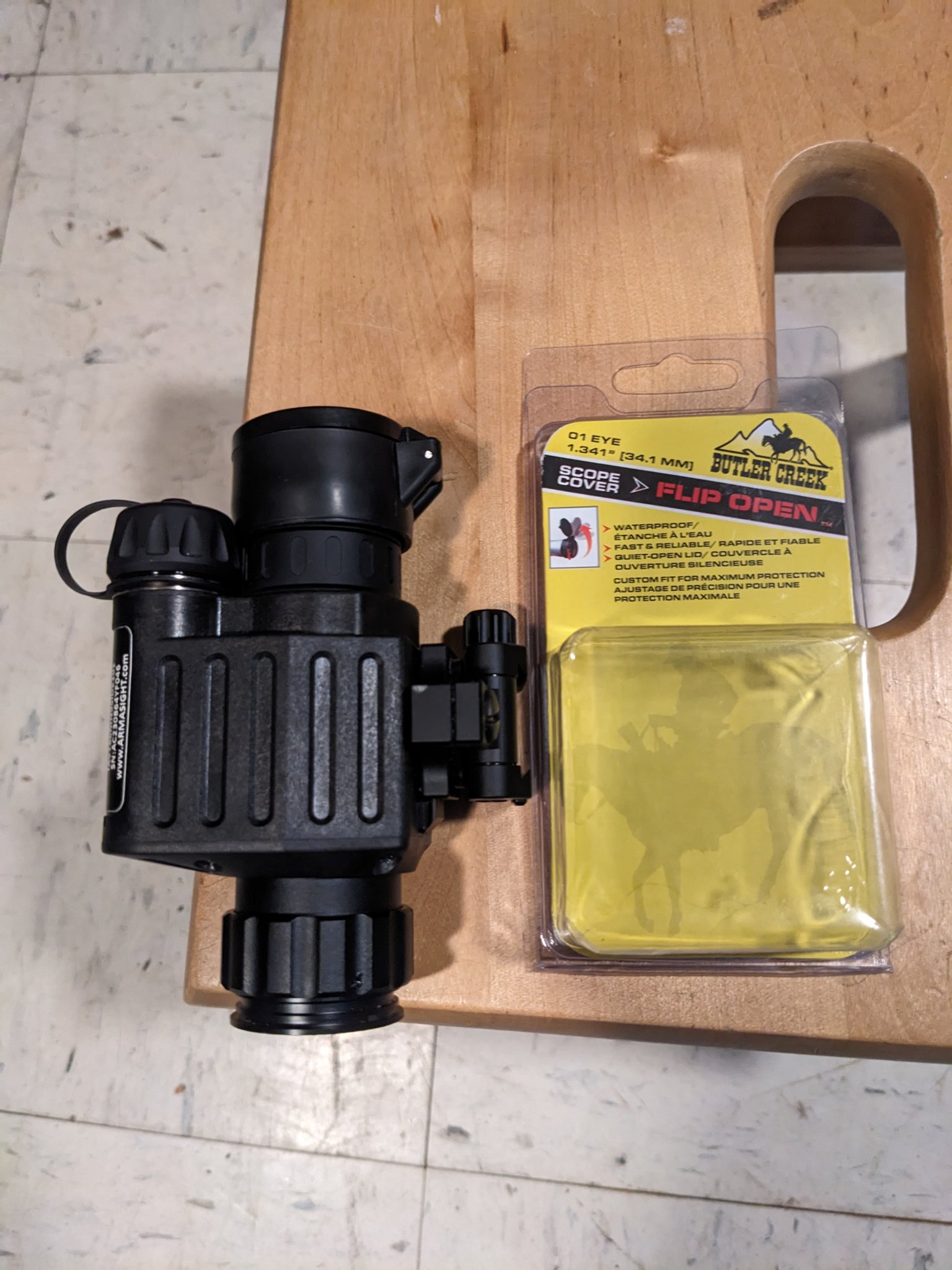

Well, it took 8 days, UPS said my thermal was out for delivery, then suddenly it was in alabama, then it was back in my city and actually got delivered. The image quality is noticeably better than before. Very happy with it, I of course have a lot to learn tweaking the settings. They removed video streaming from the menu, I spose we will get that in a firmware update.
Butler Creek flip cap #1 works well for any of the guys who have already busted the rubber tether for the objective cover.
How the heck did you do that? On the other hand, I did try a butler creek cap that I have for the eyepiece and it fit, will have to go dig up which one it is, I didn't think about trying one on the front, that is certainly faster and easier than the current cap but I'll probably keep using it unless the tether breaks. Reason I tried one on the eyepiece was because I'm OCD and was/am thinking about putting it on there when I transport it so that lens can't get scratched, but that's probably over the top unnecessary, I'm working through my issues lol.
I just measured the front objective lens with a caliper and ordered the closest size.
SUPER GLUE and Baking Soda is your friend. Bonds those rubber straps back very well. Then hit is with a black magic marker and presto you back in business. Hecque, they even fix some plane propellers with that method.
I have fixed many rubber straps using this method.

So just checked out the wildlife tonight with the SK. Temps are currently 53 F, Humidity 96%, wind at 9mph and it rained all afternoon. Excellent conditions to see what a unit can really do. :)
Most of trees, brush etc are all at the same temps so the "sea of fog"is upon me. Nothing can make an image of same emissivity terrain in those conditions that us mere mortals can get our hands on. Maybe some liquid cooled units can. But critters are popping like crazy. Looking at Dillas at 200 yards clear as a bell, albeit with a 3x magnifier on for PID. LOL
Take it off and they are still popping. One thing about the Sidekick is that in poor thermal conditions running the Gain down to zero and jacking the Gamma up to 10 produces the best and a really nice image.

I received my 2nd updated Sidekick 640 a couple of days ago and have been running it through its paces. I also have the luxury of putting a 3x 62mm Torrey Pines Logic Magnifier on the Sidekick 640. Here are my thoughts and findings.
So this morning it started out at 90% humidity and 100 percent cloudy. Poor emissivity conditions. The Sidekick performed very well and gave very good detail on both buildings, vehicles, people etc and also did the same on rural terrain where most items (trees, bushes, grass etc) are typically at about the same emissivity. This was with and without the 3x Magnifier attached. Around 11.00 am it started raining and has rained all day and is still raining heavily tonight.
So tonight in heavy rain I have been viewing all of the same scenery as I did this morning. All of this scenery has had hours and hours of rain on it. During my viewing just a little while ago during heavy rain it was stunning to me on how good of an image the Sidekick was producing. Additionally when you put a big lens 3x Magnifier on any (1x native mag) unit it enables you to evaluate the FPA and core ability to form images at much longer distance. You are better able to assess the sharpness, contrast, etc and overall image produced at longer ranges. The Sidekick surpassed all of my expectations. I was very impressed in what this little unit can do.
Like any thermal device you have to spend time in different emissivity conditions to learn how to adjust the settings of any particular device to get the maximum performance it is capable of achieving. A quality device has plenty of individual settings one can adjust to optimize its best performance under the present conditions you are working in.
In pouring down rain the following settings worked excellent for me.
First I turn off the Compass and Inclinometer that show on the Ocular Screen. This will give the CPU more HOSS-POWA because it offloads work the CPU would otherwise have to devote power too.
Contrast - 22
Sharpness - 9
Brightness - 5
Gamma - 10
Gain - 0
NUC Auto - ON
Picture in Picture Off
Now usually I will let the unit warm up with NUC on Auto and then once warmed up, switch over to manual so its not NUC' ing as frequently as it does. This lets me decide when to NUC to improve any image degradation.
I am not noticing any perceived lag or jerkiness in the unit. To me the two single most important adjustments with this unit that have a really big impact on performance and image quality are Gamma and Gain. This unit is very sensitive to increases in Gain and the image will get grainy fast if you have the Gain jacked up too high. In poor conditions I have found that increasing the Gamma and decreasing the Gain results in a much better image and detection of critters still remains good.
The Sidekick may not exactly be a NOX 18, Skeet or Voodoo, but it is one hell of a very compact good performer for its price point and really not far behind what they bring to the table due to the inherent limitations of a 1x wide FOV spotter. A 1x spotter can only do so much no matter who makes it and their range is limited, unless you can easily attach a big ass 62 mm 3x Magnifier lens on it.
I have tried to take some photos and video with my Cell Phone through the lens, but that is not working out to be anywhere representative of what I am actually seeing so I would not want to slander what the Sidekick is capable of producing. Stokes and JW are the ones that have the ability to capture through the lens images most representative of devices.
