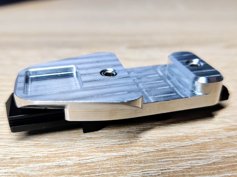

Sidekick dovetail adapter coming in hot for testing soon.
I'm assuming that means you'd be able to quick detach the sidekick from a bridge right? Would be nice to have, but means i'd have to buy another bridge, presumably the mod armory one. How much is this going to be? Do you have a business where you make stuff like this and put it on a website?
You're right, it's just a way to give some people more flexibility in mounting options.
If you already have the Rayvn bridge or another bridge that allows you to mount the Sidekick via the mini-rail and that is your dedicated setup and you are not interested in a quick change capability, then the dovetail adapter won't give you any benefits.
If you have a bunch of different bridges that accept dovetails and you want to change back and forth between them, this might come in handy. Also for the very brave who want to test the (nonexistent?) Sidekick recoil rating, this will allow you to mount the Sidekick as a clip-on in a Wilcox flip mount.
Exactly. I believe the Sidekick will make a very nice and light clip on for 556. The Flir Breach worked out good in this role and I think the Sidekick will be even better given it is a 640 unit instead of a 320 Unit like the Breach.
Being able to put the Sidekick in the Wilcox FTS mount will make it a great versitalile short range clip-on.
Right now I'm doing this stuff as a hobby, but I have a website for these projects at jv-innovations.com
Honestly the only thing I don't like about the rayvyn bridge is that I can't quickly remove the sidekick so I can use it as a monocular, it just sucks that I'd have to buy another bridge lol.
