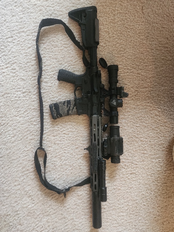

I used a mk 12-ish with an ATACR 1-8x
I day zeroed (the green dot) and I night collimated - the handwarmer. I'm a little bit left - IDK what the "click value" is but it isn't 0.1 inches.
Collimating was super easy. You line up the "collimating reticle" with your day scope reticle - done. For a decade - we have to guess and guess and guess and shoot. No longer !! Now we line em up and shoot to verify.

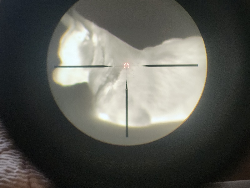

Here's a shot of the mineral cube and salt cube on the ground around the corral ...
And here's a shot of a cow ...
Here's a side by side shot of the Jockey and the Apollo (my current Apollo is a 640 (30hz).
And here's a shot of the cubes by the corral with the Apollo (the cow had moved)

So how many have jockeys now? I wanna set up a 1-8 with a top dot but I need to know if anyone is running one of these at 1.93" height because I like that and I want the jockey to line up. Otherwise I'll have to go with standard height which I think is 1.5 something.
He means the latter - rails on rails to get the net center of the jockey closer to the planned day scope center.
Here's an example:
1.31 (utc x center) plus 0.5 riser = 1.81 center to match up pretty closely to that ELCAN MGO center.
Reactions: WhereNow&How
Here's an example:
