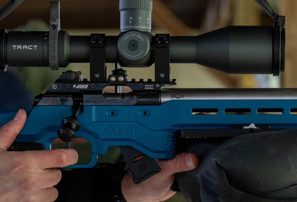

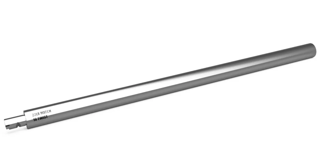

This popped up a few days ago and I realized it hasn't been shared here. L3i just came out with what might be the best deal on a aftermarket barrel for the CZ 457 (At least for NRL and PRS shooters). It is a 24 inch straight 1.180 profile barrel with a match chamber and target crown. They haven't officially said where the blank comes from, but based on the diameter there are only a few options- All of them being top tier barrel manufacturers.
The 1.180 barrel diameter is a huge deal for those looking for optimal balance on their CZ 457. Based on my calculations, the barrel should weigh around 7 lbs giving you an extra 3 lbs up front over a 20.5 inch MTR barrel. This means that almost any chassis or stock you fit this to will require little to no extra weight up front for balance.
They originally priced these at ~$550, but was told by @Thesepaperwings they were able to secure a better deal due to ordering the blanks in a larger batch with the barrels for their new Stinger Action. So the price right now is $329.00 + tax and $6 for shipping. I personally think the value is huge and already placed an order. They didn't say how long this pricing will be available, but it's definitely a good deal.
Obviously no testing data yet, but based on the quality of everything else I've seen/gotten from L3i, I'm confident it'll be great. I'll post results from ammo testing, balance, etc once it comes in.

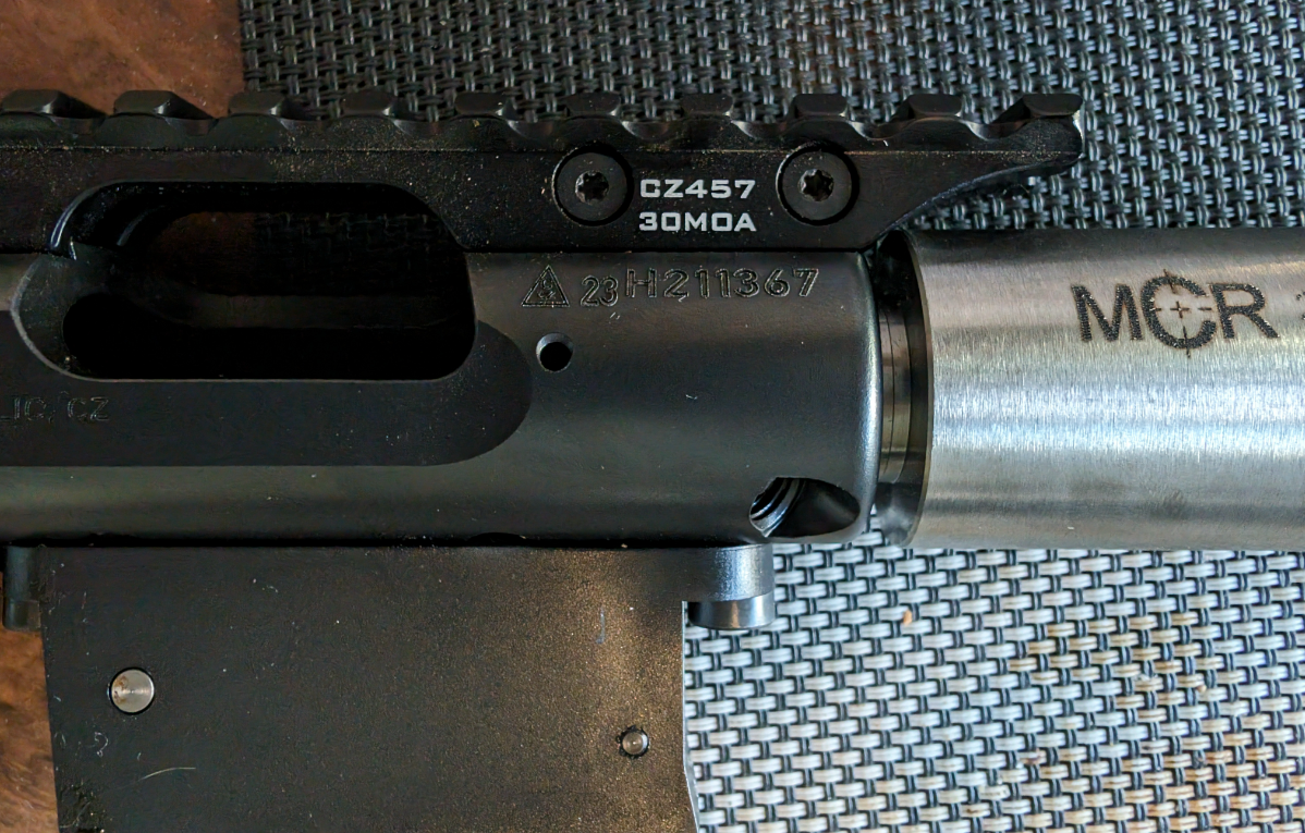

Not much meat on the CZ barrel under the cut , lets just say i would not like to hang super heavy contour onto this ,
Shrink fit , glue in and threaded are the way to go
This the crosssection from my measurements
Reactions: Pomyluy
The stress is not concentrated at the location of that cross section though. It would be concentrated at the shoulder to action junction.
Reactions: fiddlefadel
While that is true to a degree , slipfit of CZ it still leaves bad taste ,

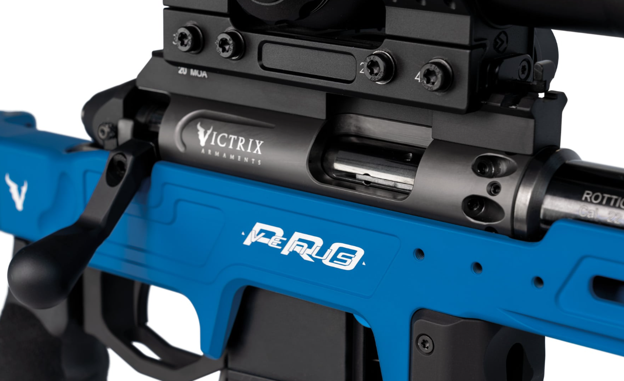

Italian Victrix seems to have something similar to CZ
Quite unusual for a Rem700 footprint action , but also not seen with 1.2 barrels so far and it seems it uses a large shoulder

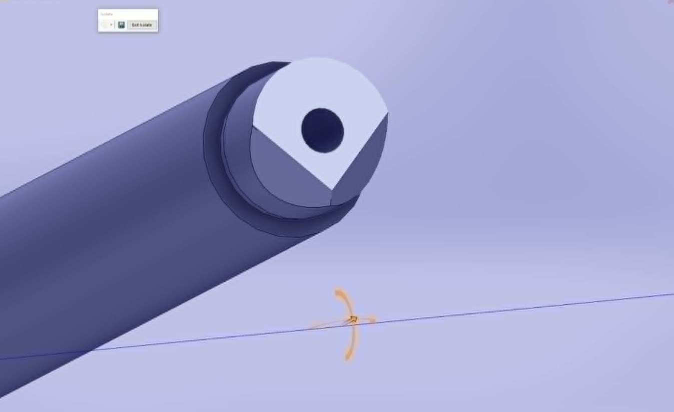

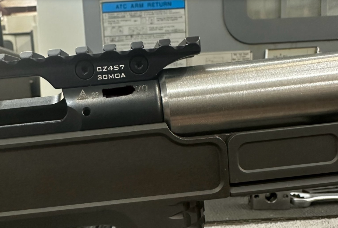

This is a 1.200” barrel, the rail can be slightly slid backwards without modification, or I could design a new rail…

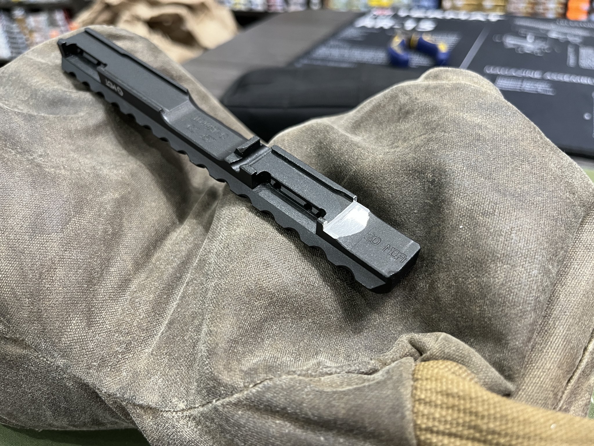

Yeah, I've seen you can slide most back a tad to clear it. But it would be nice to keep it lined up properly. I don't mind grinding a bit off to make it work, but if there are plans to chamfer the edge to make fitment a little more smooth that would be nice. I know the 1.180 have the same issue because the dovetail groves are inside of the 1.180 diameter.
The action is 1.180” in diameter, it looks smaller because of the radius on the action.
My bad, for some reason I thought it was slightly under.
Production has already started. I modeled the barrel tenon with a .020” chamfer but did not include it as a requirement in the prints. i can reach out the shop and see if they included it.

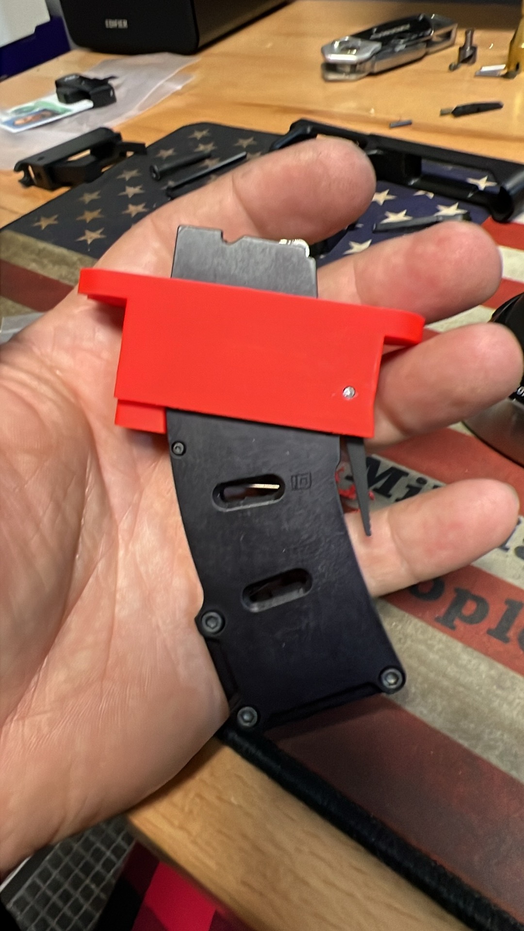

Awesome. Thank you so much. I can’t wait to get the metal magwell. I replaced my broken plastic one with a metal DIP and it’s too tight. I tried calling Pete’s pillars (where I bought it) to get a replacement and send it back but they won’t return my calls or emails. Lesson learned
