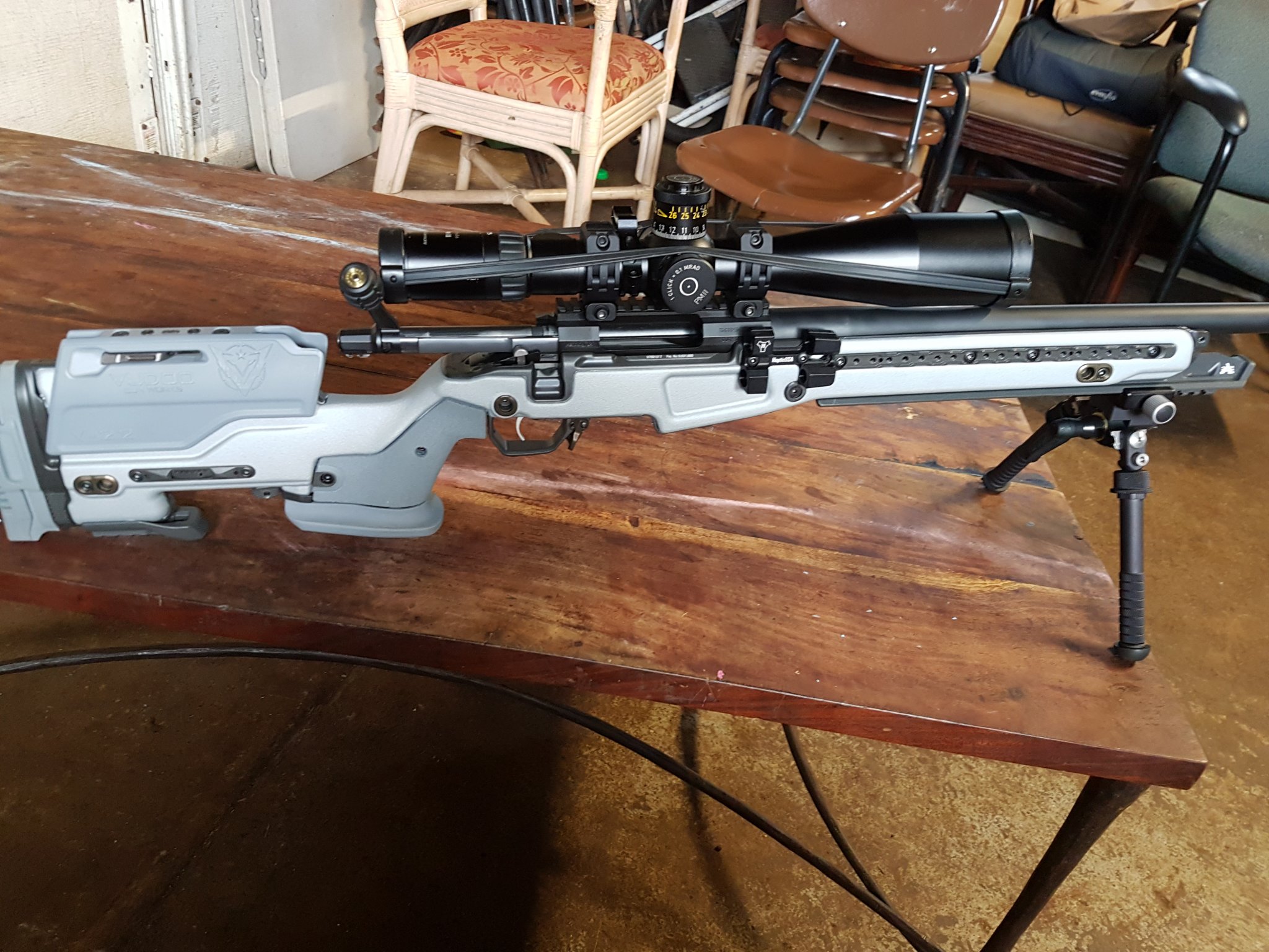

I have it in a MPA chassis and it dropped in no problem. The extended tenon piece has caused no issues that I am aware of at least.
I am currently feeding 6Br rounds out of AW mags with the HRD Gear mag kits and it is running great. I really like the manual ejector, slam the bolt back and the brass will fly across the room, nice and slow during load development just let it sit in the chamber.
It is my first Defiance action and it does have that tight feeling but it is breaking in. The bolt lift is what is unreal. They run that longer spring and it makes the open/close of the bolt very nice.
