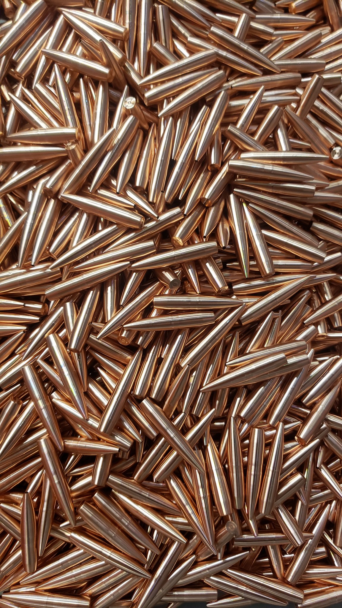

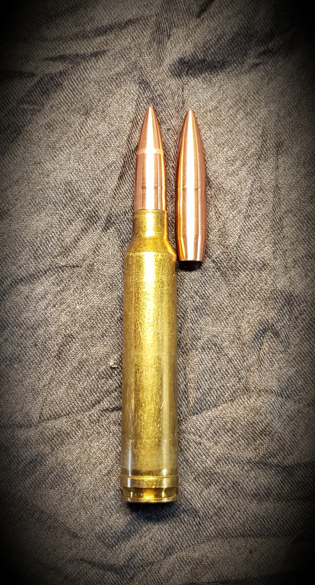

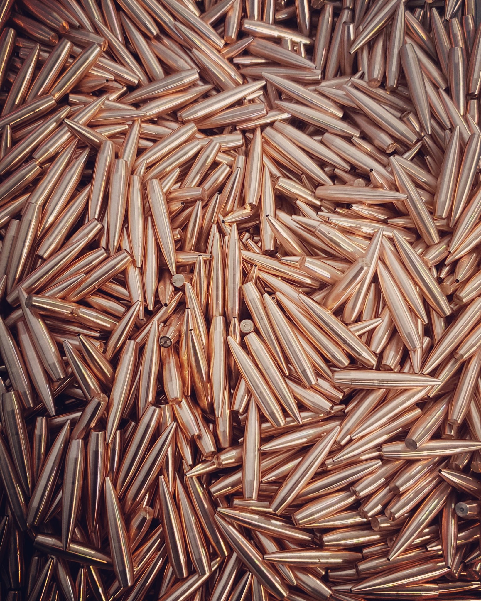

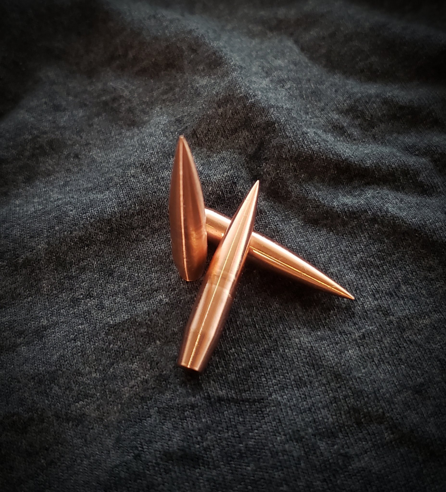

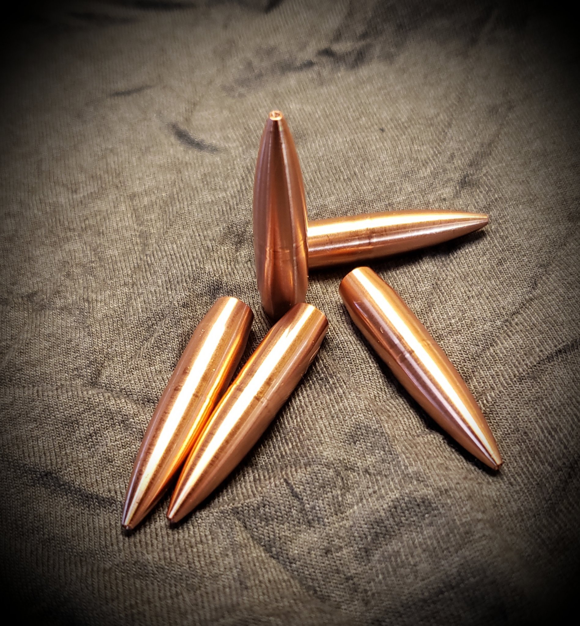

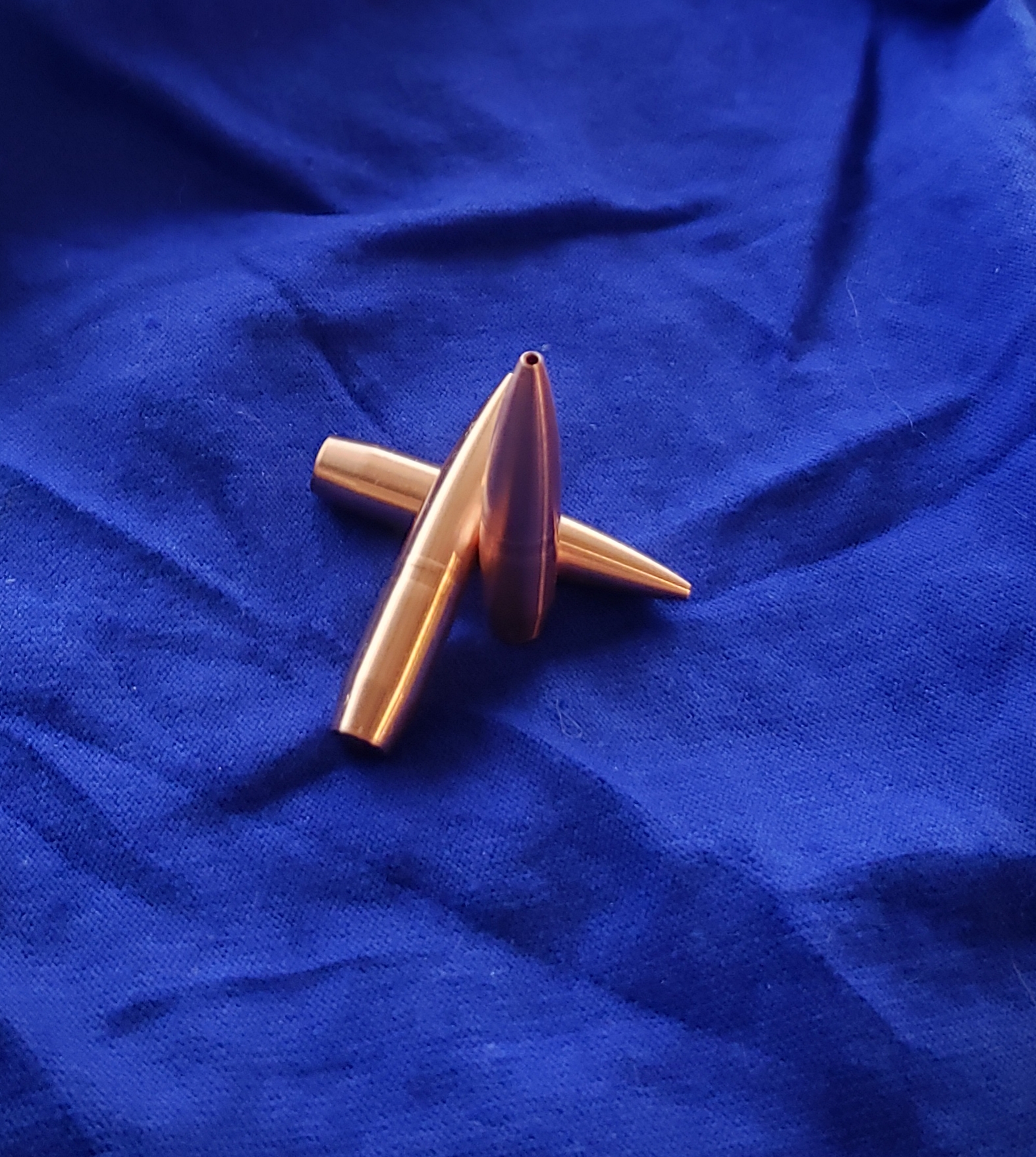

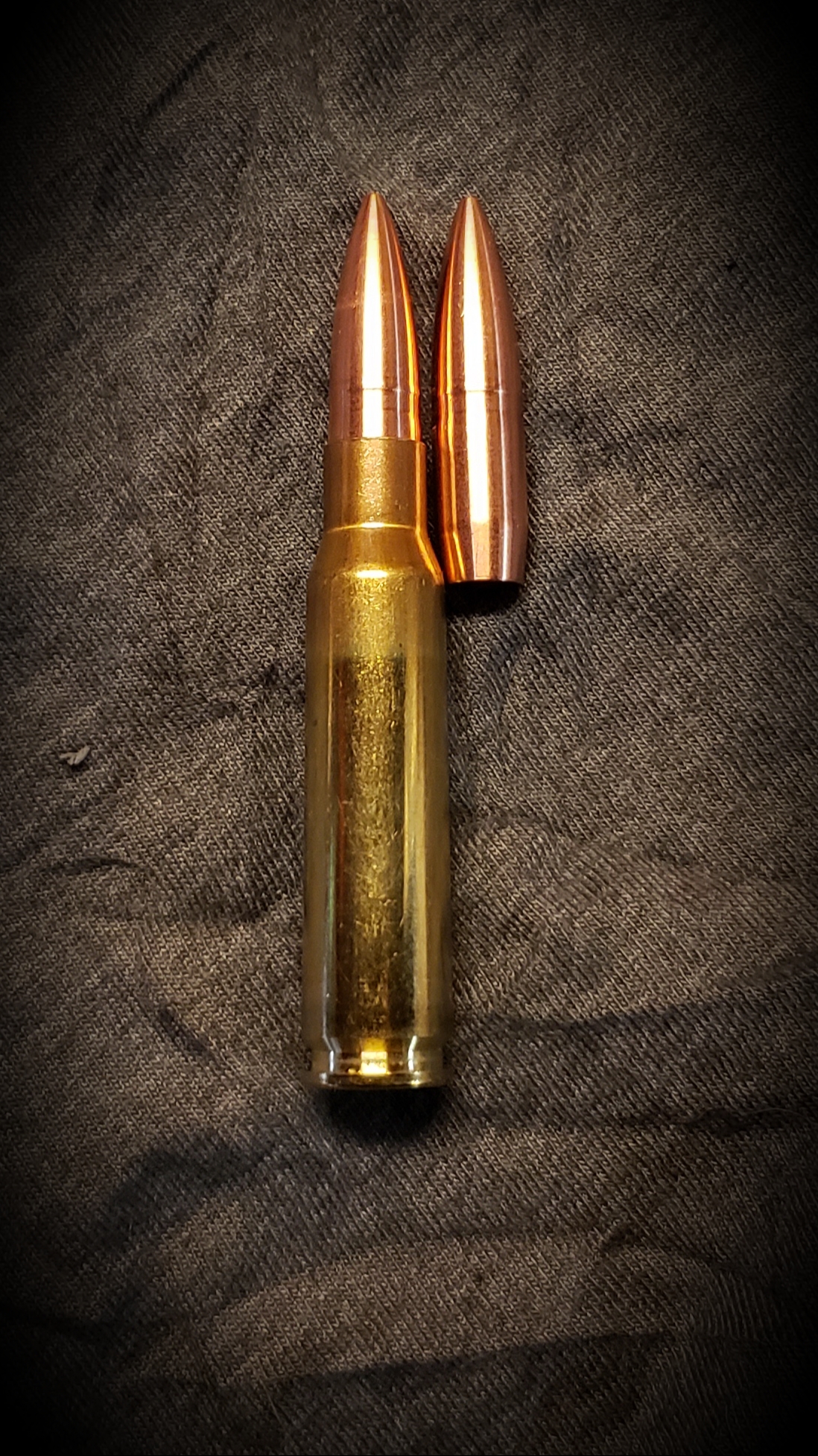

Anyway, enough yacking, here's some pictures and a link to check them out. Everything listed on the website is in stock and we're making more every day. Dealers are welcome, please contact me directly.

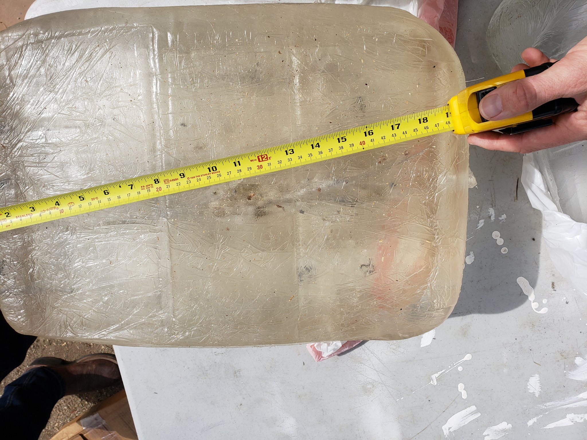

I've shot them into gel at point blank to do breakup and weight retention tests. The 6.5mm maintained over 90% of the weight it started with.
@coldboremiracle 's impact tests on animals looks like they hit going about 1800fps give or take from what I know about the shot. They opened up well and penetrated a lot of tissue and bone.
They don't petal out to 2x or 3x the size at low velocities, if they did they would explode on contact at shorter ranges. They are designed to be shot into heavy structure on big deer species and other big, strong game. Anchoring the animal with 2 broken shoulders is possible with this bullet family from point blank to past 1000yd, the goal being to hit bones and spall out the soft tissue between the heavy bone.

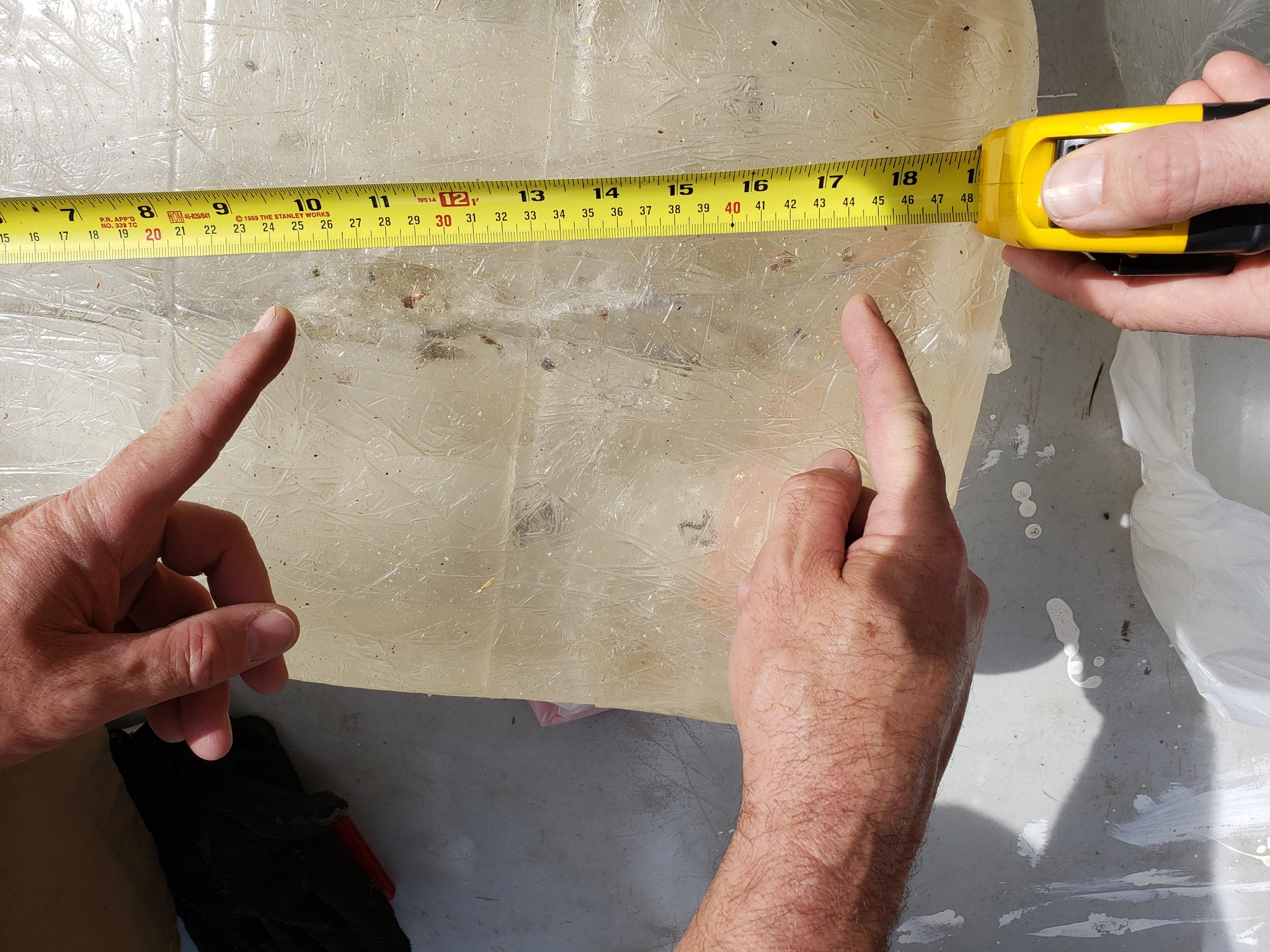

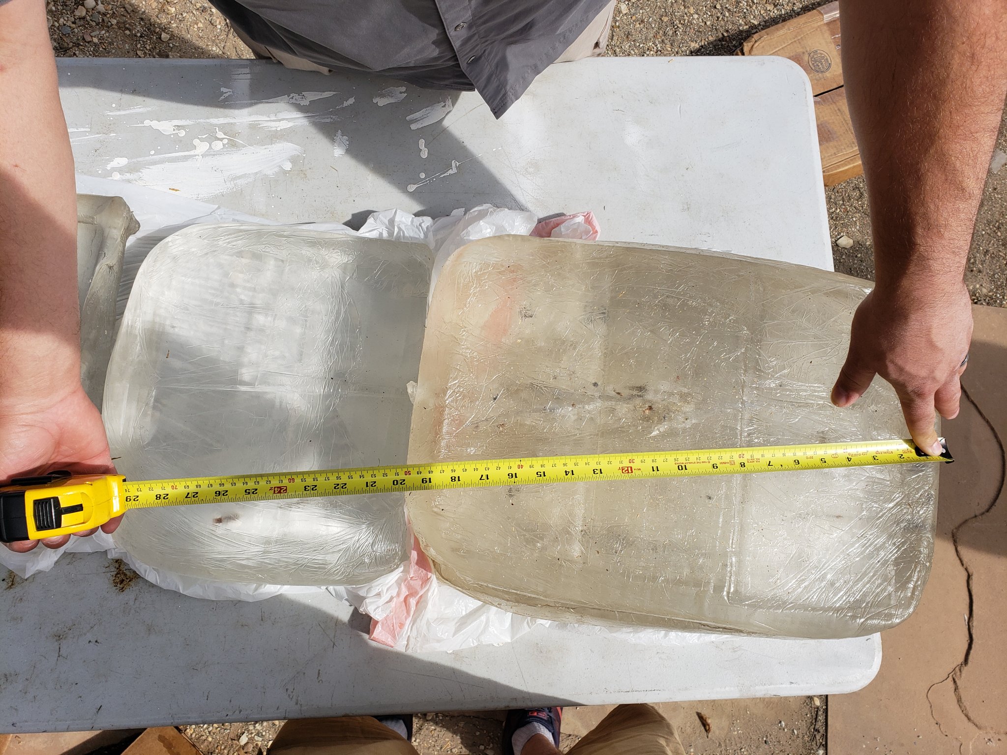

Are there any gel test videos anywhere for these? Would love to see how they expand. The BC's are pretty crazy for solids. The 170gr 7mm is calling my name with the .375 G7
I have to see if I can find a cell phone pic of the 6.5 test in gel. These were not designed to behave properly if somone gut shoots a deer. They were designed for guys to get the heavy game heavy bone, deep penetration sought after by magnum rifle users taking things like elk, bear, moose, 'bou, etc. They break bones, spall the internals from ballistic fragments of bone and go through both front shoulders to anchor the animal.
In those conditions they mash up, tumble (based on the gel trace) and leave large holes in the shoulder blades of elk.

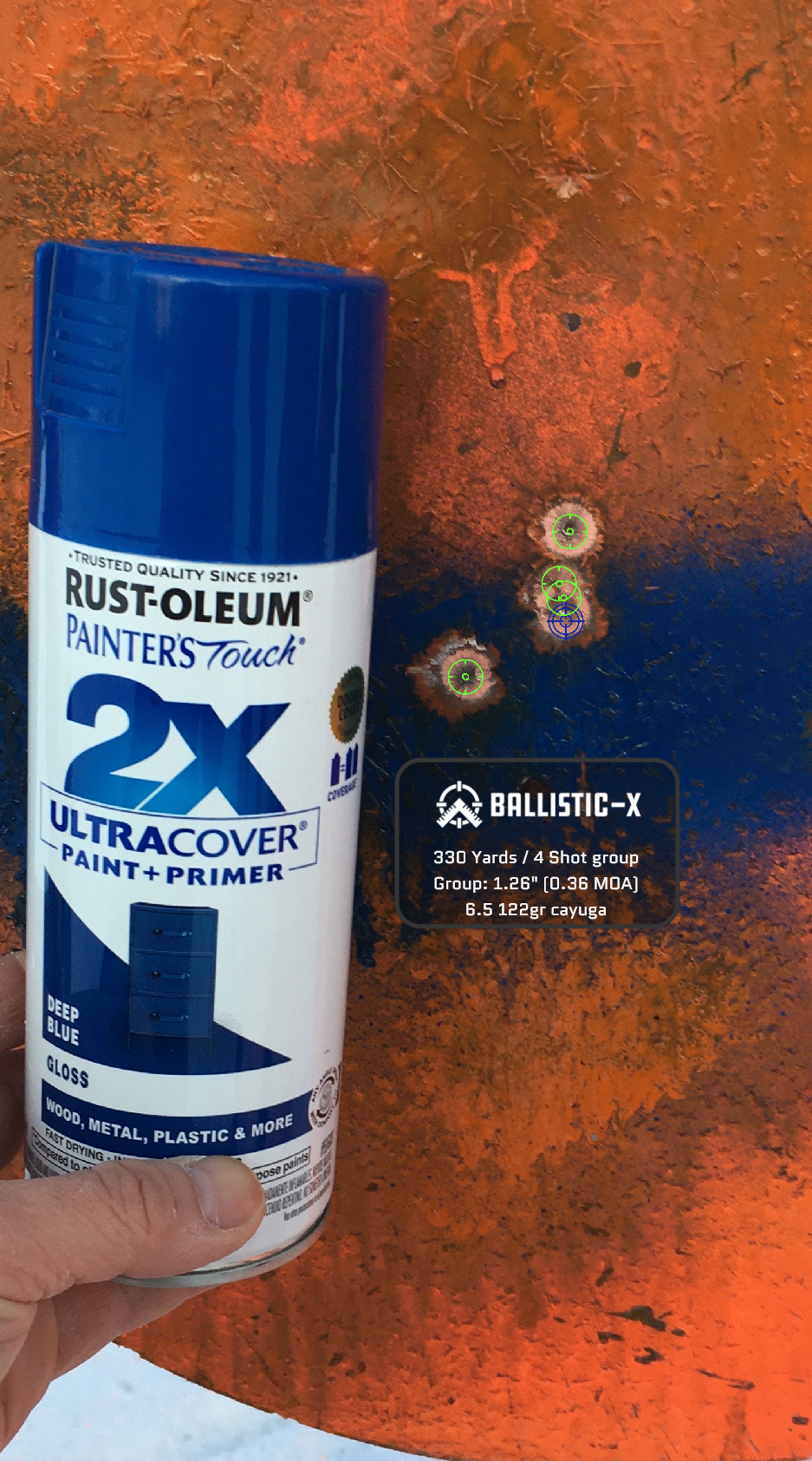

Just to clarify, I rechecked my notes and gave the wrong coal for that initial creedmoor load. This the correct load info:
Peterson brass
Cci 200
122gr Cayuga
2.850”
Below is a picture of 4 shot group at 330 yards with the same load. I think with some fine tuning it’ll shoot pretty well.

I am working on getting some more non-organic gel that can be remelted and stored without refrigeration so we can get some blocks stacked up to try catching bullets again.

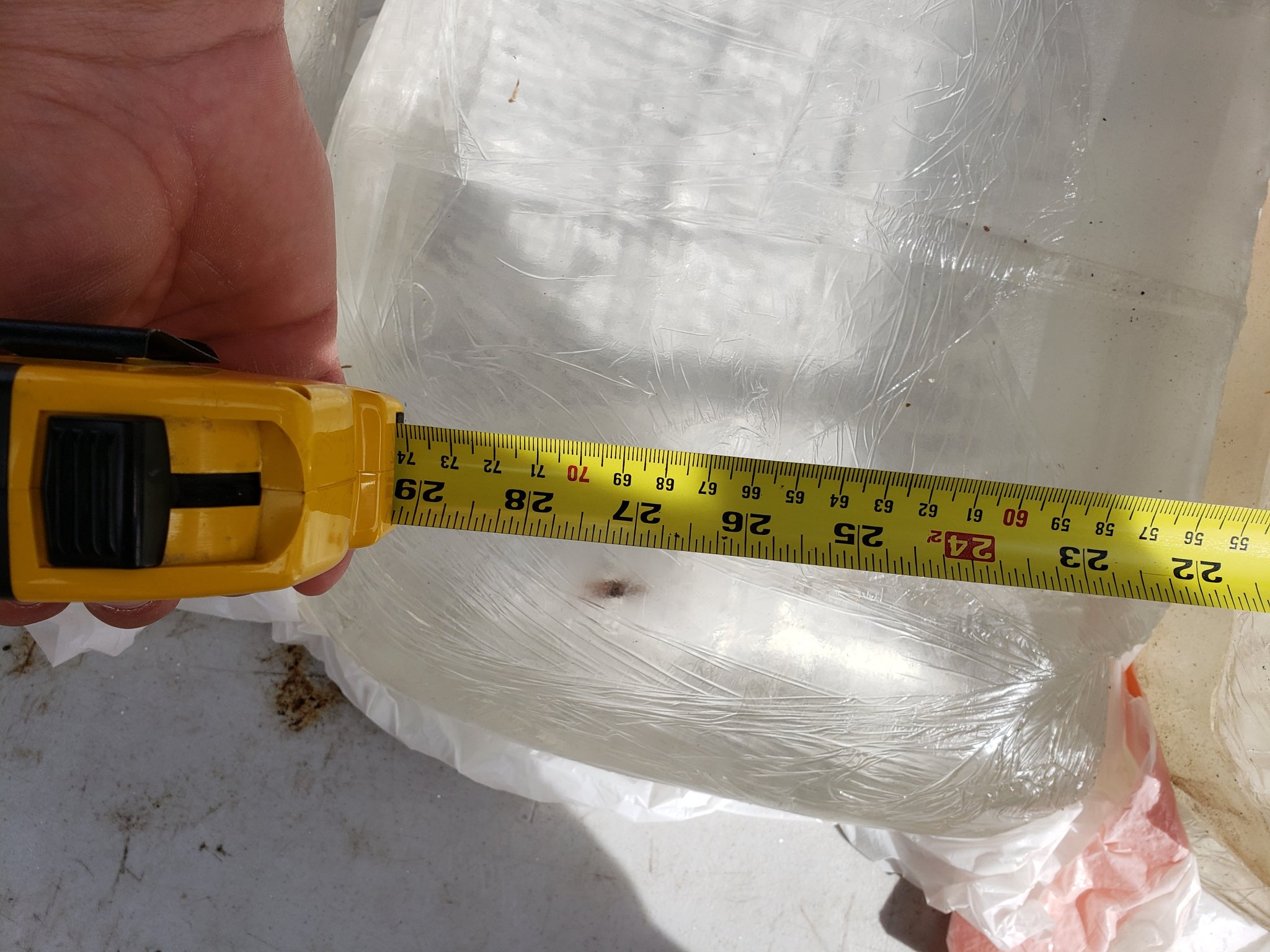

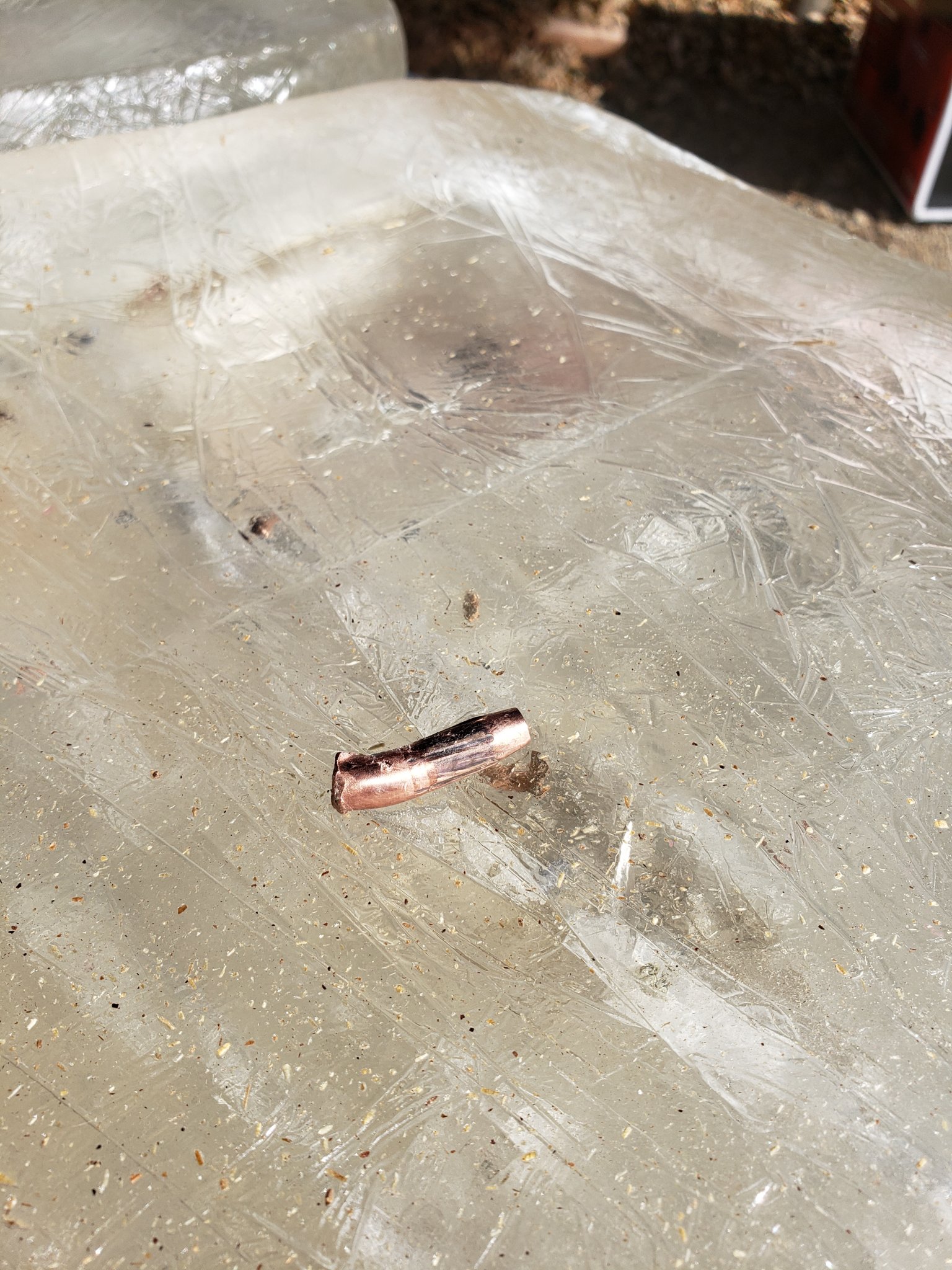

Here is a few photos I have from last fall when we managed to catch the 122 out of a 65 Creed. We also tested a 130gr match bullet in the same gel. It penetrated less than 1/2 the distance before completely fragmenting.
These tests were shot with the prototype designs that were not as expanding as the current type. The production version expands about 30% more.

Every supersonic bullet tumbles unless it disintegrates. Physics demands that, it is a given from the constraints of spin stabilized projectiles.
The nose opens to about 1.5x diameter
At short ranges the nose sheds petals off and bulldozes through while tumbling. That happened with several that had animals shot inside of 200yd. With the elk that @coldboremiracle shot last winter it was apparent from the hole sizes in the shoulder blades that the bullets expanded and mushroomed but he was unable to recover any from animals due to the complete pass thru.
At this time I have yet to get any recovered bullet photos from anyone. Everything has broken bones, spalled the interior and passed though.
Audad, black bear, elk are the bigger 3 species that have been killed with them. Some folks in SD are doing a lot of coyote killing with the 22s.
