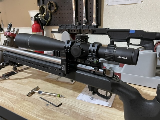

I really love the scope level on this mount. It's not sticking way out there, blocking my view of my dope card or left eye target acquisition, but it's still easy to see (unlike my Spuhr). 8 different mounting options for it is nice too.

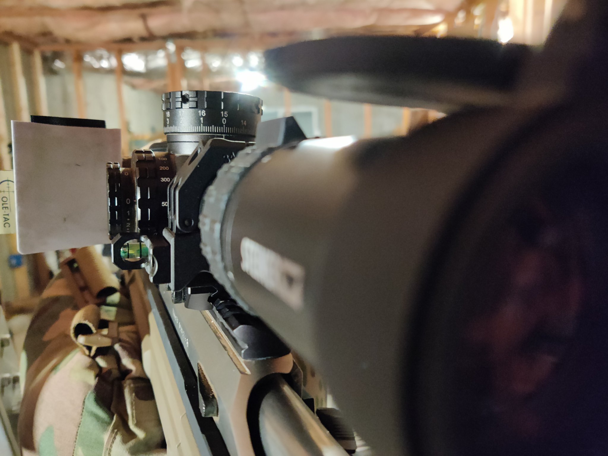

Any chance you can send us a picture of the Radius on the LRF without the riser? We need to be careful of an interference between the forward most portion of the LFR mount and the objective bell of some scopes. Maybe this warrants a longer variant.
Ted
Ted
Ted, I sent you some pics. I hope they help. Let me know if you physically want my Radius to help with the design process.

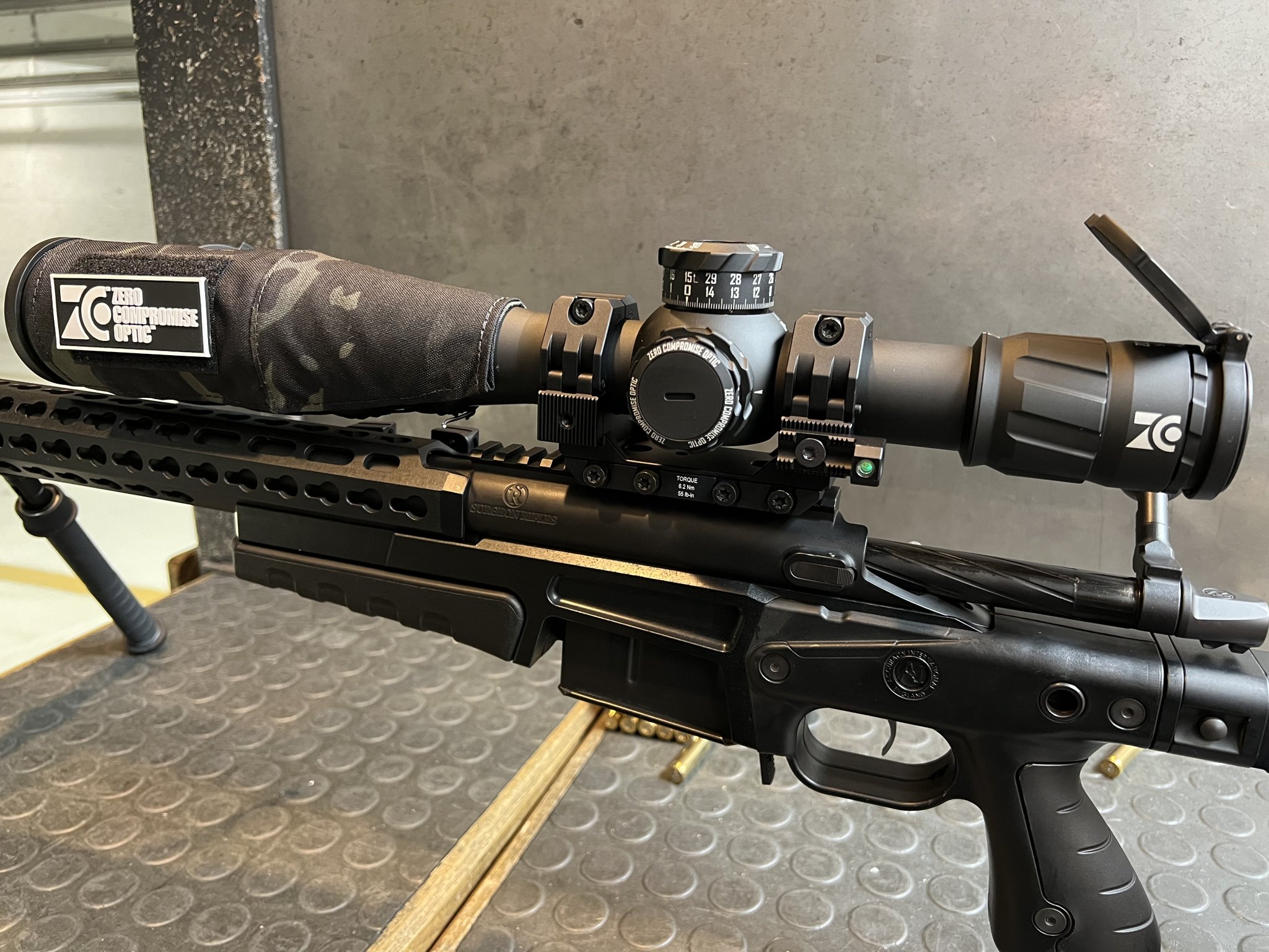

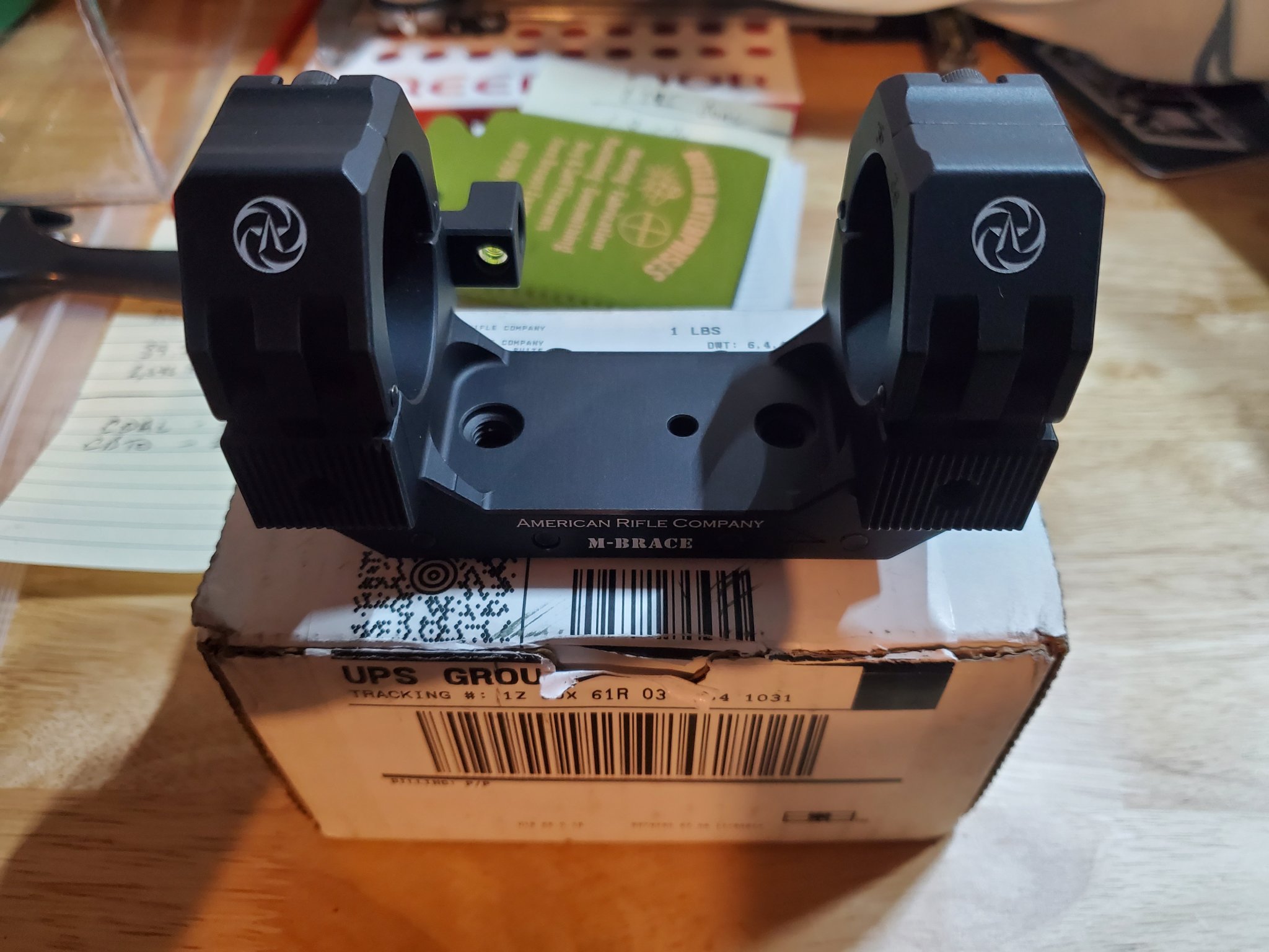

I got mine this week....awaiting my scope. I really luv the design of the rings. Kudo's to you guys for designing it in this fashion. Makes TOTAL sense.

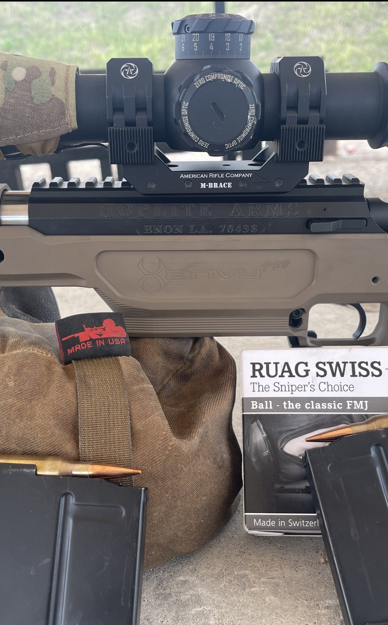

Just received my ARC M-Brace today and as others have said, it feels well built and solid. The primary reason I chose this over other mounts was the larger single screws that could be torqued more than 2 or even 3 small screws. I have to wait until Christmas until I can put my rifle together but the M-Brace and Vortex Razor Gen 2 will make a great combo.

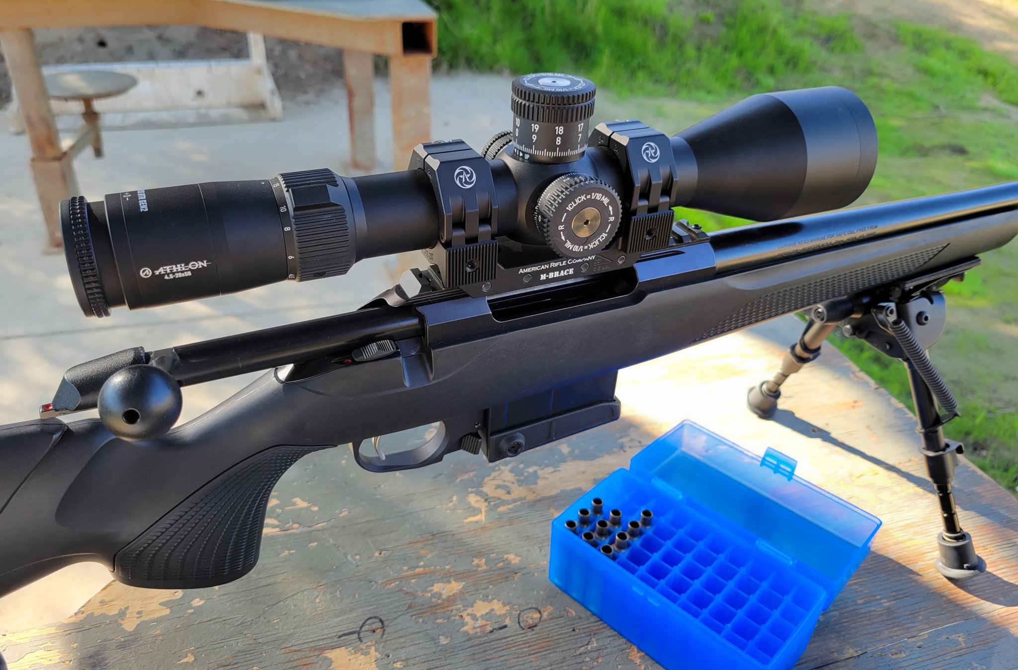

Grabbed one. If it works as good as I think it will, I’ll move to all M-BRACE on my bolt guns.
I have a Sphur QDP and I have experienced some rare zero shift and ultimately I’m not sure 100% that I can trust it.
