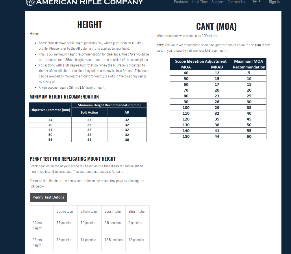

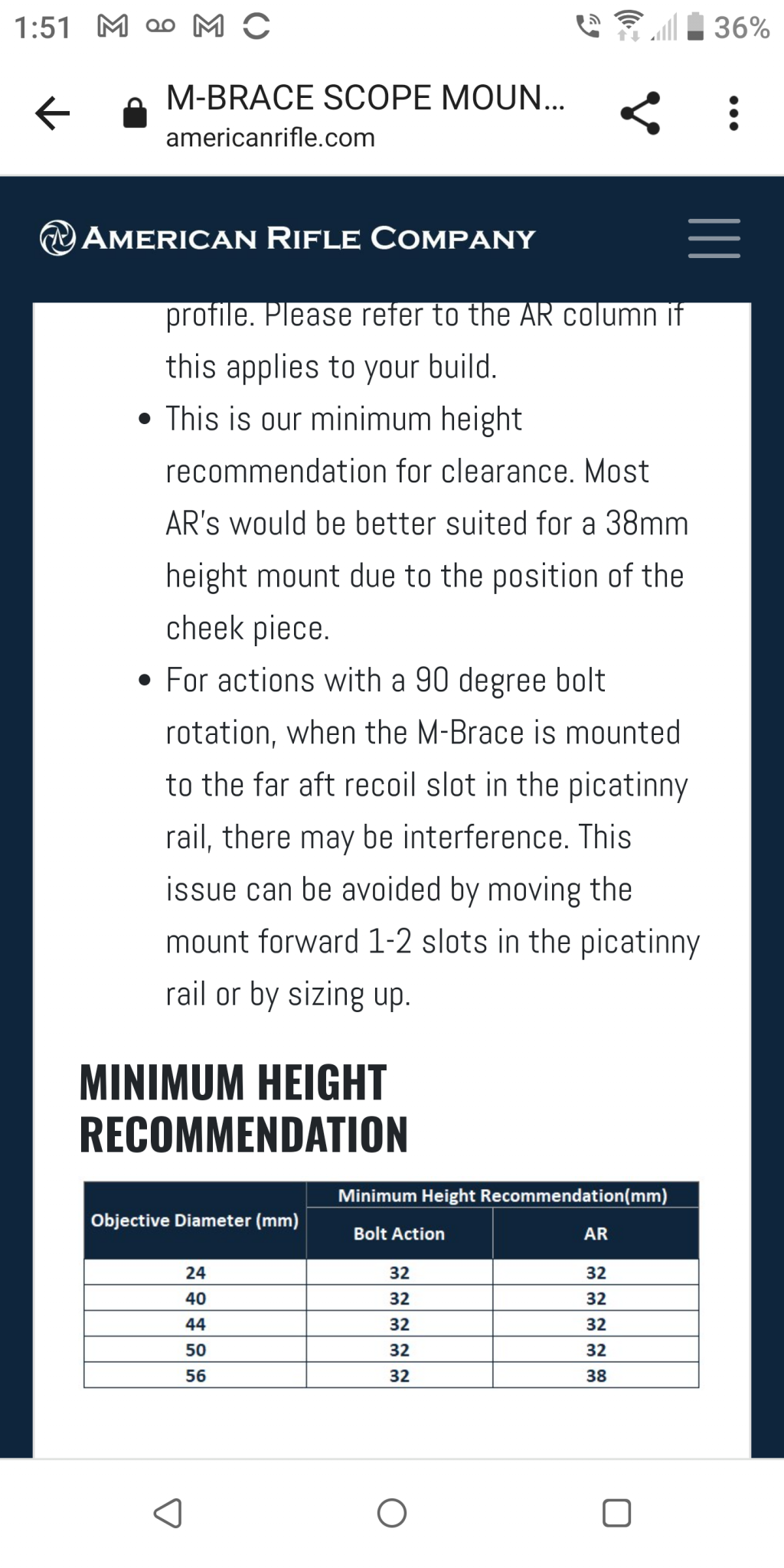

I went with 1.5", probably more personal preference, just make sure the front of the scope will clear the barrel. With the 20MOA, 1.5", still could fit the Tenebraex flip cover on the front of my ZCO shade, I don't think it would have fit with a 1.26"

I have a tikka in a bravo. In the past I have been running 1.2ish height rings and recently swapped to 1.5” rings. I have found I prefer the taller mount to get a more natural vertical head orientation. Much more comfortable to shoot for me. I also changes from a cheek bone weld to a jaw bone weld.
That's just a link to where to the site. Opening the link resets anything you clicked on to the pages default. IOW that isn't an answer.

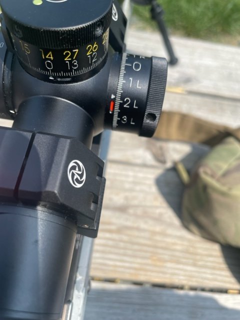

I went to Arena Training Facility this weekend to shoot the unknown distance range - goes to 2300 meters.
With my 20 MOA base and my M-brace 10 MOA mount and my Burris xtrIII mil, my max vertical dial up was to 21 mil. I needed ~25 mil to hit the 1 mile target. So for this, I would need 30 MOA base, or 20 MOA m-brace mount.

As far as the cant of the mount. There is really no down side to a 20moa mount. Depending on how far you want to shoot, what scope you anre using and with what cartridge you will most likely need atleast a 20moa if you’re going 1k or farther.
Easy to figure out. Look up the specs on your scope for elevation travel. Cut it in half now run the ballistics on your rifle at the range you want to be able to shoot too with a ballistic app. Is half your scopes travel enough? If not choose the appropriate cant rings or base to give you enough travel. And yes I know that 1/2 the travel is t exact but will get you close enough to have an idea.
I was looking at a Leupold Mark5 5-25x which has 35 mils of total elevation adjustment. Looking the Hornady ballistics app and older posts of member's experiences, it seems like I would need between 11-13 mils of adjustment at 1000 yards for a 308. I would have around 4 mils to spare if I don't get a 20moa mount. Because of the ranges around me, the typical distances would be much closer (100-500 yards). But I would like it to be able to reach 1000 yards if asked. I think keeping the Tikka's 0moa base and getting a 0moa mount/rings will work out. I'm assuming the 2000 yard range thats far from me has the option to have closer targets.
I agree with Rob, get a 20moa. It doesn’t cost you anything extra vs a omoa and you won’t have to upgrade in the future should your cartridge, or range change in the future. All my nice rifles have 20moa base or mount. You can still easily get your 100 yard zero and stretch most of the common cartridges out to atleast 1400 yards. Literally no down side.
There's no reason with that scope not to get at least 20 MOA in the mount. Won't hurt anything and give you more elevation. Personally I would go with a 40 MOA mount with your 0 MOA base, that would give you about 28 mils of elevation.
I agree as well... 40 total for me - Richard@CST

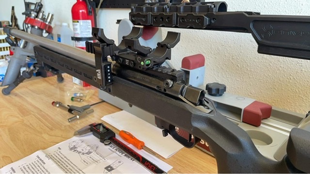

This is an in depth review of the M-Brace and the only issue that he makes note of is the lack of washers on the rail bolts. One of the screws dug into the side clamp and removed the anodizing, possibly down into the aluminum.
So, I like this guy’s videos. I don’t have time to watch the whole thing right now.
Did he lightly oil the bolts AND their mating surface? Because that’s in the directions.

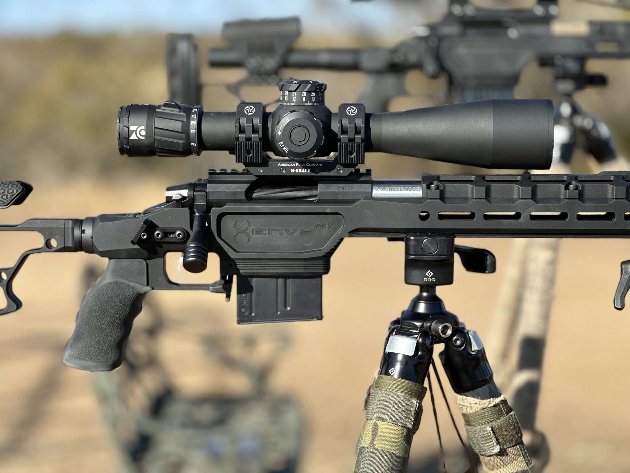

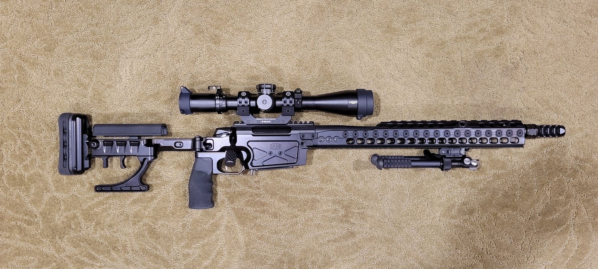

M-Brace on Spuhr SICS . Proof we all can get along 😆.
Looking forward to a red dot and an ACI M-Brace mount 😉

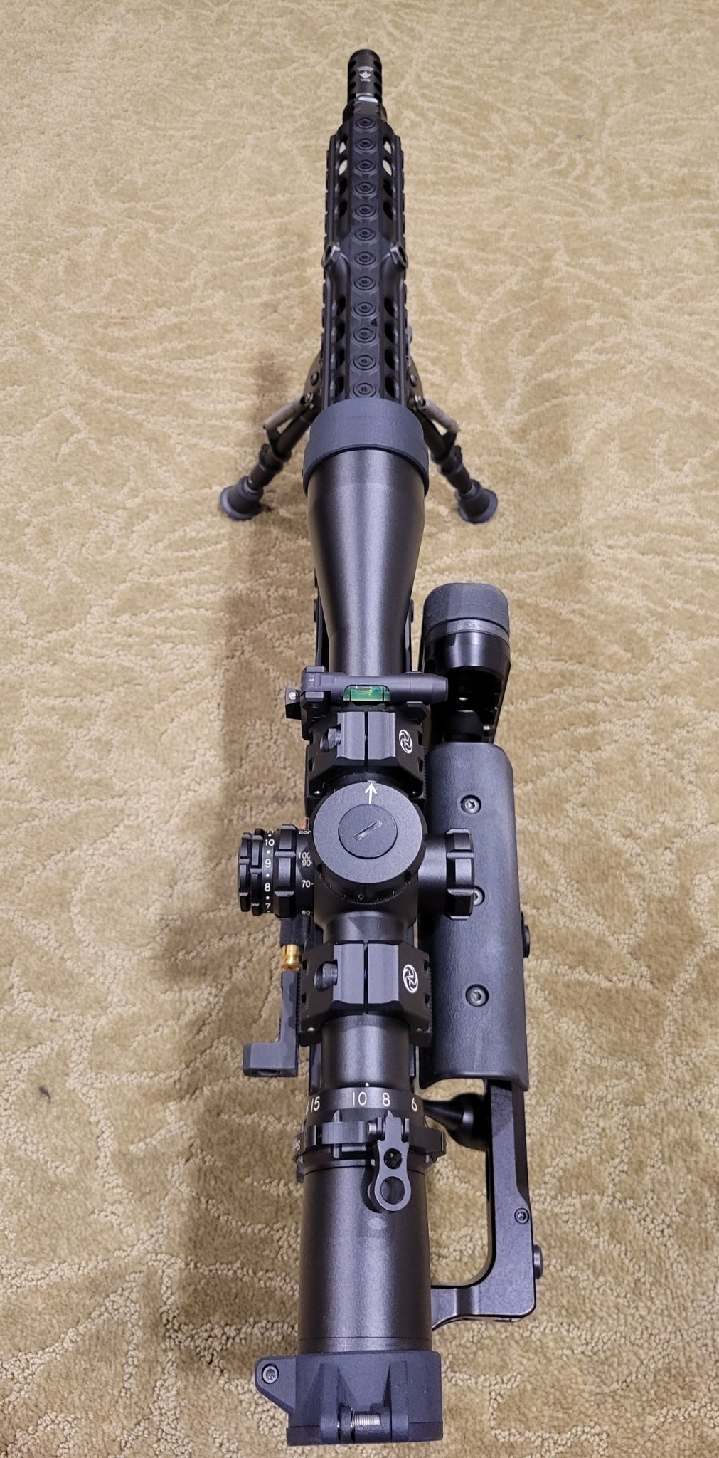

I want a accessory mount for the MDT Send It Level... hint hint anyone. But the mount is great and I would buy another before any other.
I run the sendit vertical on mbrace, just mount on the pic rails on the side. Or get the lrf hood with pic rail and mount atop. Since the brace takes up the least action real-estate of non cantilever uni mounts, put it on the action rail out past end of mbrace, lots of options.
Actually after checking out the review on YT, the reviewer pinned a note in the comments that says:
[link to 11:40 in vid] This is why the scope mount was gouged: One of the bolts (that one) had a factory defect, and the face was not flat. So when tightened, it acted like a drill. After watching this video, I inspected it closely. That fourth bolt had a mangled-in edge, causing a pushed in scallop, and was clearly a manufacturing defect. I'm writing ARC about it now (12/8/22) to see how they handle the warranty claim. I'll keep you updated on how they respond. Good catch!

If I was home. Work project, gone for a few weeks. I surely can when I get back. The sendit is designed with internal switch to operate horizontal or vertical. Arc sells a pic rail that interfaces with the serrated points, axially with scope tube. I just throw sendit on it vertically oriented on support side of rifle. The lrf bridge is pretty tall and has sendit a bit out of normal fov. If you have 2 or 3 slots left on your action rail in front of mount towards muzzle, put it there as the sendit is easier to translate in horizontal position. I do this most the time.
I think I understand but a visual will be nice if you remember. I also intend to run it with the brandt built optical piece. Running vertically makes it easier to pack away I'd imagine.
I run same sendit on several rifles so it's always removed after use. Brandt built lights are cool, novel idea. I played with one, found it distracting. I shoot both eyes open as my R eye is overly dominant. L eye sees enough sendit lights that I can level rifle while settling into bag and getting on target. Works for me, but that's the great thing about this industry, so many options to tailor to one's use or desires.
