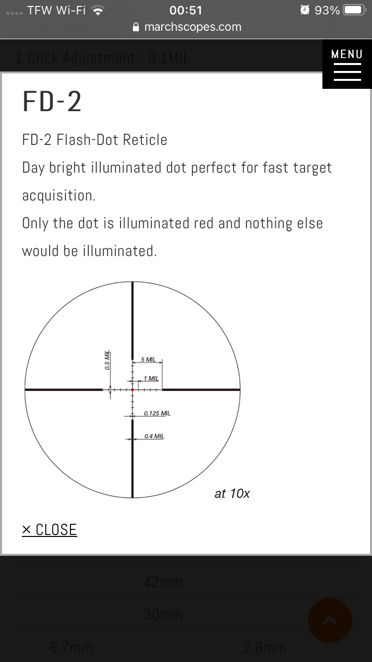

Can any of you math wizards tell me what the equivalent subtension values of this reticle is on 15x?
From the image we can see at 10x each hash is spaced 1 mil apart.
At 5x I’m assuming each hash would be 2 mil?
At 15x I’m guessing each hash would be 0.5 mil?
If so that would give you 2.5 mil of windage to play with at 15x.
If so that would give you 2.5 mil of windage to play with at 15x. View attachment 7650366
1mrad at 10x SFP is 2mrad at 5x and 0.67mrad at 15x
