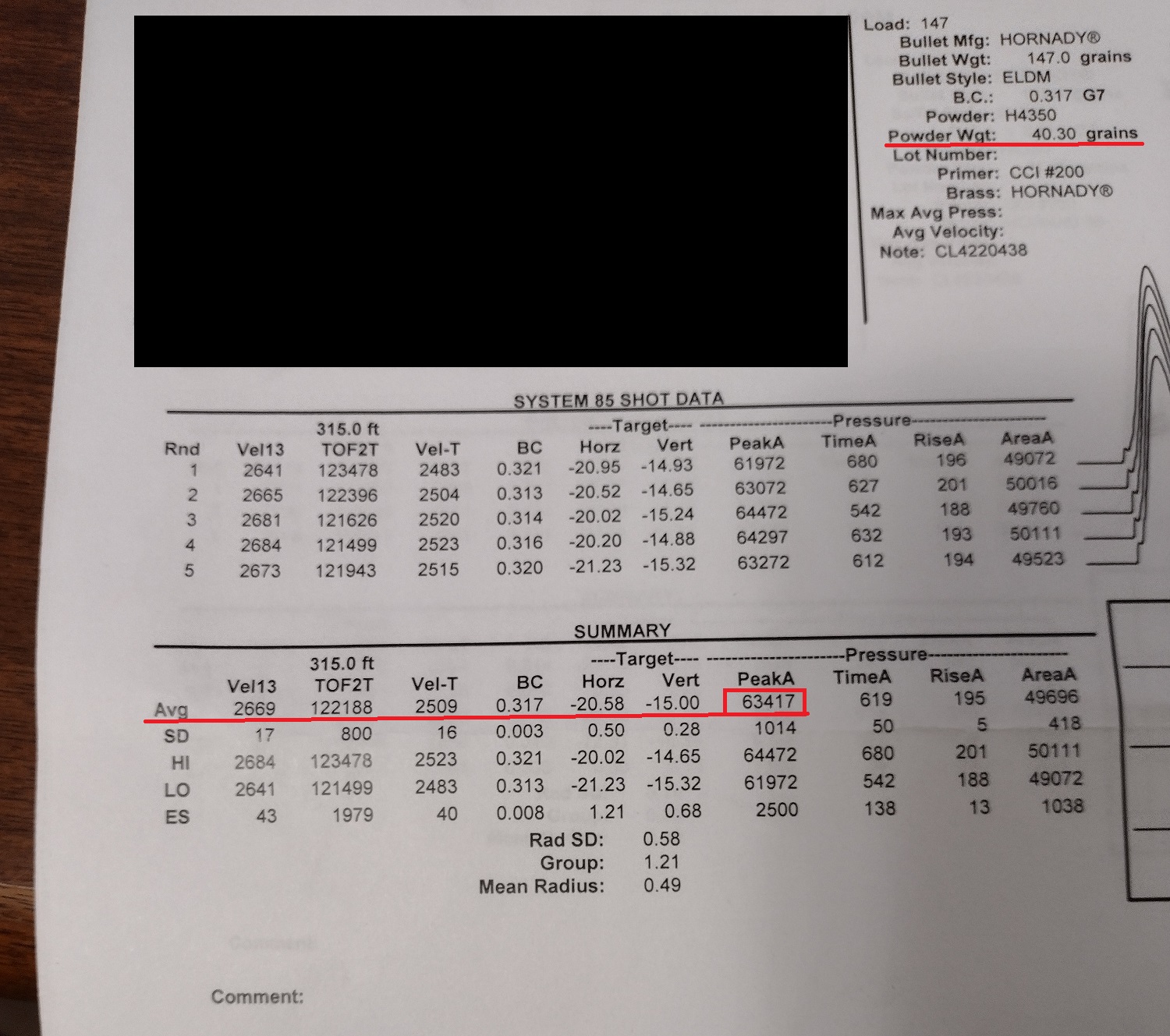

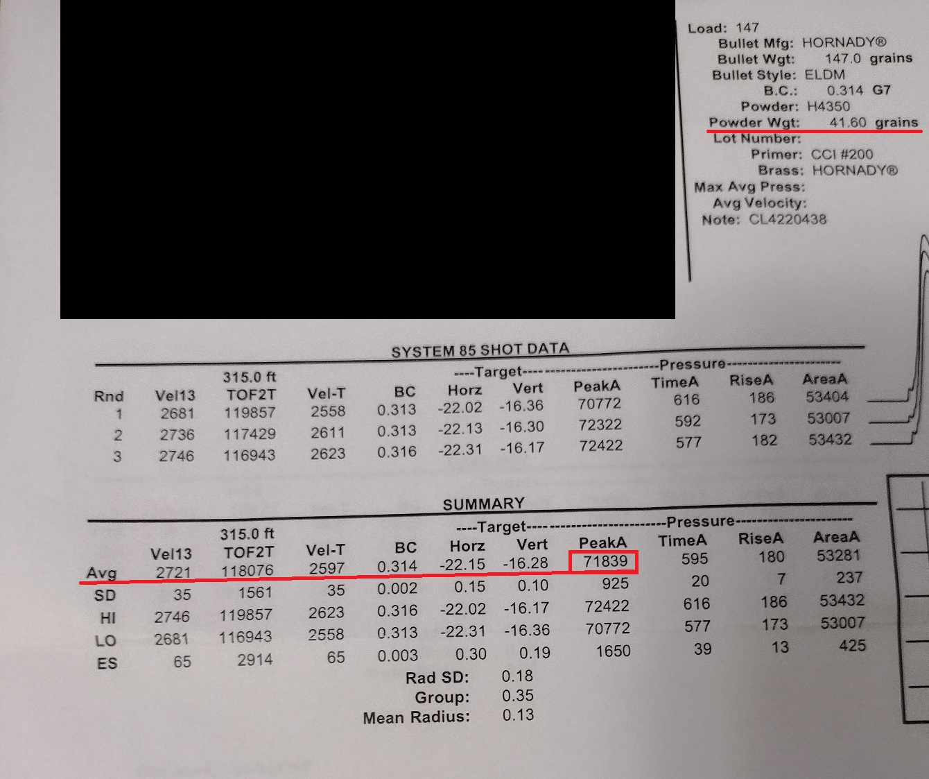

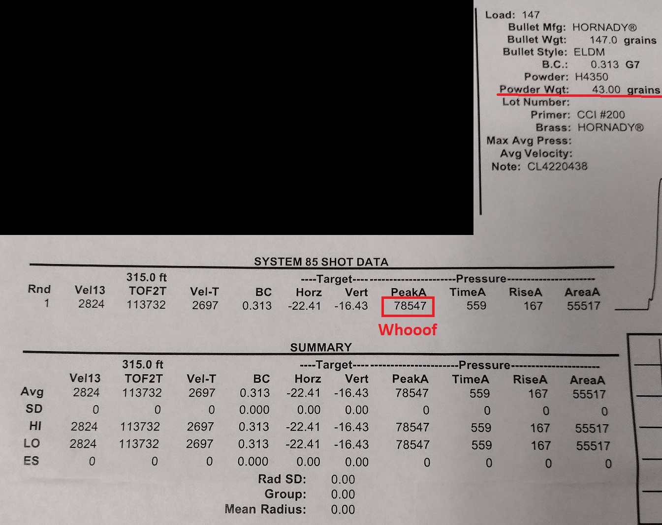

Doubling down on ignorance, nice. What are "safe operating pressure levels"? How do you determine/verify what those are?
Loading manuals from way back in the day were using copper crush pressure measurements, which are a pain in the ass and less accurate than the current piezo transducers. Never mind lot-to-lot variation-- hell even using the same components but swapping two different bullets of the same weight can change pressure by 5000psi or more.
The lawyers' portion of the book is in the front where they say something to the effect of "This is data that we generated with our test equipment and it may or may not exactly match what your rifle/components/lots produce, proceed at your own risk, start low and work up. We're not responsible for your failed experiments".
Then a lab technician proceeds to incrementally step up powder charge until they reach SAAMI MAP, and accurately record pressure, charge weight, and velocity with a fixed chronograph, piezo pressure and velocity gun in a universal receiver with case calibration and pressure/velocity offsets for that barrel based on reference ammo. That is the data that makes it into the handbooks.
You do whatever makes you happy, but at the end of the day you have no skin in the game and it's irresponsible to suggest that people can exceed published data at will with no repercussions-- especially when you're displaying a complete ignorance of the manner in which the published data is collected and reported. If/when someone follows your advice and breaks something, your only offer for rectification will be a lame statement like, "Well, that shouldn't have happened."
My first-hand testing with calibrated pressure and velocity test barrels showed that "flat" primers (subjective) show up anywhere from 65-72ksi. Light ejector swipes show up anywhere from 60 to 74ksi. Stiff bolt lift is anywhere from 65-80ksi. The signs of excessive pressure on the gun, case, and primer almost guarantee you're over SAAMI pressure, but you can in some circumstances run at 70,000psi +/- without seeing shit. Which may or MAY NOT be okay. The actions are designed for SAAMI with a safety margin. You don't know the limit of the safety margin, and you don't know the operating pressure without testing it... Not a great place to be.

Well here's what I found out sitting at the kids' table...
This is what happened in the barrel I tested with, with the components I used. I'm not suggesting and can't guarantee you'll get the same results with your stuff in your rifle.
Latest Hornady manual publishes 40.3gr as the max charge for H4350 in the 6.5 Creedmoor with 147-153gr match bullets... So let's see how "Lawyer loaded" it is... "PeakA" is the peak pressure of the shot. SAAMI MAP is 62,000psi for the 6.5 Creedmoor. 55-65ksi is typical across the board for modern brass cased rifle stuff. These are all at 2.800" COAL.
Oh... Turns out it's not pooched for the "litigious environment"... In fact, almost every time I've tested various book max loads in several different cartridges, they've been right at, if not slightly over SAAMI MAP.
Now let's go to the Sniper's Hide to find our good data... In fairness, I'm using a different bullet and case so results may vary a little, but it does raise an eyebrow.
I was playing with 153 bergers this weekend.
Lands were around 2.966
OAL: 2.935
Lapua Brass
BR4
H4350.
Ladder test from 39.8 to 41.6 No real preasure signs or heavy bolt even at the upper end where I know its around 66K PSI. Was shooting in 35* weather so that helps.
Going to settle on a 40.8 and start playing with seating depth. Got 2650 out of a 23" barrel.
I am curious how you know it's around 66ksi, though. I saw another mention in that thread from you stating that published load data is watered down. I really want to know what source you're getting that information from.
And for shits and gigs I found another post in there with someone else (actually a couple people IIRC) loading up to 43.0gr of H4350 with a Hornady 147 and I only shot 1 because at this point I was a little afraid of damaging a transducer. Obviously the guy posting this also has "no pressure signs or hard bolt lift"... :rolleyes:
And now some rambling...
Hodgdon currently lists the 147 ELD-M + H4350 combination at 60,800 PSI at 41.8gr.
They list the 143 ELD-X + H4350 combo at 61,200 PSI at 41.8gr.
But the 143 is extremely similar in its external shape/dimensions to the 147, yet 4 grains lighter... They also list the 140gr class bullets at a max of 40.0-40.4gr...
Are they wrong? No. Probably not.
When they tested it, with the lot of powder, at the humidity level they tested it, that's probably exactly what their test barrel/system spit out.
Anyway, it goes to show that there is some lot-to-lot variation. That should go without saying-- any reactive chemical production is going to have variation-- not all 91 octane gas is the same, not all H4350 is the same. There is variation in chambers, bullets, cases, etc... You can certainly see a rise in pressure based on fouling levels. There are a multitude of reasons why the same ammo will produce higher or lower pressures, and those numbers move around a little with manufacturing of all of the components. That's why every reloading manual ever states to back down and work back up after changing any component........
The point I'm getting at is that the published data is (with rare exception) correctly acquired and truthful. This myth that it's "Lawyer loads" needs to die, right along with the phrase "No pressure signs", because it obviously extremely subjective. If you want to reference multiple manuals and game the game using the largest published charge weight you can find, whatever... But going multiple grains over published max loads is asking for trouble in pretty much every case. Using unverified, untested load data off of the internet is also a sketchy endeavor as far as I'm concerned. You'll have some guy telling you 44gr of Varget with 62g solids is hammering in his 22 Creed-- "No pressure signs at all"... lol
YMMV, your gun your face, etc... Hopefully this was informative.

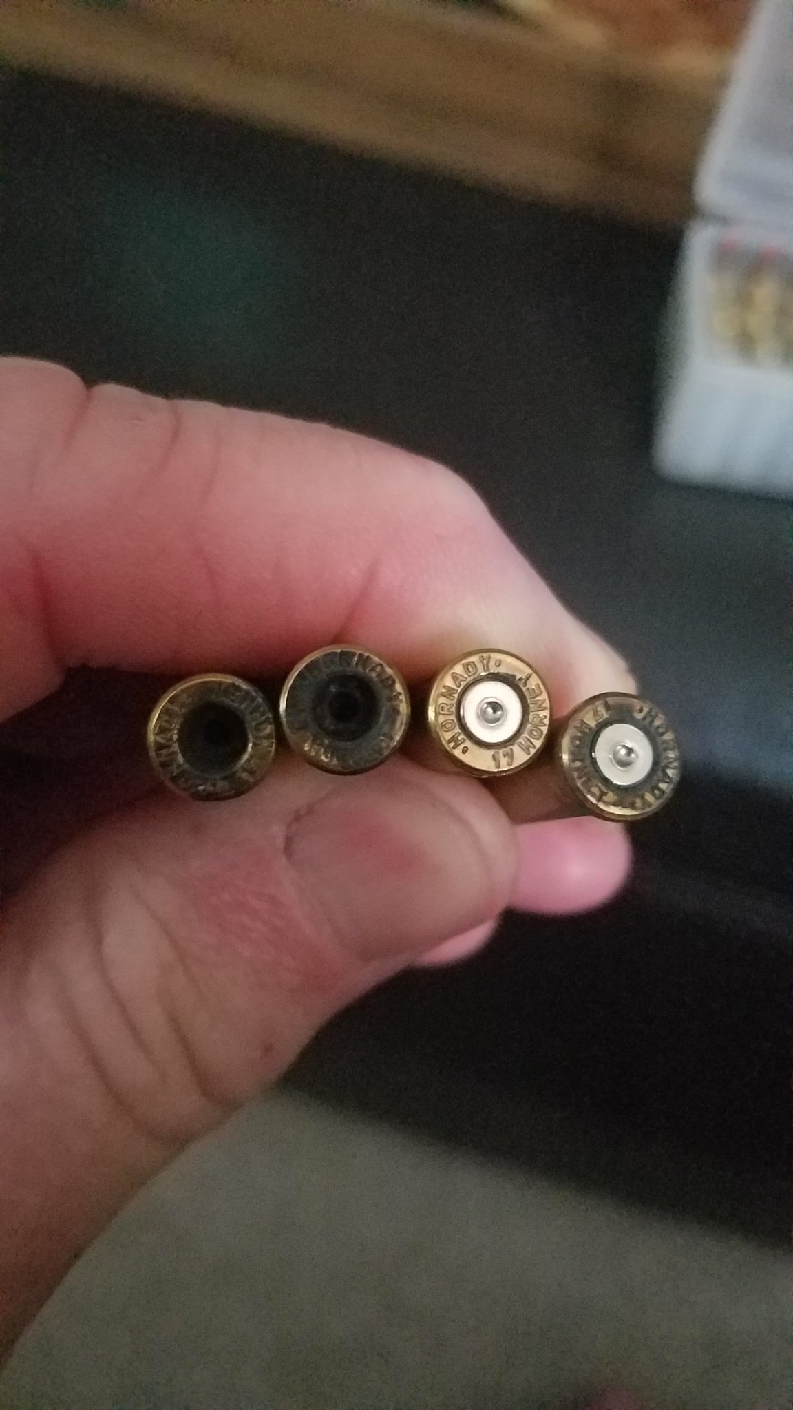

I shot these a few years ago. No hard bolt lift, no ejector marks and the primer cratered just a little.
Normal load but accidentally grabbed bullets that were only 5 grains heavier.
5 grains heavier, that's it.
Now, for the rest of the story.
Cartridge: 17 Hornet
Brass: Hornady
Primer: WSR
Powder: AA-1680
Bullet: 25 gr V-Max
5 Grains did that?
It sure as hell did.
5 Grains doesn't seem like much, but in the 17s that's a 25% increase in bullet weight.
That's enough to go from a normal load to excessive pressure. Enough to blast out the primer pockets.
Thankfully the CZ 527 vents gases very well. So well in fact that I was unaware of the issue until I picked the cases up.
How did I make this mistake?
Simple. I had 25 grain bullets in the space that is allocated for 20 grain projectiles. The boxes are identical too. Well, except for the fact that they say 25 Grain... The 25 is also a flat based bullet, so the pressure it produces is much higher because of its bearing surface is longer.
I should have noticed the difference in the projectile. I didn't.
I should have looked at the stupid box.
I didn't.
The Hornet cases operate at a much lower maximum PSI than most other rifle cartridges. 50-55ksi will destroy the little pieces of brass.
That created a pretty good safety margin for myself, the rifle and everyone that was near me.
The brass didn't fare too well as you can see by the image above.
Now for those that still think internet posted loads are fine to use and that lawyers decide what is published, go back up and re-read what @Ledzep posted.
Look carefully at the data provided and if you can see it, look at how quickly the data goes from zero to 62ksi.
Do you really want to play around with 75-78ksi next to your face?
I used to play around with our test barrels and you'd be surprised at how quickly a load can go from safe to oh, shit levels.
Hell, just set your loads in the bright sunlight for ten minutes and shoot a couple of them.
Did you have a little sticky bolt? Yeah, but you blow it off.
Now take that same 43gr/147 load and bake it too.
You put yourself straight into possible catastrophic pressures and you risk damaging your rifle not to mention your face and hands.
You're getting into proof load territory. The rifles are not designed to withstand a diet of that.
We try to be smart and develop loads that are safe in all weather. With that development comes a bit of margin for error like bright sun, and maybe letting a round or two sit in a hot chamber for a minute before firing.
When you are playing around with loads that are clearly above normal safety margins, you leave yourself no room for error.
You're asking for trouble and it'll eventually find you.
