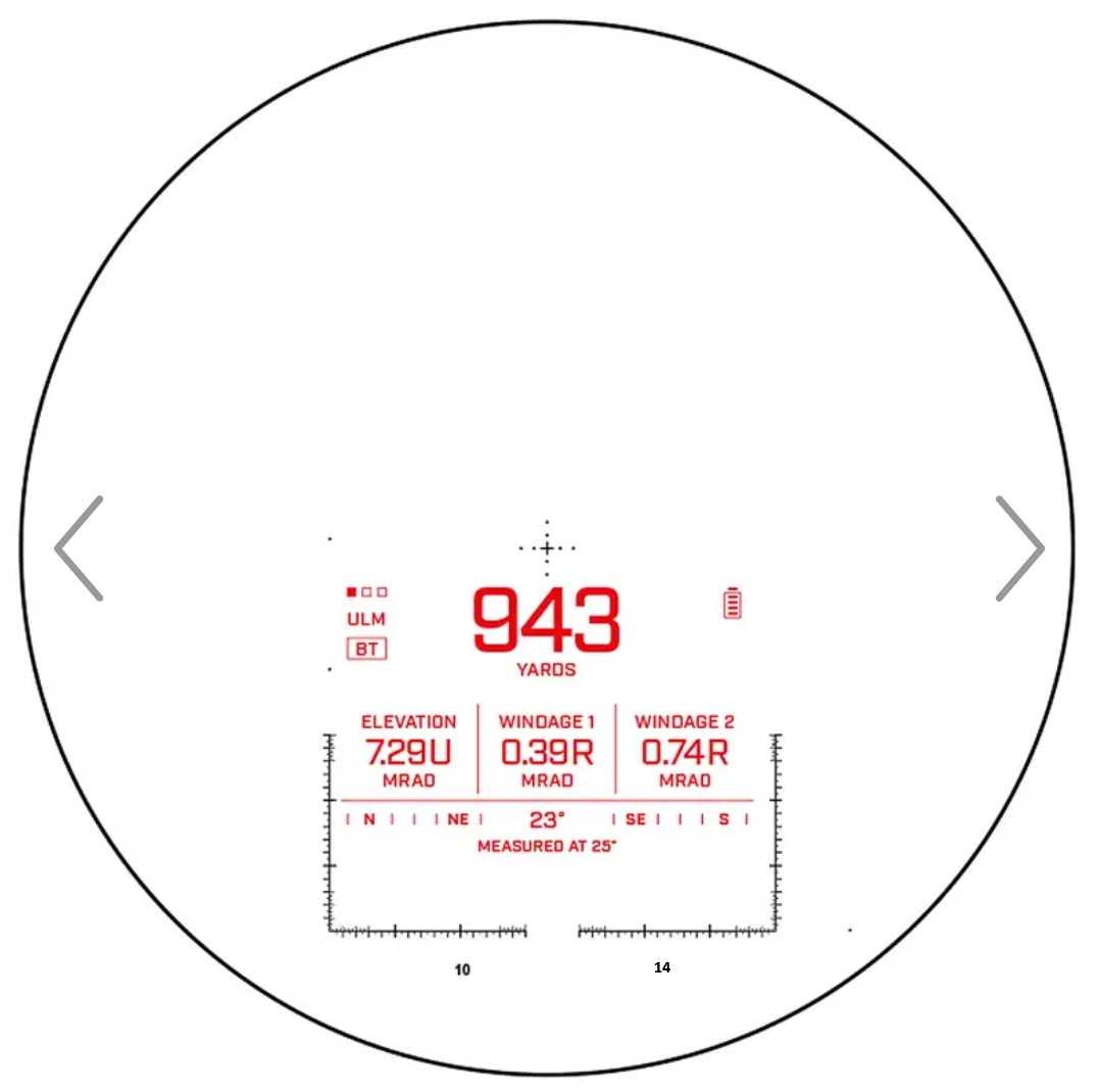

I have scoured the product pages. I am trying to figure out if each model with 8x 10x and 12x with DMR reticle. Has the appropriate scale for use with the range enhancers. It seems only the 12x model is shown. Can anyone confirm?
Looks like the MSR-DMR has dual reticles, one accurate for the base magnification and one accurate for the magnifier, while the MSR-SMR only has one simpler less cluttered reticle accurate for the base magnification.

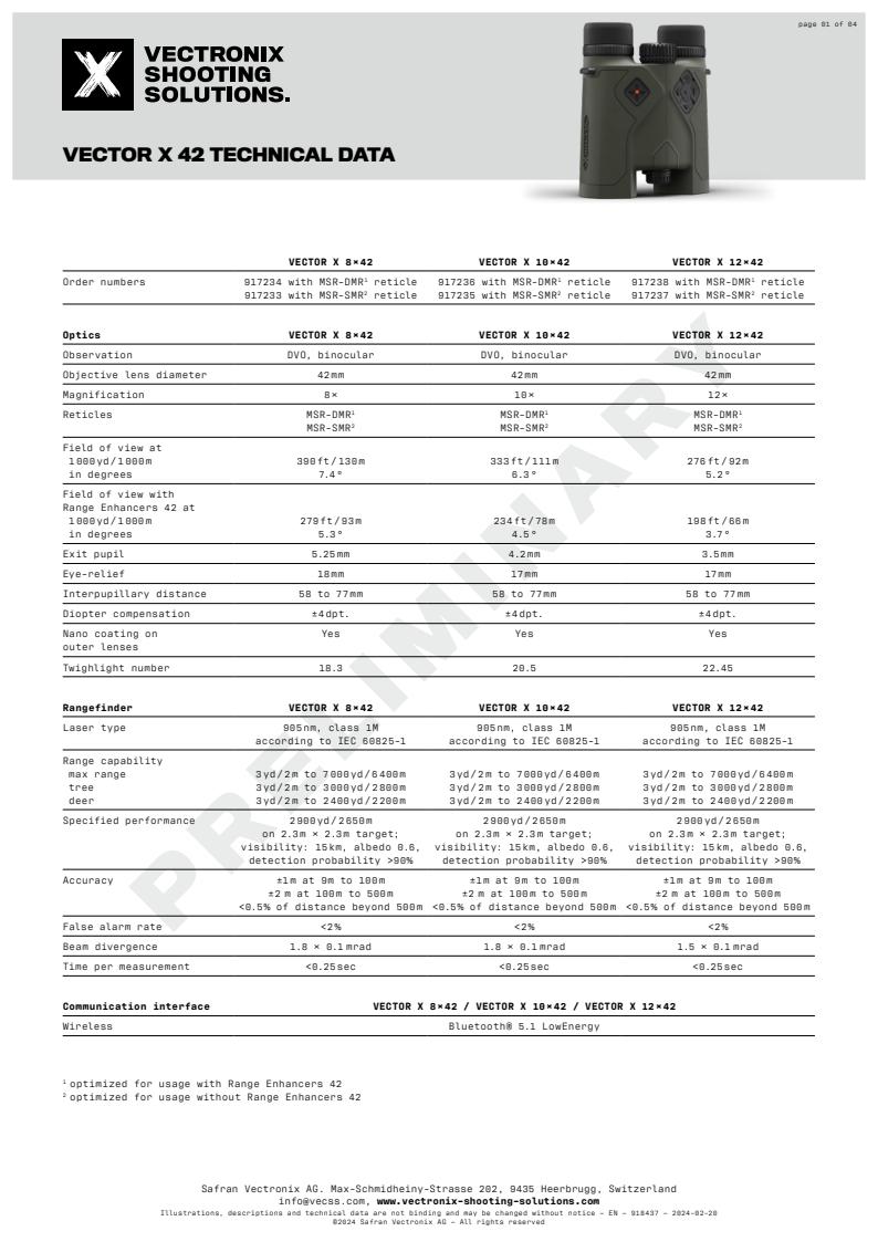

I have some more information about these to share as well as their preliminary spec sheets. Frank and I have been in contact with @Philip_at_Vectronix about this product and I will be doing a review of it later this year along the lines of the Leica Geovid pro and Sig 10k reviews a couple years ago.
The first thing to strike me about the Vector X's is that they will be competitive with the 10k's in maximum range. I had mentioned in the EDC podcast on electro-optics that me and Frank did a while back that there would be more such rangefinders following the 10k's and this is the first of those. Though the spec sheet lists the Vector X's as having a max range of 7k yds and not 10k yds, that max range is not a memory hard stop such as 3k meters appears to be on the Leica Geovid Pro's. The Vectors can return ranges further than that and I have been told they will match or perhaps slightly exceed the 10k's.
The second thing to strike me was the value of the Vector X's in the dual role of spotter / field binos. With the screw on "range enhancers" each of these models is boosted to 1.4x it's original magnification. This puts them squarely in spotter magnification range and, with the aid of the tripod adapter RRS is making and the dual reticle option (the left reticle is calibrated for base magnification and the right one for magnification with range enhancers) the Vector X's should make a magnificent spotting scope replacement. I understand most match guys are already using high powered binos in this role anyway. How much better to have the LRF and ballistic solution baked into that, especially in team matches. This struck me as a huge winning feature. Of course, without adding these things, the Vector X should perform quite well in a hunting role.

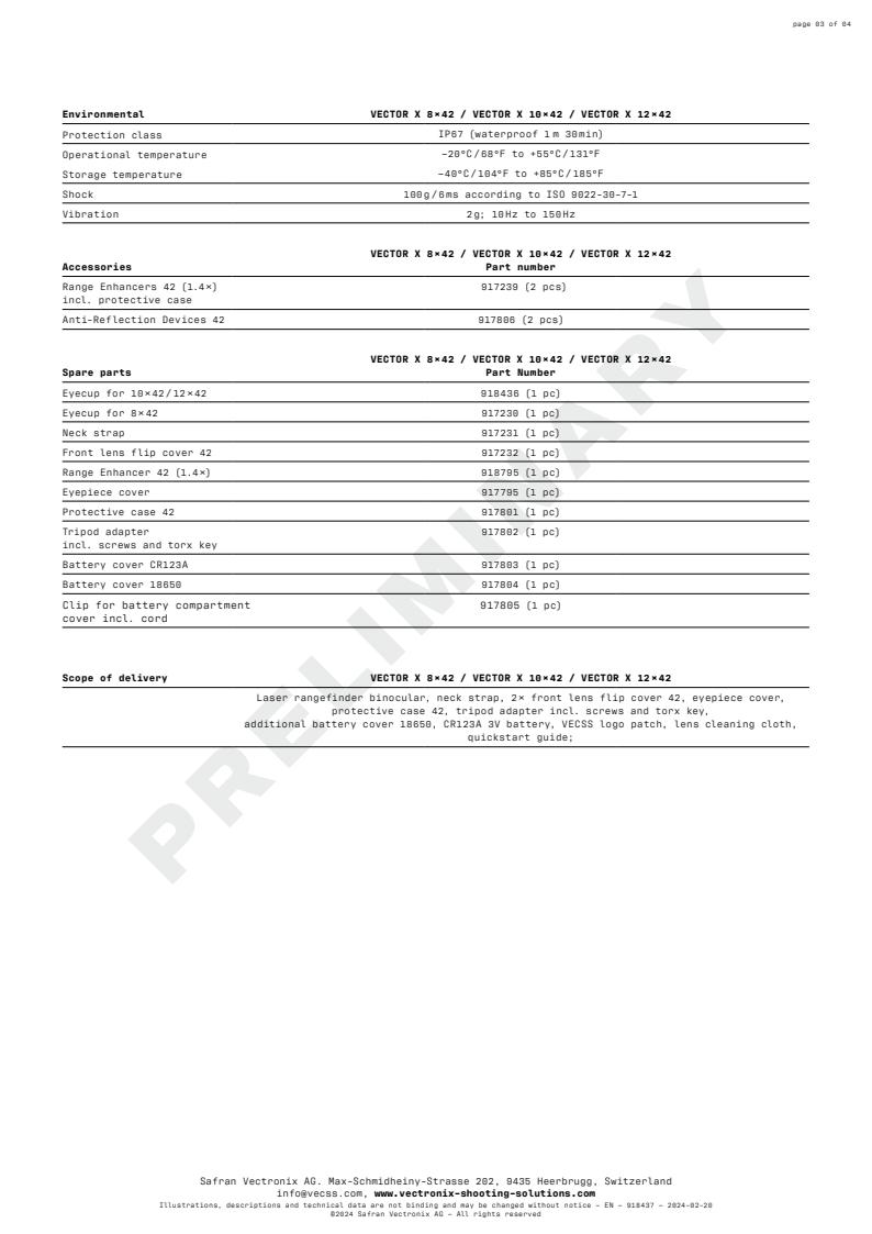

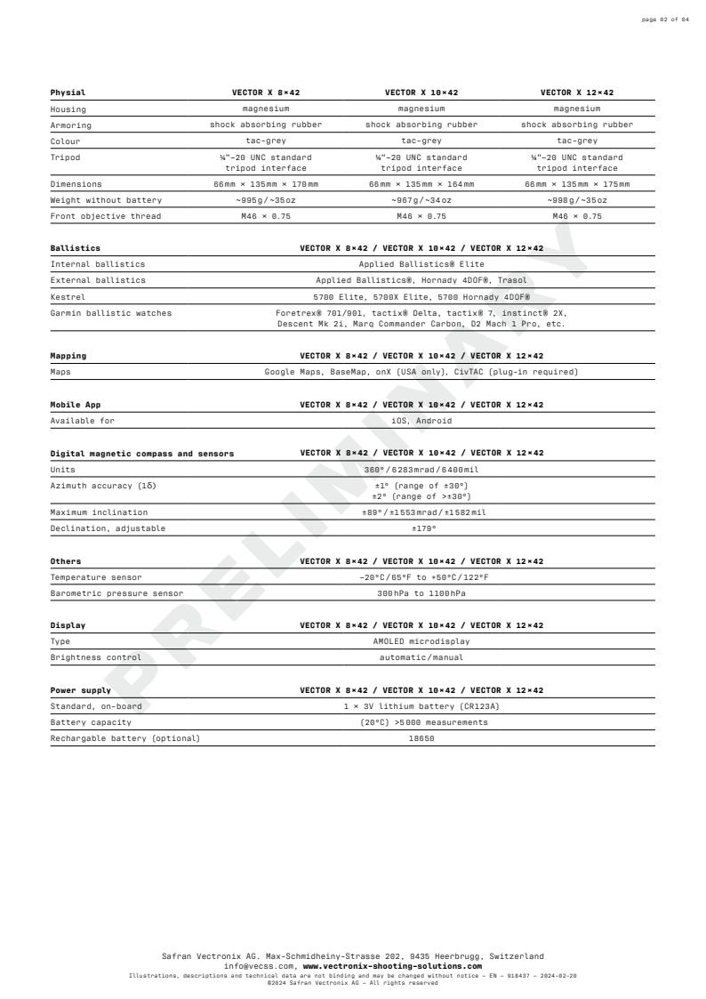

Beam divergence conflict for 10x... Jim and EO show 1.8, this thread shows 1.5.
@Covertnoob5 any clarification?
Edit: answered.
Also, assuming the dimensions (height) is swapped between 8x and 10x on Jim's posted doc... i.e., the 8x is 164mm and 10x is 170mm?
The DMR is available with all mag ranges
Lastly, the Vector X has a lot of choices in device integration. You can even leave the AB ecosystem if you want and do 4DOF or Trasol. You can also integrate the Vector X's with a lot of other devices such as garmin watches, the DRS gun mounted display, Kestrels, and the affor mentioned AB Calipso wind meter.
Kind of. The device will export Range and Azimuth but it will not export much else under the Vectronix TDH Protocol into non AB apps. It won't allow anything outside of that. The information cannot be transferred back into the binoculars outside the AB Ecosystem either, so its one way when using that. And, when exporting to the other apps the Binos will still display and function only in the Applied Ballistics system (Including they will continue to display the AB firing solutions), so they are still going to populate and function as the AB Solver when exporting to those, they just won't transfer any of the relevant data (Ballistics, Environmentals etc) and won't allow data to come back in from other sources.

Yes sir, I understand stand that. If you look at the reticle (DMR) the left and right show 12x and 17x scales. This for the 12x model. My question is. Do the other models have the appropriate scale correction. When using the range enhancers. I am assuming they do but I haven’t seen any reticle images of the 8x or 10x DMR’s.
Yes! All the models have individual scales for the Range Enhancers
Yes
Yes, all mag ranges with the DMR scale with the rang enhancers

Their website says 1.5 x 0.1 for 10x and 12x and 1.8 x 0.1 for 8x
The spec sheet I posted has preliminary stamped across it so presumably there is some stuff on it that may be non-final or at least not double checked. To further muddy the water, my notes from my conversation with on the subject with Philip say the 1.5x.1 is on the 8x and 10x with the 1.8x.11 on the 12x. When I shoot him an e-mail next I will be sure to ask for a clarification but I expect that since he is busy releasing this product at IWA right now, it will be a bit before he is on the forum or answering e-mails.
Be interested to see how good the compass is to drop pins on the Basemap app
This was one of the things I asked. The compass sensor is +_ 5degrees on it's accuracy. Philip said this is the fancy good tiny compass sensor but not the much more accurate system they use in their military models to allow for weapon targeting. Outside, without a bunch of interference, the GPS component of the drop pin system will be quite good, 5 meters or so, as GPS is that way now days and the range measurement will be even better than that. It is the compass sensor that limits these things from a practical standpoint.

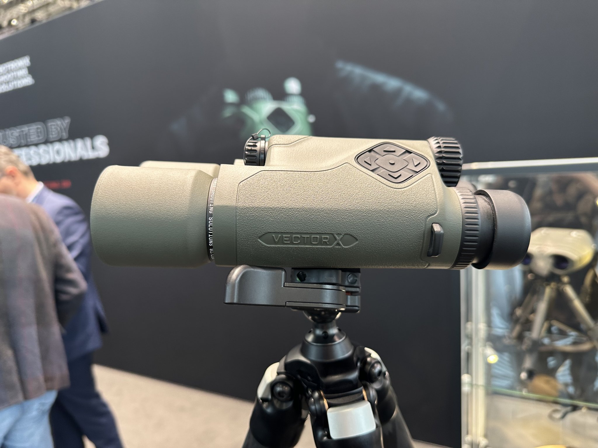

The binoculars look and feel amazing! Had a chance to play around with them a few months ago, we think they are going to perform awesome.

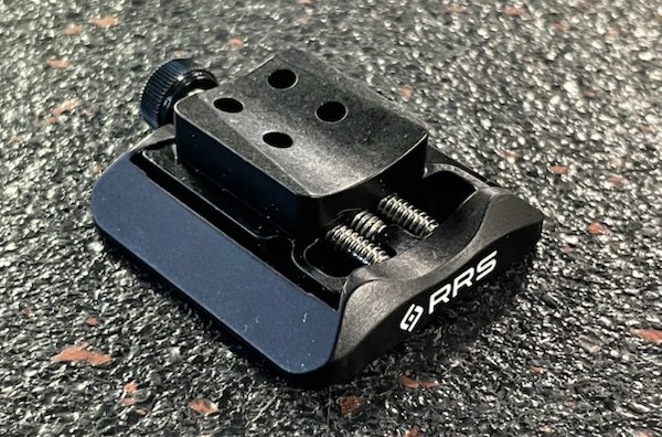

The RRS Vector-X Mount will be available upon release of the binoculars to the public, through Vectronix Distributors.
The "Vector-X Mount" was made specifically for/in conjunction with Vectronix for the tripod designed mounting ports. Includes a tension knob to remove cant caused by adjusting the Pupillary distance.
Attached are photos of the Pre-production testers.
View attachment 8361160View attachment 8361161
View attachment 8361167View attachment 8361154
Is there going to be a mount that will allow attachment to a Arca clamp? Since most users have Arca clamps on their tripods that would seem like a good option.
Edit: disregard, the wording on the RRS mount made me think it was a proprietary pattern not the standard 1.5” dovetail which should work with any Arca clamp
The spec sheet I posted has preliminary stamped across it so presumably there is some stuff on it that may be non-final or at least not double checked. To further muddy the water, my notes from my conversation with on the subject with Philip say the 1.5x.1 is on the 8x and 10x with the 1.8x1.11 on the 12x. When I shoot him an e-mail next I will be sure to ask for a clarification but I expect that since he is busy releasing this product at IWA right now, it will be a bit before he is on the forum or answering e-mails.
Roger that, I had a feeling some specs might be out of whack, often the case with brand new releases and trying to get information up in a hurry.

Will the cinch work on the 12x? Looks like there might be enough room?
It will fit yes, but it will be at the extreme end of the housing. We looked at just offering the Cinch for it as it is already an item we have, but with the weight and location, the custom adapter was definitely a must.
