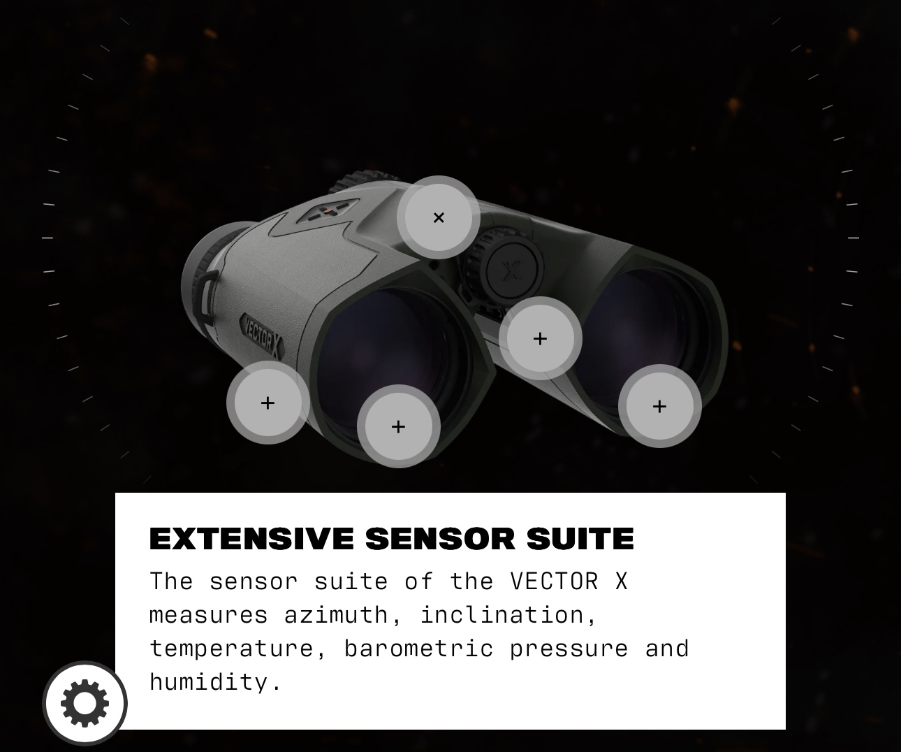

So is there any onboard atmospherics or does it have to use the Kestrel?
Yes there are.
