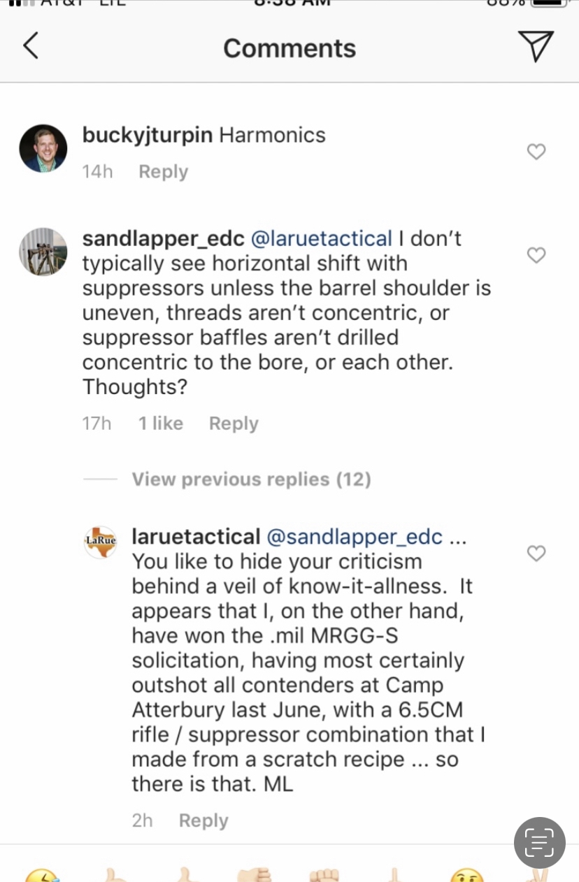

And this right here is a prime example why I can't stand this Dickhead...
Completely uncalled for behavior, the dude just shits on his customers without fail. Any other manufacture would have said.. "Hey sorry to hear about the delay on your $400!! Knife Order, send us a Email or give us a call and we'll get your order squared away"

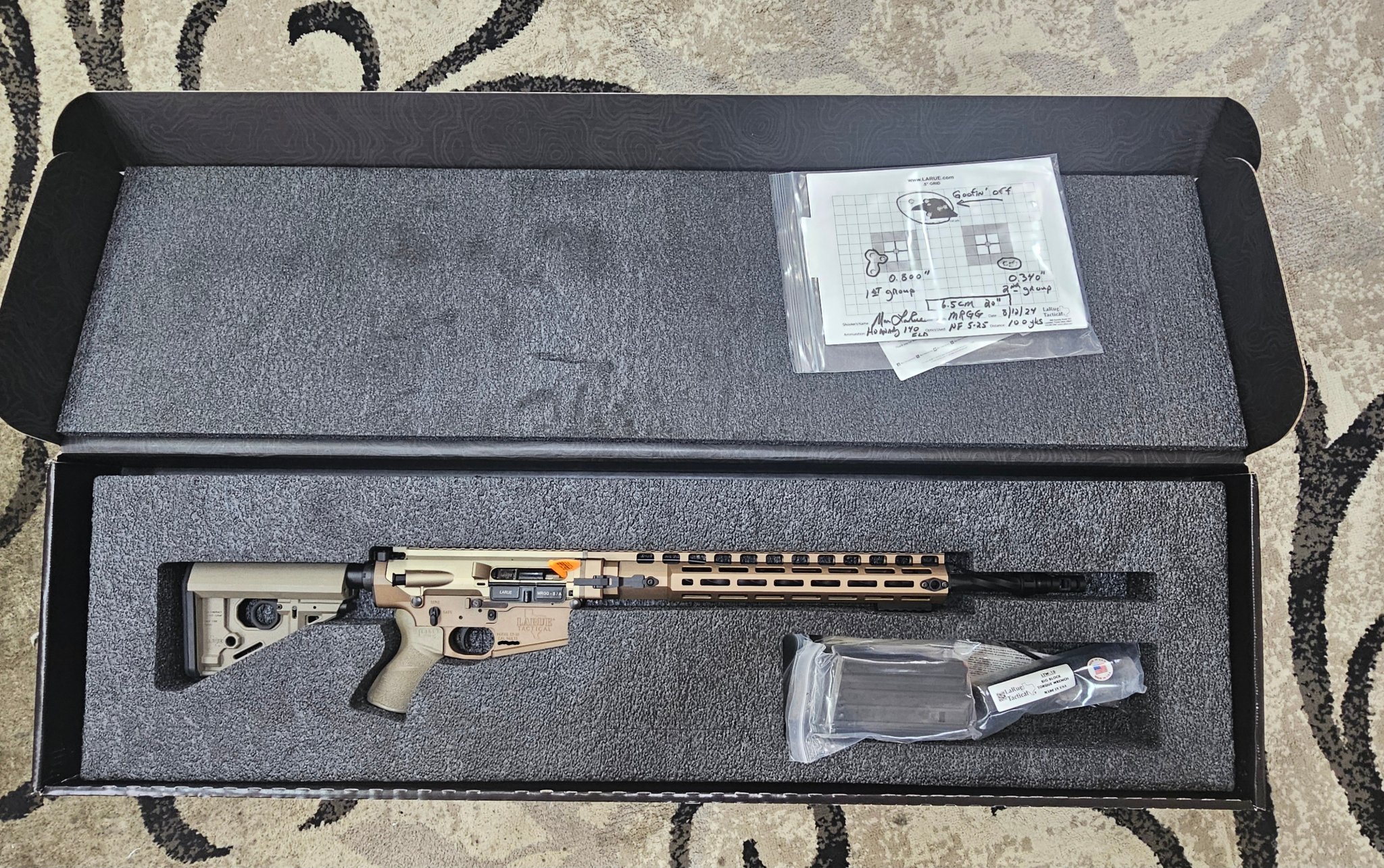

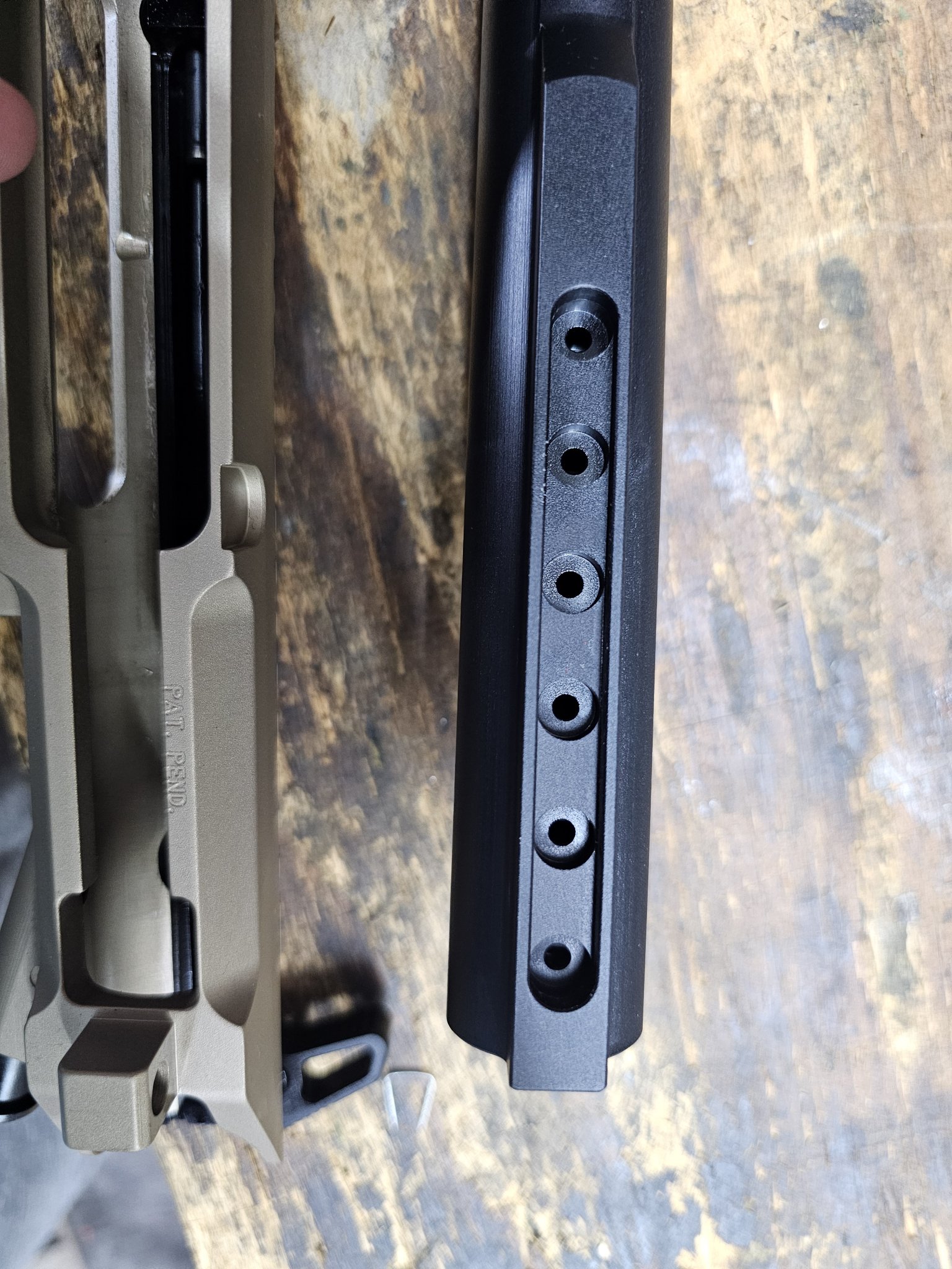

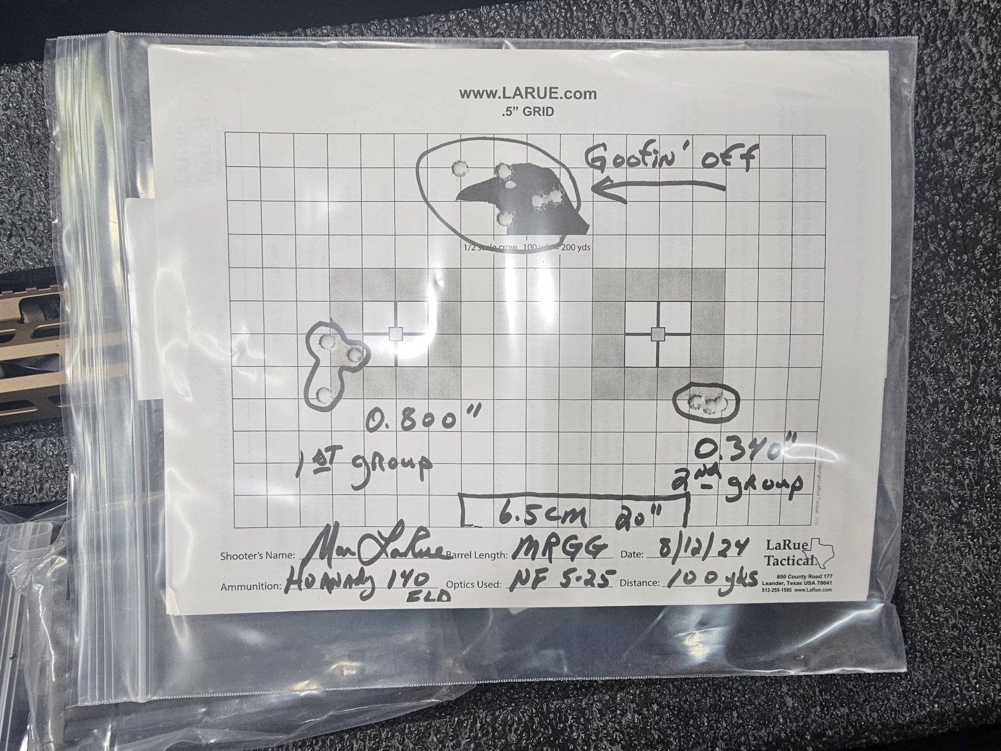

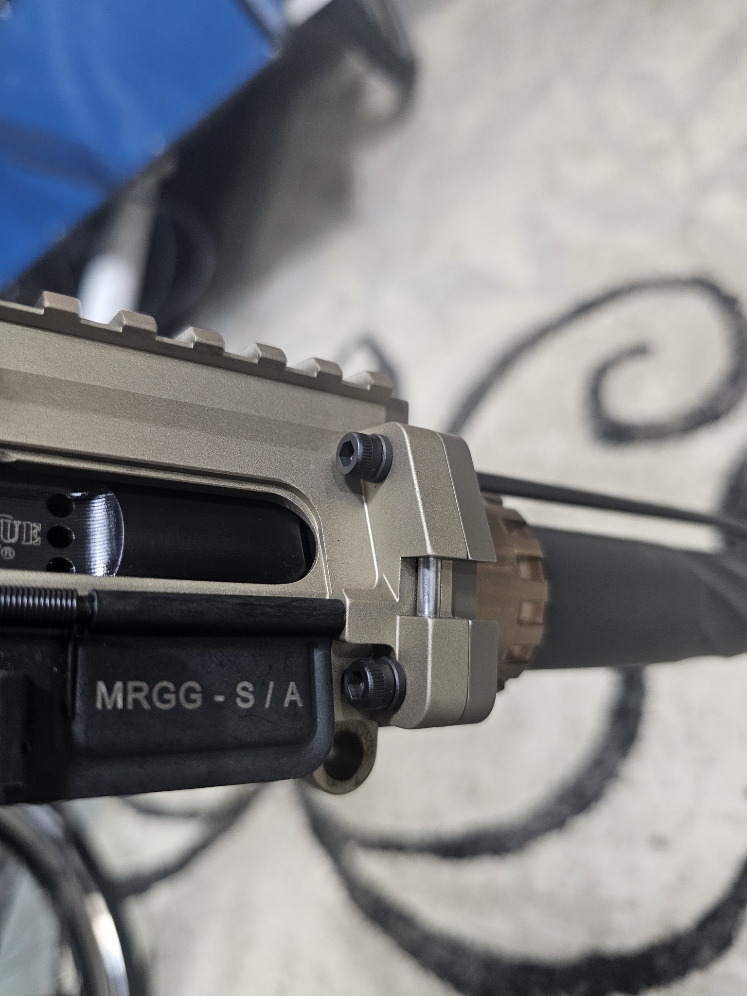

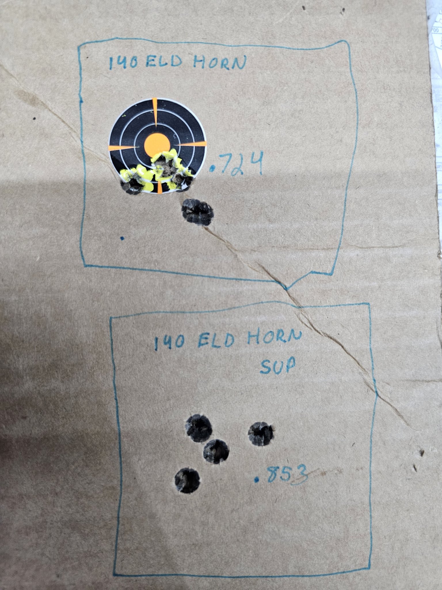

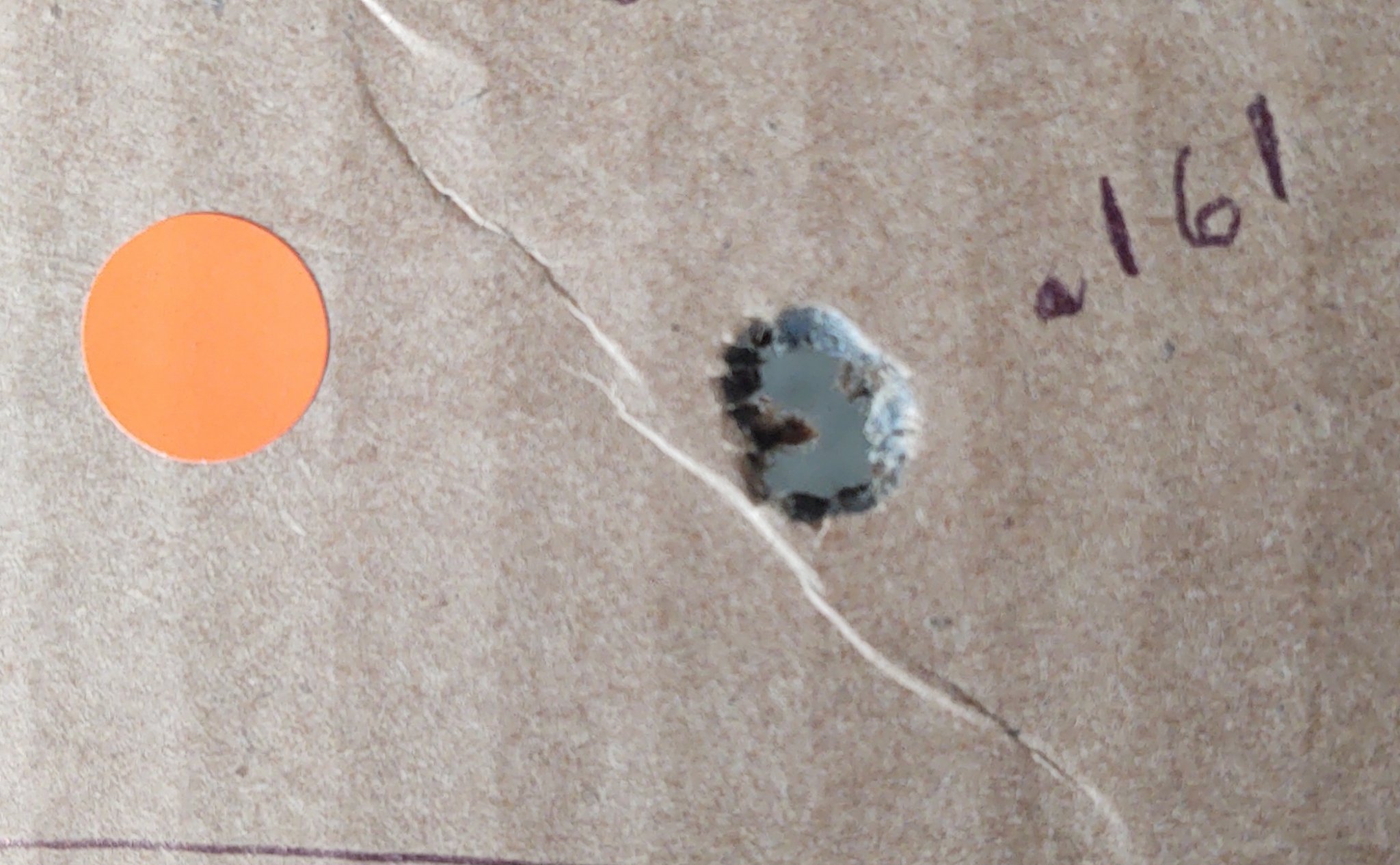

No it definitely has its Pros and Cons that I'll get into when I write up the review, and those are cherry picked groups. Next range trip hopefully wont be in the middle of a dust storm, I'll shoot a 5x5 which will give a more realistic accuracy eval.
One issue I will discuss is the Upper and Lower have quite a bit of slop between them and Larue has changed thier barrel blanks.

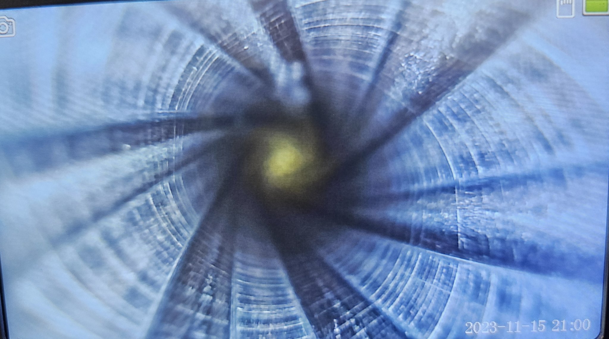

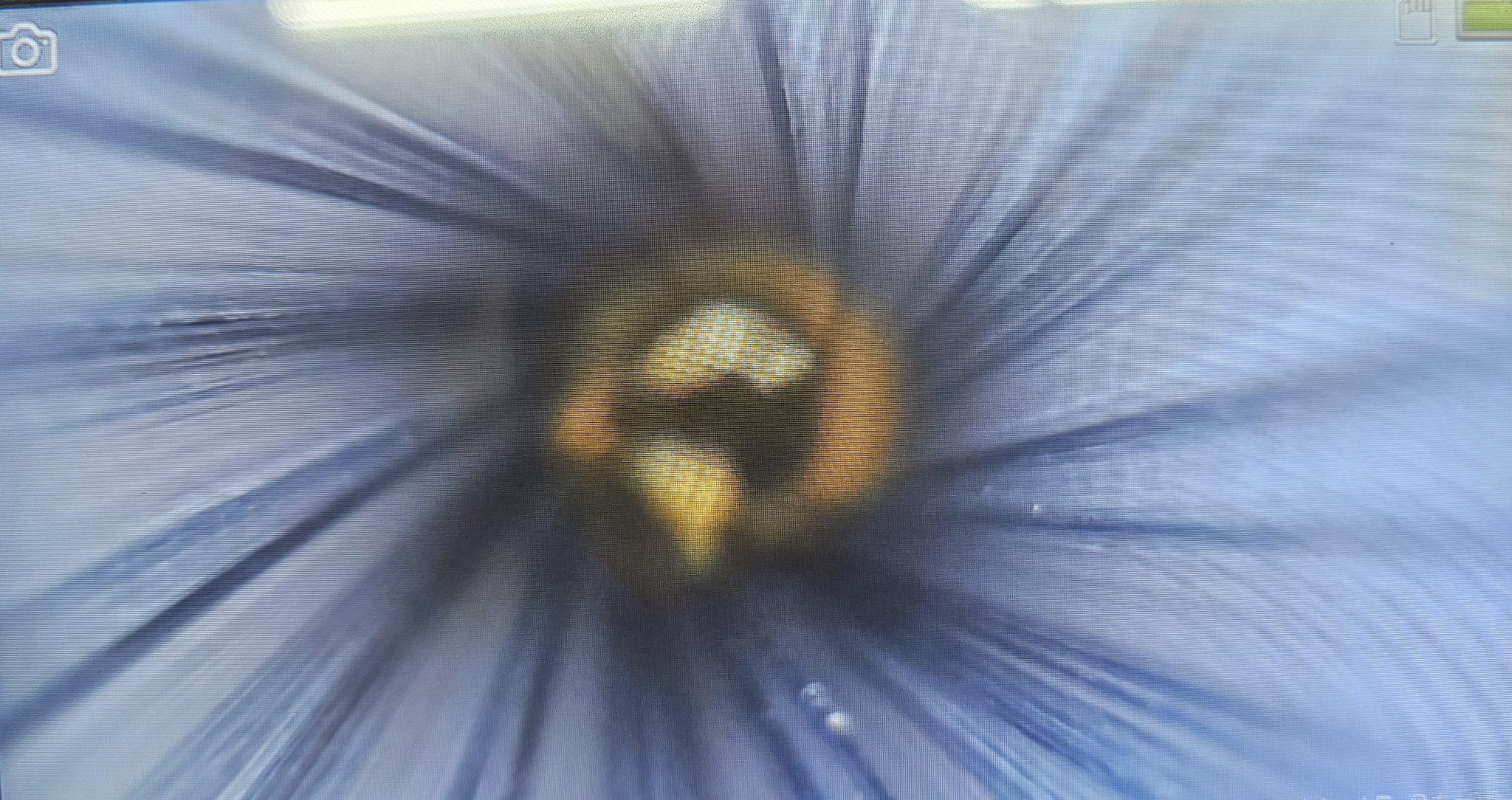

Larue barrels now have Polygonal Rifling. A few months ago one of my Range Buddies bought one of those 16" Larue .308 barrels from Dvor and has been having issues with it since the beginning, when I bore scoped his barrel I noticed Poly Rifling but didn't think much of it at the time because it was a $200 barrel so I wasn't expecting much anyway.
All the other Larue barrels I have on hand have the traditional Button Cut style that we've seen for the past several years.
Well now I’m going to bore scope the 16” 308 I recently built. It’s also one of those optics planet Larues. 8 Twist mid gas. Didn’t have any issues though. Shot pretty good during break-in.

The slop is surprising to hear. Very surprising. They like em coming out of Leander tight. I've felt some so snug on a hot day, you couldn't separate them.
Look forward to your write-up.

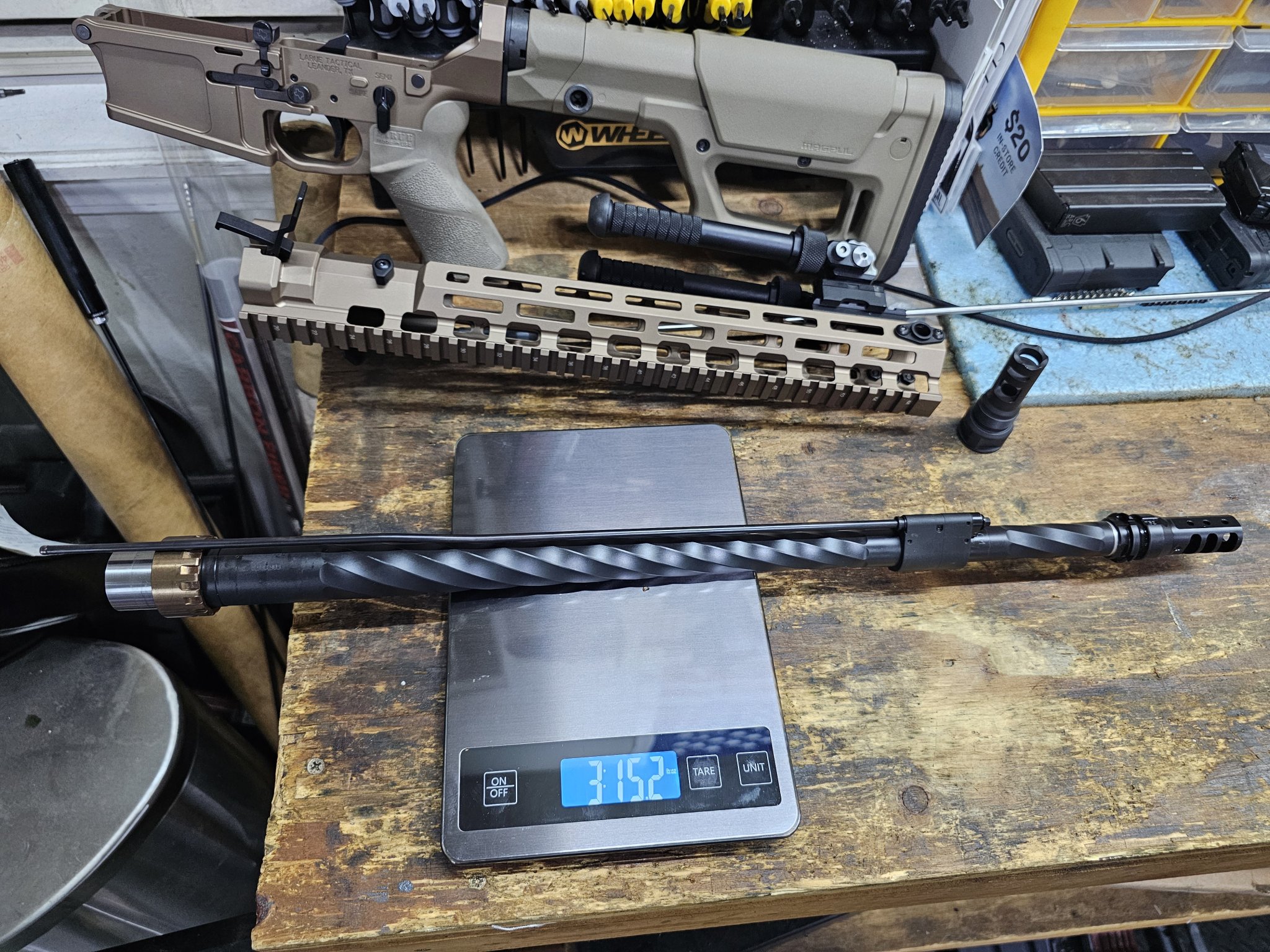

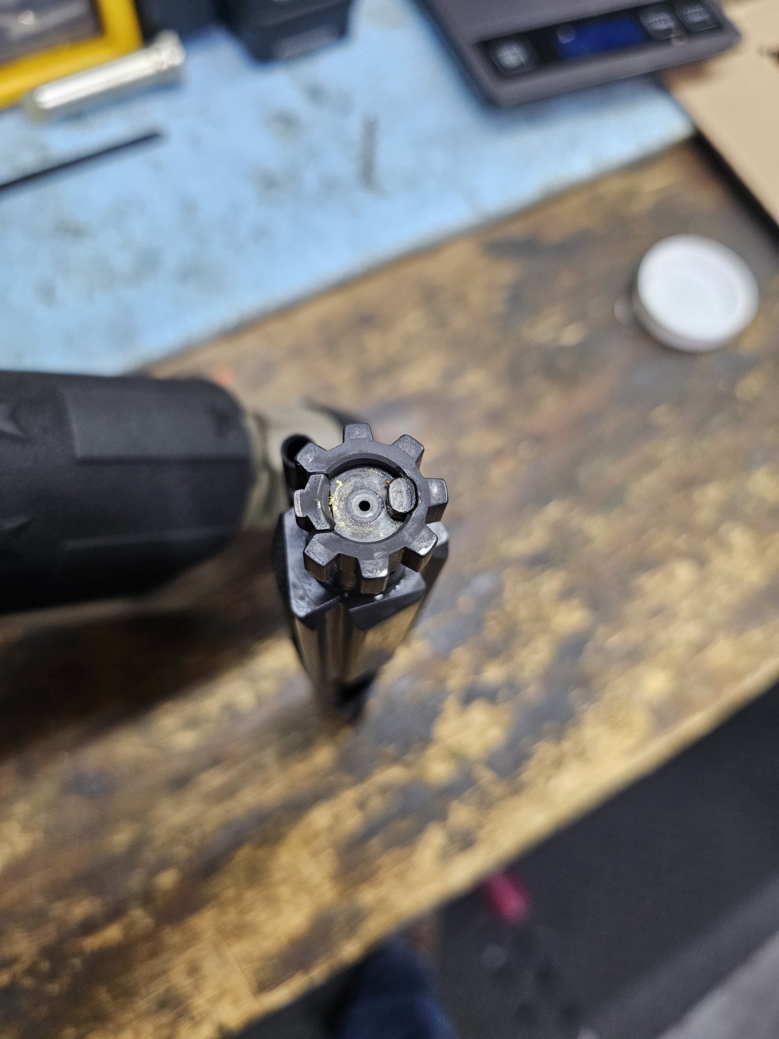

I just ordered an 18” LaRue 6.5 Creedmoor Stealth barrel from optics planet. Hopefully it will shoot well
I took a gamble on one of these because the profile & config was exactly what I wanted for a low mass suppressed Creed.
FYI - Optics Planet description is wrong. Barrel config is even better for my purpose. Barrel is 18", 7.5T, .750" gas journal, but gas system is Rifle + 2", I ordered the XL gas tube from Larue.
Also FYI - My barrel was short chambered i.e. no-close on Go Gauge. Would not chamber factory Prime 130. I tried JP, RCA, & Toolcraft bolts. Larue CS is worthless, so I just ordered a Clymer finish reamer + pilots from Brownell's ($160ish) & fixed it myself. Now Go + .001".
Only one range trip so far. Shot the Prime 130 @2610 IIRC & 5/8", Berger 130 @ a couple fps faster 2617 I think & .75", My 130 OTM hand load in crap brass @2740 & under 1/2". I came home from the range & ordered a second barrel. Just received the second one today.
Not trying to shit on Larue here, aside from the HS issue, their barrel impressed me. Larue large frame mags are tits. I just like building my own rifles to suit personal taste/purpose.

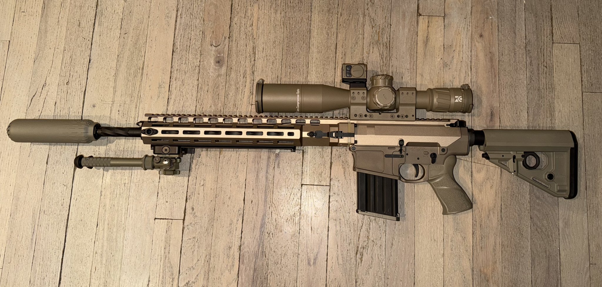

MaxRGG

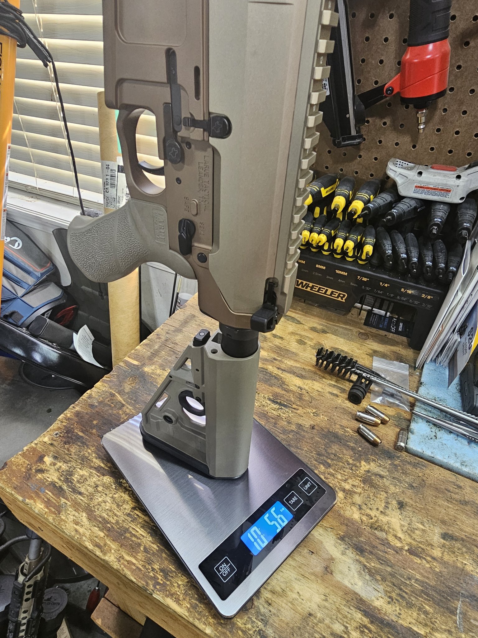

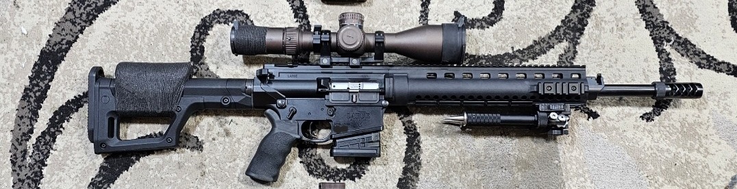

Without mag/Can/Bipod wt is 12 lbs 2 oz & right at $2100 all in rifle only. That includes the reamer/pilots.
Factory Prime 130 @ 2610
Hand load 130 otm @2.820 oal CCi #34 RL 15.5 = 2740fps no work up. This was my bolt gun load backed off .8gr

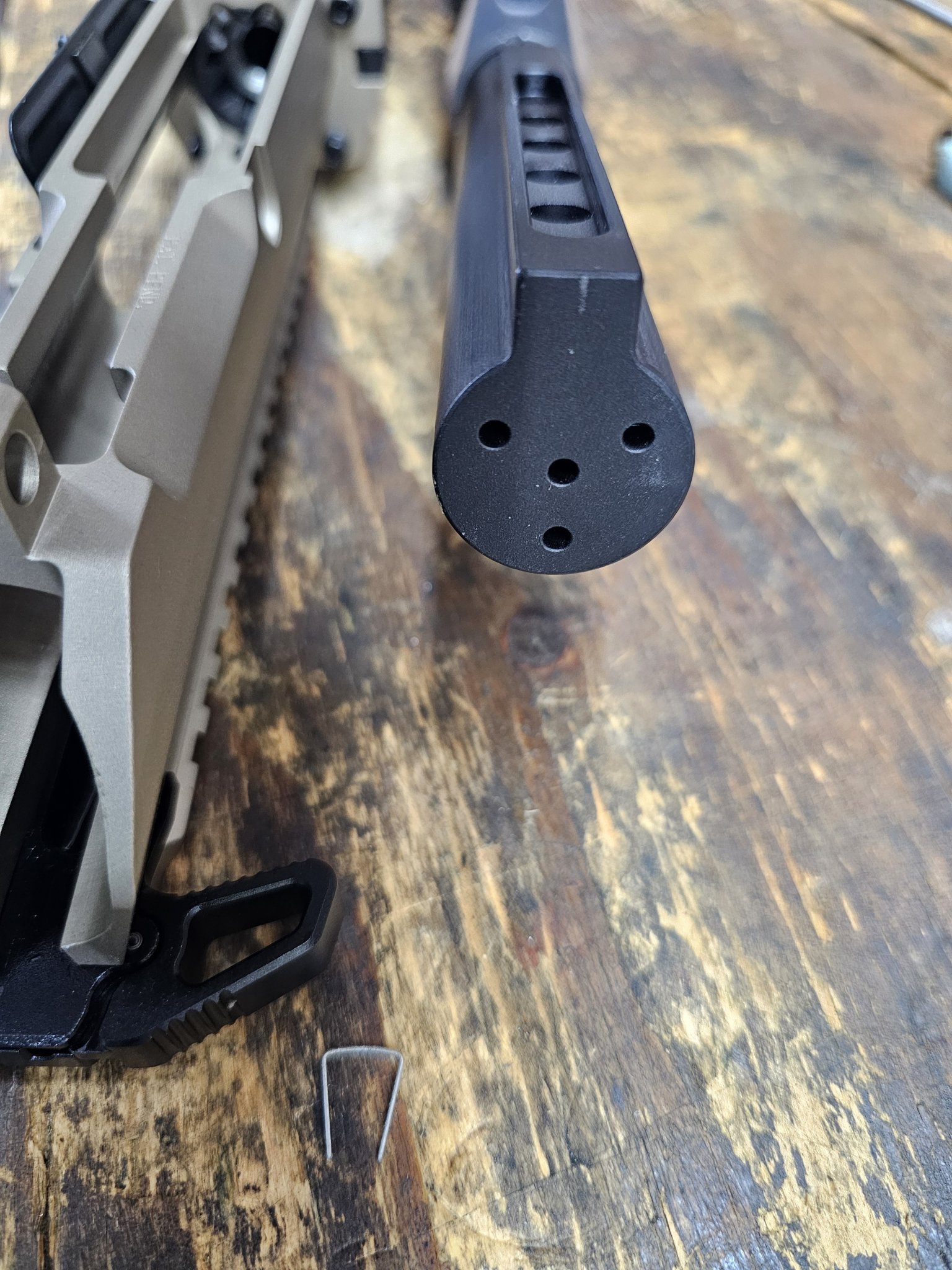

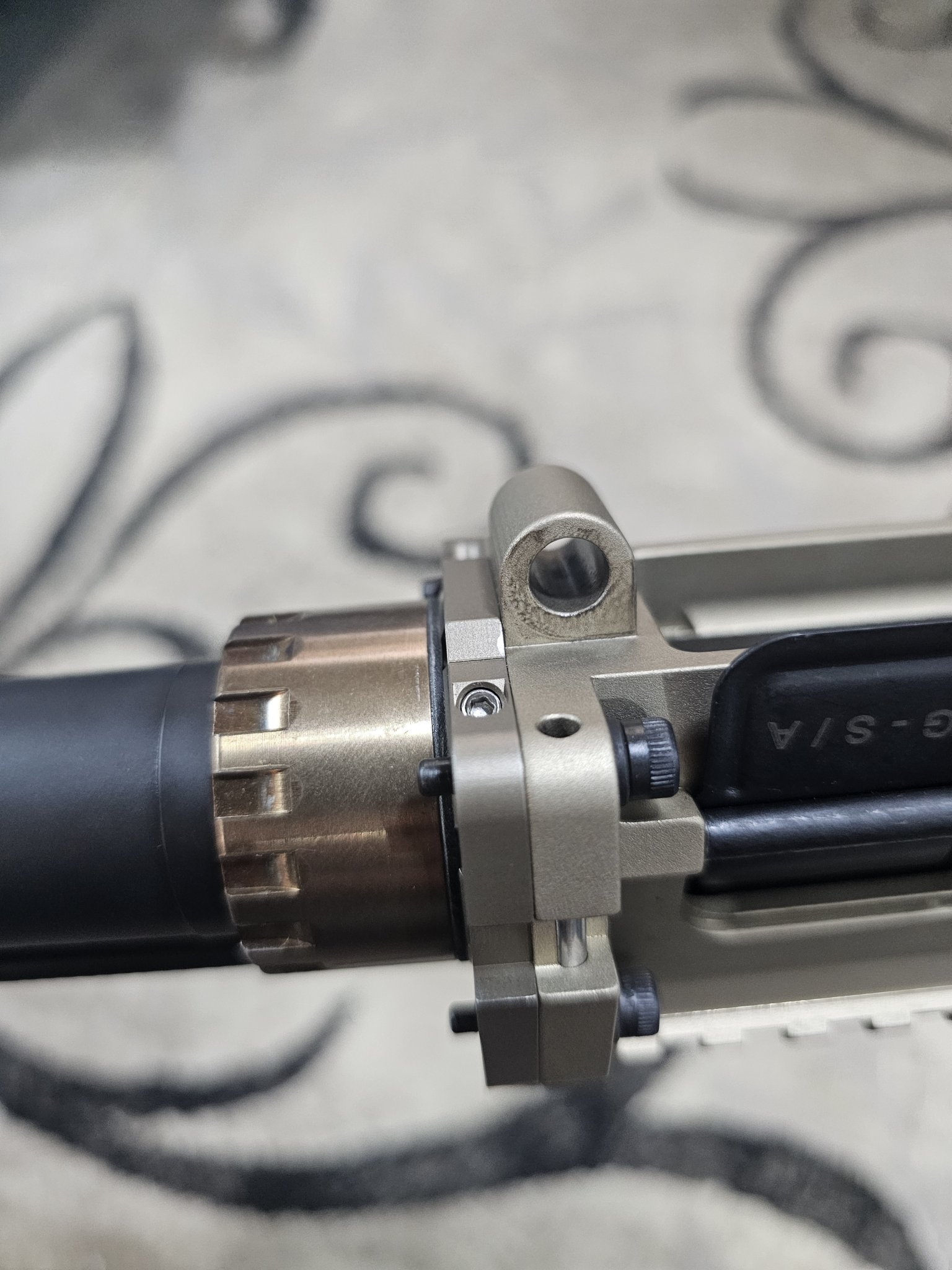

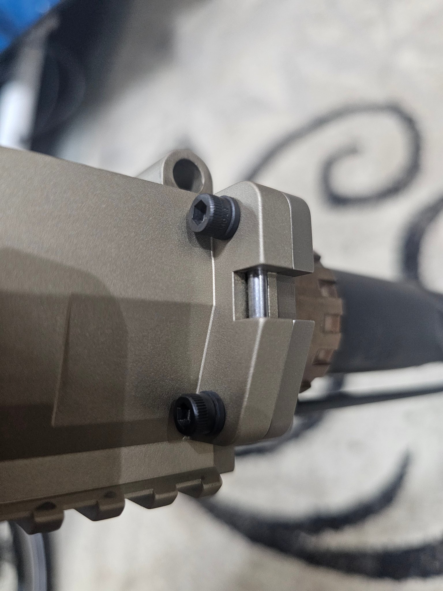

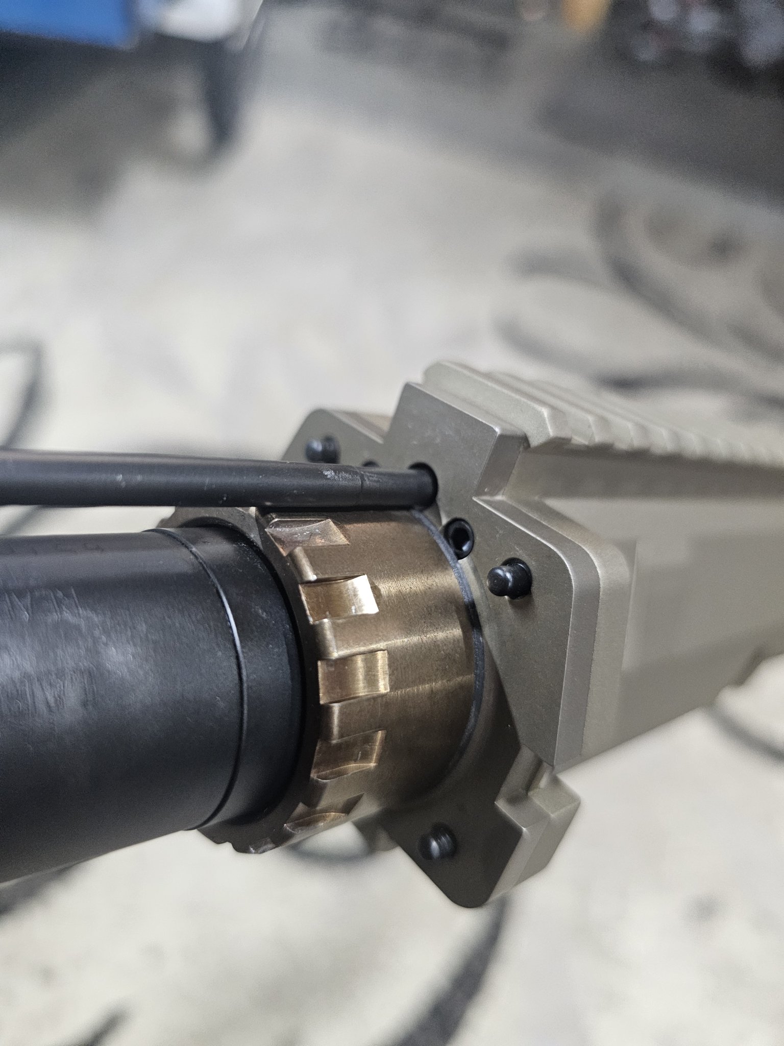

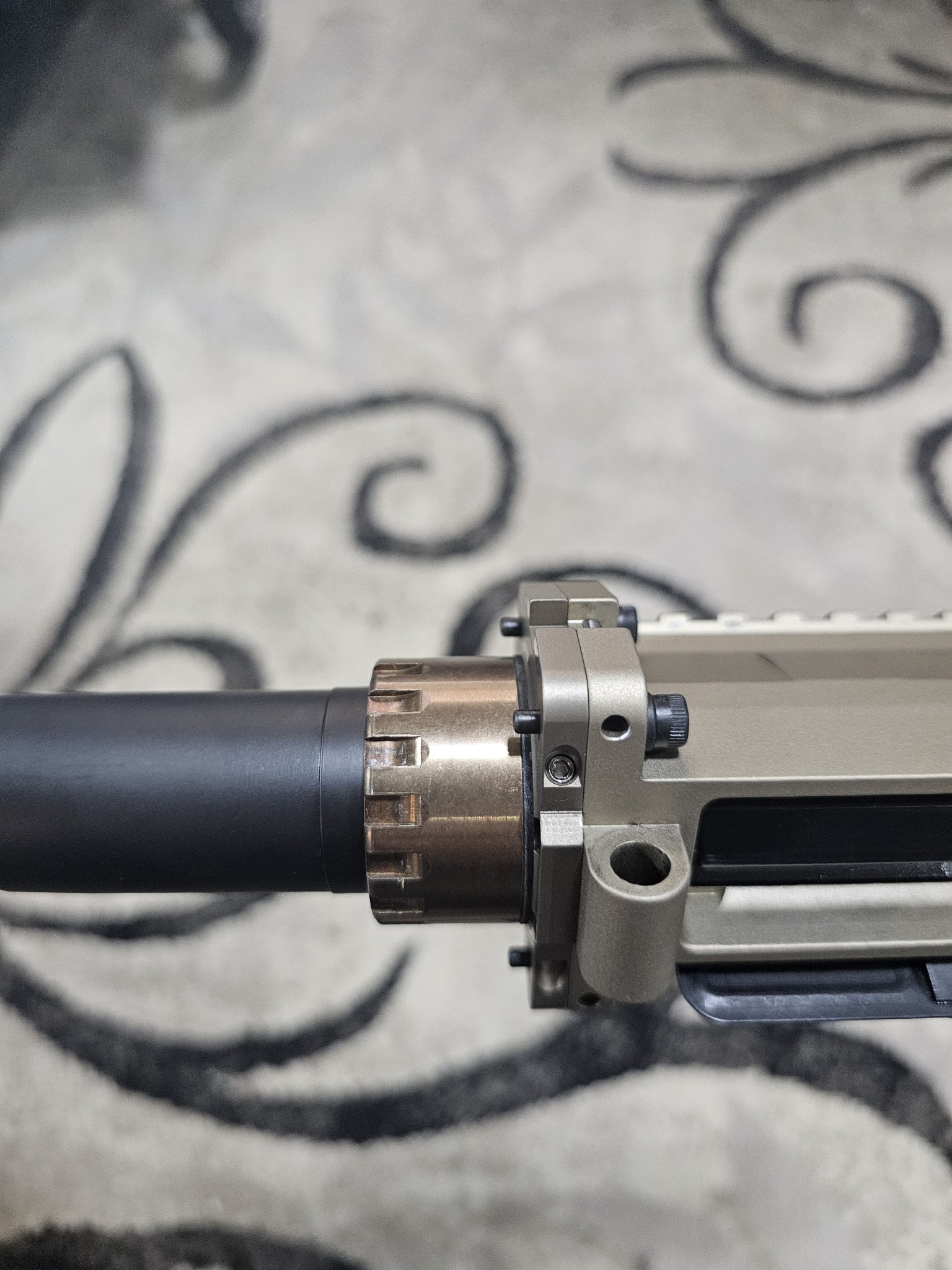

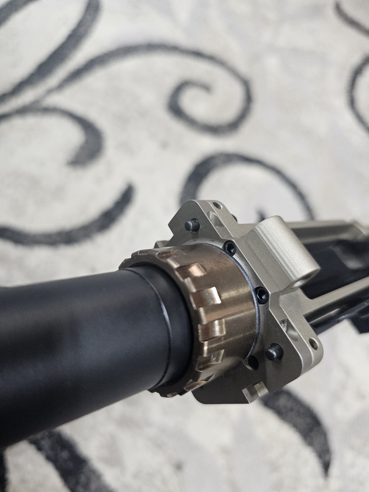

That's actually one of the topics I will be touching on, with the previous models you can thermo fit the barrel into the receiver but due to the design of the Steel SAMS Incert that doesn't seem to be a option.
The New barrel extensions and slightly undersized at 1.176" at the face of the barrel extension and 1.178" at the base. Standard diameter barrel extension are generally around 1.184"
I called and spoke with Dave at LT for more clarification about the two tenion detents that are build into the SAM unit, he stated the purpose of them is to create the same effect of thermo fitting by applying upward pressure onto the bottom of the barrel extension.
Dave couldn't give me a specific torque spec so I've just snuged them up to a point that I feel comfortable I'm not going to strip the screws.
At the recommended 40ftlb barrel nut torque the barrel has a fair bit of flex. I've increased the barrel torque to 55ftlbs and it seems to have increased the rigidity I'll try several different torque specs to see if it has any bearing on performance or accuracy.
Also keep in mind with the free floating barrel design and the new steel SAMs insert their theoretically shouldn't be much shift if any at all. The Sams unit is definitely securely installed.

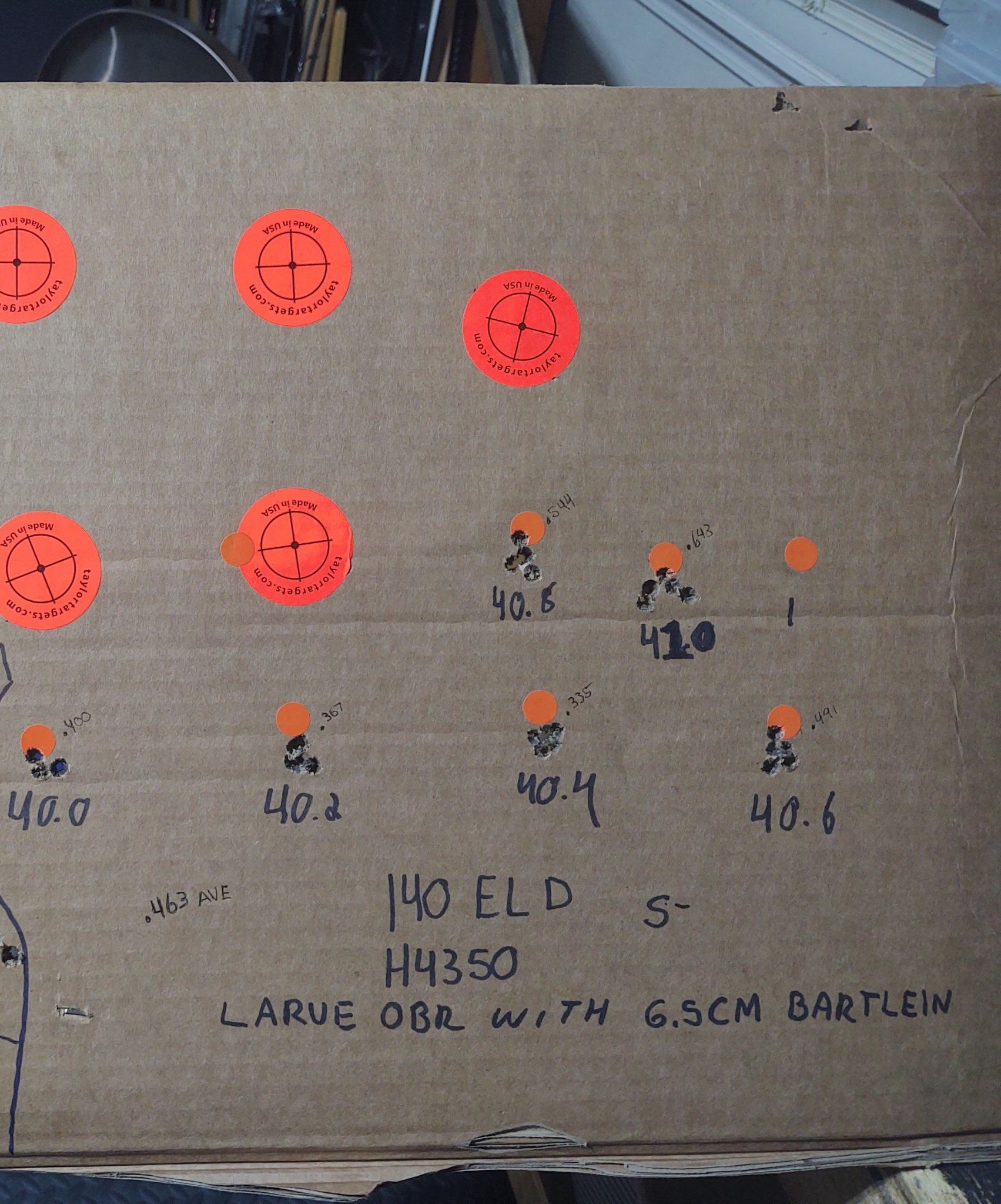

Keep in mind that's with Hornady Factory 140 Match ammo. If I was to work some handloads up I'm 100% sure i could get it under 1/2 MOA.
And the the above OBR has a 18" Bartlein Barrel in it, turned by one of the best barrel smiths in the country.

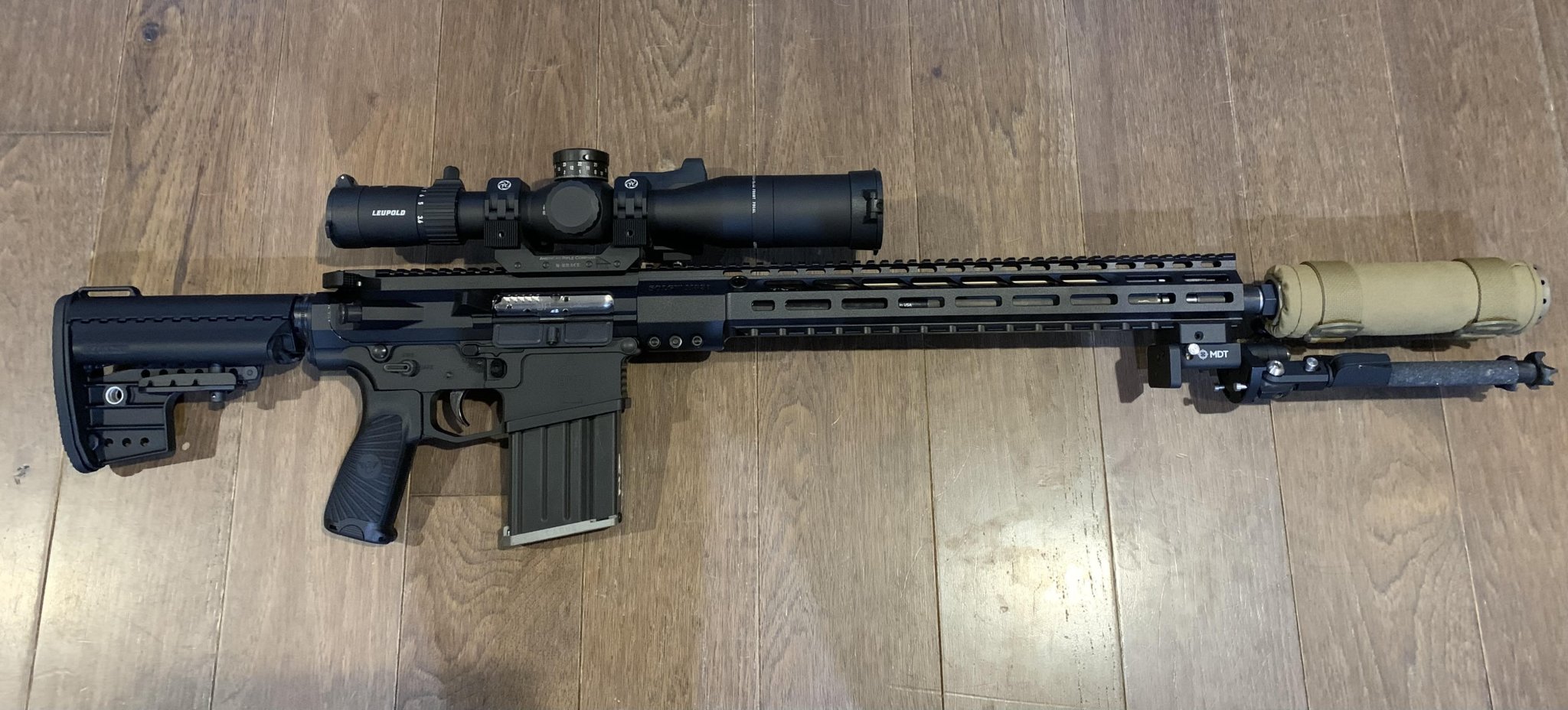

As someone who owns one of the original 50 LaRue MRGG-S rifles I’ll drop a little knowledge that I’ve gathered. Yes they were submitted for the MRGG program, the original 50 were prototyped with snipers across the US military branches during a course of some kind. A few of them are here on SH but idk how much they’re willing to share. They were given the option to purchase these rifles at a steep discount after this course, and ALLEGEDLY some went to some interesting places around the world. The main difference between these kit guns and the MRGG submission was the prototypes not having an ambi bolt release, and not having FA capability. The commercial variant obviously doesn’t have FA either, but does have the ambi. Proto kits also came with 18” 308 barrels (pictured) with the regular gas blocks, wrench, scope mount with diving board, and some mags.
Non-ambi brotherhood

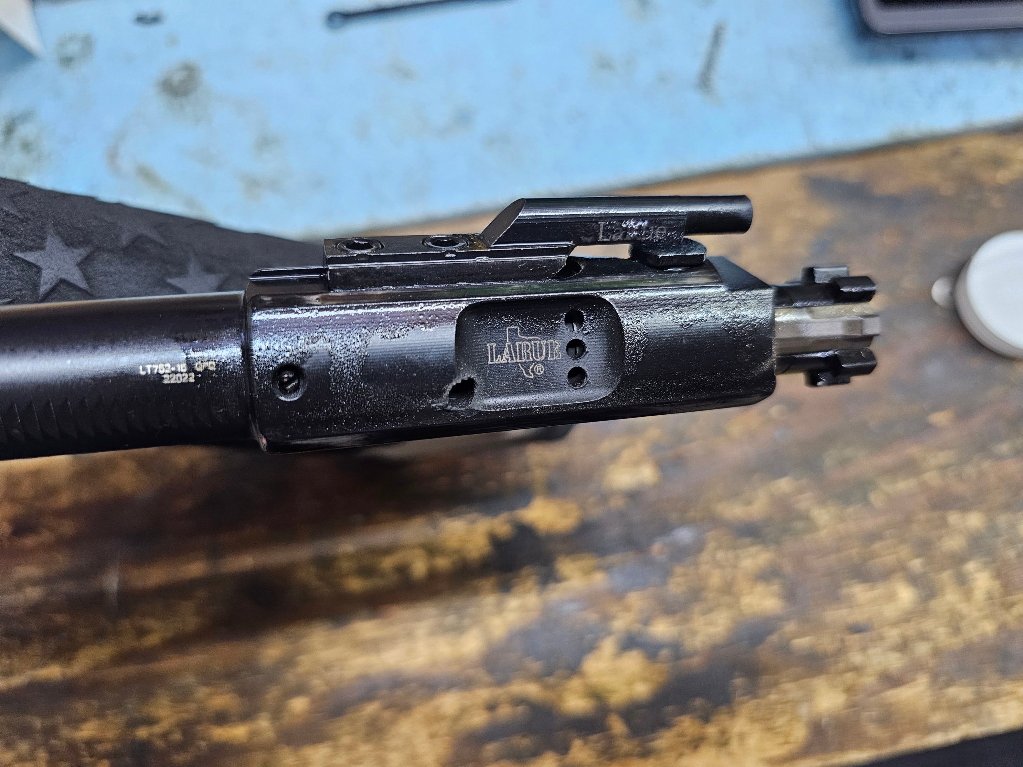

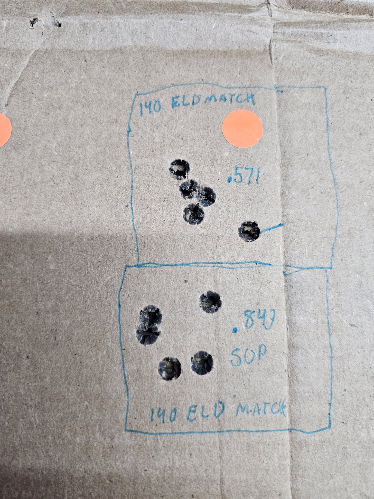

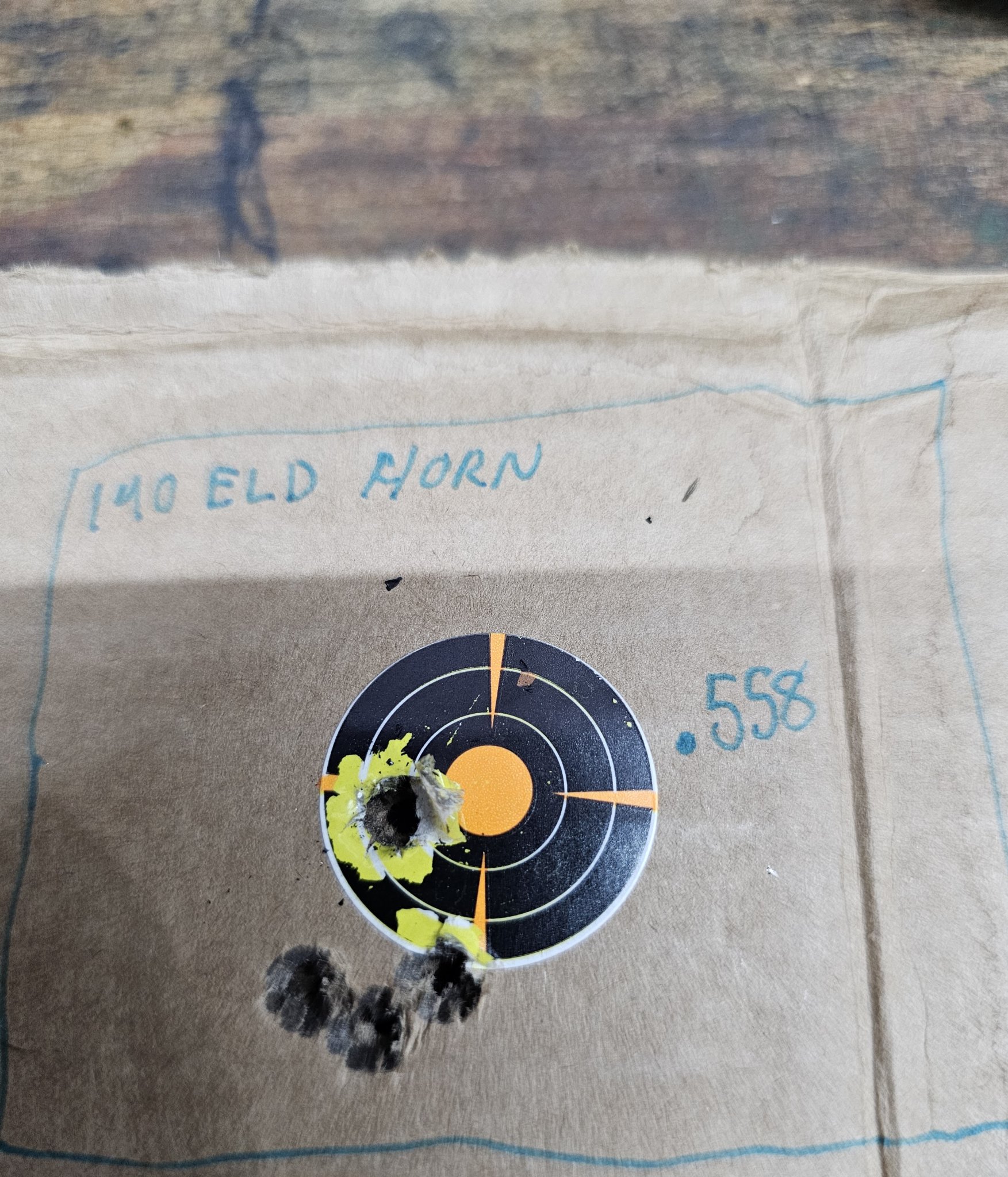

I've been meaning to add to this thread for an update, I've been doing my very best to give the LaRue MRGG a fair chance and I was about to throw in the towel and just write it off as a .75 - 1 MOA rifle until the other day when I discovered the issues for The Unexplained Flyers and poor accuracy.
I've been feeding it nothing but a solid diet of Hornady 140 grain ELD Factory ammo, I was running some tests with various other cartridges that seem to chamber a bit on the tight side when I discovered that when chambering the Hornady 140 ELD Factory ammo the bullet was actually sliding forward anywhere between 5-9 thousands. This would definitely explain inconsistent accuracy.
Since I've already put 200 rounds down the barrel, I've decided to start Handloading, with a bushing die that will shrink the neck down 5 thousands under loaded neck diameter.
After loading 80rds of 140 and 147 ELD's in Lapua brass I chambered a bunch of them by loading one round in the magazine and let the bolt release go, slamming the rounds into battery.
None of my handloads moved from their original COAL.
This should resolve the erratic flyers and inconsistent accuracy.
