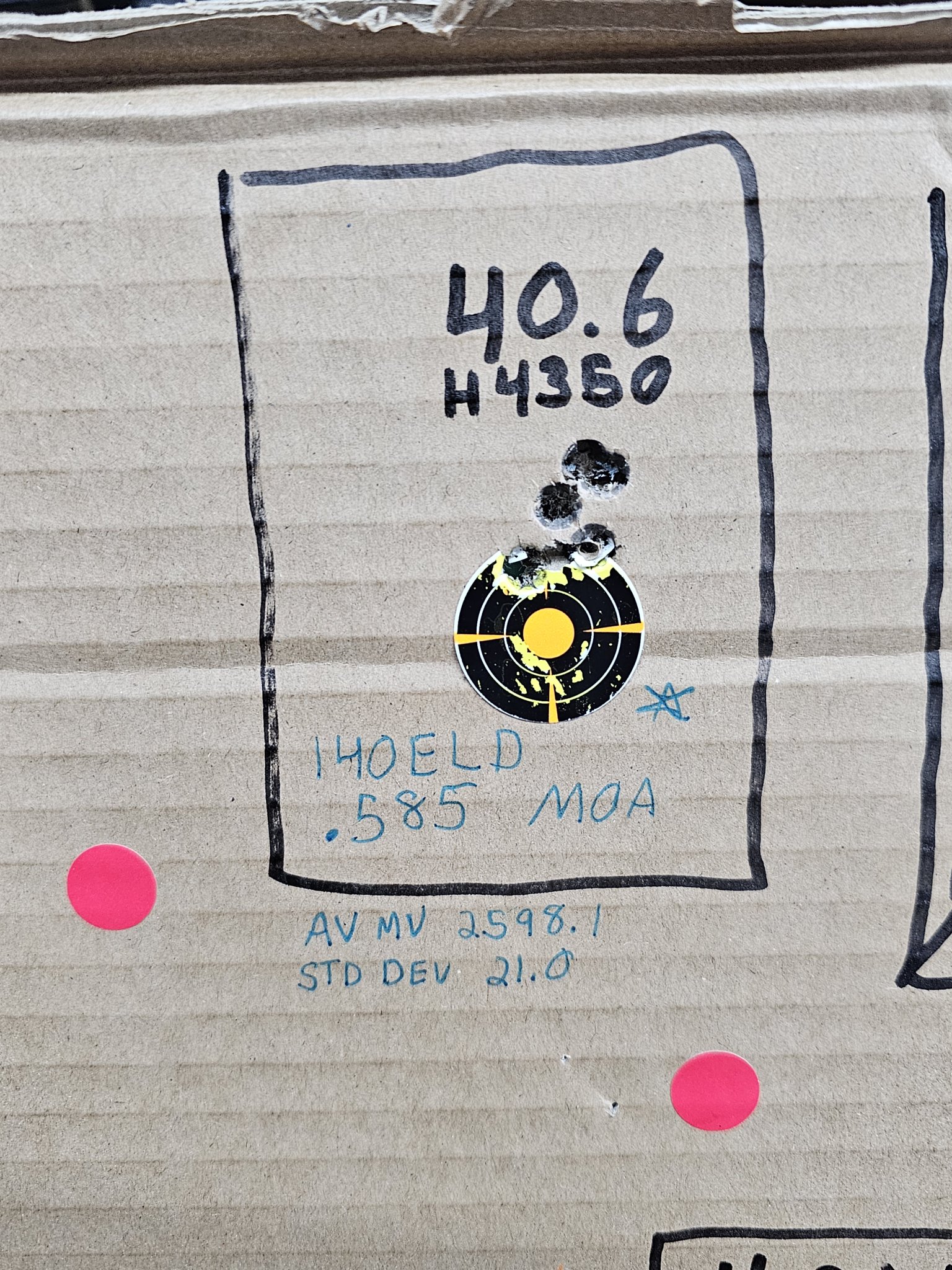

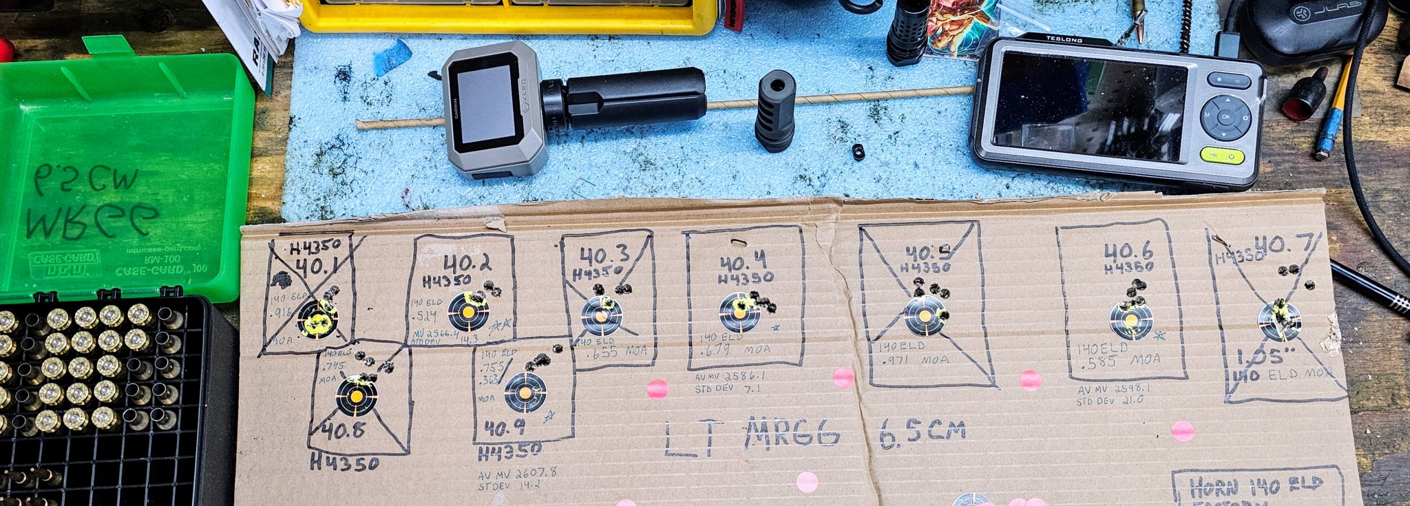

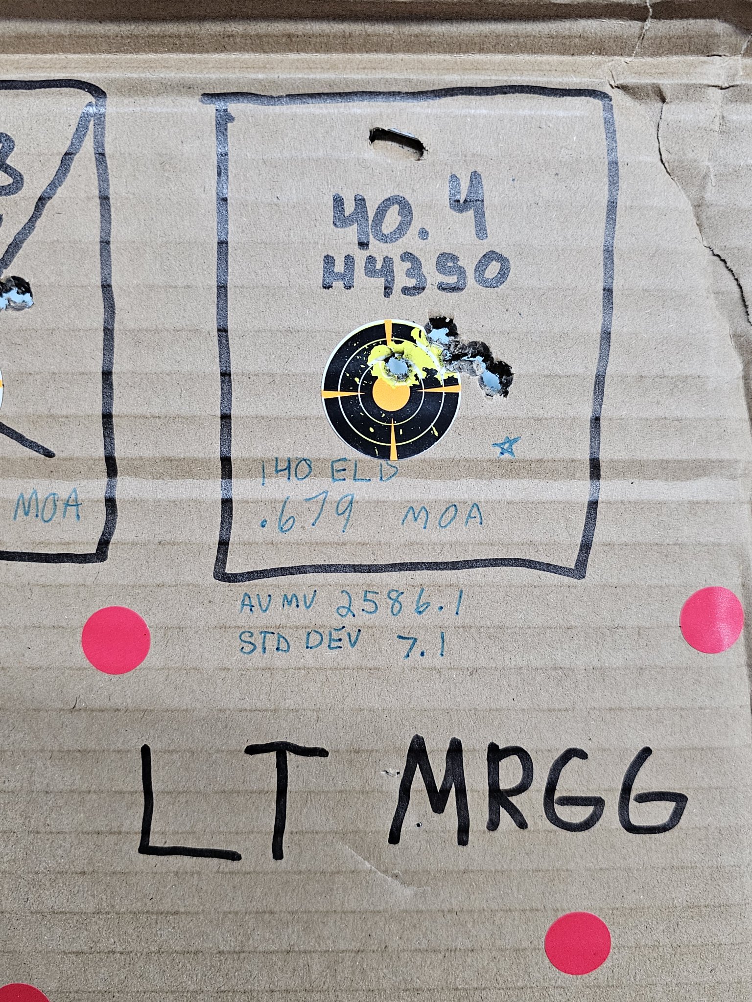

I just got back from the range doing load development with some very nice results I'll update this thread soon as I get home with data and pics.

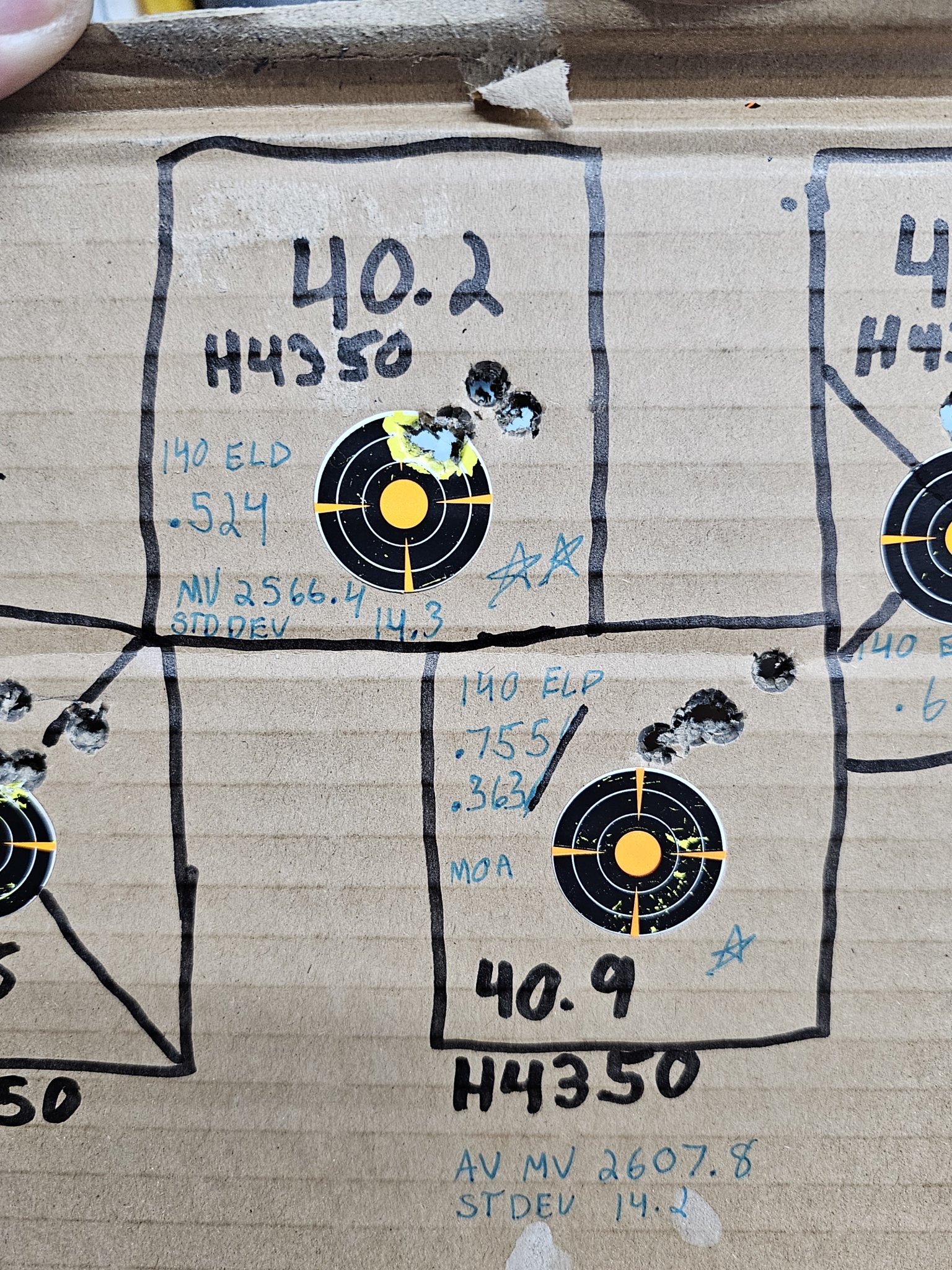

Started load development today and had some promising results, now that I have control over the neck tension over factory offerings the groups are very consistent with no unprovoked Flyers.
Only Flyer I had today was with the last 5rd group 40.9grs H4350, I think it was a case of Buck Fever.
I'll repeat loads 40.2, 40.4, 40.6 and 40.9
I haven't started to see any signs of over pressure so I'll keep working my way up.

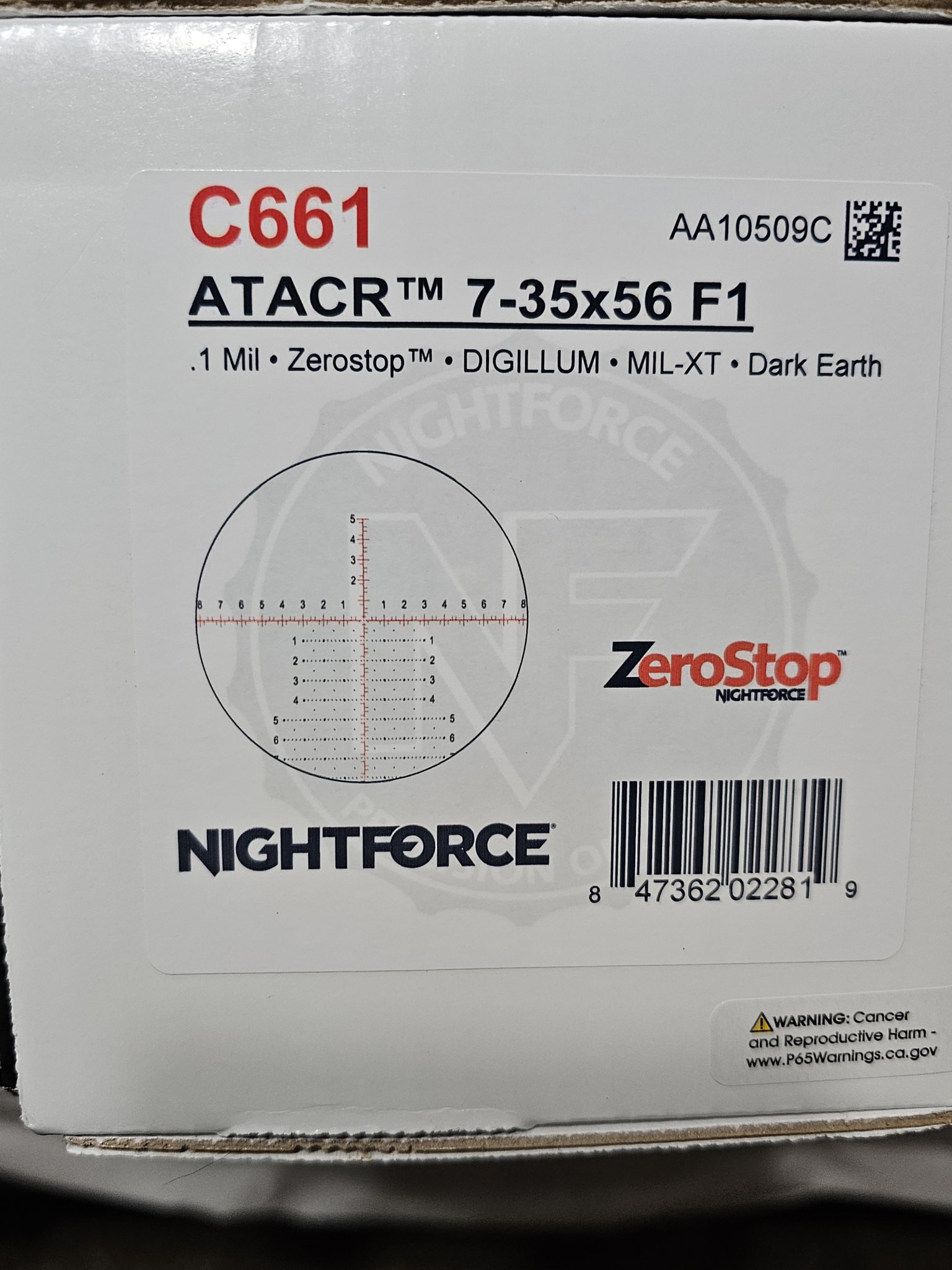

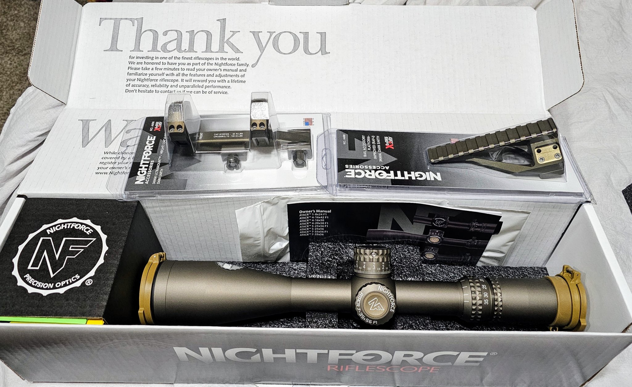

Also had a little somethin arrive today to assist with the load development😁

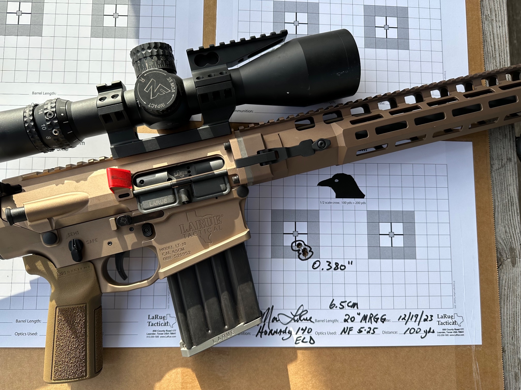

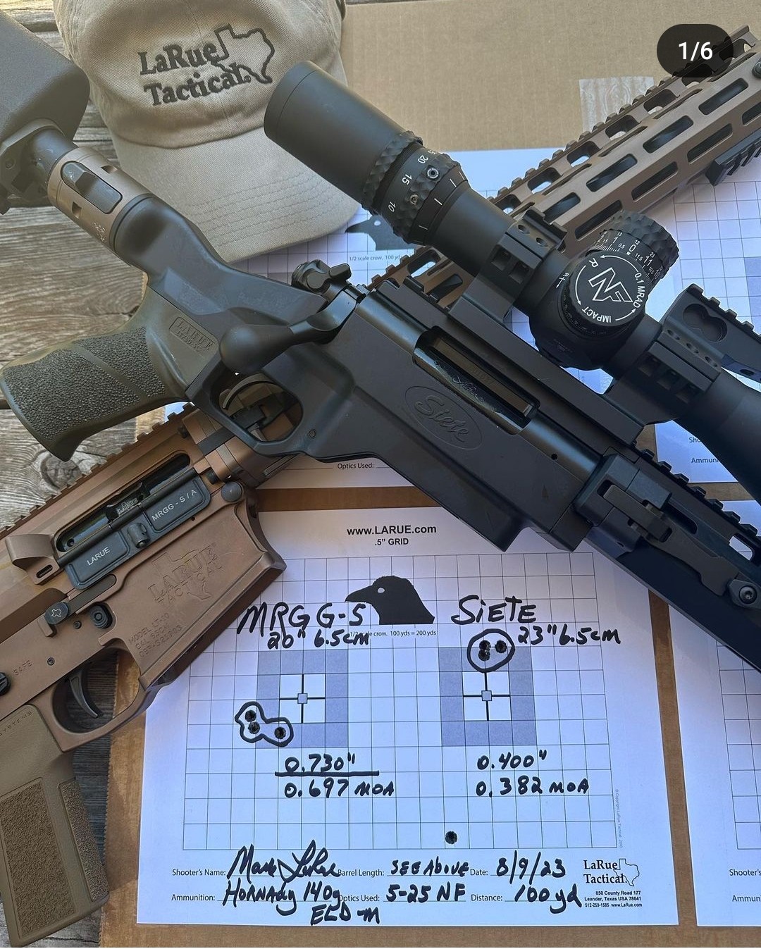

The LT MRGG Rifles have a 20" Barrel with a 1-7.5 Twist, it's going to favor the heavier Projectiles.
Everyone I know who Shoots LT Rifles in .260 Rem all get better performance with Projectiles in the 130gr - 139gr.
His 6.5CM barrels prefer the 140's and up range of Projectiles.

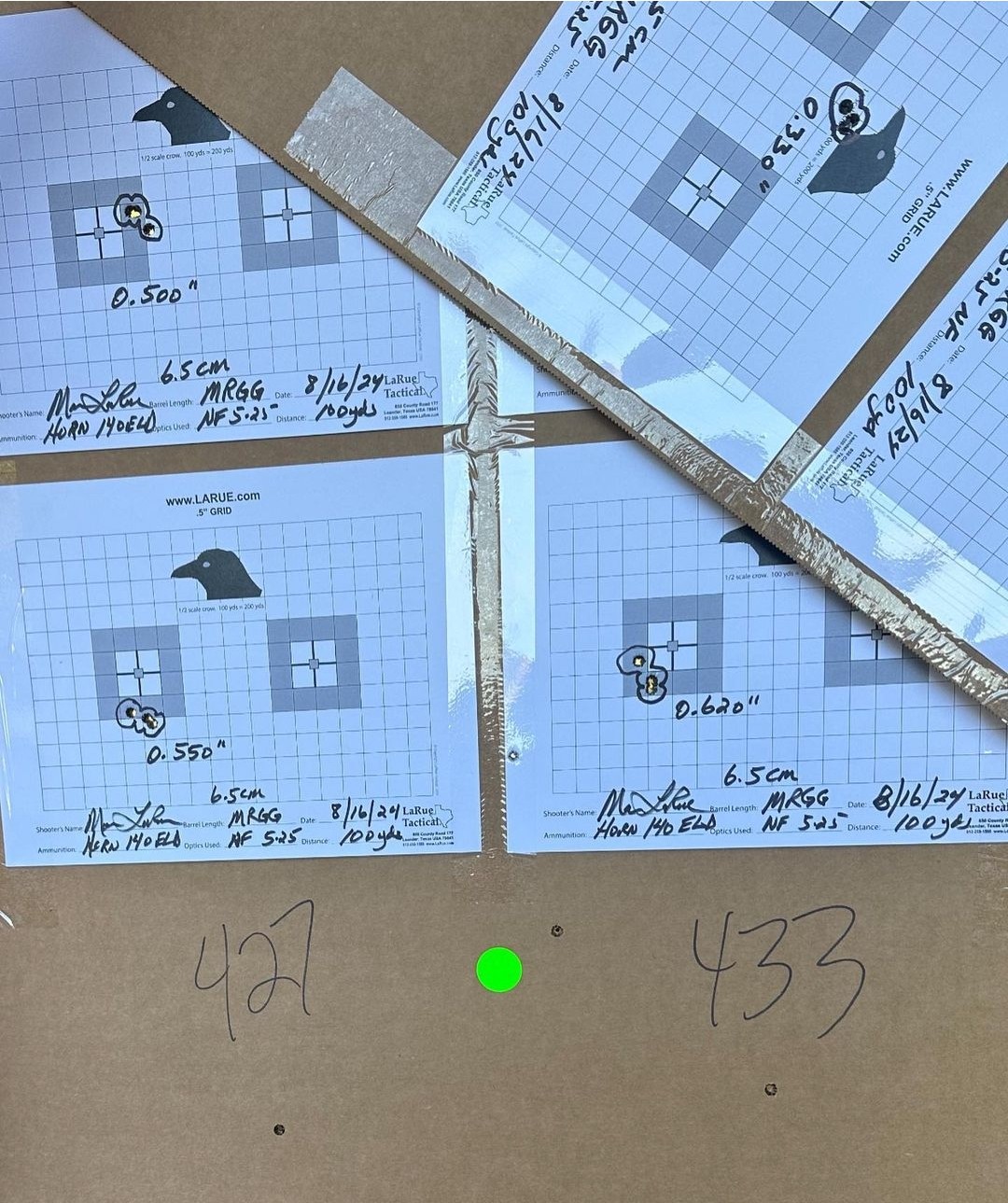

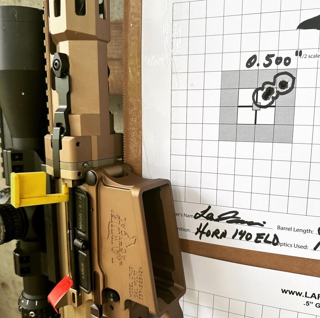

Larue shoots the 6.5CM MRGG Proof Targets with Hornady 140gr ELD Match Factory Ammo, and I could be wrong but if I was shooting Proof Groups for each of my rifles I'd definitely shoot the most Accurate Ammo to make my rifles look good.

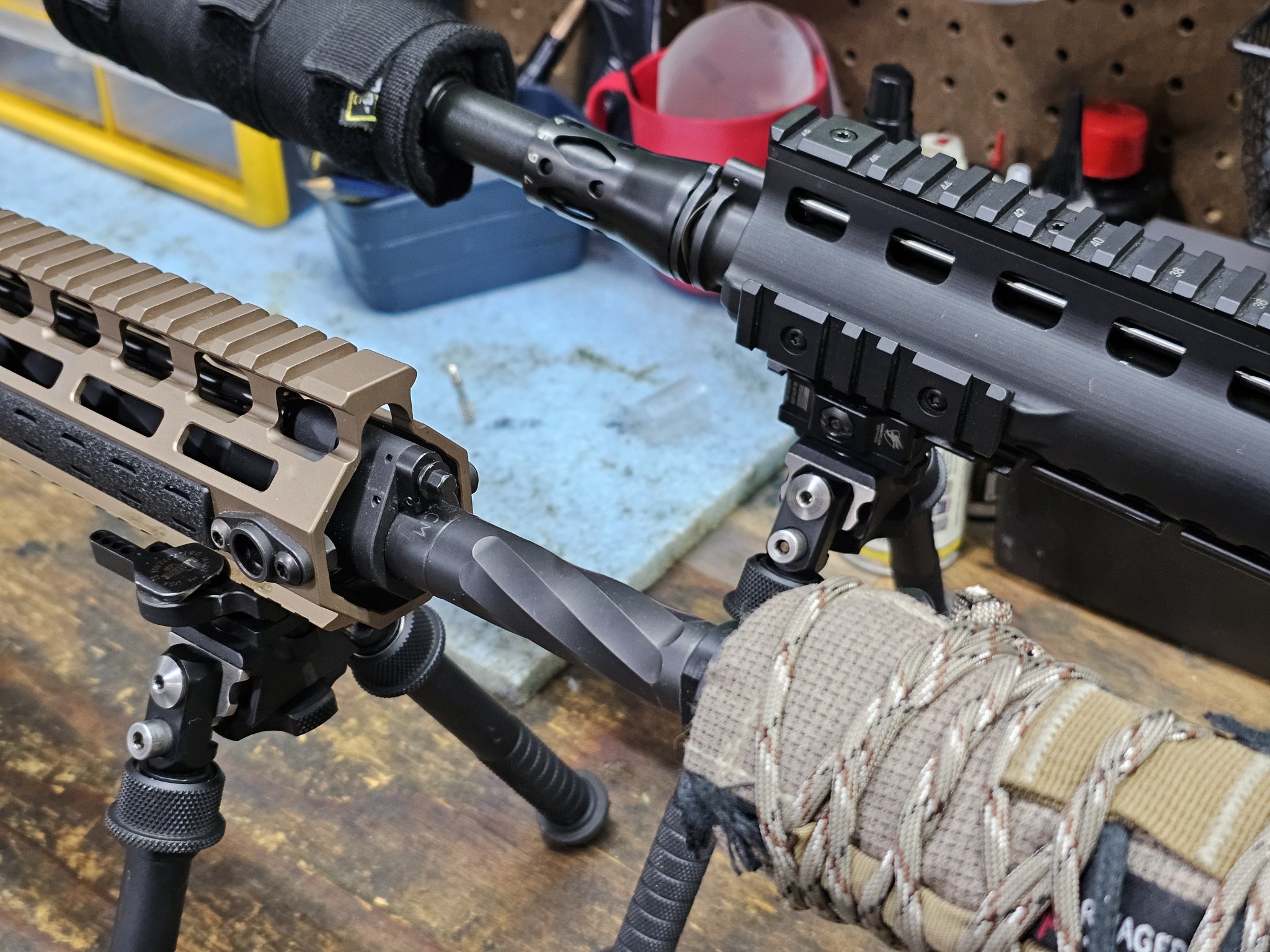

Thank you @Bigjake83 for posting your results. I would love to know what the differences are between the MRGG and PredatOBR rifles. Other than the FDE color and cool spiral fluted barrels.
My tOBRs have become my favorite rifles.
The only difference that you can't visually see is that the MRGG Barrels have a smaller diameter Barrel Extension with a very, very slight taper.
If there are any other MRGG owners wanting different calibers/length I'll start keeping a few on hand in .308, 6.5CM and maybe .260
Reactions: muad
Dang, so no possibility of a fluted MRGG barrel in my tOBR. Bummer.
Thanks for the added information, sir.
