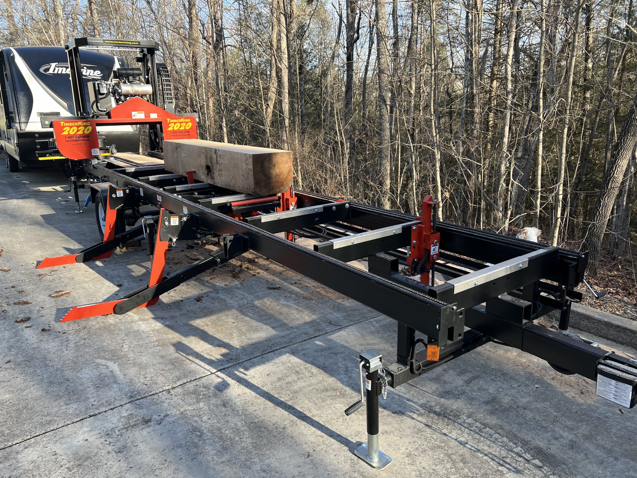

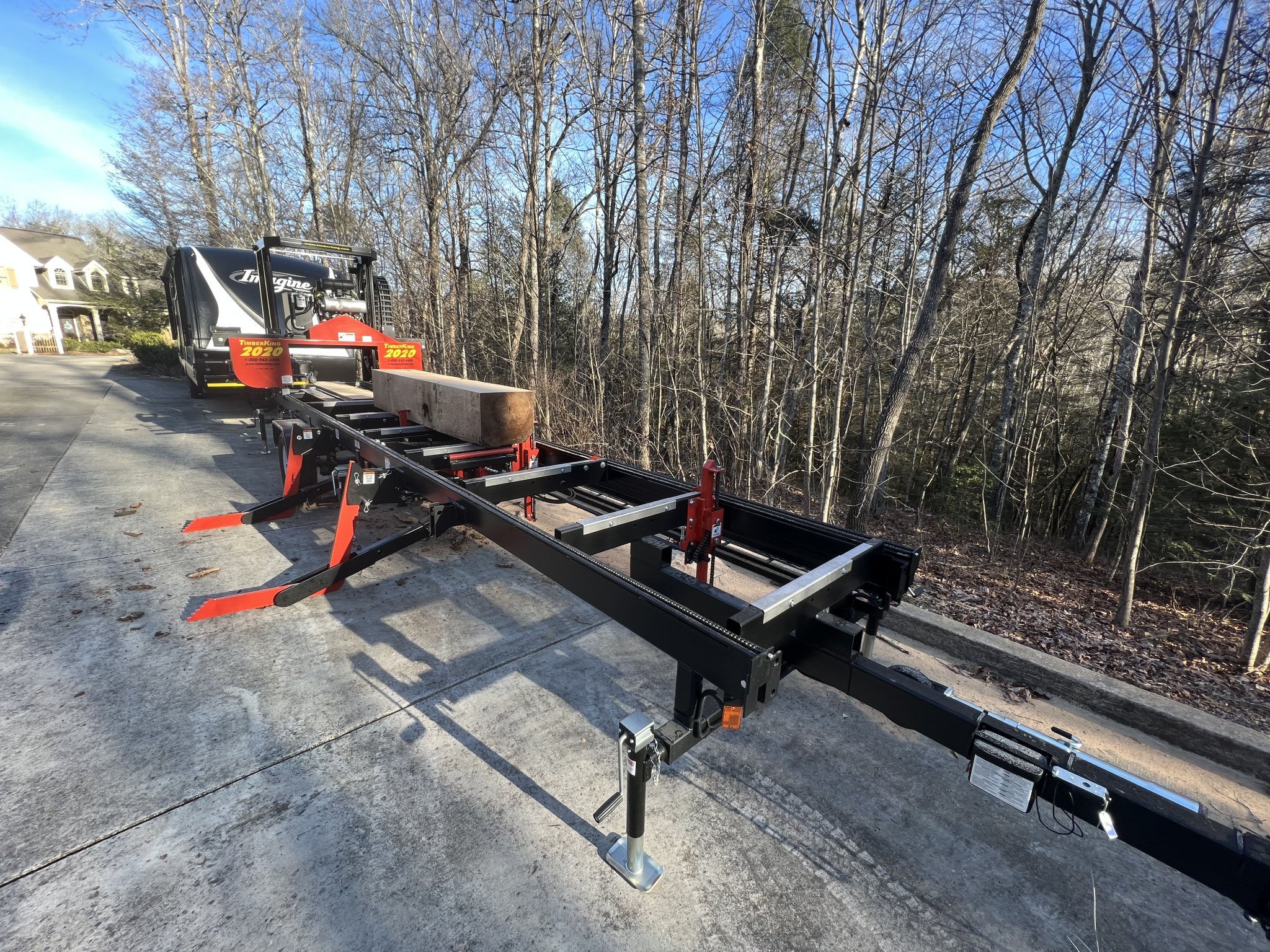

Yes!!!!! They spent 3 hours training me on it yesterday. I’m in hog heaven.
I have to say that any of the online stuff on this mill does not even paint a proper picture. It is built like an absolute TANK! I’ll have to post some pics or maybe a video.
I’ve got my first log on there and have my cant squared up. I’m between 1” and 1 1/8” for these fence boards. Anybody have any advice on that?
If your looking for a finished board to be 1 in , then you would cut at 1 1/8th to allow for shrinkage and planeing. For just reg rough cut fence board I would just go 1 in since you don't really need the extra 1/8th.
These will just be rough fence boards so I’ll go 1”. Thx!
We need pics bruh.
We need pics bruh.

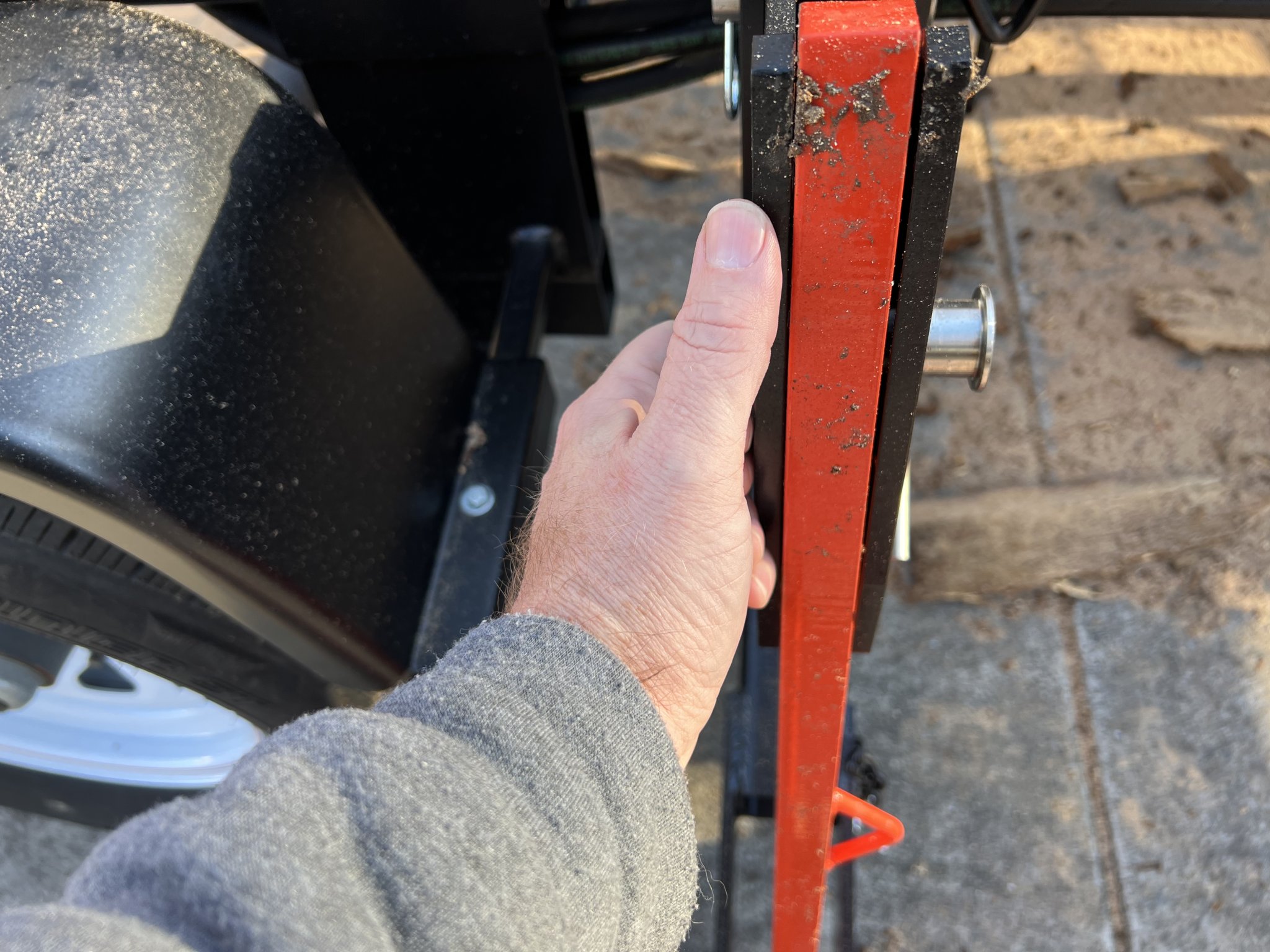

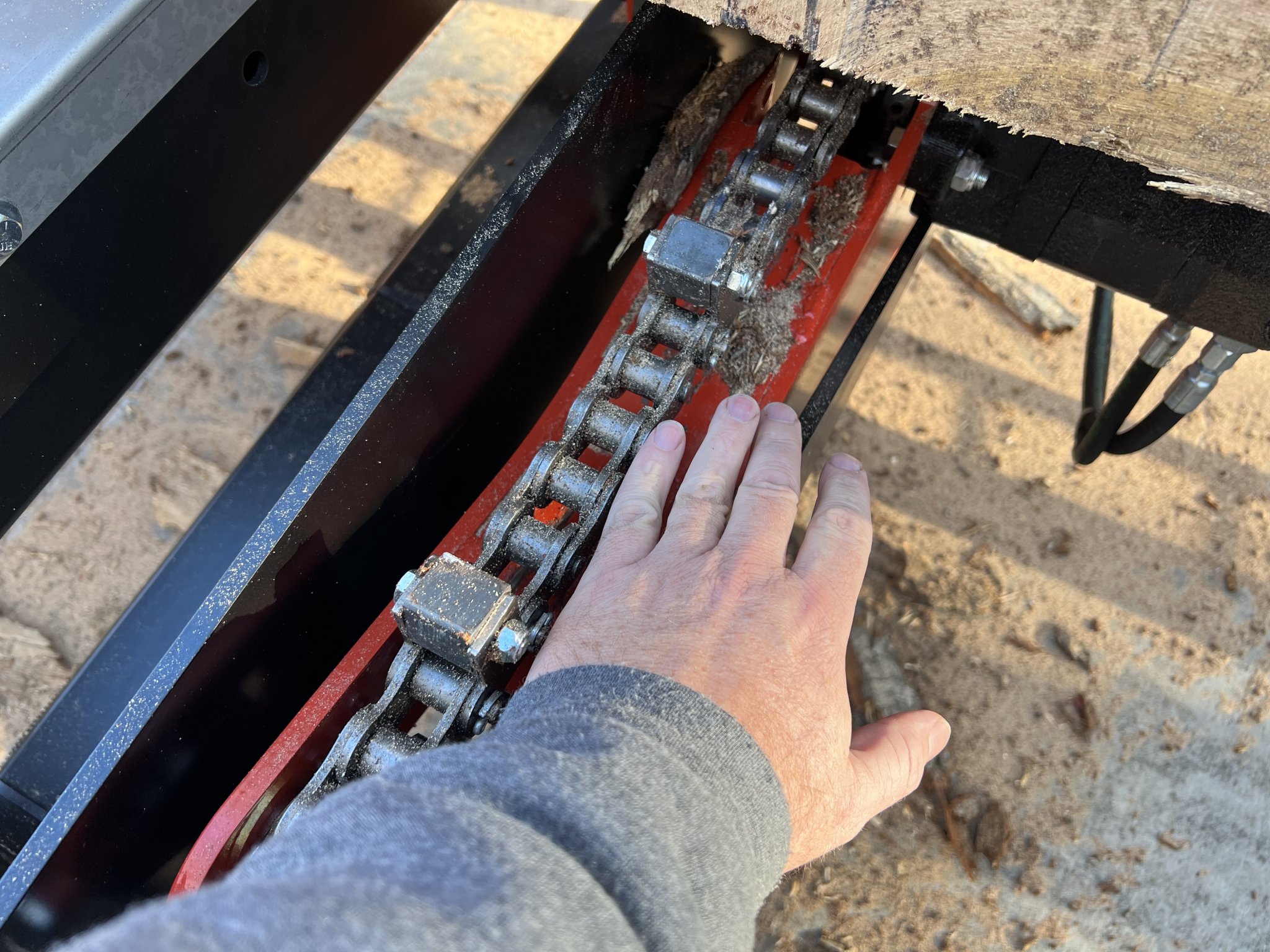

I put my hand in there to show the scale of the construction. I am 6’5”, hands proportional to the rest of me lol. Everything on it is just massive. By the way, the mill is fabricated from all American steel!
