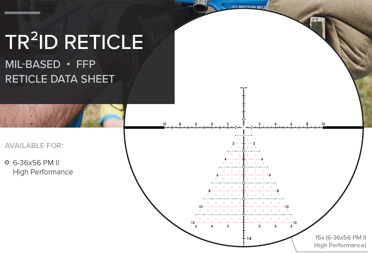

This new reticle looks great. For those that have done it, is it best to have a reticle swap done or sell one’s older optic and purchase a new one with the desired reticle. Purchased my 6–36 through EuroOptic with the P5FL reticle, but prefer the TR2ID layout.
Reactions: Night Vision Viking
I have an 'old' S&B PM II 4-16 that I bought in '99 for my work rifle that was being built. It's now '24, I'm retired and working for an agency that bought 4 NF ACTAR's, a few years ago, for their SWAT rifles. I'm now working on those rifles (was at the range today with them, along with my 'old' sniper rig #1 w/the S&B and my newish #2 with a Razor HD III) and was shocked at the difference between the S&B and the NF. The S&B, for my eyes, has WAY better glass!!!
Here's what's illuminated and not.
Full pdf is available from here: https://schmidtundbender.de/en/
So basically the same dots and 2 mil tree lines, looks identical to GR2ID so I feel pretty confident brightness will be the same as well, which is to say it can be seen during daytime but dots are harder to see than illuminated lines.
