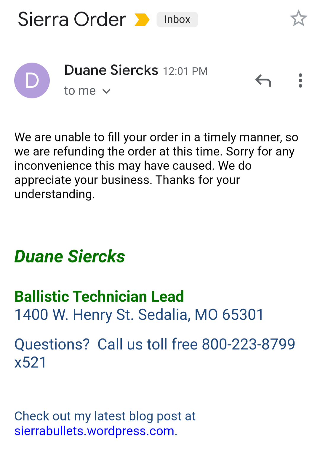

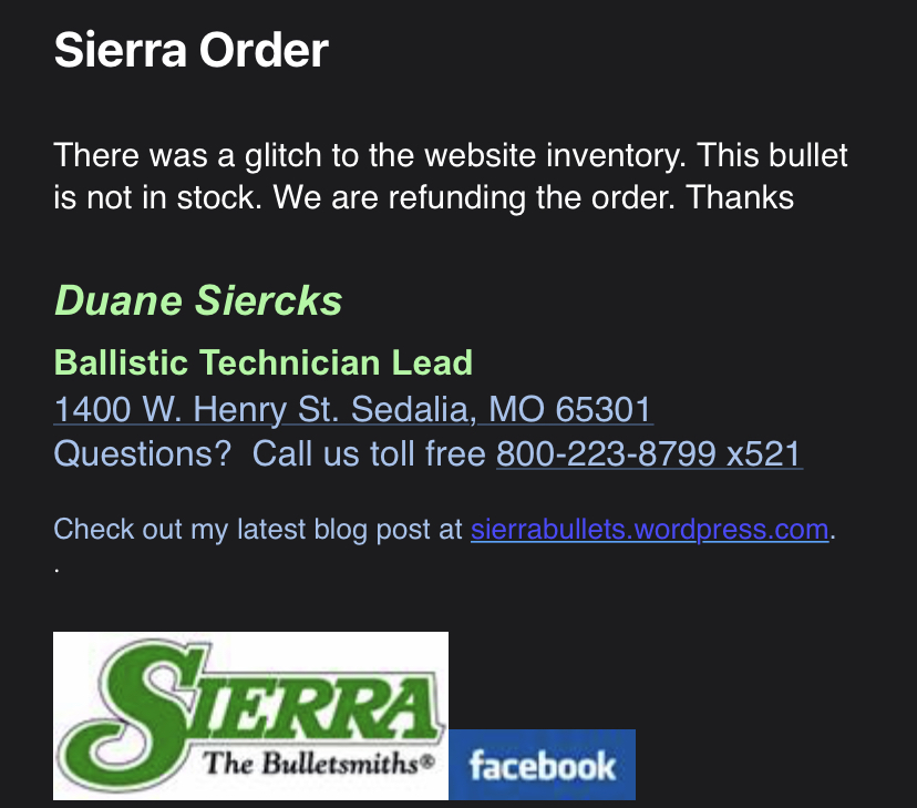

My order went thru for another box. Haven't got refunded for my first order yet, but figured I would be better safe then sorry.
Edit: second order was refunded and said there was a glitch in the system.
Very disappointing. Mine was also just cancelled while they show the same item in stock. I'm guessing that every order that is cancelled automatically puts one more back in stock. Those will probably be cancelled as well.
