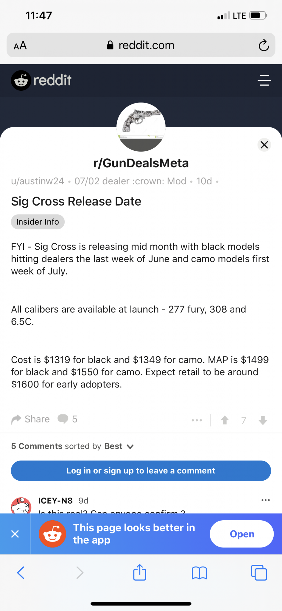

Can’t verify the source, but found this after a little google searching today...posted 10 days ago. The availability date and similar pricing was confirmed further down the page by somebody else who was told the same by their vendor. I’ll order a black 6.5 right away if this is the case, I’d like to get some time behind one before hunting season gets here.
