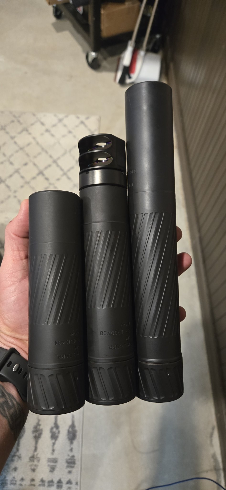

Moved the Magnus RR-K to my backup gun. After a 2 day match and a few other outtings, it simply does not perform like a close competitor on the market. The measurable difference between reticle movement between the two is over 1.2-1.4 mils in both vertical and horizontal movement (for example: other braked suppressor has a 0.6 mil rise on a 525 yard target. The Magnus was almost 2 mils on the same target). IMHO, it needs a different brake design with a flat bottom to prevent gas from 'lifting' the gun. (And yes, I ran it 9/3 and 12/6 configuration).
However, it works really well on magnum cartridges. Really, really well... Likely due to the amount of gas produced.
With that said, I'm still waiting for my Ultra 338 RR.

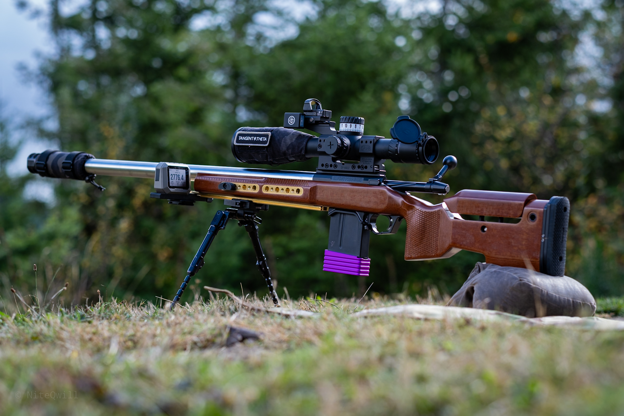

Shot my 300 PRC rifle with the full size Magnus RR installed last weekend. Worked exactly as advertised. Very quiet and also reduced recoil quite a bit. Very happy with it! I'll try to get some video of it in action this weekend.
