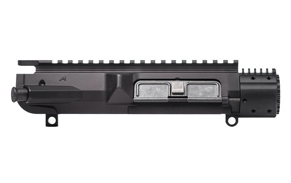

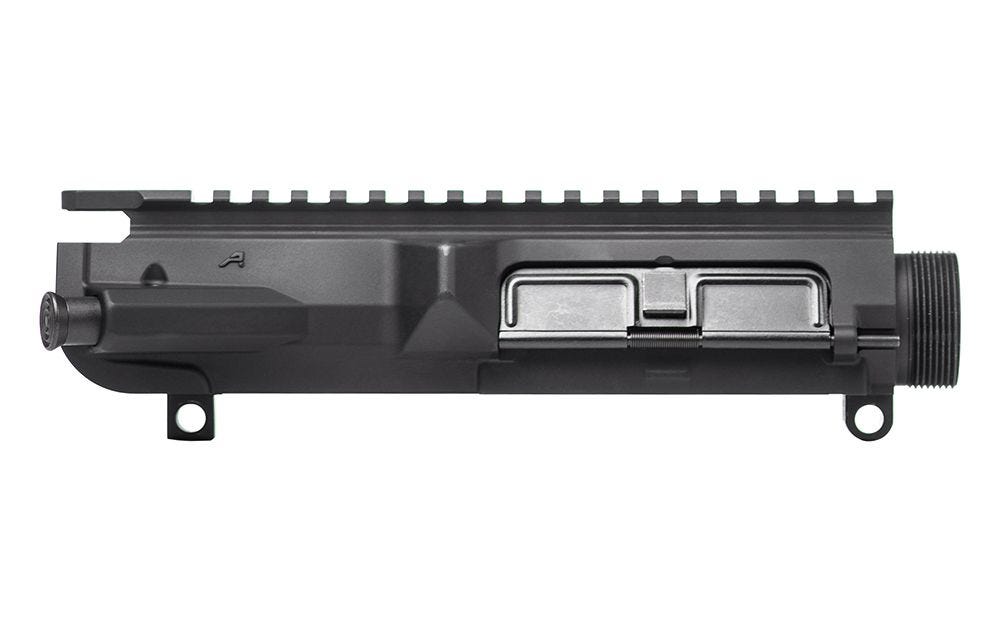

OP, do you truly have the M5E1 upper, which is what you stated in your first post? (See picture)
If so, you can ignore a lot of what redneck is saying as most of it is subjective.
Yes is is the M5E1. I just called Aero precision and there are no shims used anywhere on this platform. Had me worried a shim in the barrel mounting sounded like bad news.

The m5e1 upper is does not use shims to align gas tube hole in the barrel nut, because there is no hole in the barrel nut. The gas tube rides over it, through a channel in the receiver. Redneck doesn’t know what he is talkin* about, in this instance.
One other thing I would change is doing a Superlative adjustable clamp on gas block over the JP. The Superlative IMO is a better design and easier to set up and tune. The detents and feeling the click between settings is also nice if you are shooting suppressed and unsuppressed as you can tune it for both and know the difference between proper function without the can is X amount of clicks more open so you just do that and back and forth vs having to mess with a set screw and eyeballing the amount of turn you'd be going on the JP. The Superlative is also lower profile and fits under hand guards better.
JP makes click detent gas blocks.
I ordered two sets and both sets came with the shims and instructions to use them. I didn’t on the set that I built out because I didn’t see why I needed them and thought it was retarded but it most certainly came with them and said to use them.
Shims. It comes with them.
That's for putting an enhanced handguard on a regular upper.
That whole piece is part of the upper on an Enhanced Upper.
I see it now. The e1 enhanced receiver takes its own special barrel nut. That doesn’t need shims.
But they also make a stand-alone nut that allows that handguard to go on a DPMS upper. which needs shims.
Maybe they revised it. I bought two full M5E1 sets that the handguard mounts to the receiver and they were complete in one box so not separately bought parts. They came with shims and instructions to use them and I thought it was retarded, didn’t see why they were needed, so I threw them in the trash and sent it without them. So possibly an issue with packaging and generic instructions two years ago when this took place. Still, I sold the build shortly after and the extra kit because there was a lot that I disliked about it, mostly just the handguard design and size. It’s proprietary too so you’re stuck with it. You’re stuck with the Seekins too, but at least it’s a good design lol.
THere were some vendors that had packaging containing a standard m5 upper with the m5e1 barrel nut and calling it a m5e1 receiver. I'm not sure if this was straight from aero, but the current m5e1 receiver doesn't need shims. The use of shims to align the barrel nut obviates the major benefit of the "e1 concept," not needing to clock the barrel but for gas tube and handguard alignment.
These were M5E1 sets bought directly from Aero in Aero packaging. They came in a nice box with foam cutout for both pieces.
