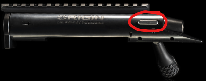

As noted the 700 platform actions open a world of options for chassis/triggers. Many of which can be found in the px here. If you buy from the px it allows you to try about any chassis or stock out there and resell for the same you paid if you decide you want something else

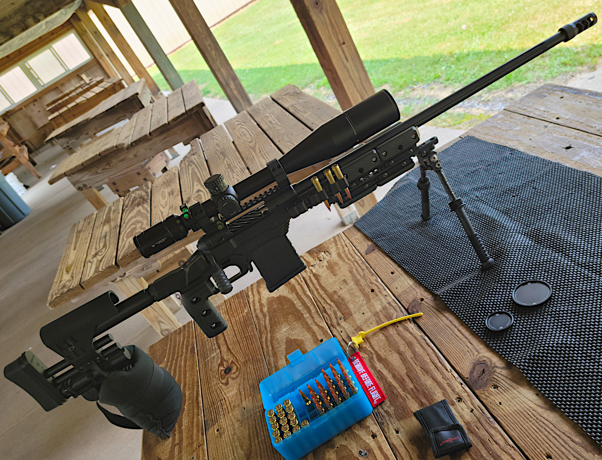

Personally I like MDT chassis. ESS was my favorite. I prefer a chassis and with the blocks in them you don’t need to worry about bedding or bottom metal. Just torque and go. KRG like the bravo is the same

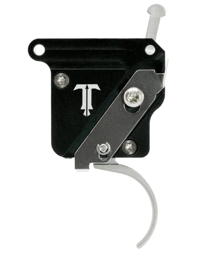

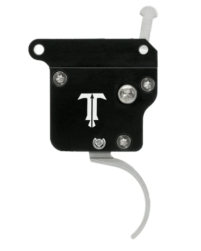

Timney Remington 700 Benchrest Trigger. It's a single stage. I'll have to try some two stage triggers before I jump on that train. Single stage triggers, right now, are all I know.
You sure you want a trigger that light? Being in your place a HIT would be a better option as you can go higher and then down as you need.

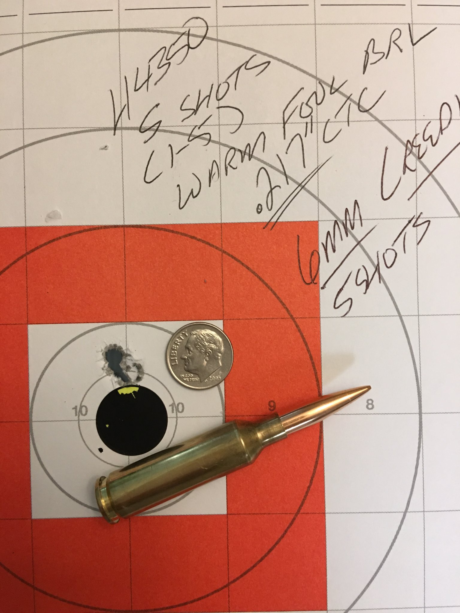

6.5 Creedmoor is a good choice. Get a 26" 8 twist barrel or even a 7.5 twist and you can have some fun. As I mentioned earlier you can easily change if you wanted to have more calibers on that same platform. That is why the easy shouldered prefit actions are great now. Screw barrels on and off like screwing in a nut and use the same scope, stock, action and trigger so no extra money going out.

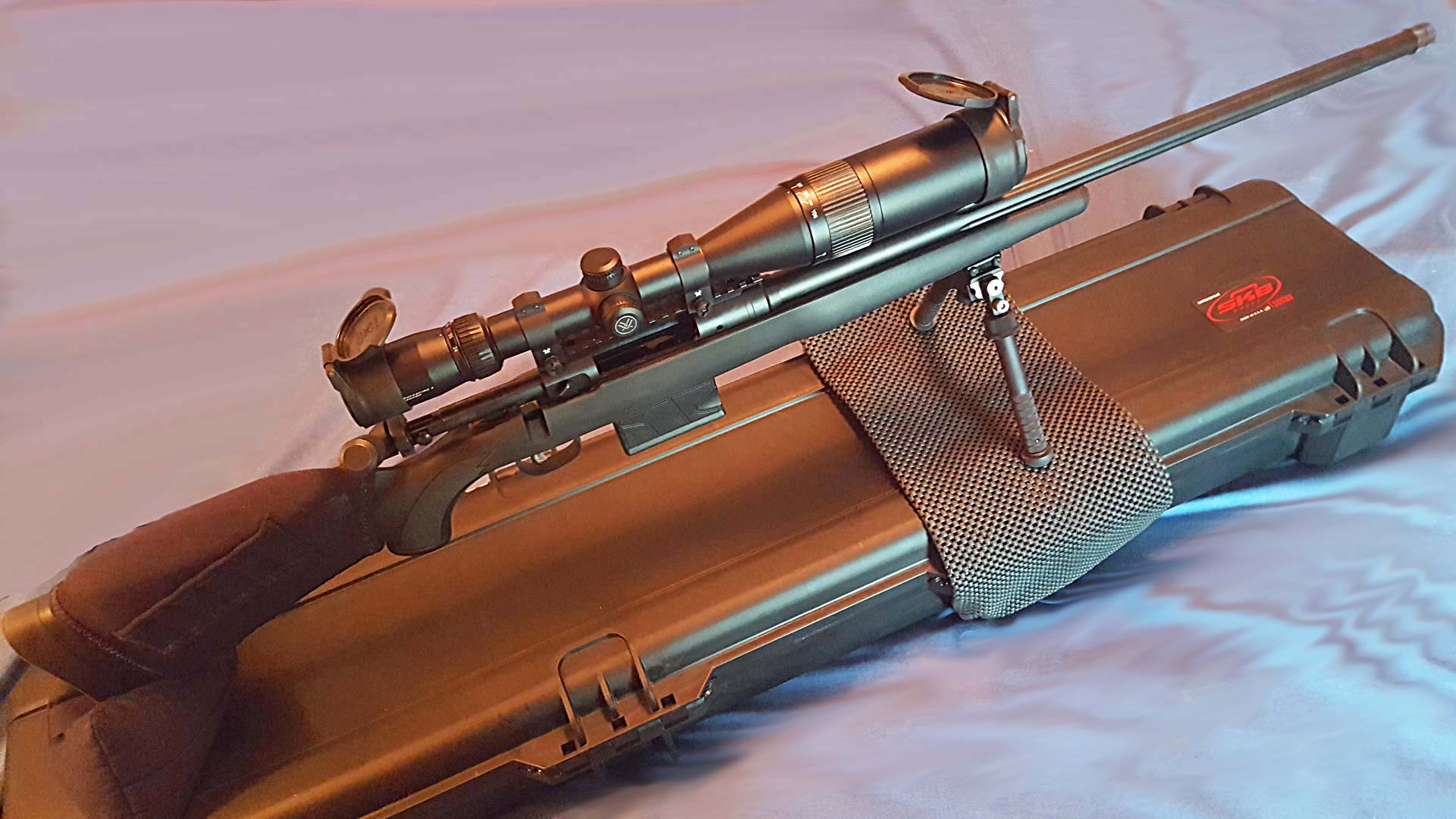

My first bolt gun was a Savage 10 FCP/SR in 6.5 Creedmoor. I shot it right out of the box with a Vortex Crossfire 6-24X50 scope and an Atlas BT10 Bipod. 100 yard consistent MOA was sub MOA - about .75 MOA with factory Hornady 147 gr. ELD Match ammunition. Never missed a lick , no FTF, no FTE...the damn thing just rocked right out the box.
Everything in the pix the gun is like $800 and it shot sub MOA in the hands of an absolute dip shit/dumbass Newbie to 600 yards. My Nephew fresh out of the Marines shot this gun better than his Super Duper Custom with the same ammunition and the same range. His $3K+ Custom was way slicker, smoother and fast but it was not as accurate consistently in his hands.
Then I kept adding stuff like an MDT LSS-XL Gen2 chassis, weights, an XLR butt stock, and numerous other goodies and the gun is now a .5 MOA gun out to 600 yards . Everyone tells me I'll never recover the cost of this rifle if I ever decide to upgrade but I already have a short list of people who will buy it for more than I have in it if I ever let it go. Which I will not. Ever.
I'm not suggesting you buy a Savage *but* I am suggesting that if yer maybe not certain that a Bolt Gun is gonna be yer forte' that you might not want to spend $3K+ getting started and maybe buy something that can be upgraded while shooting sub MOA right out of the box like I did. If I had to do it again I'd do it exactly like I first did it. Retired now and if the stock market recovers I'll have me a Savage in .338 Lapua mag and do the same thing with it. I'm kinda fond of Savages for what I do. YMMV.

The kind of accuracy you seek is gong to cost some coin $$$. Out of the box is not going to cut it. You will also need to know a thing or two about reloading.
Take a look at Impact Precision. I would look at the 6mm Dasher or 6mm Creedmoor for competition. Get a bigger caliber for tactical applications. I tried the MPA stocks but it felt cheap and rattly compared to the Foundation.
Here is my PRS Gun:

For those not aware, I read up on the Timney Remington 700 Benchrest Trigger and it doesn't have a safety or bolt catch features. The Origin Action doesn't mention anything about a safety or bolt catch. Is this something built into the action or is it possibly built into the chassis?
Pardon the newbieness of the question, but I can't find that type of information on anything I've. I just have to have the safety. Not really sure what the bolt lock is.
The bolt stop (or "bolt catch") you refer to is the original Rem700 design, where the trigger group has a little steel piece on the left side that has a tab down in the trigger guard area; you press up on that tab, which slides the bolt stop up and lets the bolt pull backwards all the way out of the action. Here's a pic of an example from TriggerTech:
As opposed to a trigger group that doesn't have it:
The Origin has the bolt stop integrated into the action, it's on the left side. Most modern R700 clones have gone this route. It's this little button circled in red:
The safety is part of the trigger group in the R700 platform, so a TriggerTech Primary or Special will have what you need. Get one without the bolt stop, or if you get one with the bolt stop, it's easy to remove, you just unscrew the one screw and pop the little e-clip off, then it comes off and you reinstall the screw and clip. Some other platforms integrate the safety into some other portion of the receiver system, but with R700-style receivers it's part of the trigger group.
