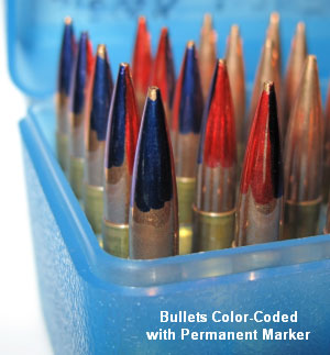

Lets just start our own. Instead of having the friend mark each shot, get a sharpie and color the bullets and shoot them onto white paper, you can see the ink left on the paper denoting which charge weight each shot was.
I just use one color per bullet unlike these with several colors on each. Same idea though.
