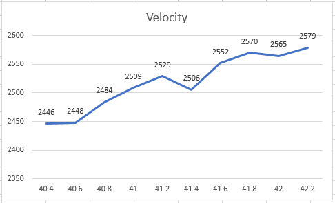

A couple of nice velocity nodes to investigate ...
- Tikka T3x TAC A1 in 6.5-Creedmoor
- Peterson 1x fired brass (Annealed, FL-sized, Mandrel)
- Hornady 147gr ELDM
- StaBall
I'm going to load 10 at 41.9 and see how they group. Very happy thus far with StaBall in all three of my 6.5-CM rifles.
