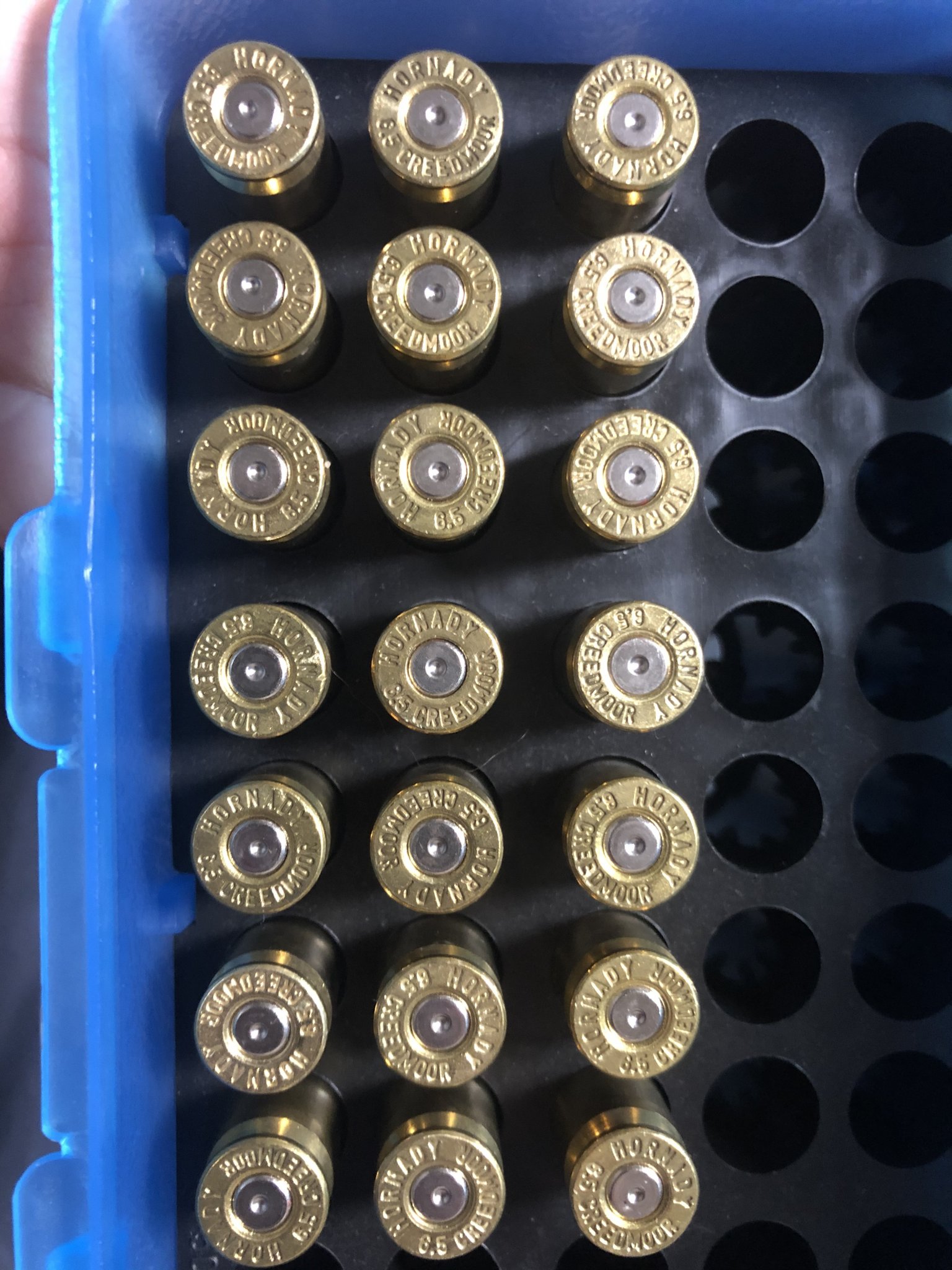

Went out and did my first ever load development test, found the best groups at .060 off the lands, and then I went to powder, following Scott Satterlees LD process.
6.5 CM
140gr Nosler Custom Competition
Staball 6.5
Federal Match 210m primers
Hornady 1x brass
No pressure signs all the way up to 45.4, primers less flat than the factory hornady loads, no ejector marking or smearing, easy bolt lift. Seemed totally fine

Primers from 44.2grains on top to 45.4 grains on bottom

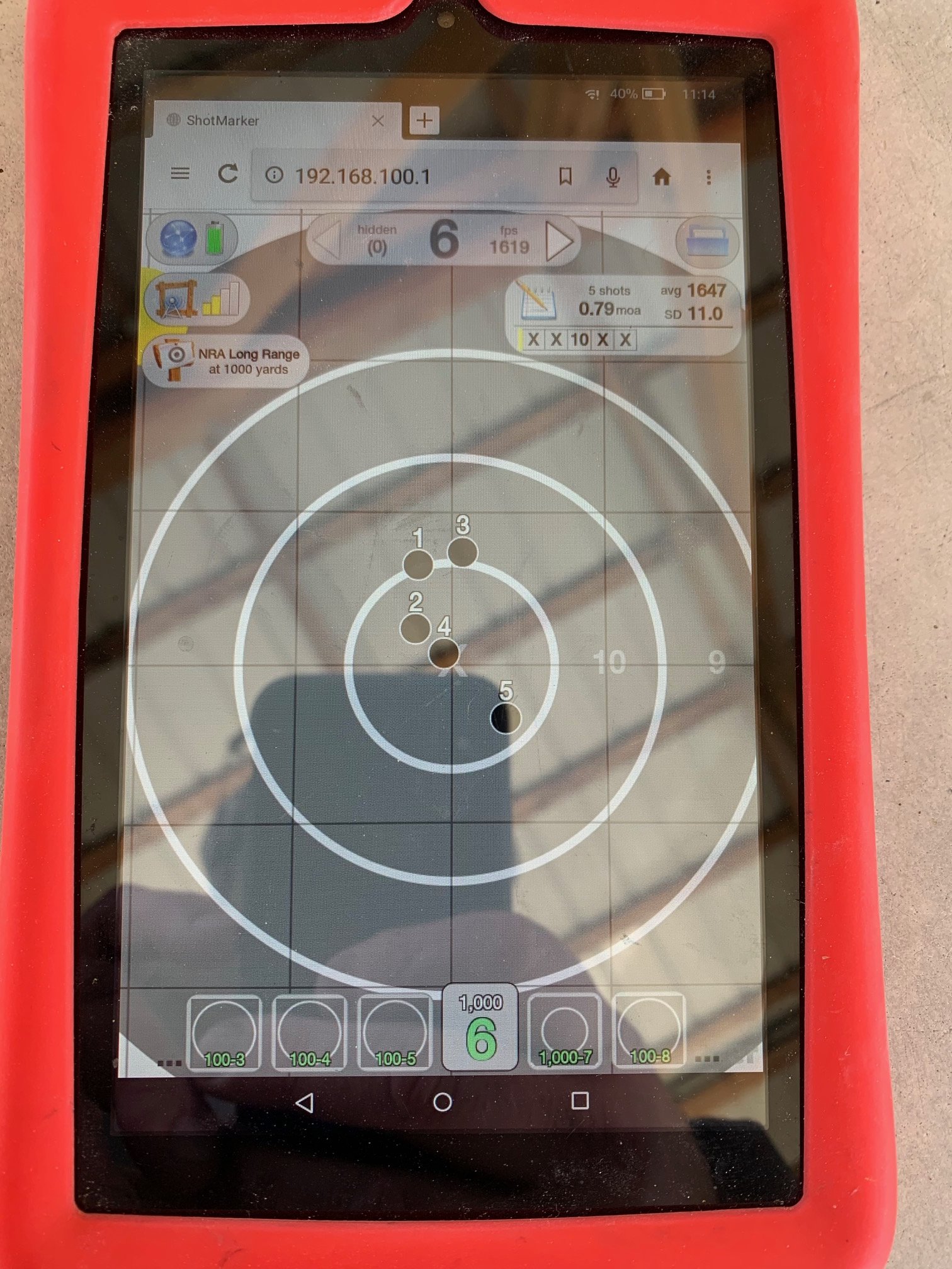

6mm Creedmoor
1:7.5T 26"
44gr Sta-Ball, DTAC 115, Hornady Brass (8x fired?), CCI 200
FL size -.002" bump, ~.002" neck tension, ~.100" jump to jam.
2987fps @61F/28.5inHg/25% - No chrono - speed trued at 600yrds in Strelok Pro.
G7 .302 BC was dead on @800 and 1000.
Dropped straight into cases, $50 measure, $50 scale... powder took about ~15mins to do 100rds.
1000 yards off bipod and rear bag (wasn't even the best group, just one I remembered to snap a pic of):

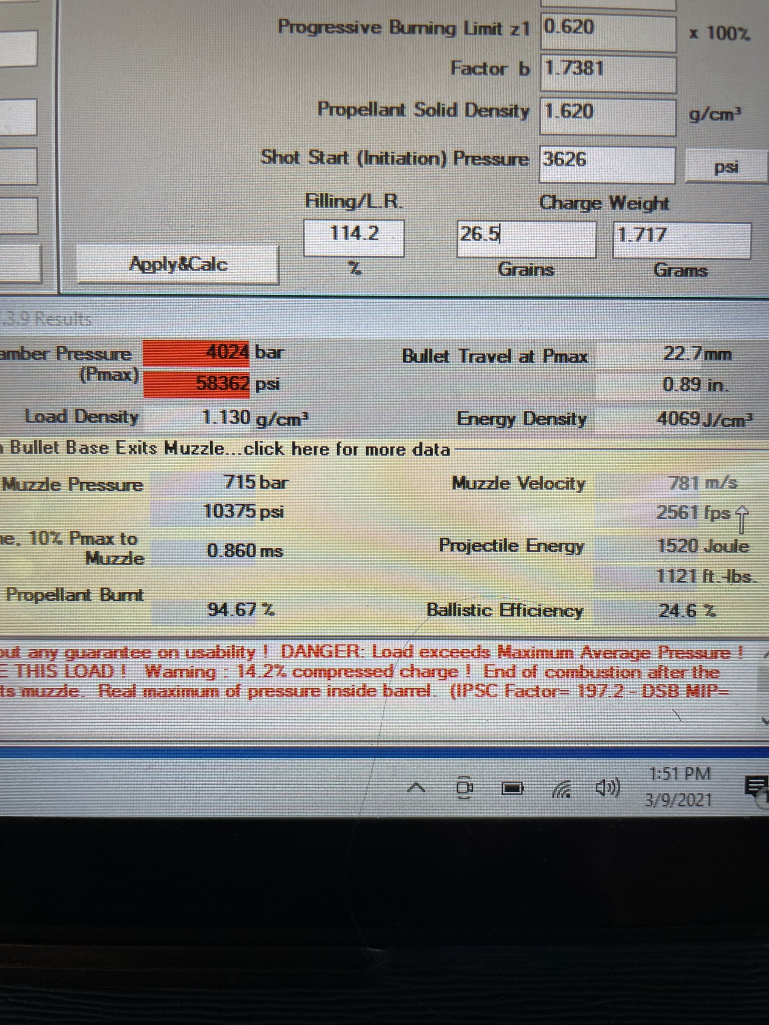

loads published on
Loads published on Hodgdon range from 24.9 - 26.8gr. I have settled at 26.5gr.
I plan to do a chrono on the loads soon. Hodgdon claims 2750fps for 26.8gr. Out of a 24" barrel. I am hoping to get at least 2600 fps out of my 16" AR. This isnt a precision round for me right now, shooting out of a 16" AR with a 1-6 LPVO on top. I am getting consistent sub MOA groups around 3/4". Which is enough for my intended purpose. Before StaBall, I was using varget and got similar results.
This is what quick load came up with at 2.260 coal 223 rem

You piqued my curiosity so I gave your load a try this afternoon:
77 TMK, OAL 2.255"
LC 19 brass, once fired
Fed AR match primer
StaBall 6.5 26.5gr
The results were pretty slow.
16" 223 Wylde AR - 2411 fps
20" 5.56 Ballistic Advantage AR - 2489 fps
In comparison I'm shooting the same bullet from the 20" at 2940 fps with Lever; there is no data so the load might be warm but case life is good, and it doesn't give any more indication of pressure than the StaBall load above.
I'll add as well that I don't give a hoot what QL or any other calculator says until you've trued the results with your barrel, components, and powder lot. Otherwise the margin of error is so large that the results just don't mean much.
