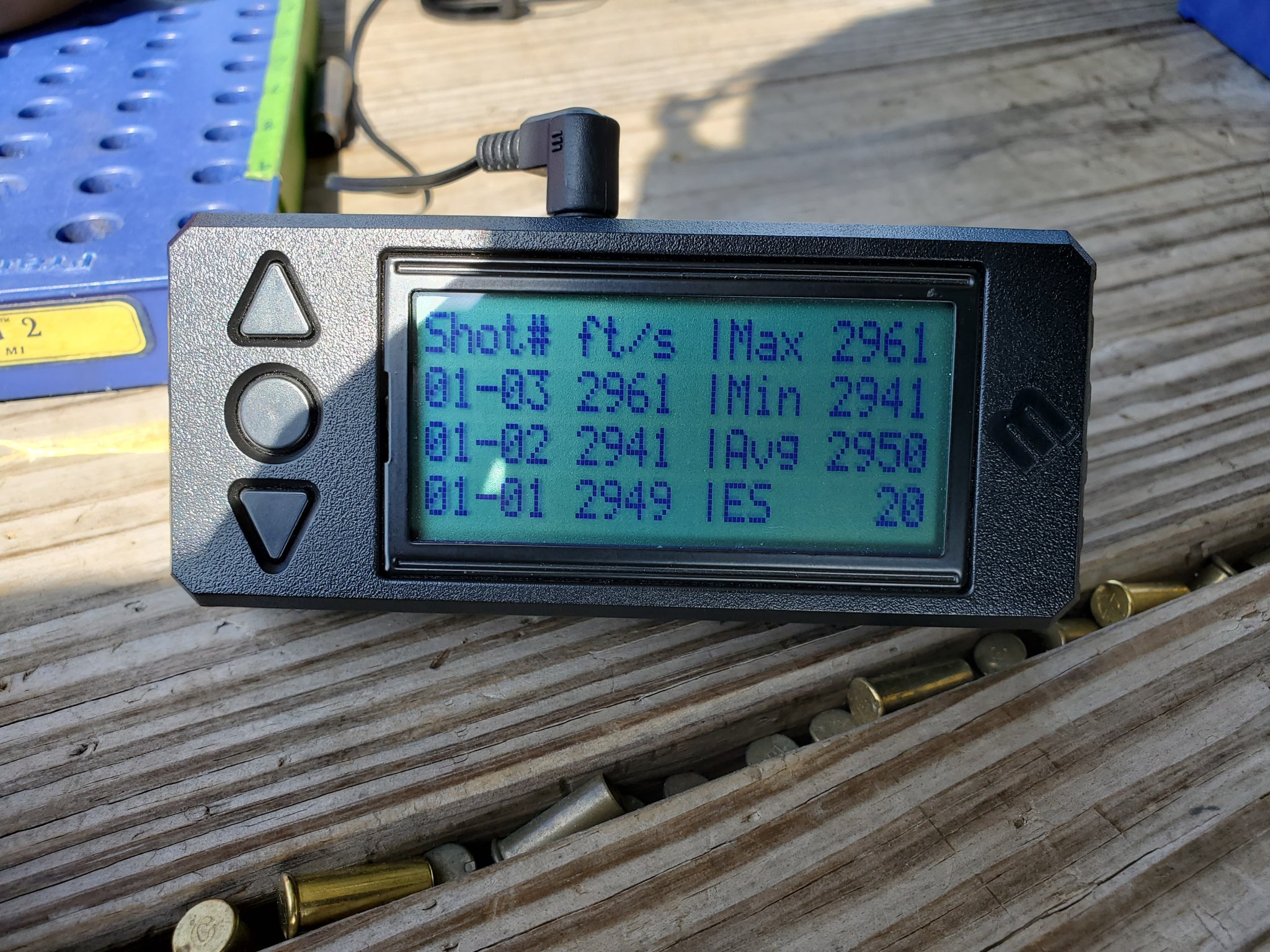

88ELD's @ 2910fps, good groups @ 100, 2999fps not so good groups.
ARC Arc., Criterion 6.5 Creedmoor 22".

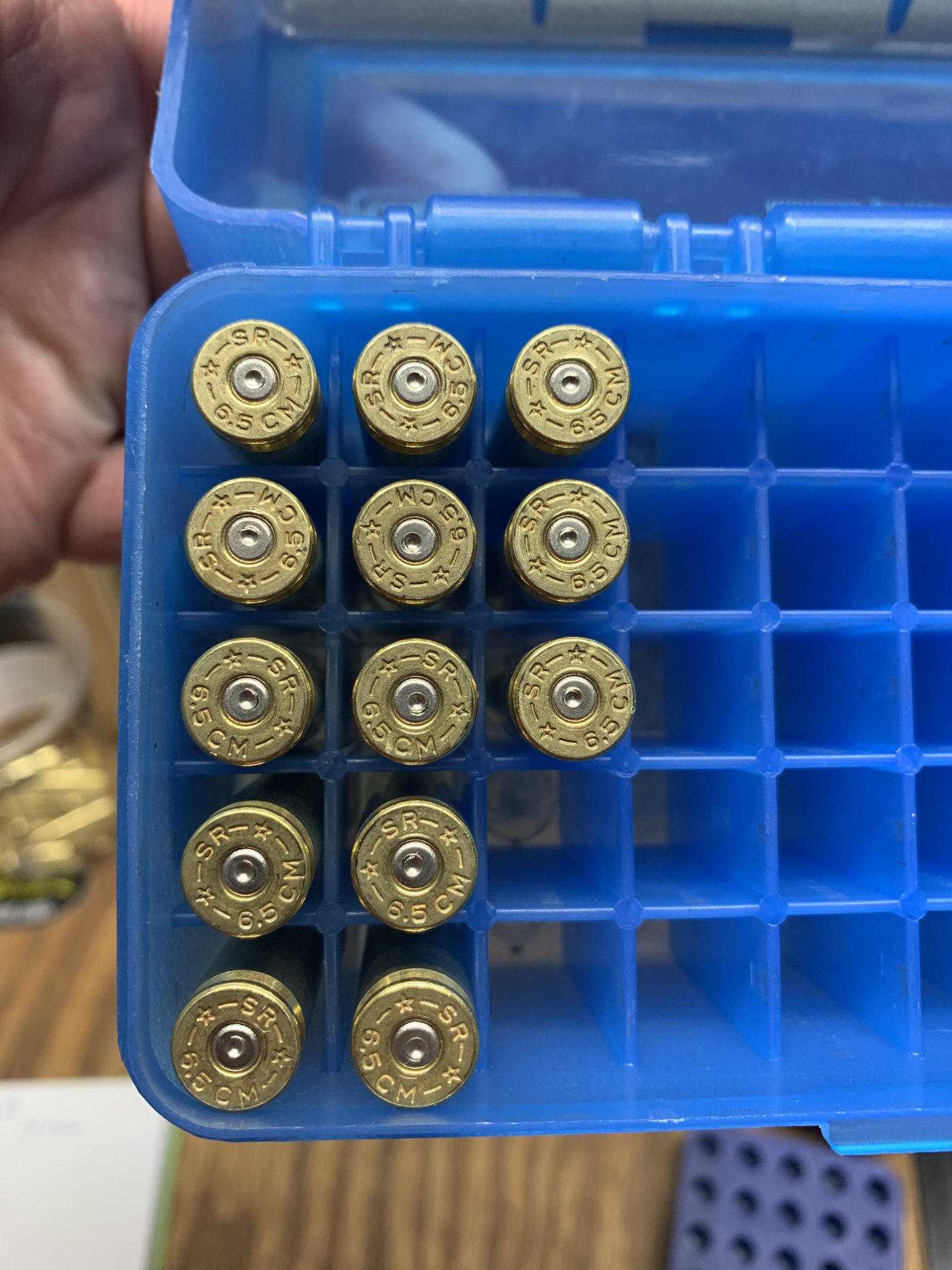

Initial rounds loaded to see where I hit pressure. No hard bolt lift, but I have a feeling something right around 46 grains is going to be good with these 130 Hornady's. There are 18 shots on this paper so the barrel has... About 23 rounds through it so far, lol. Velocity figures are going to be pretty low until it's broken in but I should be able to check velocity tomorrow anyways to get an idea. 4 of the groups are 1.3" and the other 2 are a little bigger. 200 yards.

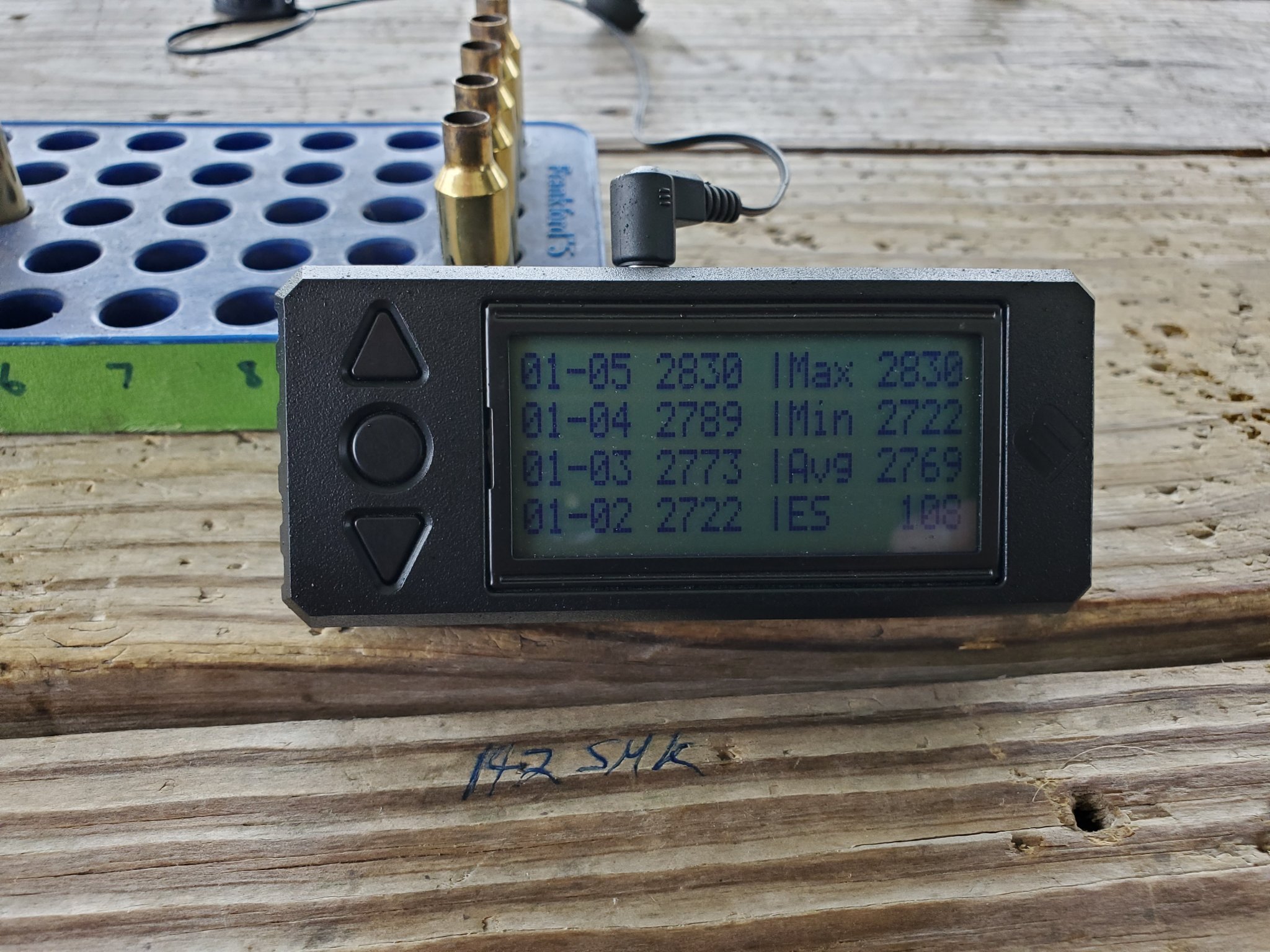

Today's outing. 200 yards with 142 Sierra's. Much more promising than the 130 Hornady's. Very good velocity from this powder from a 22" barrel. Velocities on MS readout are only 1 round from each charge weight but give an idea of speed
2- 43.8 ~2720
3- 44.2 ~2770
4- 44.6 ~2790
5- 45.0 ~2830
-Dan

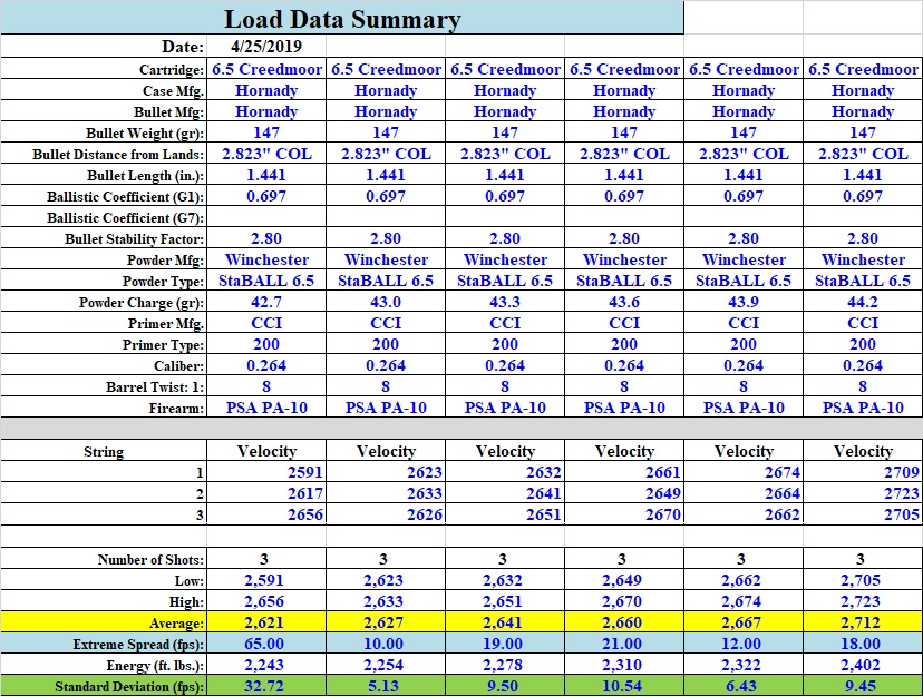

Palmetto State PA-10, 6.5 Creedmoor, 20" barrel. 43.9 grains of StaBALL 65 under 147 gr. ELD-M in Hornady once-fired brass produced 2667 f.p.s. average (3 rounds) 12 fps extreme spread. .661 MOA group.
It was part of a mini-OCW test (6 loads instead of 10), and normally I would pass a good 3-shot group as pretty meaningless, but 5 of the six loads produced very consistent data and 4 produced decent groups (sub-moa) as well. So I'm going to load up 20 of either the 43.9 load or the 43.6 load and see how it groups.

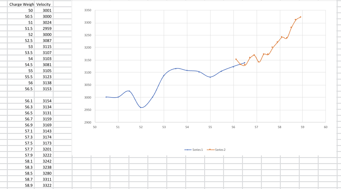

So I figured I would update here for those using the 6.5 PRC as I am currently using this cartridge in a hunting rifle with a 24” proof prefit. Due to the high velocity and possibility of close shots I am using mono’s to prevent bullet blow ups but my 7.5 twist proof limits me to the lighter monos. Since the Hodgdon data for lighter bullets only uses the same slow powders as the 156’s I have been doing testing to determine what the upper limit would be with a faster powder and so far StaBall 6.5 has produced significantly faster velocities though I have only done limited testing.
Currently I am using the 122gr Lehigh Controlled Chaos bullets with good success and started with the 122gr PVA Cayuga bullets to see how they performed since I was out of Lehighs.
So far I have run from 50gr all the way up to 58.9, primers are slightly flat at the top end but there are no extractor marks on the case head and bolt lift is normal.
