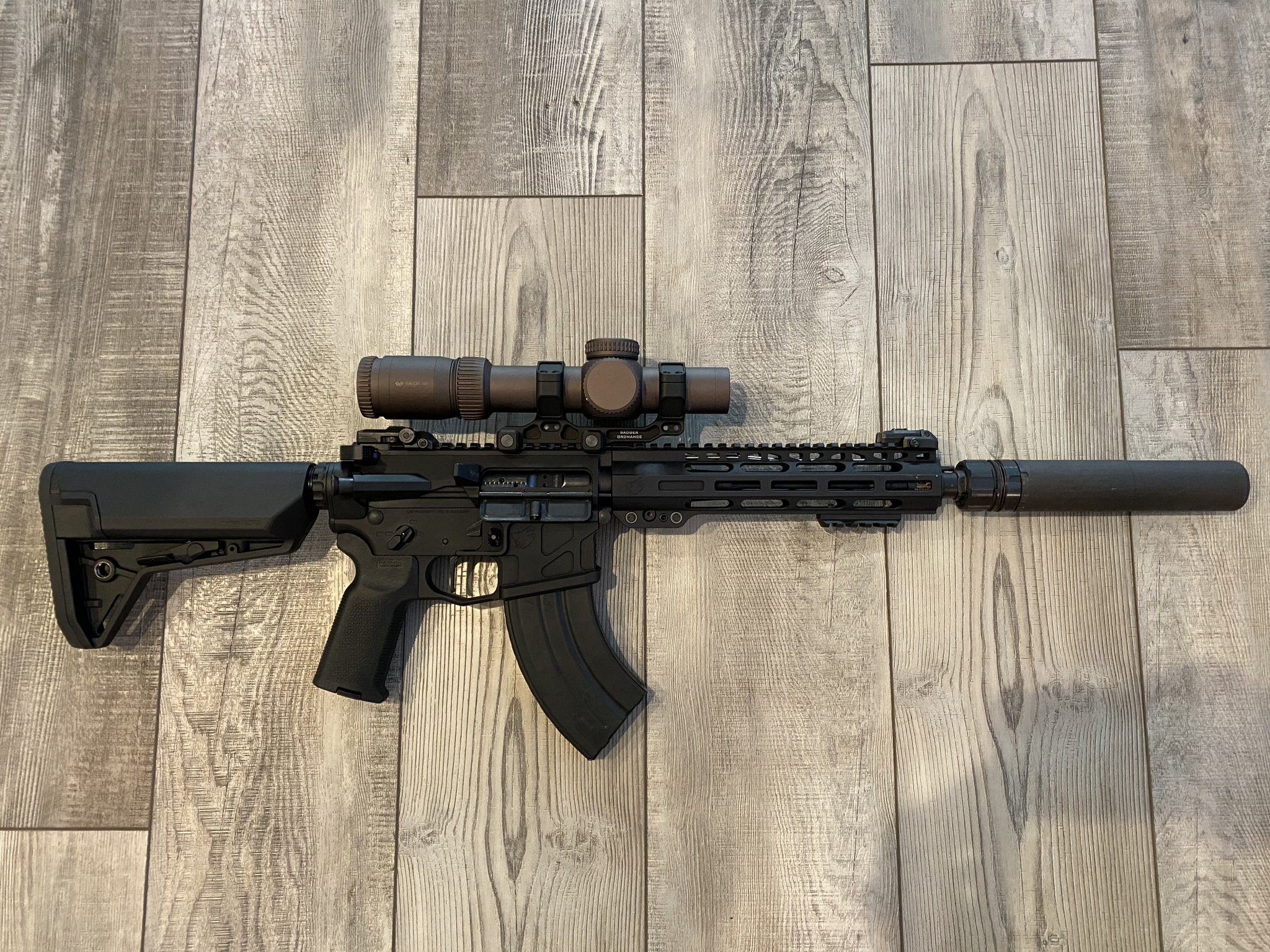

Vortex G3 on my 10.5” (with 9” handguard) 6mm ARC AR15 with a (longer) Saker 762:
Other than the awful color, I think it’s the best LPVO right now. I spent some time behind the NF and the extra 2x was noticeable to me. I sold it because I still wanted more magnification and moved on to an offset red dot, but if I were in the market the Vortex would definitely be my choice.
The NX8 1-8x24 is sick on higher performance intermediate cartridge AR15s, like 6.5 Grendel or 6mm ARC with short barrels.
For longer barrels, I would definitely lean on the Vortex 1-10x.
I would still go Vortex on shorter barrels. :) I don’t have any further pictures and have since sold the scope, but even with a tape switch and flashlight up front it was fine.
What badger mount do you have on the Vortex G3 above? Thanks!
1.54" 20MOA. I had just purchased the 1.70" prior to selling the scope, and would have switched to it, as I was not often shooting prone and was using the 'red dot' aspect more. That's the highest I would personally go, though, as I don't like chin welds, and I do shoot prone from time to time. I'm back to a 1.5" mount with the new optic, since my red dot is now an offset.
