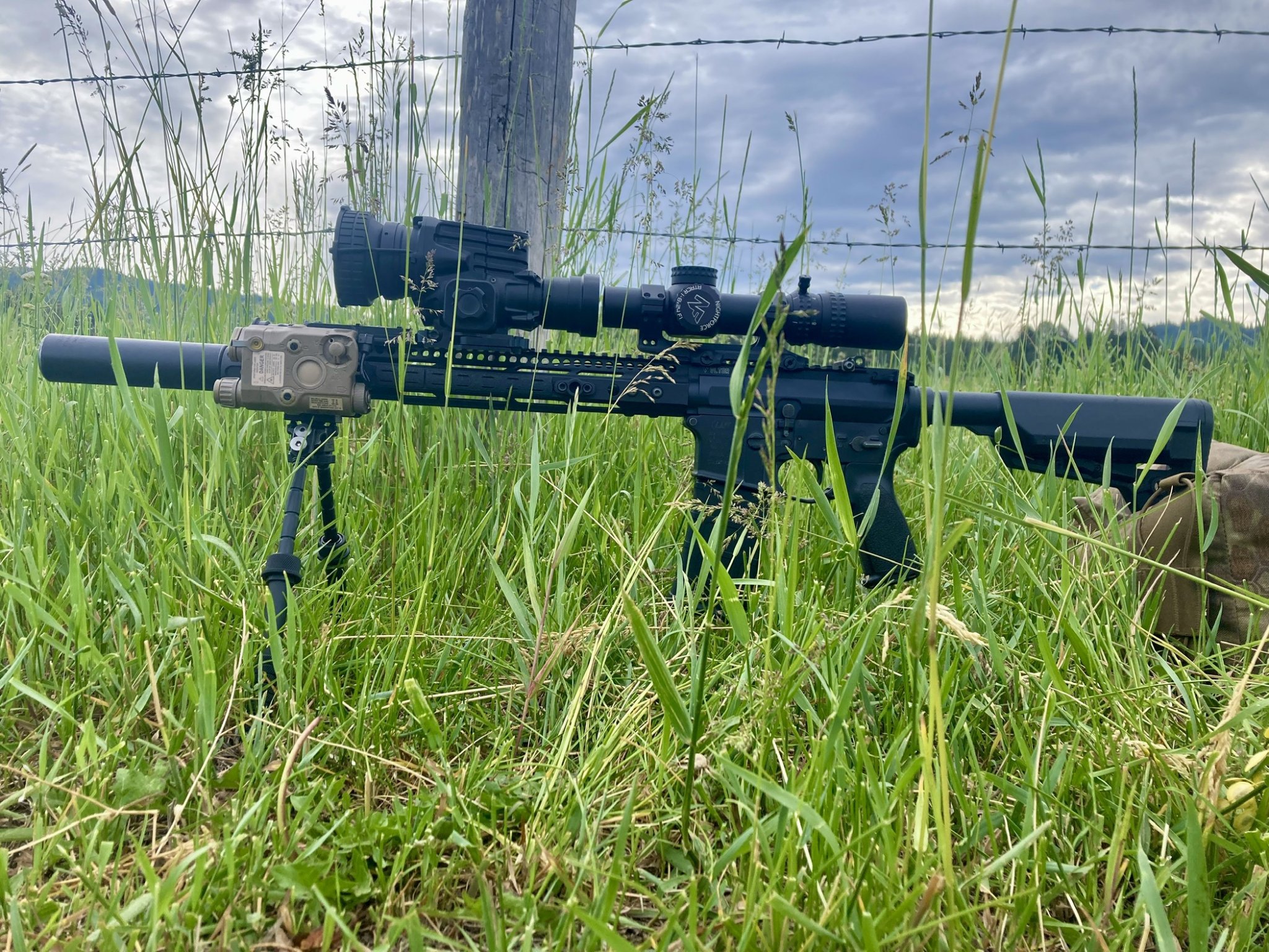

Goals: Test nox-18 has hybrid thermal clipon on 556(14.5) in front of ATACR 1-8x DMX.
( some background. Not all readers may be aware, but over the past 6 months, I've moved from KS to MO. Now in SW MO, on the North shore of Bull Shoals Lake about an hour East of Branson. The terrain here is VERY different than in KS. In the flint hills of KS we have gentle rolling hills and some woods and lots of pasture ground, only significant crop land was near KS river. You could shoot several kms if you had the proper permissions and could avoid shooting across roads (which was possible in some spots). Here in MO we are in the Mark Twain National Forest. There are very few natural clearings. There is some privately owned land in the forest, that was privately owned before the forest was "declared" and our new property falls in that category. Some of our land and some of neighbors land have cleared pastures. But they are tiny pastures compared to KS. We have a total of 22 acres cleared out of 80 and my neighbor has 70 acres cleared out of 110. In KS we had 200 acres cleared out of 250. So down here, a 200yd shot is a "long" shot. As the individual pastures down here are just a few acres each. We called small pastures like this "patches" back in KS :D
So "long distance shooting" is now an edge case. And FOV is now king - not magnification!
I'm waiting for some new Theon thermal clipons, and down to just one purpose built thermal clipon, the apollo42. But it spends all its time of the .22LR doing barnyard defense. I wanted to bring up a second gun in case I ever saw a larger critter near the chickens day or night. So decided to try to run the n18 as a "hybrid" clipon on 556(14.5) with atacr 1-8x. I use the word "hybrid" as this was used with the SNIPE when using the internal thermal reticle in front of the day scope. Of course the downside to this idea is the need to ignore your day scope reticle when using the hybrid clipon reticle - so this sort of "improvization" will not be for everyone. I don't consider it ideal, but I wanted to see if it would really work and if so, how well, so I decided to test it while I'm waiting for "real" clipons :D)
Environment: hot, dry, dusty, but still some mornings are foggy with inversion. The moon disappeared a few days ago.
Equipment: 5.56(14.5), ATACR 1-8x DMX, RRS, IMI 77, Nox-18. IPSC?2/3) steel.
Activity:
The 556 was already zeroed with the atacr at 156yds. So I mounted the n18 and then zeroed that in the day at 156yds using bolt gun with NX8 2.5-20x as a spotter.

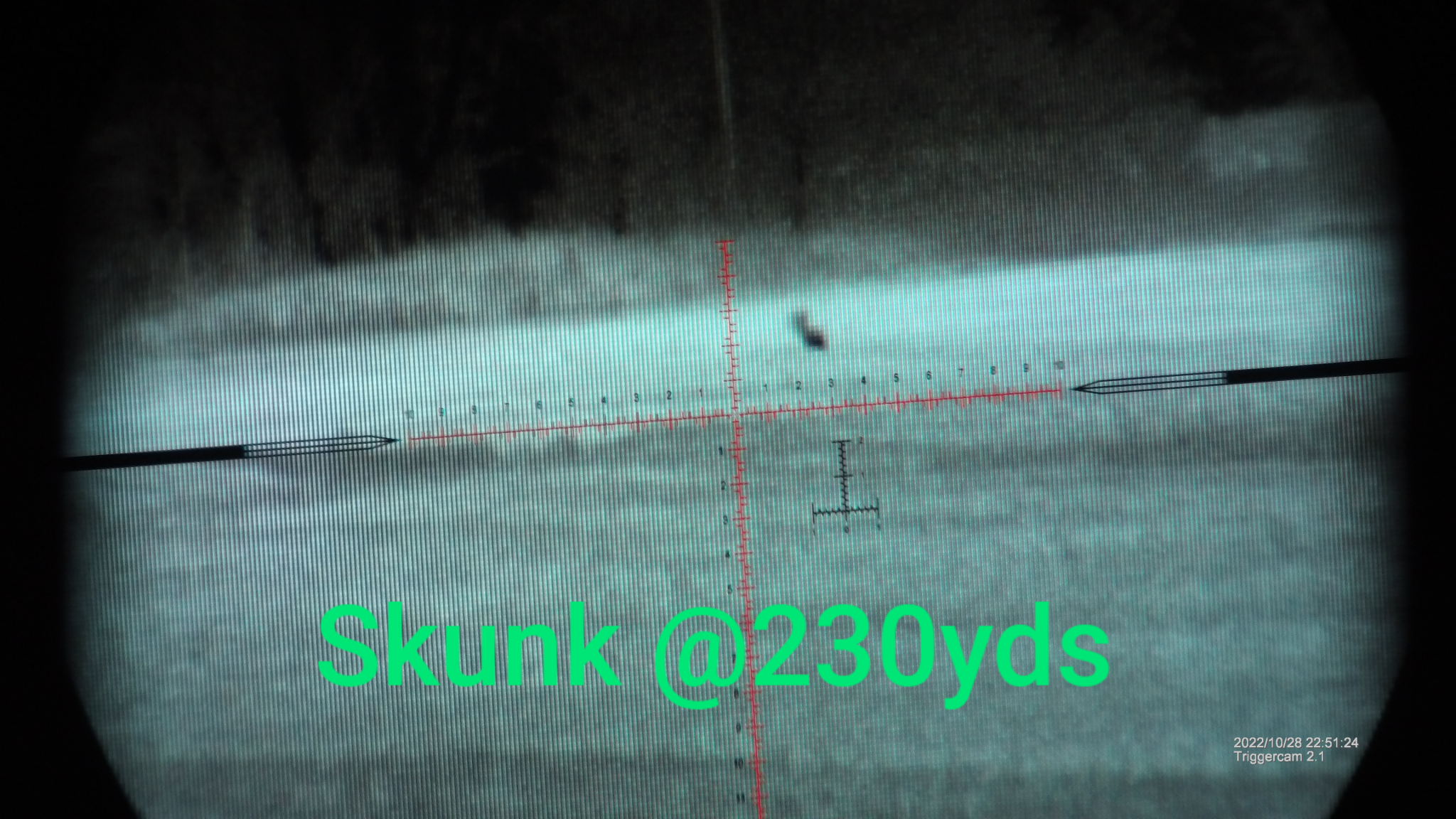

Then at night, fired bolt gun at face (with PVS-27) and 556(14.5) at center of torso with n18.

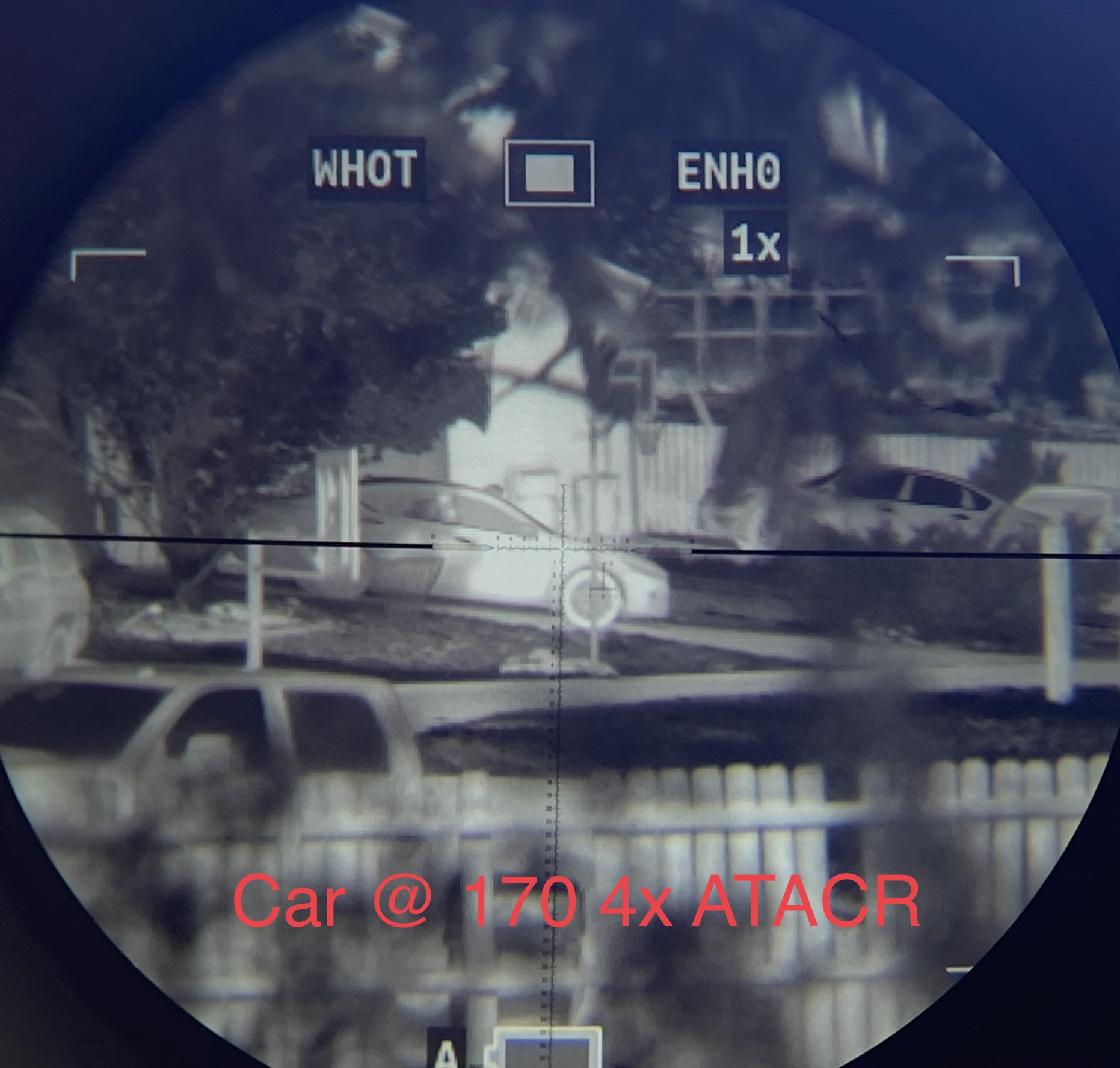

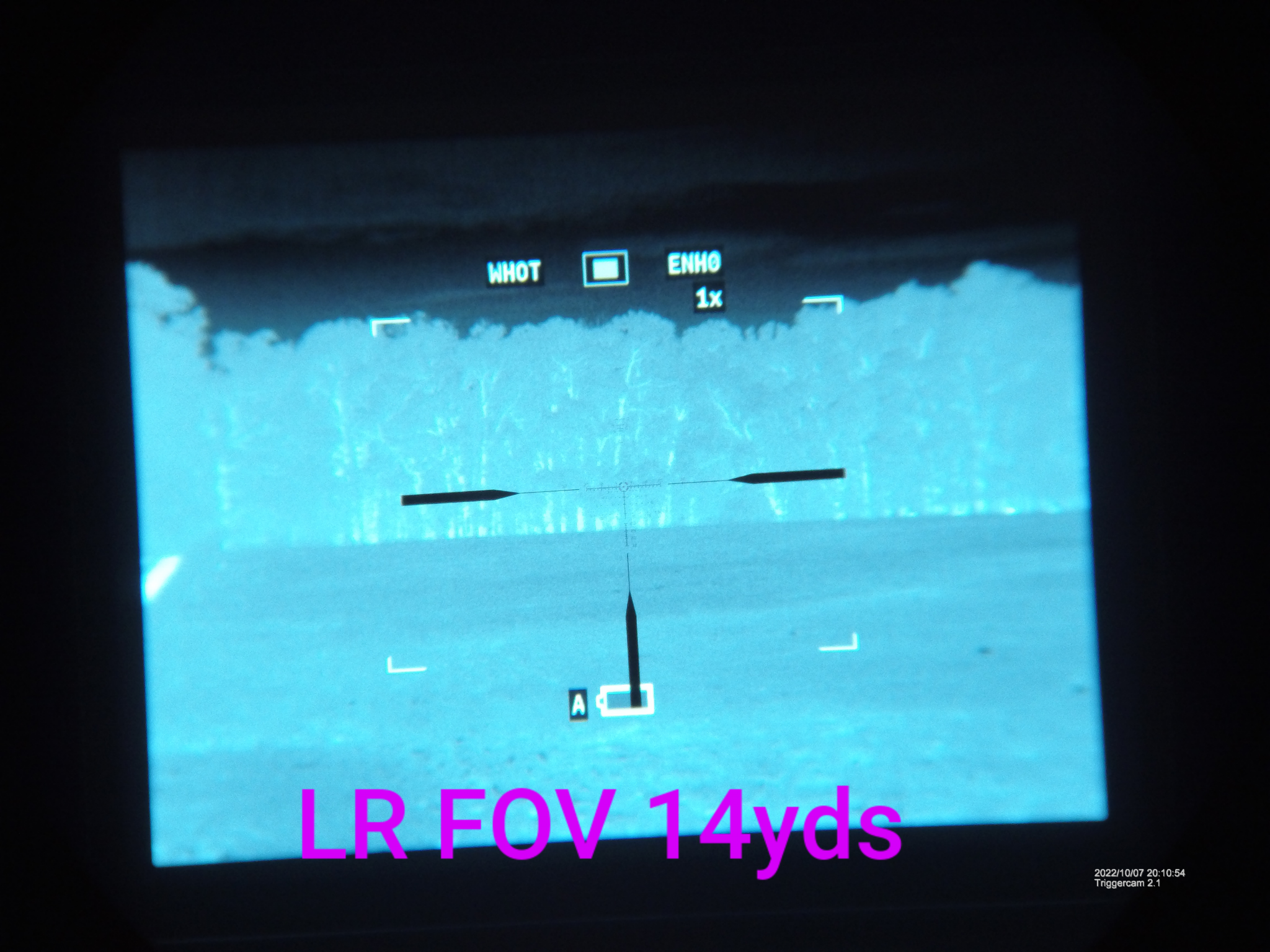

Then took a few thru the lens pics
Coop
chevron aiming at target
close deer about 40yds, far deer about 100yds
Thru the lens pics with the kyocera sucque. I got this phone to be an outdoor phone and its a great one. But I didn't realize I would be giving up so much with the camera. In order to try to focus on the back of the lens, I have to zoom in and it still fights the idea. Any "fuzz" is the camera or me. The image was just like a nox or a reap or what you're used to with a BAE core device.
Summary: Net/net, I find this to be useful as an "emergency" solution. Its not perfect, but its way better than nothing.

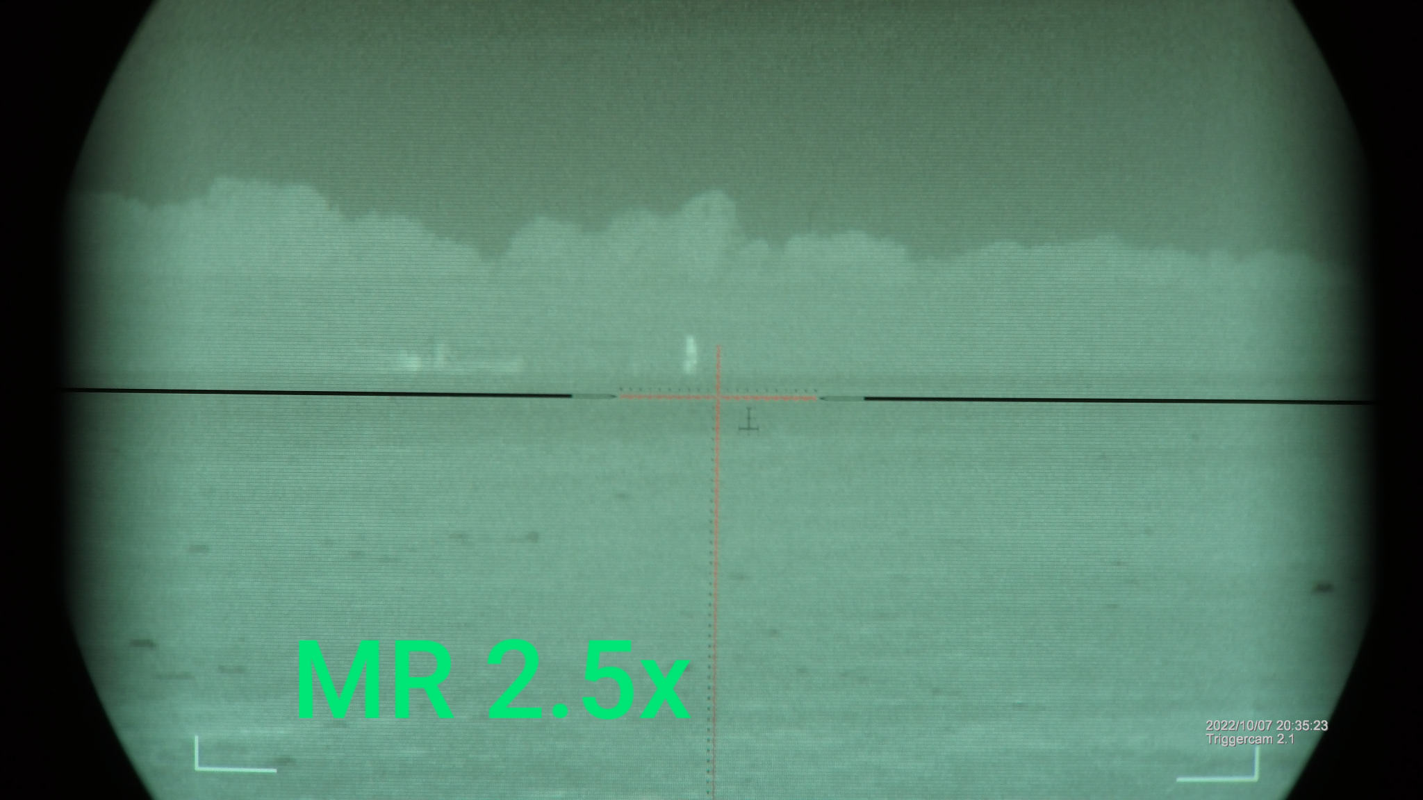

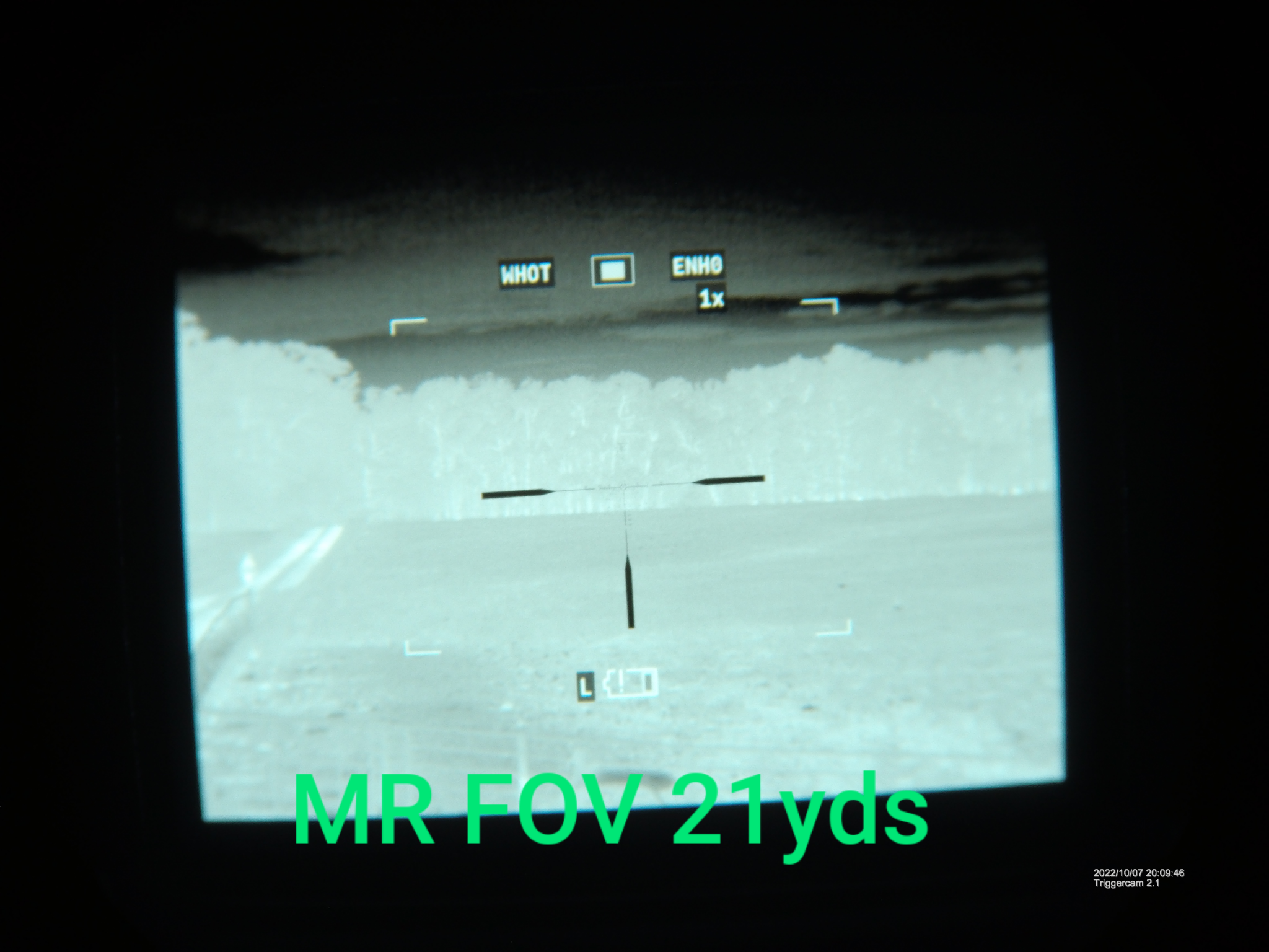

Received Theon MR (thermal clipon) today.
Its a little smaller and lighter than the LR version but has 50% more FOV. The LR marketing says 10x/12x on day scope and that seems to be the case based on my observation as well as others that I've heard from who have looked thru them.
Preliminary results seem to indicate the MR is good for 8x/10x on on day scope which again aligns with marketing.
So in my new terrain (heavily wooded area) FOV is definitely king and giving up 2x seems well worth it to gain 50% FOV !

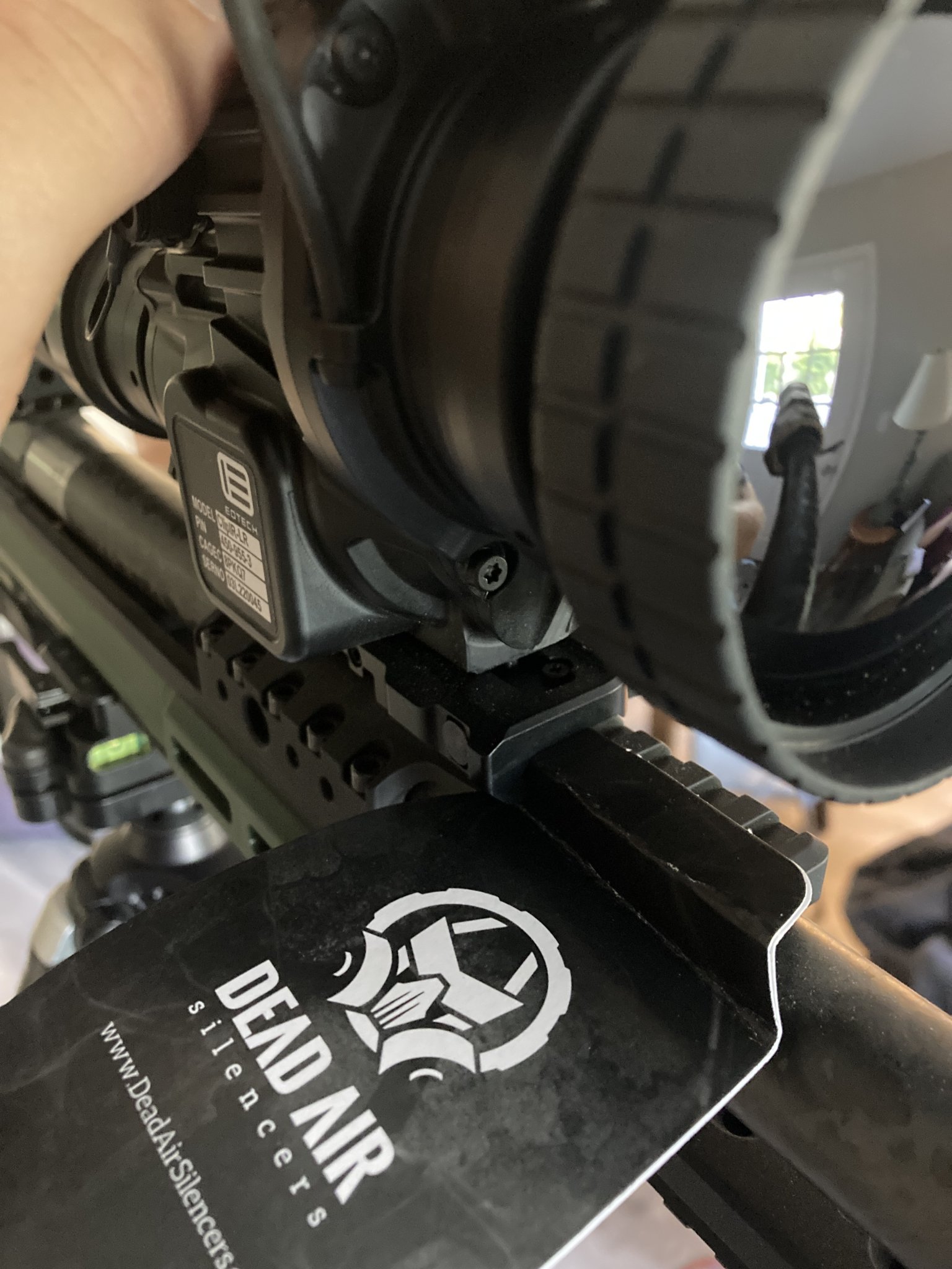

To further test/demonstrate the true clip-on nature of the Theon, I placed 2 layers of card stock in the mounting surfaces (between the picatinny rail and thermal mount). I did this at the front of the mount in a way that would aim the thermal up and right of its original position. This was to simulate inconsistent mounting from plant life, debris, sand, etc. getting in the mounting surfaces (you know, like will happen in real life situations). The POI remained unchanged. Quadrupling the card stock had no affect, even though the mounting lever was unable to even start to close and the unit had to be held in place by hand!

Mount: I’ve read concerns about the mount but it’s easy to adjust without tools and works great. If there are any issues, the ten year warranty and aftermarket capitalism will address them.

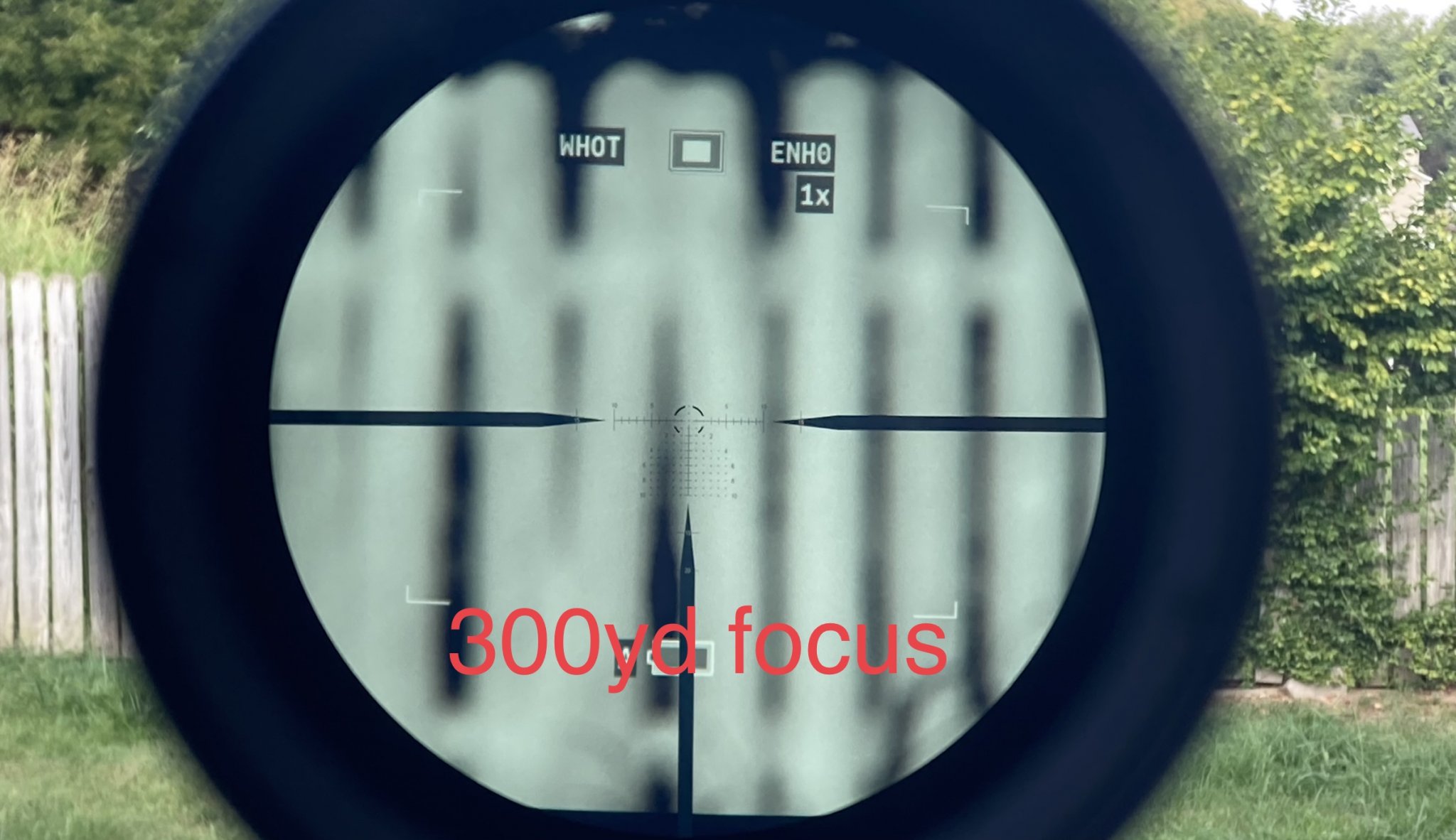

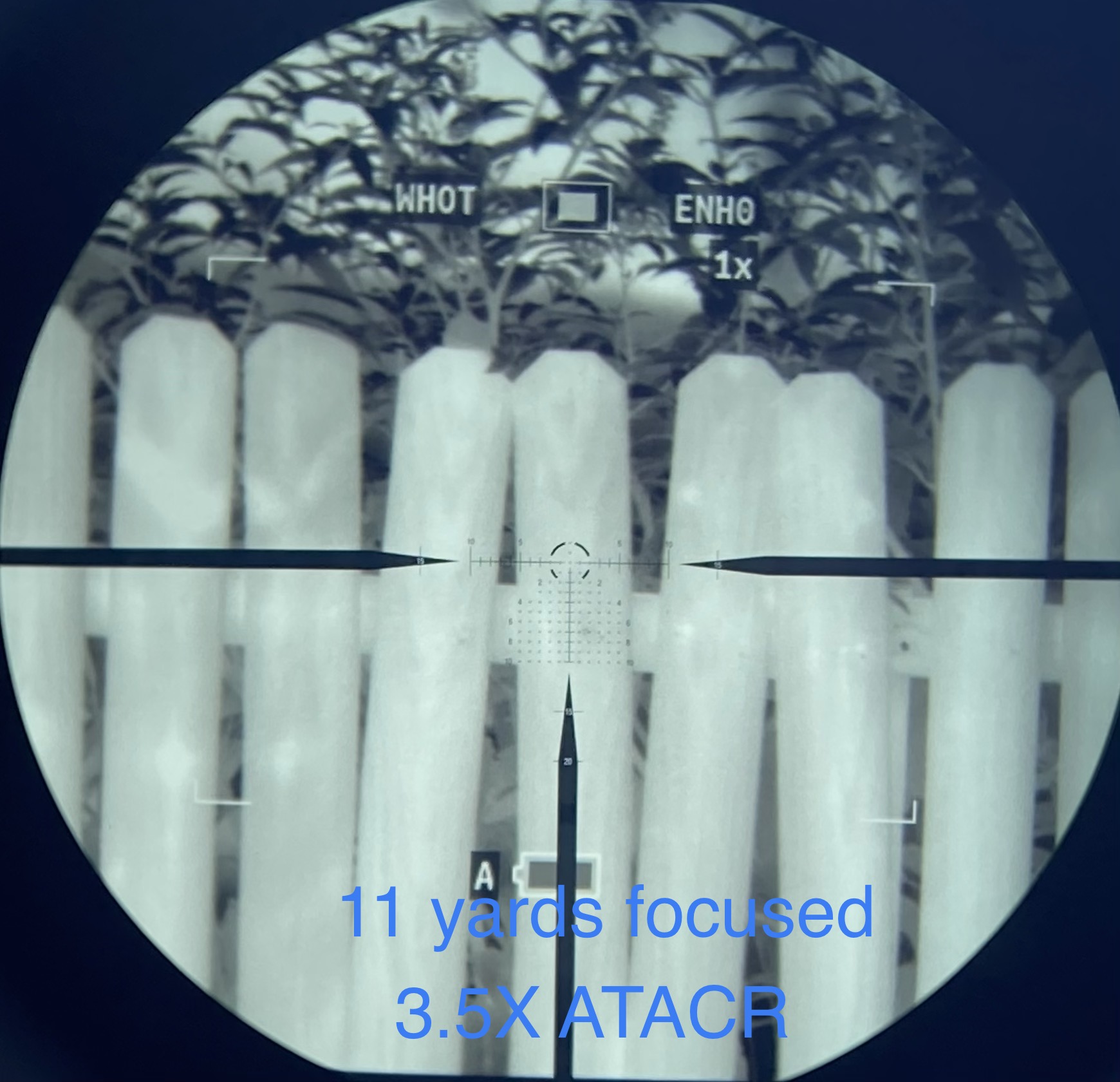

Focus ease/depth: The focus ring is really easy to reach and operate (for me on my setups). I set it at about 300 and don’t touch it. That makes it excellent from 150 to infinity. Closer ranges may benefit from more adjustment but I don’t bother. Pictures below show a fence (fuzzy picture) at 11 yards with a 300 yard focus… yeah, it’s fuzzy, but you wouldn’t need to touch the focus to engage a threat or predator at close range. The next photo shows that it will focus down to 11 yards.

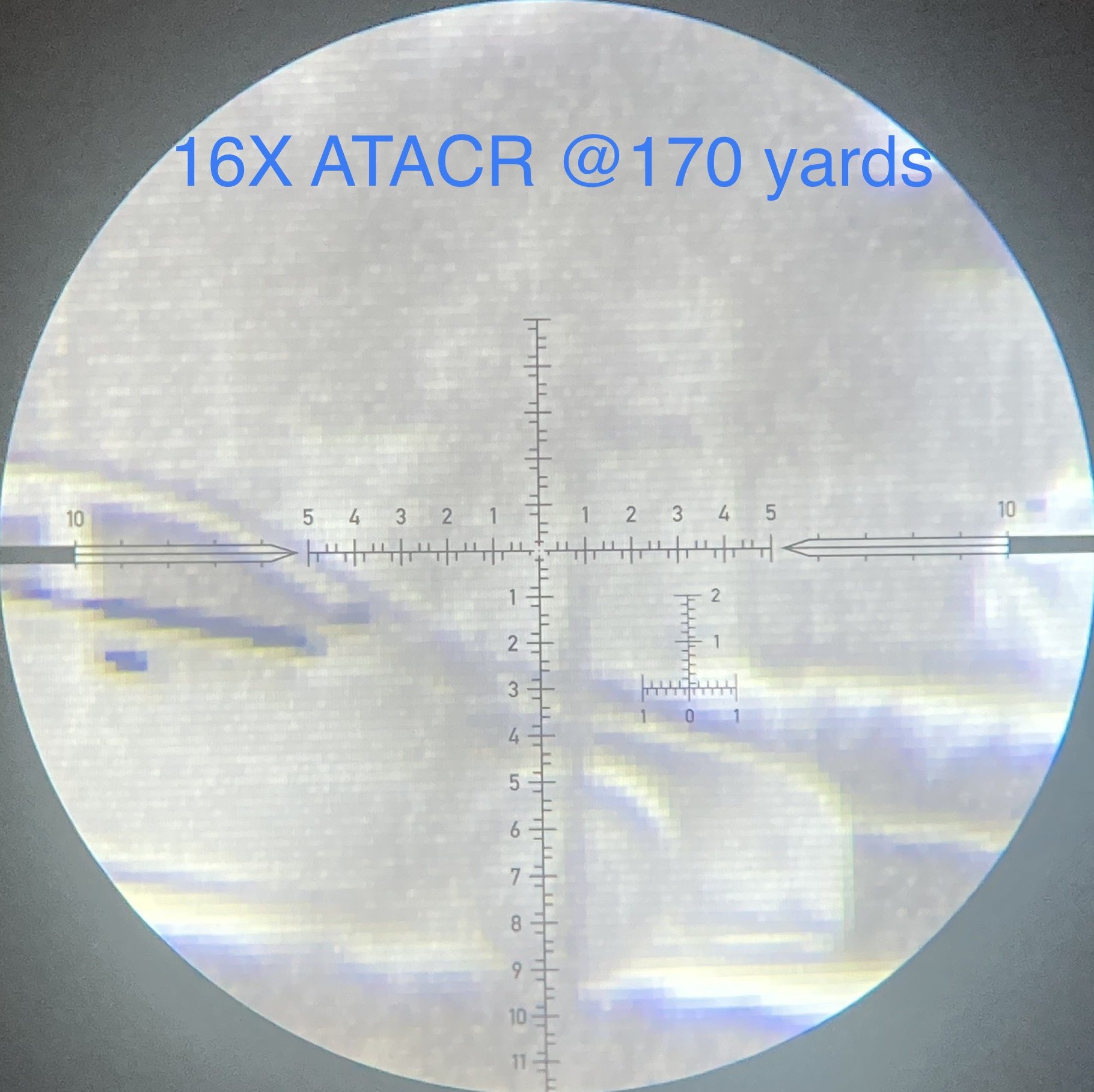

Day scope parallax: On the 4-16x42 ATACR, parallax set to 250 yards removed any error between scope reticle and thermal screen (head movement doesn’t move reticle in relation to pixels) regardless of actual range to target. This was close to the best focus as well but was not exactly. Focus and parallax are not the same thing and one is not necessary corrected by correcting the other. The 1-8 ATACR exhibited the slightest amount of reticle movement (barely discernible) with its fixed 125 meter parallax when my head was moved to the far edges of the scope.

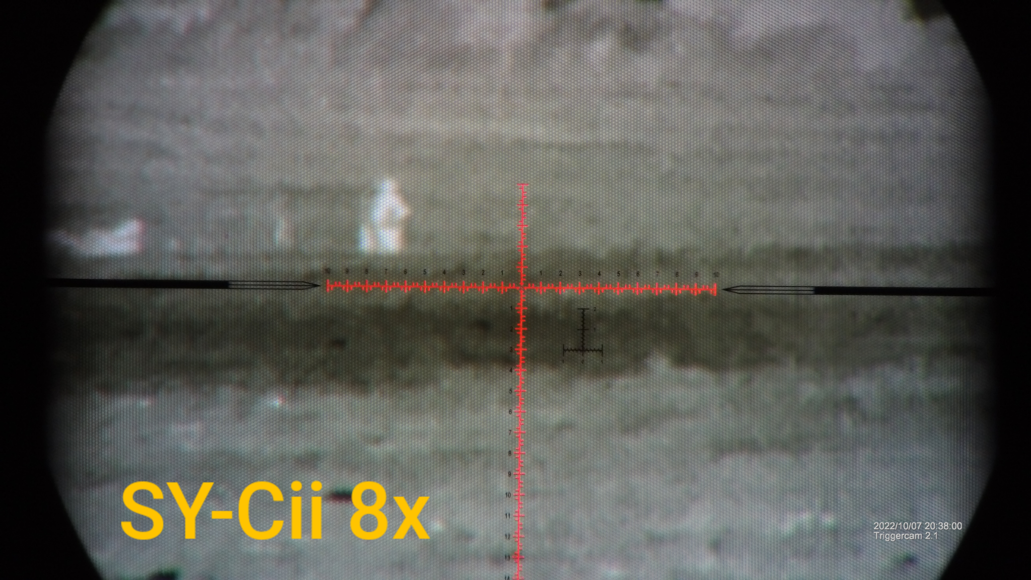

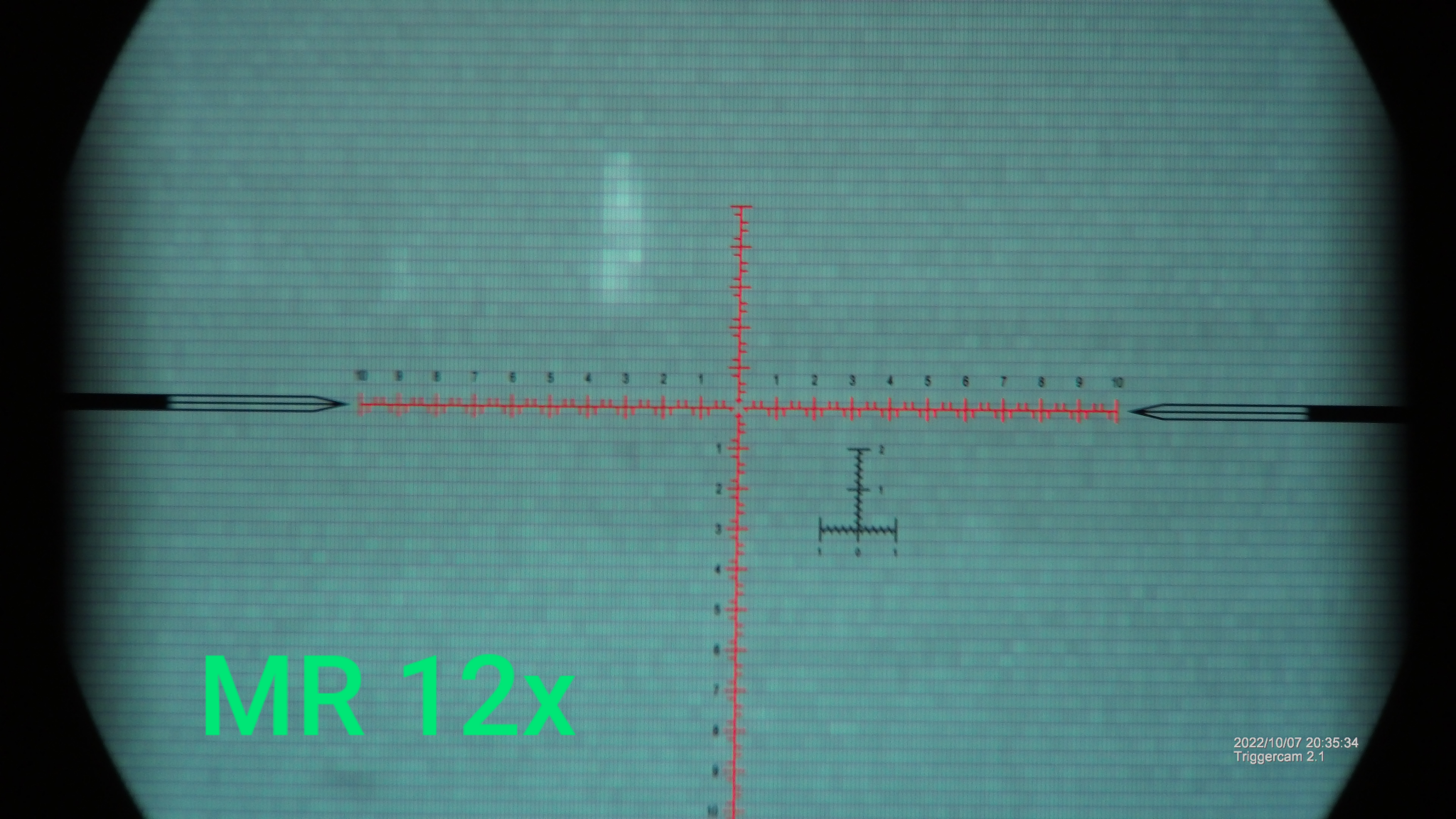

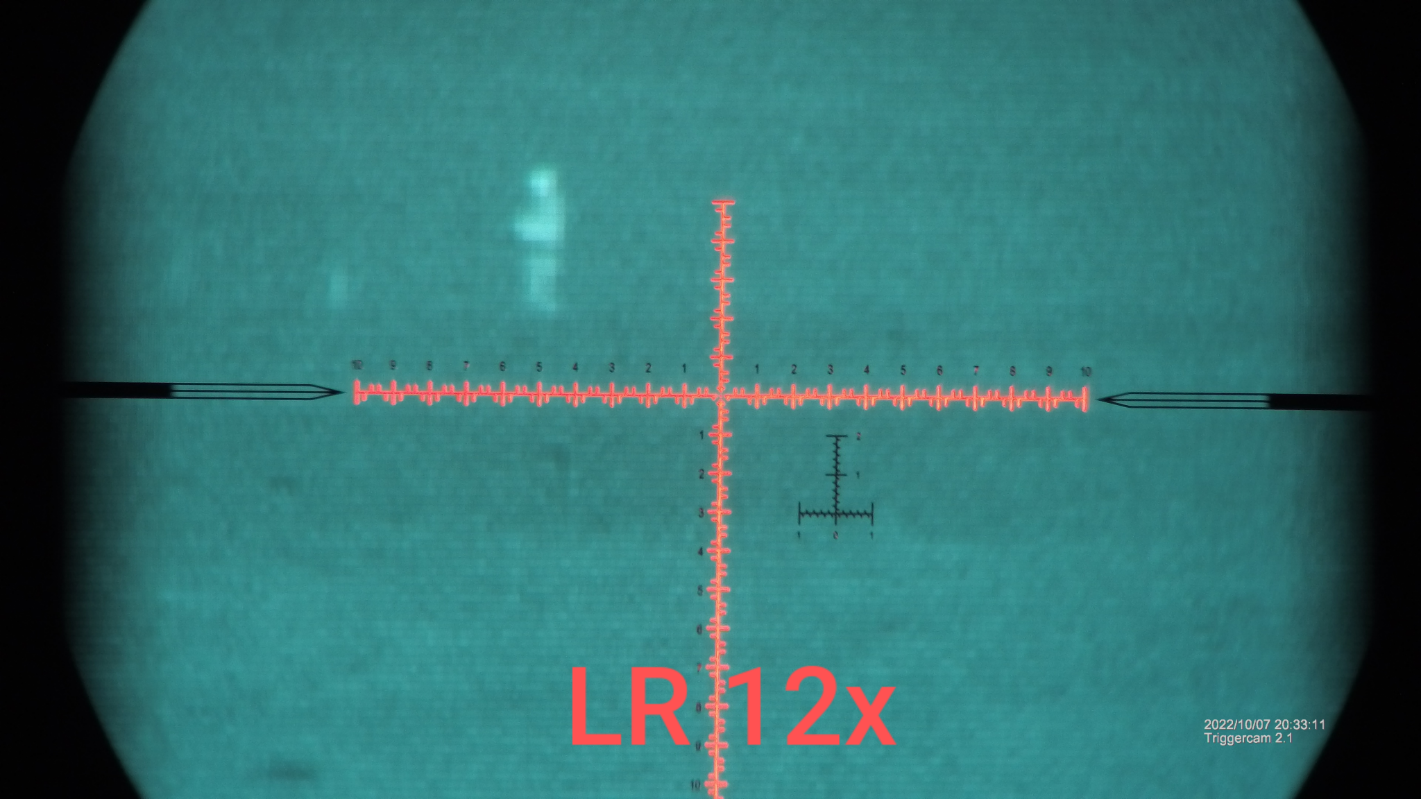

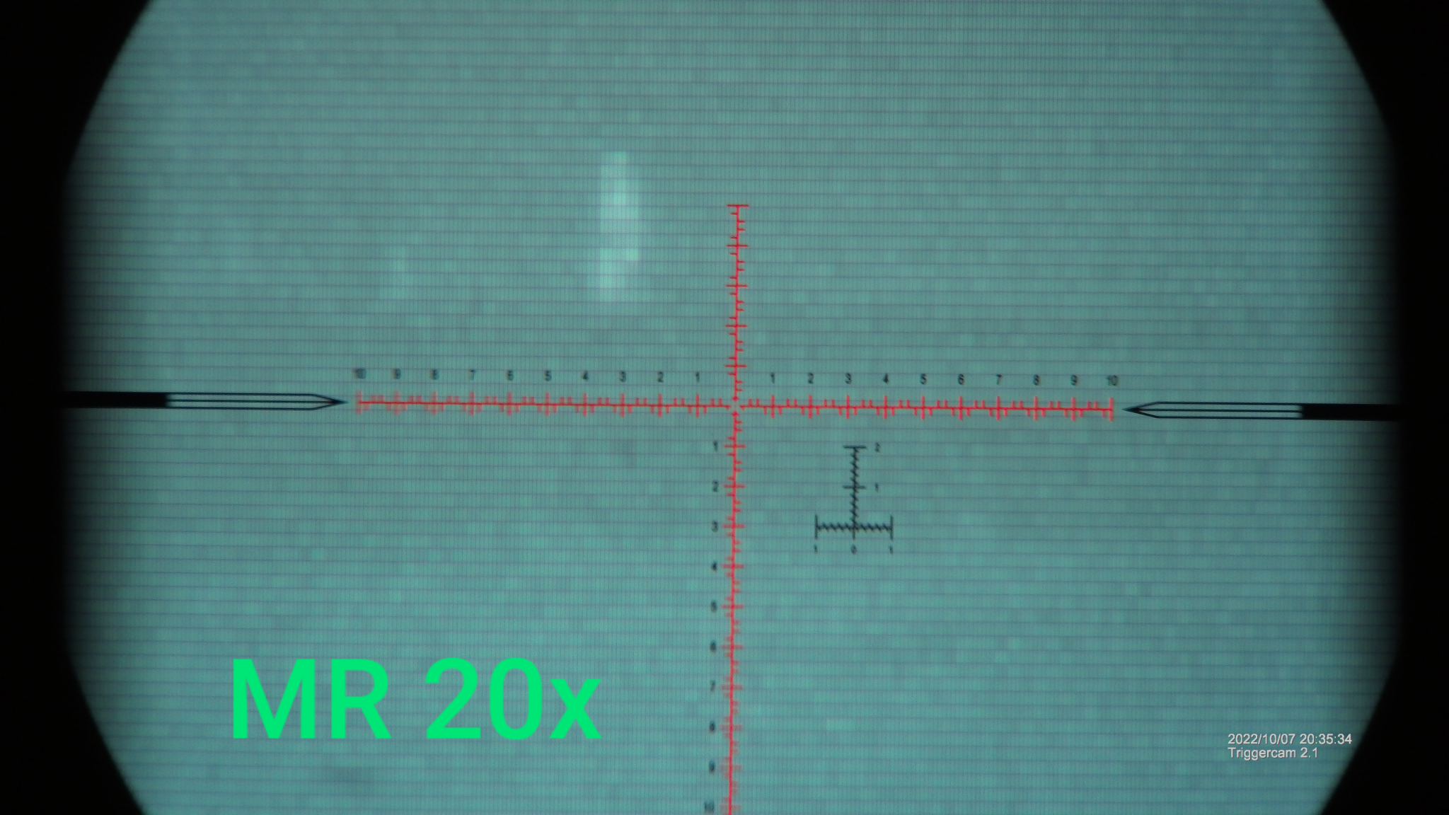

Recapping some notes from a few different conversations... for your reading pleasure.

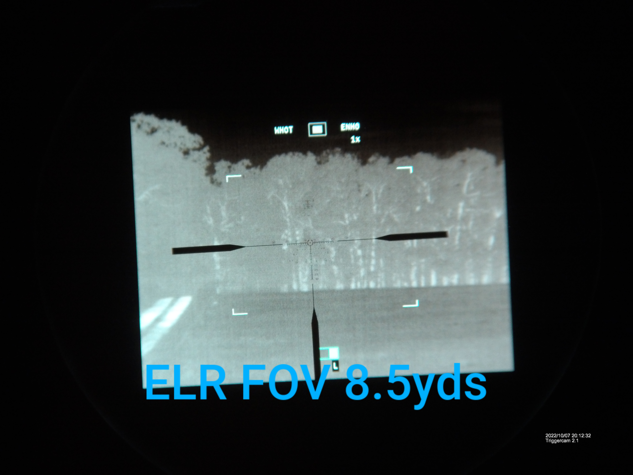

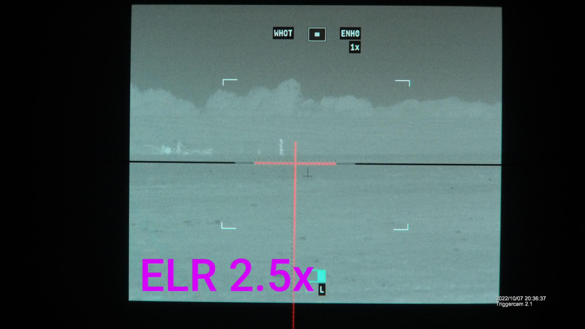

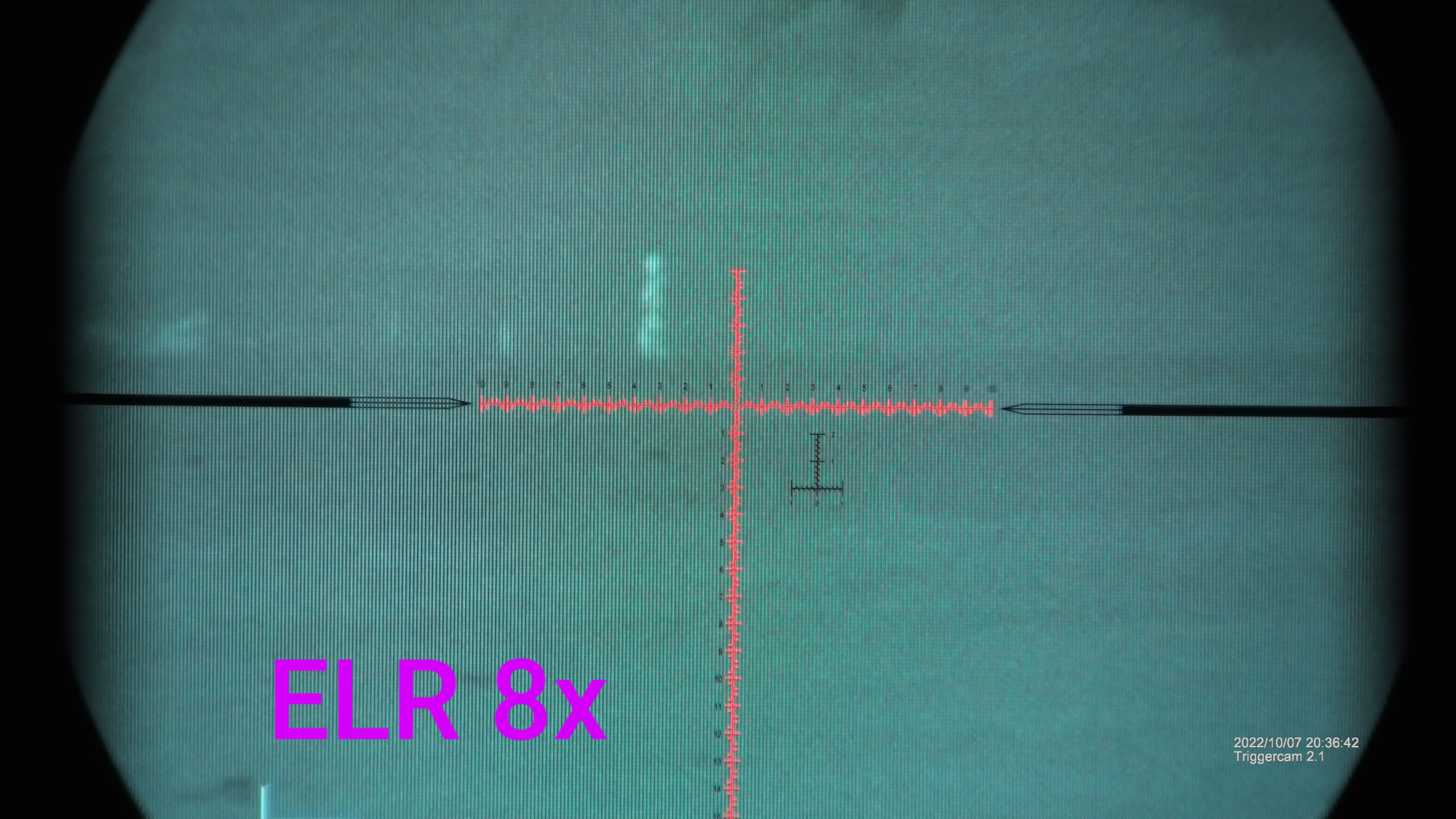

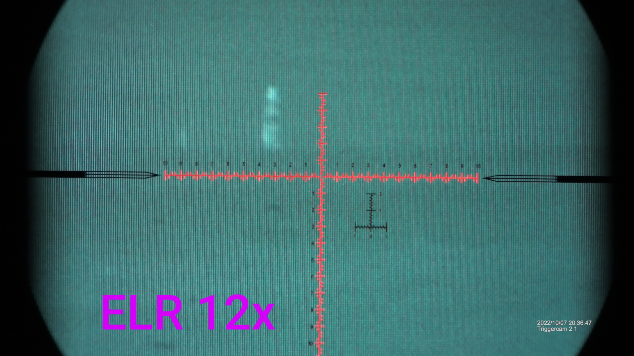

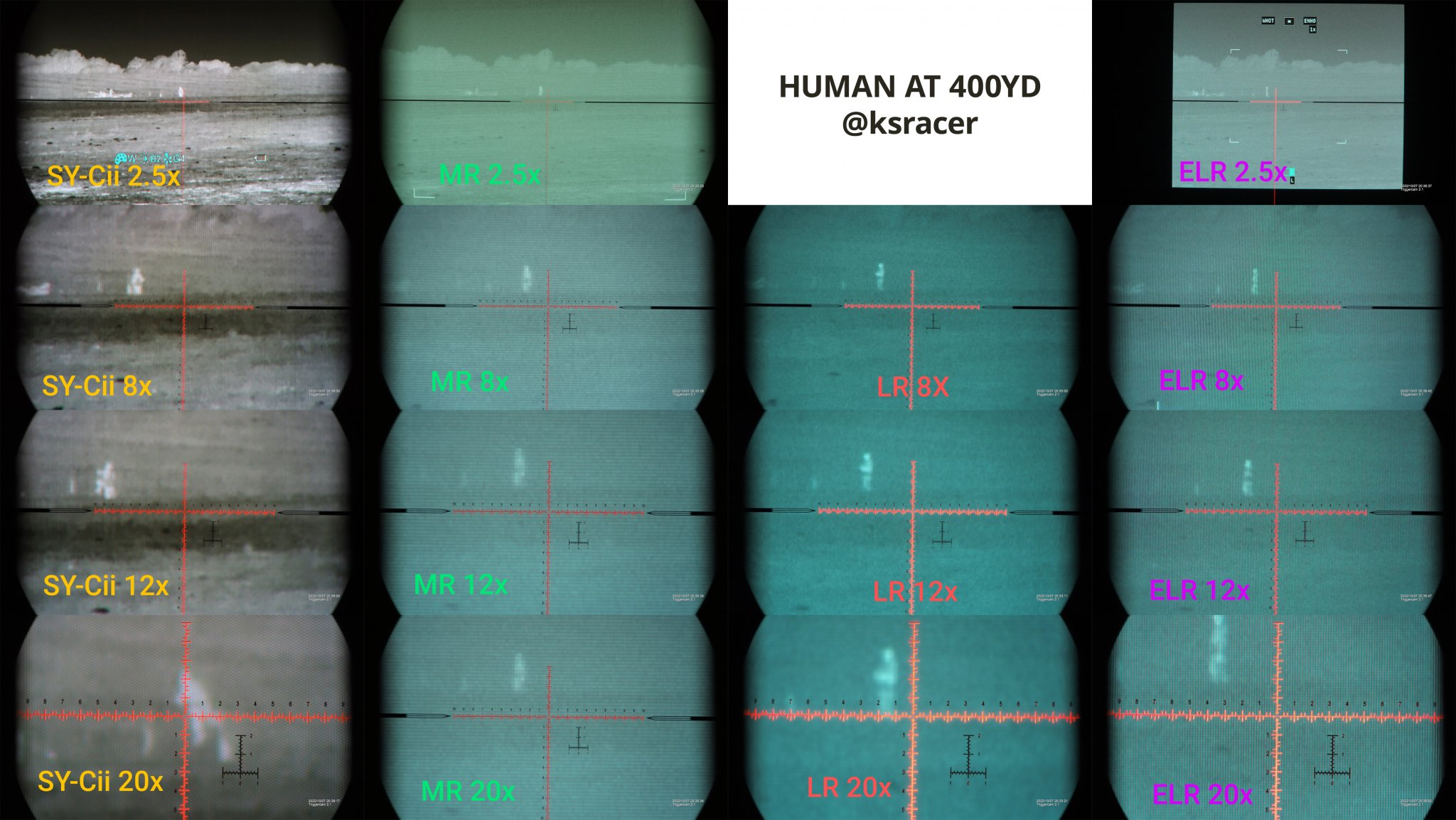

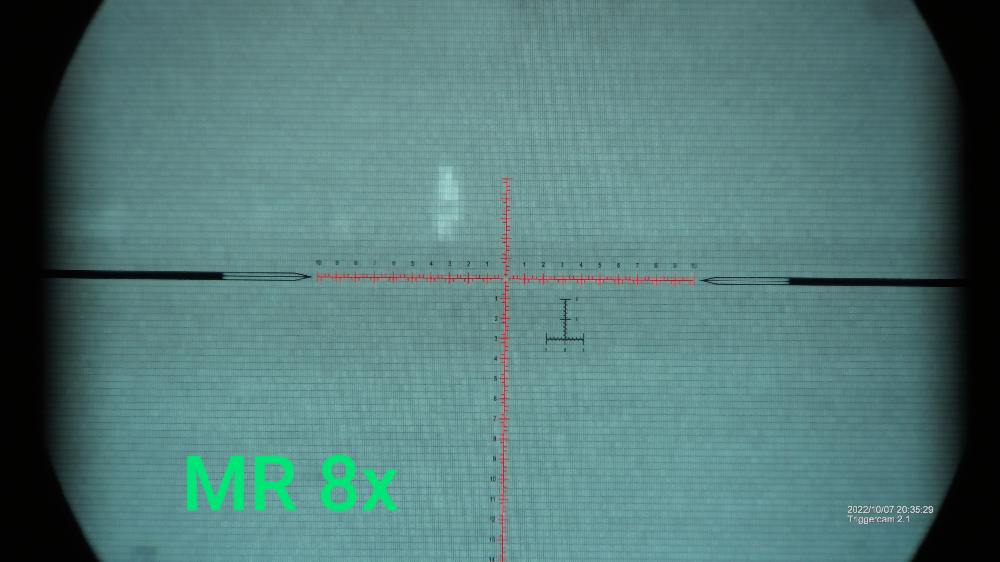

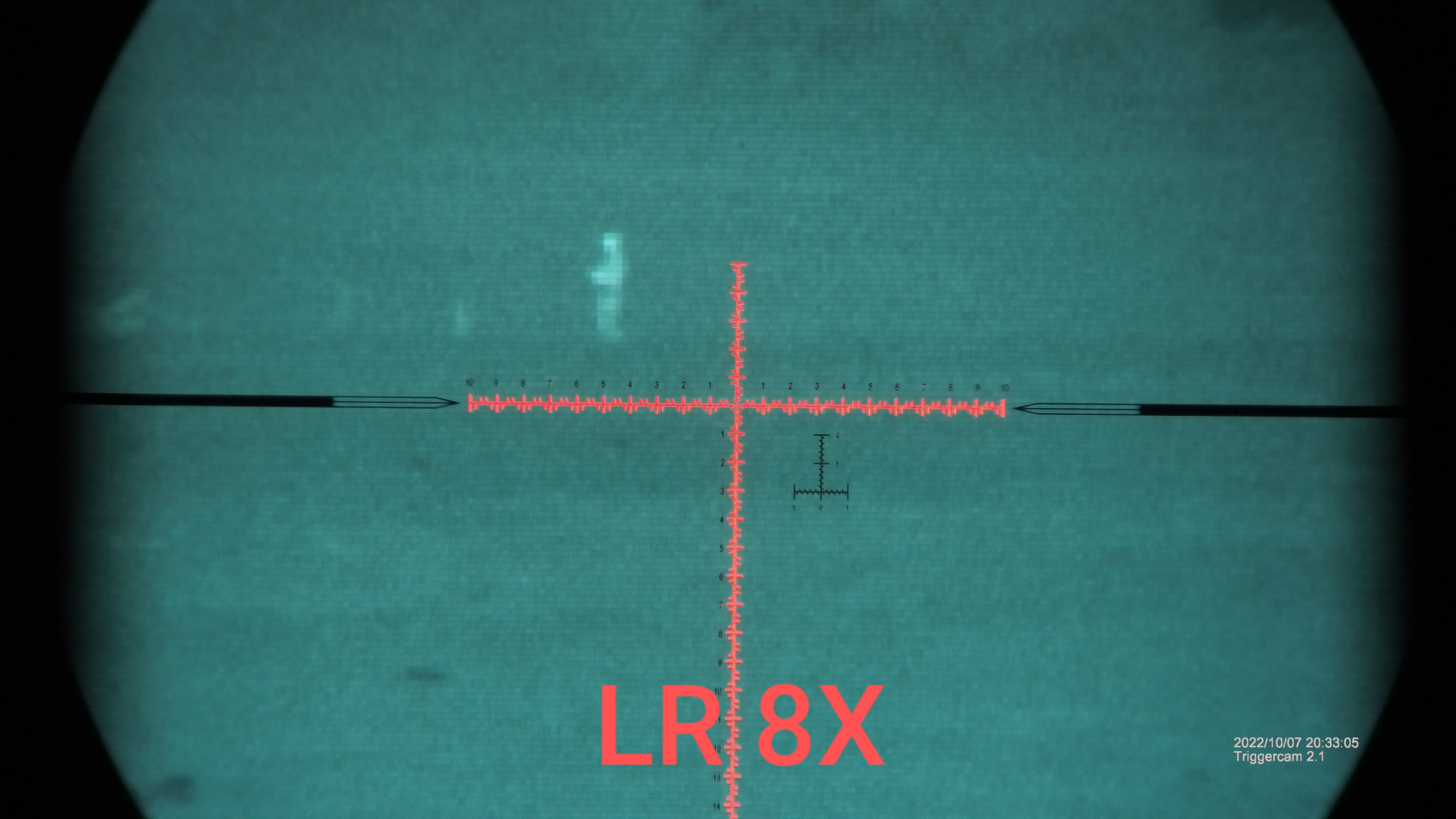

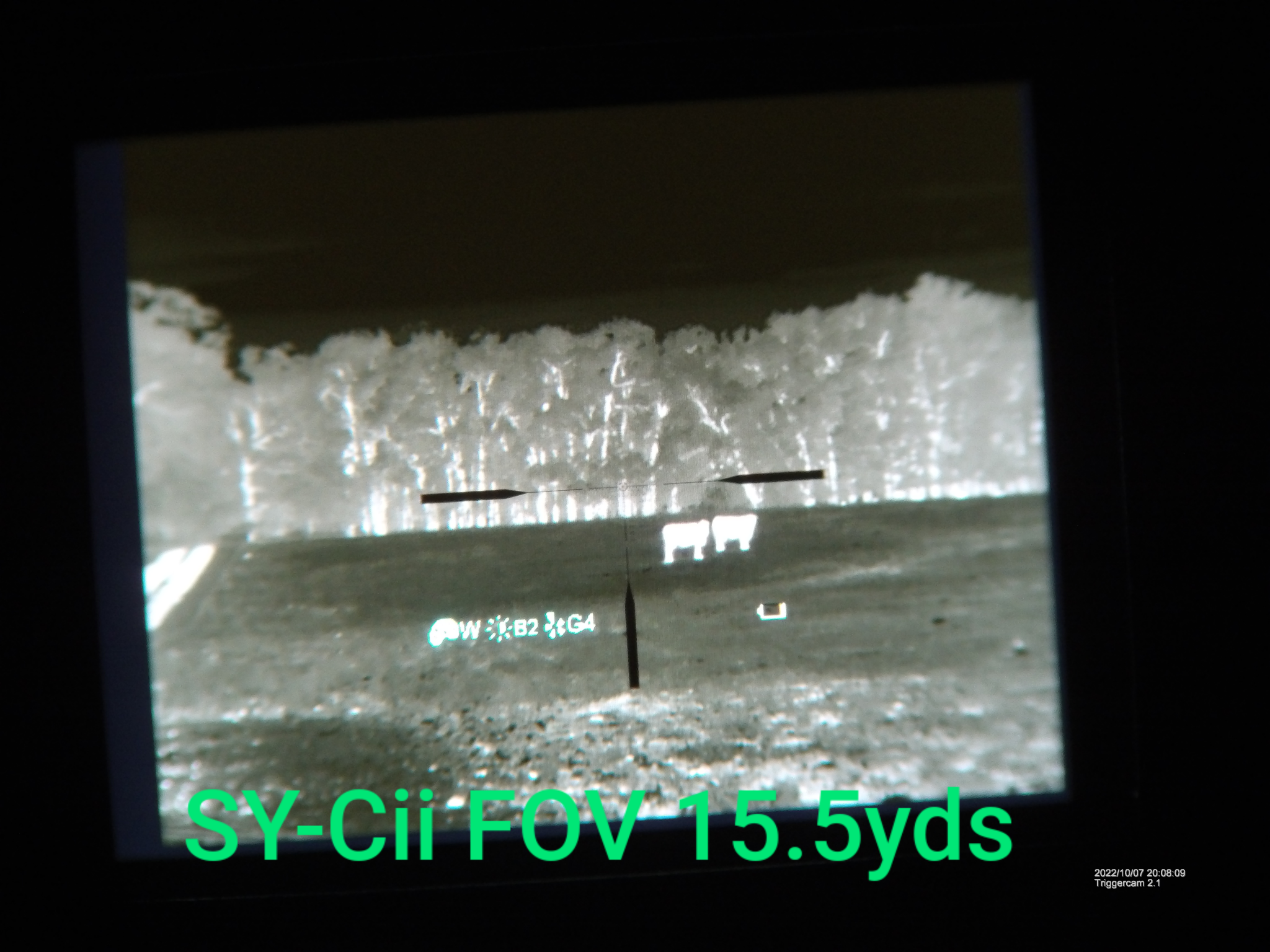

The ClipIR (some calling MR) is extremely impressive with it's wide FOV and capability to pivot from 1-10x. Definitely fully utilized by an LPVO. The fixed parallax is about perfect paired with an LPVO too.

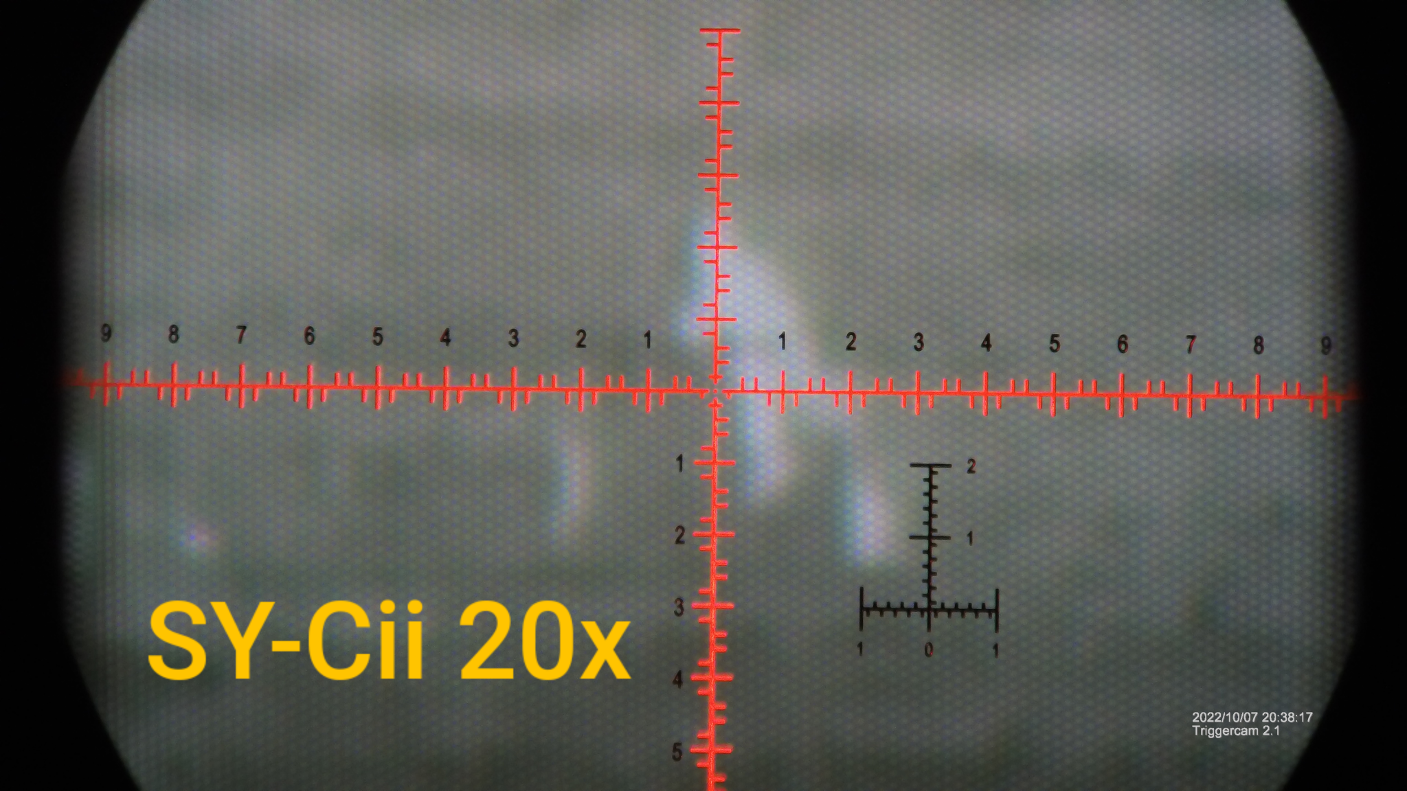

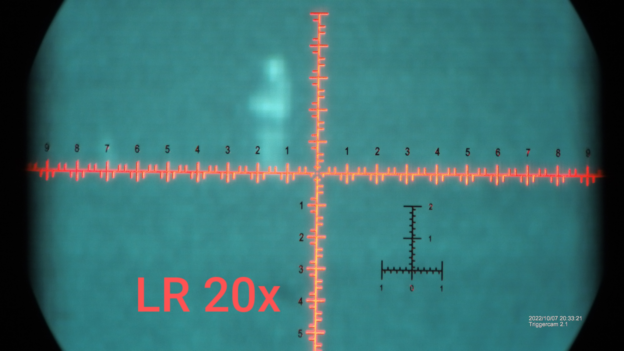

The ClipIR-LR (some calling LR) is equally impressive, with 2-12x or 2-14x being the sweet spot. You do get a little better PID capability out of the LR. Parallax is far closer to infinity, but not quite infinity. @Evolution 9 's photo is evident of what you can do with magnification at 16x, and like him, I also use higher mag for certain use cases, and it certainly works!

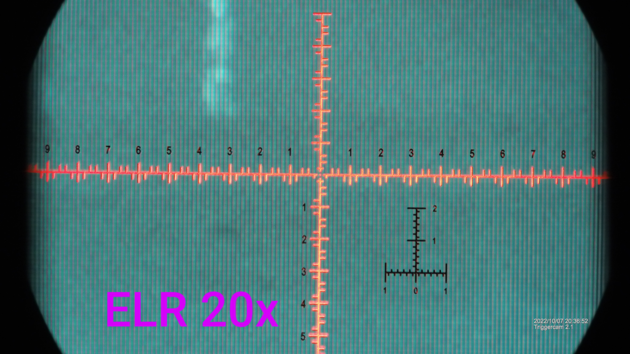

I grouped both the MR and the LR to check collimation. Essentially I was shooting between pixels with the MR and got a slightly larger group, but with the LR I had a more refined aim-point and managed day-optic like groups with a bolt gun. POA/POI shift was measured at .1-.2 mil radian of offset. For comparison's sake, my UTCxii also measures between .1-.2 mil radian of offset.
For those wondering, the ClipIR-XELR (some calling it XELR or XLR or ELR) has a tighter FOV and even better PID capability than the LR. I have not checked POA/POI offset, but will. The optical range sweet spot I estimate (it's been 4 months since I played with this unit so going off memory) at 3-18x or 4-18x. You can squeeze up even higher, and we did, but you lose more hold over capability with each increase in optical mag.

Used .22LR with eley 40gr HP subs, AAC mini suppressor, VO pst g2 1-6x (a perfect scope for this application). Most of the night kills have been with the apollo42, but the last 4 were with the theon MR. Oh and that's a surefire IVL2-IR on 9 o'clock. Its a perfect combo laser for this application also. I actually have it on vis (green) laser with white light setting (it also has ir laser and LED ir illum). Haven't used it for any critter shots yet, but have used it to find the kills.
The coons
The armadillo and the skunk

I had my 556(14.5) upper with an atacr 1-8x DMX so they could try to "see the weapon" also.

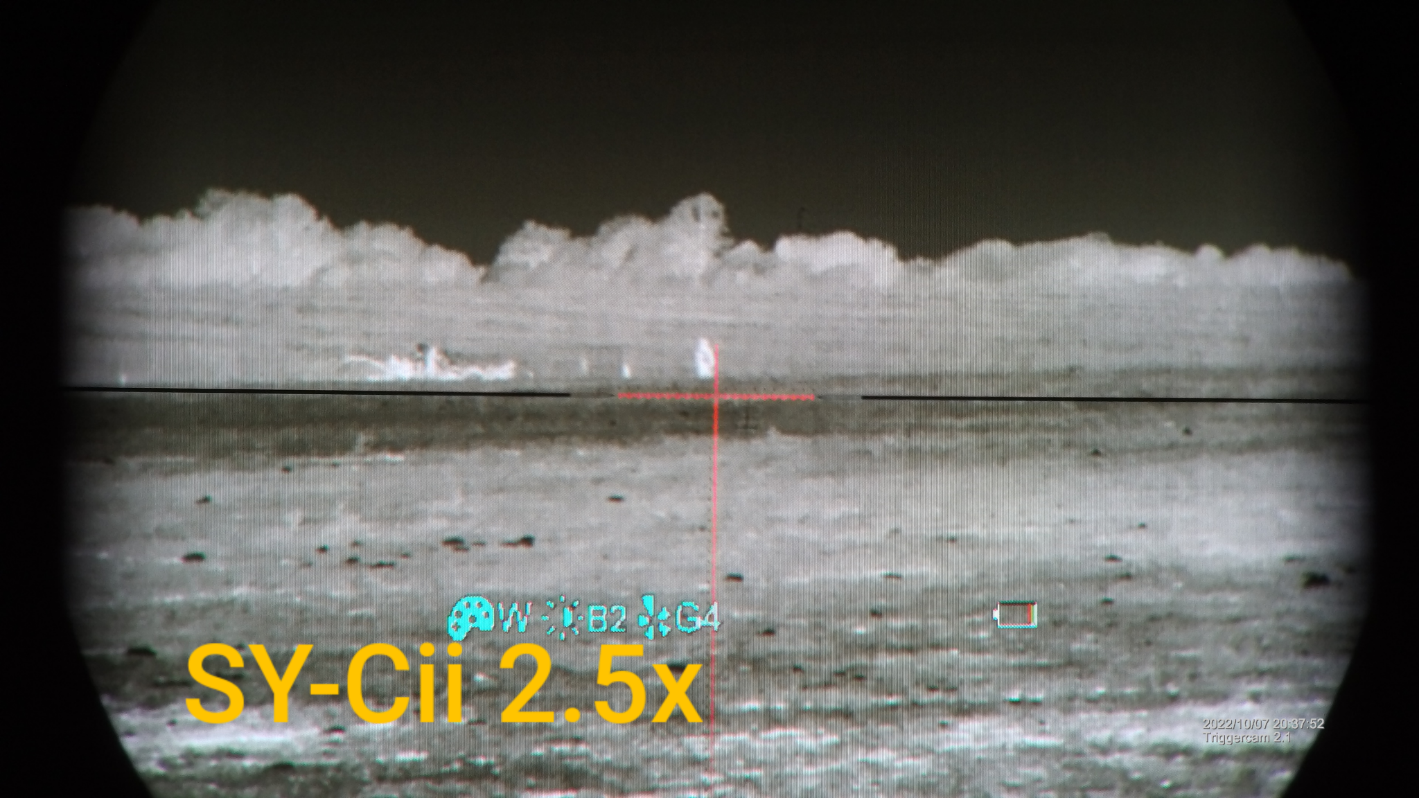

First, I want to than Wig and Cantankerous for the amazing opportunity. Trying to look through so much equipment in a short time was a little bit hectic, but I had a blast!
I used my Triggercam to take some pics for the sake of simplicity, vs trying to focus a camera behind a scope for each shot. They aren't as good as some others, but they are a fair comparison between each unit.
I tried to focus on getting some pics with the Theon MR, LR, ELR, and the second generation Bering Optics Super Yoter Clip On at multiple ranges and magnifications.
My goal when I purchased the ELR was long range coyote hunting. Towards the end of the night 3 dogs showed up at 618 yds. The image from the Theon was more than adequate to make that shot. I'm going to estimate that the only thing holding a person back out to 800yds on coyotes would be shooter ability. Unfortunately, we had made all the rifles "safe" before climbing the platform, so I wasn't able to take a shot.
I fully agree with WIG that if you live in a wooded area, the LR would be a better choice. Several people went back and forth between the ELR and the SY-Cii and the general response was "Oh Wow, that's not bad at all" in regards to the Yoter's image.
I've got a bunch of pics I need to sort through, but I'll start with the ones depicting the FOV of each unit. You can see the size of the reticle and count tree tops in the background for a reference. I turned the magnification on the day scope up enough to fill the screen for each one.
It was a great night!
We had so much going on it was hard to keep up with swapping devices and getting pictures.
I used a digital camera as(compared to a cell phone) it was a lot easier to get an image behind the scope , and now I'm having trouble getting my computer to read the camera card so you may have to wait for pictures, I hope to have them up in the next day or two.
For me the really interesting part of the night was comparing the ELR to a PVS-27 for detection and ability to ID at different ranges.
Wig volunteered to walk down range holding an AR upper so we could view him at different ranges. This was to let us see how far out someone could ID a "weapon".
Our bolt guns had the bolts removed and the ARs used for viewing were uppers only, so all weapons were rendered incapable of firing.
Using the ELR, I was able to identify the upper in Wig's hand out to approx 300 yards. after that the aluminum was too close to ambient temperature to stand out. Using Wig's PVS-27 I was able to ID a "weapon" out to 600.
I was able to find and PID Wig (standing) as a man in the open field with the PVS-27 thanks to a full moon and Wig's Airforce issue sweater which reflected pretty well. He was also wearing Multicam pants, which were much more difficult to see at distance. The Multicam was slightly darker than the surrounding grass, so if I looked closely I could make out Wig's legs.
At 900 yards Wig went into a prone position and he completely vanished from the PVS-27.
If Wig had been dressed completely in the Multicam I would have had a much more difficult time detecting him with the PVS27.
As you probably suspect, Wig was not only easy to find at every distance with the ELR, he was also immediately identifiable as a man as far out as he was able walk as long as he was standing or even in a high crawl position.
When Wig went prone he still stood out but he was impossible to ID.

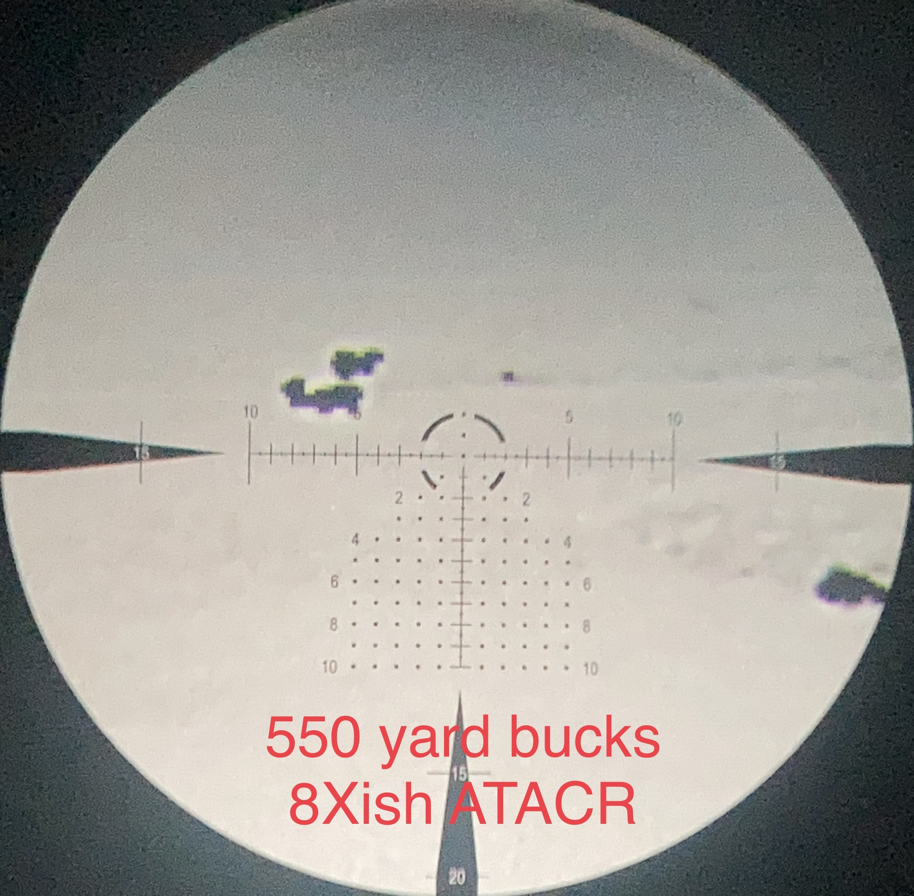

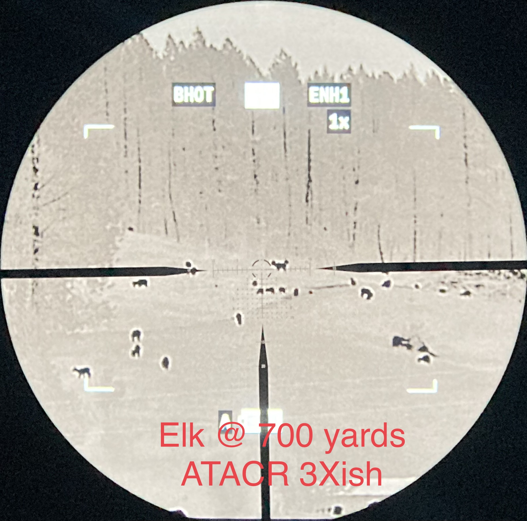

Pictures inbound. I will apologize because these are not jaw dropping impressive. They aren't meant to be... Any thermal pic looks good from 37yds away, but I wanted to push the limits. I'm not sure what the "test subject", AKA Wig, was wearing, but it did a good job of masking his heat signature, plus it felt like there was a little humidity blowing through. He was around 400yds if I remember right.
The 20x pics through the LR and ELR look similar, but you can see more shading with the ELR.
It looks like the sensitivity of the SYCii really helps with detail in front of the target?
Yes, there was a period of time where I did think the SY-Cii was picking up more detail. It was after the wind switched and it felt like a little humidity was in the air.
Keep in mind that all of the Eotechs were in base mode with default brightness and contrast settings. The Yoter only offers a brightness adjustment and one other mode.
On my previous range trip, the ELR was picking up unheated steel at 4 and 700yds the the Yoter didn't.
Reactions: rlsmith1

I think this one is the MR in front of the 1-8, on probably 1.5x on the day scope. The cattle are 400-500 ish.
And I think this is the LR on the 108 and 8x on the scope, same cattle, same distaces, those structures are at 1k-ish in distance.
And BTW, I was real careful with the focus on each clipon. Nucing a bunch, setting day scope magnification to max and bracketing the cattle with the focus ring, and continuing to reduce the size of the focus bracket until I had it right in the center of the bracket. Used that same slow, careful, process with every thermal clipon. No quick "ball park" focusing tonight ... and all the thermal clipons looked GREAT !!!

It was a good night for thermals here also. There were a bunch of skunks out back and I was able to quickly PID them with the ELR out to 400+yds. I killed several in the 200yd range and missed one at 370yds. I find myself going back to the default brightness and contrast settings everytime I mess with them. I like this scope more everytime I use it!

Well I think I'm going bananas over here. I finally got a NX8 1-8x DMX I ordered back in April. And I put it on 556(10.3) carbine. Does that make any sense ? Prior to that both of the mk18-ishes had EOTECHs and 3x on risers. Now I've put a LPVO on this one !!
Here in the Ozarks, in the Forest, shots over 200yds are rare. Hecque, actually in the woods, shots over 100yds in the winter are rare, shots over 50yds in the summer are rare.
But, I think with this scope on there, I might be able to hit MOM targets out as far as 500yds which the farthest I've ever seen a shot around here is 488yds.
I still love the DMX reticle, the center dot, even though illuminated, is hard to see in the pic ( I had it turned down low ) ... but I could see it fine for aiming. The 2/3 IPSC steel is at 156yds.
THEN I tried putting the ELR on there, another crazy stunt. And it fit ! A real day scope and a long distance thermal clipon - on a 556(10.3) I've never thunk of such a thing before !
Later that night I finally shot it and it worked ! The carbine was a little tight on the RRS and bound a bit when I tried to pan about, but I worked around that. But a little gun can pretend to be a big gun if you work on it hard enuff ! :)
I had a ATACR 1-8 on a 11.5 for a while. Similar situation on terrain and average shooting distances. I ultimately went back to a Eotech on the 11.5. I will eventually pair it with a G45 magnifier. I always thought the magnification never hurt, but the ATACR made the 11.5 feel very top heavy and lost its advantage of being nimble/light.
However, the setup is legit lol
Reactions: wigwamitus
Went on a pig hunting venture in the big TX here about a week ago. The weather was dogshit, but all of my kit performed quite well. Smacked a decent amount of hogs and got kills with both the Voodoo S and Voodoo M. Both units performed flawlessly in some really crappy conditions.
