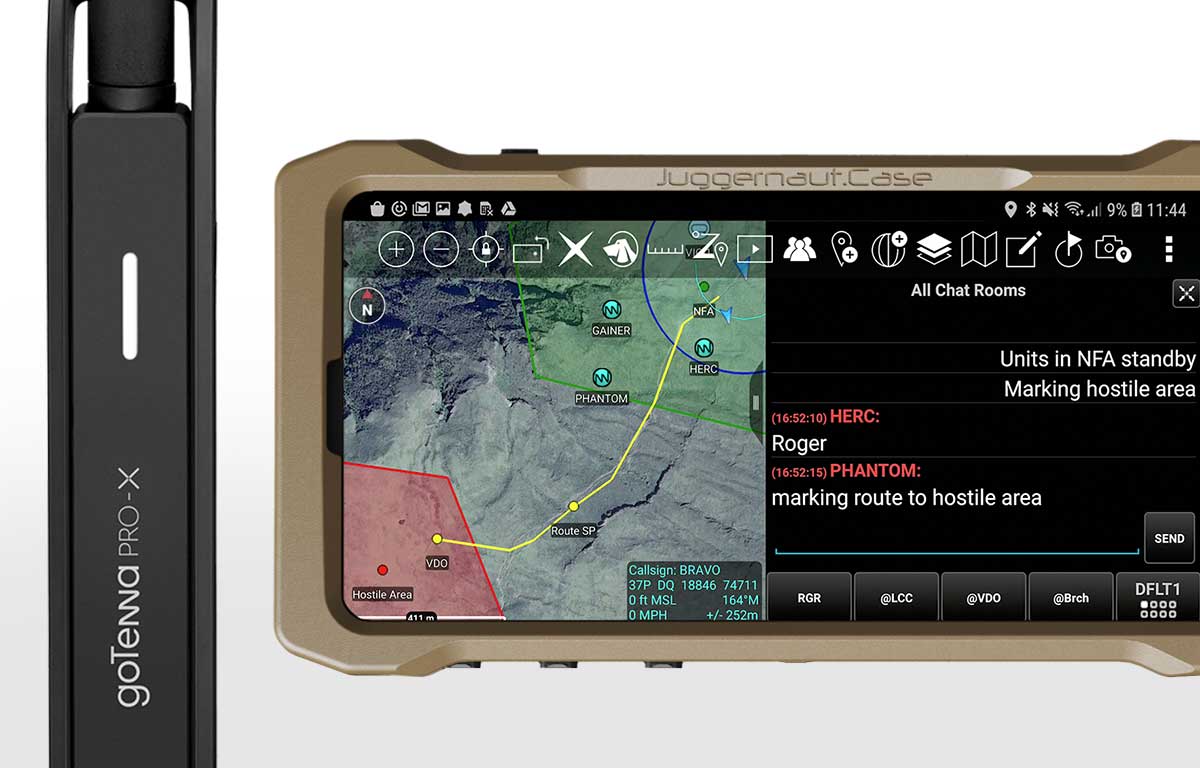

    I've used the .mil ATAK before and I know its evolved since then. An ECOTI wasn't a thing yet and I'm betting the capabilities and compatible equipment list within the system has grown as well. A civ version of ATAK (probably to data mine you and/or keep track of people who think you can use this during some kind of insurgency fantasy) has been available for a while now. However, their site as well as the subreddits dedicated to it give you next to zero actual information as far as what works and what doesnt and outside of people needing troubleshooting or nerds nerding out over some sort of specs or whatever, thats about it.
    If you're not familiar with ATAK, its basically a newer version of what the DAGR used to be, and can now be run on a cell phone. It allows you to mark waypoints in real time on the phone using a terrain overlay (think interactive google maps) that everyone else on your network can see and also interact with. You can enter info on the targets and waypoints as well as they can be made via other equipment like the PLRF25. A basic example of this would be that you see 3 guys with weapons walking across a hillside. You hit them with the PLRF25 and it'll update into ATAK that there is something there; youd then label it '3 armed personnel, unknown, heading 246 at 1723. Everyone on that net now sees that waypoint on their unit as well as the info.
    The other cool thing is anyone linked to the network shows up on ATAK so you know where all of your elements currently are. Even if you are out of cellular range, the GoTenna it works with will continue to receive/transmit via (I think) satellite and will continue to receive and broadcast.
    Some of the equipment that works with it are rangefiders, the MBITR radio where the phone will work as a KDU and allow you to manipulate your radio without having to take it out of its pouch and the ECOTI, which from my understanding, if attached, will then give you a real time HUD of the waypoints and where your elements are. It's basically like a fucking round of Battlefield 4 with a HUD and waypoints you see as you move your head towards them.
    Basic equipment list for the 'system' would be:
    - Galaxy S20 phone 'tactical' version (which they wont sell you because it has the .mil ATAK version on it but you can get the regular S20)
    - ATAK software app (civ version available)
    - GoTenna Pro (available)
    - MBITR (can't get this, however there are civ versions now that are broadband, 15w, near indestructible, and work with all Harris/Thales PTT, Harris batteries and even now work with the old school KDU module)
    - ECOTI (available after we were all told it never would be)
    The ideal setup would be to have the civ ATAK on the phone. Have the GoTenna linked to the phone. Then via cable have the phone linked to both the ECOTI and the MBITR which in itself I am not sure if its possible as I do not believe the phone has 2 ports, but could be wrong.
    The main question here is - do any of you have experience using the civ version, and what is it capable of, and what are its shortcomings/where is it bottlenecked?
    And then a few other random questions:
    - How does the ECOTI attach to I am assuming the phone? Cable?
    - Can you attach the MBITR and ECOTI simultaneously?
    - Does the phone still/capable of working as a KDU?

    GoTenna is basically a LoRa+GPS module. Phone connects to it via Bluetooth, a LoRa mesh is created between the GoTenna's.
    LoRa is capable of long range but is low bandwidth, only small amounts of data can be sent. Since this is not a HAM or similar public voice frequency (FRS, GMRS) encryption is not prohibited.
    What you are paying them for is their software and development and an app that is "done" which is pretty much where the time suck is on any open source project.

    Positions, points, routes and chat, each one of the GoTenna radio products has a specific plugin.
    All that you mention does work over a radio as well. IIRC there is a video or two showing it done with LoRa modules as well.

    Been playing with ATAK-CIV again since this thread.
    A few tips:
    If having trouble, DISABLE any plugins, especially HAMMER. The way it overwrites the display causes many issues, in particular with the Import Manager. Once are done importing then you can turn them back on.
    I also suggest DISABLING auto-update for ATAK and all plugins. Once you get it working an update is guaranteed to break your setup as the plugin updates/re-signing always lag a week or more behind.
    You will find a ton of rather large zipped DTED files (elevation data), NONE of them are actually formatted in a way that you can use. You need to create folders for the particular "easting" or "westing" EX: w125 then place the renamed tiles in each folder, then rebuild the zip file to import.
    This tool will aid greatly in renaming a ton of files based on patterns, RTFM on using it:
    Also Android can have some very odd permissions issues, you may need to first copy zip files into the same folder you are trying to import the contents into.
    Map and elevation data can be HUGE. You will not get the entire world at high resolution stored locally on your phone/tablet for offline use.
    You can get an acceptable and usable view though and super high detail for your particular state or AO. You will likely need to add a microSD card to get the most out of it, they are cheap now. Look up the specs of what your device can accept, not everything will accept a 512 GB card (64-128 GB is common for devices the past 3+ years).
    The experience with ATAK is like with any open source product; frustration and shit documentation. That being said if you can power through it there is some very cool and powerful functionality.

    K have the Gotenna and plugins. Have the android phone with ATAK.
    What are the best maps for overlays to DL?
    And then how do the servers actually work? I see people talking about apps for private servers and then people saying you can make your own server via ATAK directly. Haven't tried yet.
    The jump start guide on reddit has some good starter map sources and elevation data:
    Google, bing and ESRI clarity are 3 you absolutely want to look at.
    The servers allow uploading and sharing of more info (packages, mission files etc.) but obviously require access to the internet or a server running on your off grid mesh.
    Options for off grid use:
    FreeTAKServer has an android distro but the documentation for it is scattered, contradictory and incomplete. I've been unsuccessful in getting the UI portion of it to install (needed for configuration of the server proper).
    Getting it to run on a Pi 4 with either PiOS or Ubuntu should be less hassle but is another box to power and carry.
    A taky server running on a barebones micro linux device like a Pi is also another possibility:
    https://github.com/tkuester/taky I am going to see if it is lightweight enough to run on a Pi Zero W which is tiny and cheap.
    Lastly is try it first without a server in the basic mesh network mode that it supports natively and via the GoTenna plugin.
    Even over your own home WiFi connection multiple devices running ATAK should be able to see each other and communicate, share routes, waypoints and other basic info.
    If you are trying to communicate to a device that is not on the same physical network and both have internet access, that's where things like ZeroTier vpn come in.
    Read the 4th link in my post above "index - ATAK" it is the jump start guide.
    You don't need to pay for ZeroTier unless trying to connect more than 50 users that the free tier covers. Their software can also be self hosted.
    It is a VPN not an ATAK server, it can be used to connect to a server though.
    The main use of ZeroTier is to create a private mesh network of devices that ARE connected to the internet but are NOT on the same network.
    EX; You have an android device running ATAK with a 4G connection on Verizon. Your buddy in another state has an ATAK device on a 5G connection using T-Mobile. Another buddy has an ATAK device on his home WiFi with AT&T DSL internet.
    A ZeroTier setup would allow all of these devices to directly communicate to each other over their various different ISP's as if they were all on the same local network.
    The other use case for it is all cell phones WITH functioning (internet) data connections in the same physical area, the ZeroTier VPN would allow each of the devices to see each other and communicate via ATAK as if they were on the same physical network.
    If you absolutely MUST have a server in the mix for the added features it requires internet or the server being present on the same local mesh network of your group. A Pi 4 in an enclosure is about the size of a fat deck of cards.
