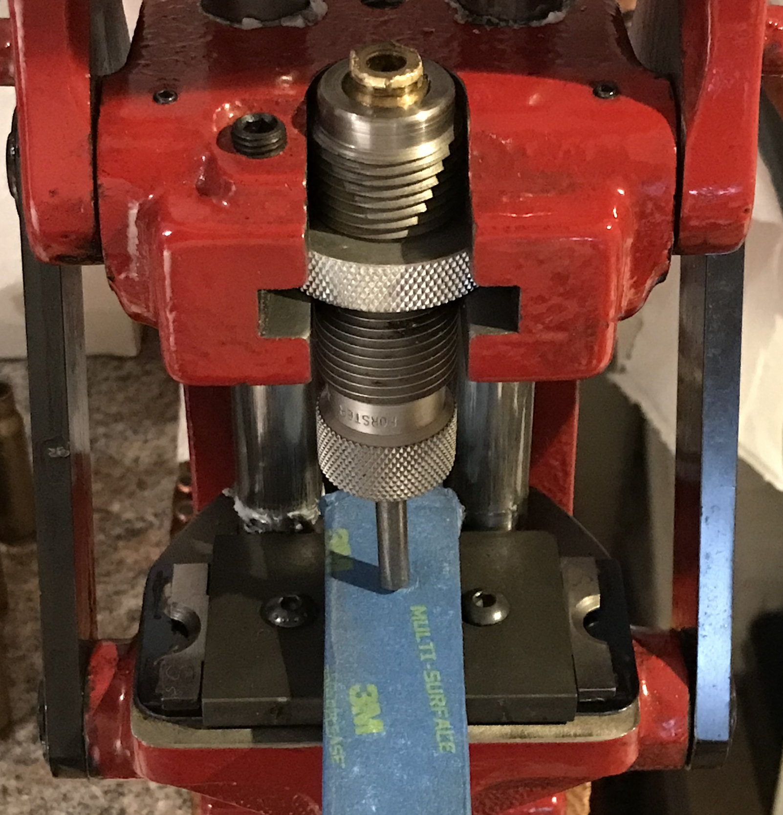

Ugh.
My second instance ever.
I suppose I’ve been lucky, over the tens of thousands that I’ve gone through thus far…

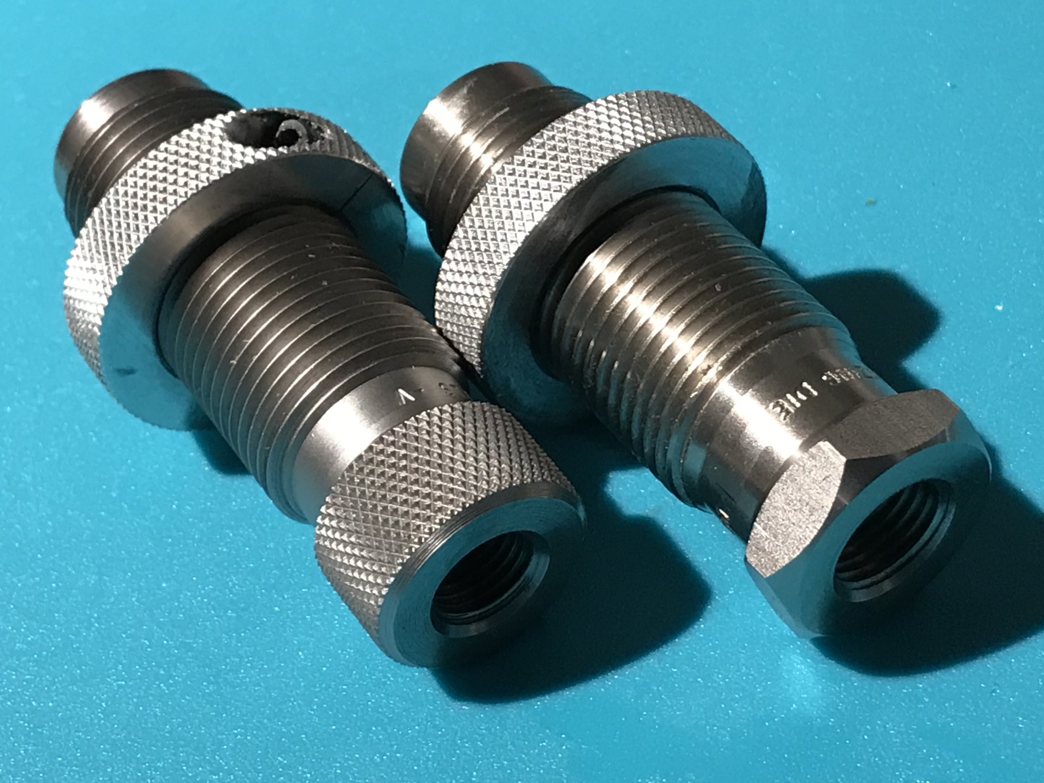

This is a Forster FLS Small Base Die.
I was uniforming some machinegun - fired garbage brass.
The Dillon dies have the wrench flats + stuck case extractor designed into the dies themselves, no extra parts or tools needed.
Now I’ve to wait for that RCBS 9340 Stuck Case Remover to get shipped…
The case rim is gone.
Any alternatives other than waiting at the moment?
EDIT: This happened because I left the case in the die in full compression - did something else for an hour or so - came back to where I left off, and voila! Seized die, wouldn't budge. The wax was probably squeezed out over that one hour.

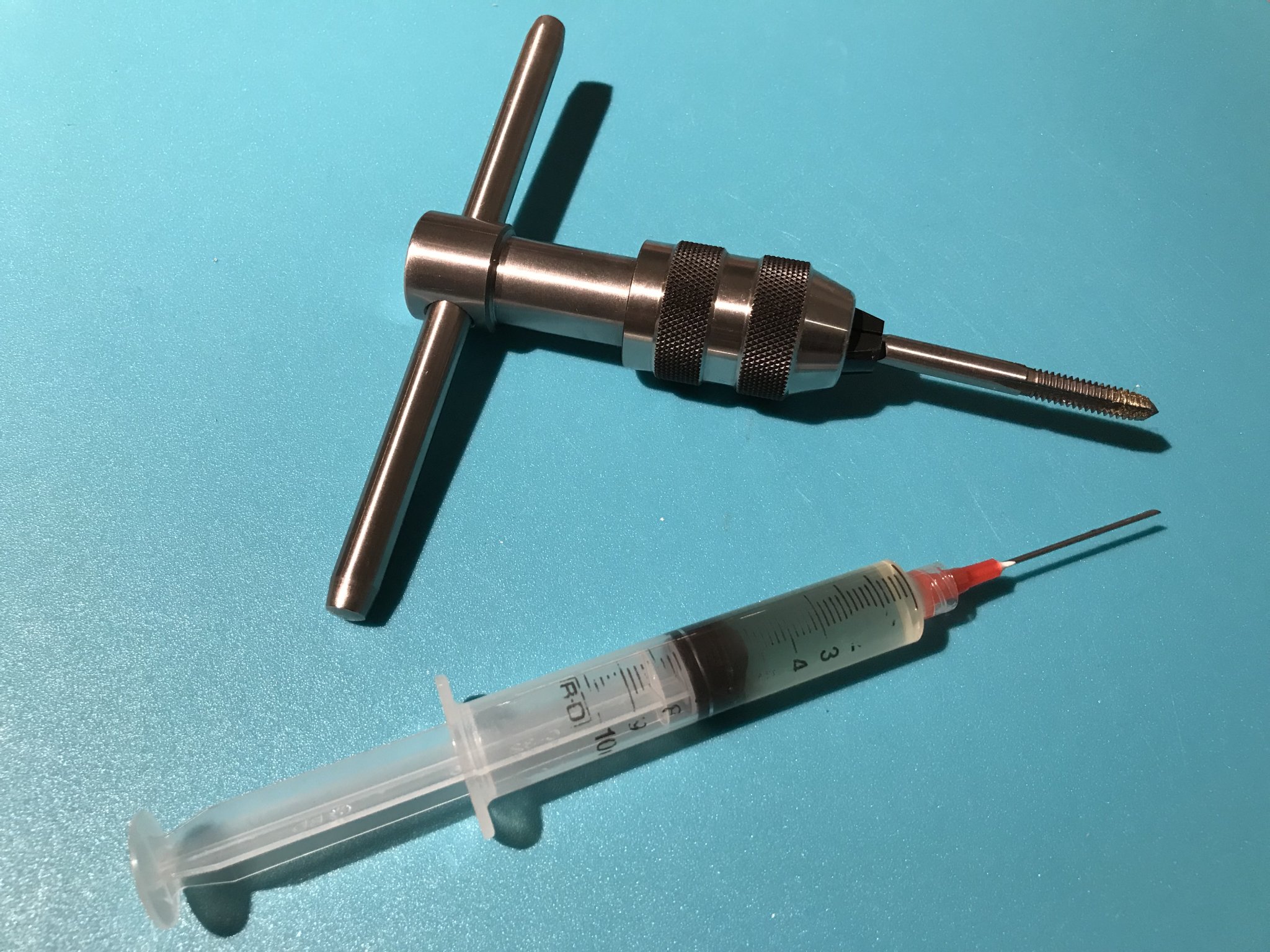

DIY yourself a stuck case remover, if you already have a decent sized tap sitting around? Drill out the primer hole, tap/thread that hole, then use washers and a bolt with a wrench on it to exert tension against the bottom of the die to pull the case out
Saw some YouTube videos approaching it that way…
Unfortunately…
Drill Bits of All Sizes… Check.
Taps… Nope.
Sockets of All Sizes… Check.
Somekinda Standoff… Nope.
Washer… Nope.
Fasteners… Nope.
I suppose I could use a block of wood and a spade bit in lieu of the Socket / Standoff / Washer :ROFLMAO:
The RCBS kit is on its way.
I’ll wait :)
Already practiced drilling out a centered hole using a smaller drill bit.
Best to use a low torque, high speed setting so the bit doesn’t “grab.”
Easy enough, brass yields readily to hardened steel - odds are, I won’t be catastrophically messing this one up :ROFLMAO:

It looks like you have the die guts emptied of it?
Just get a flat end metal rod down the neck and a hammer and smack the shit out of it
If you want to get cute, keyboard cleaner turned upside down so it blast the freezing refrigerant, spray that down the neck in the case in an effort to shrink the brass away from the die body before you smack it

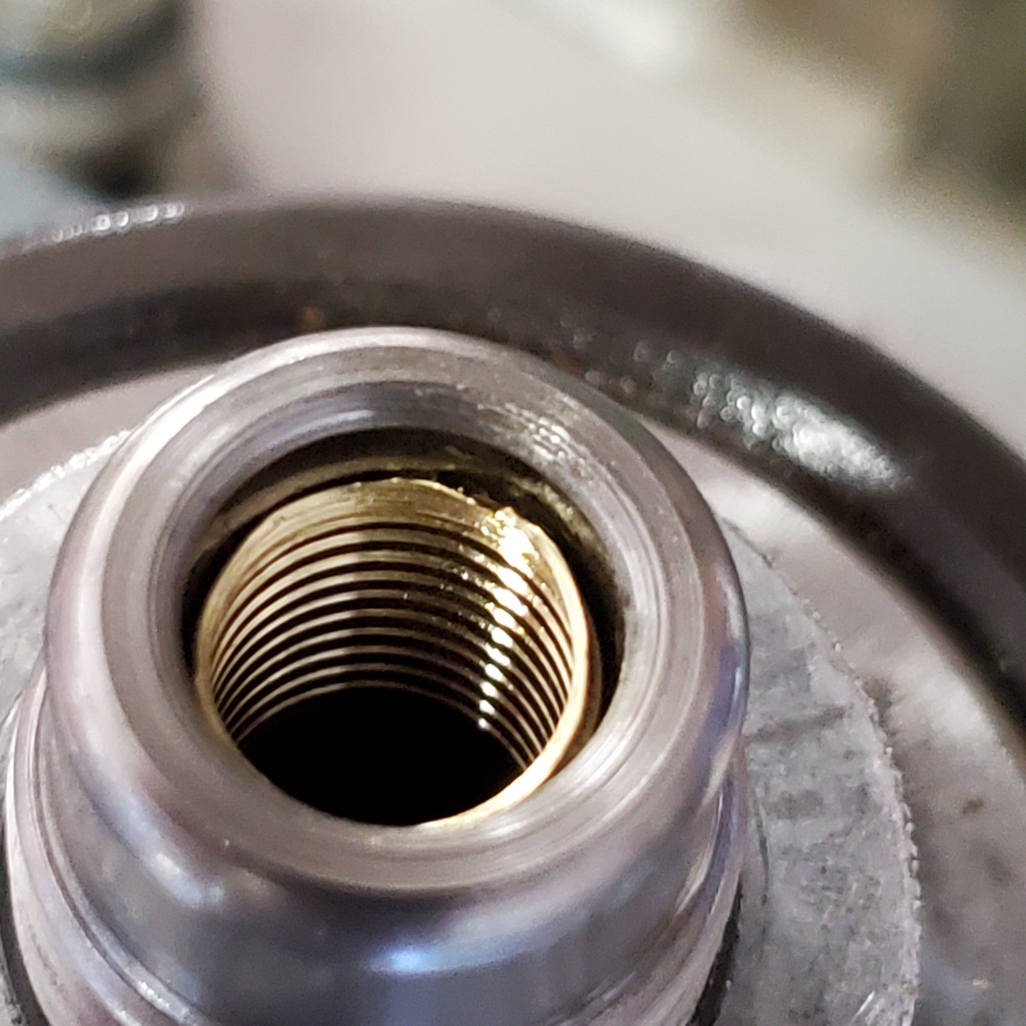

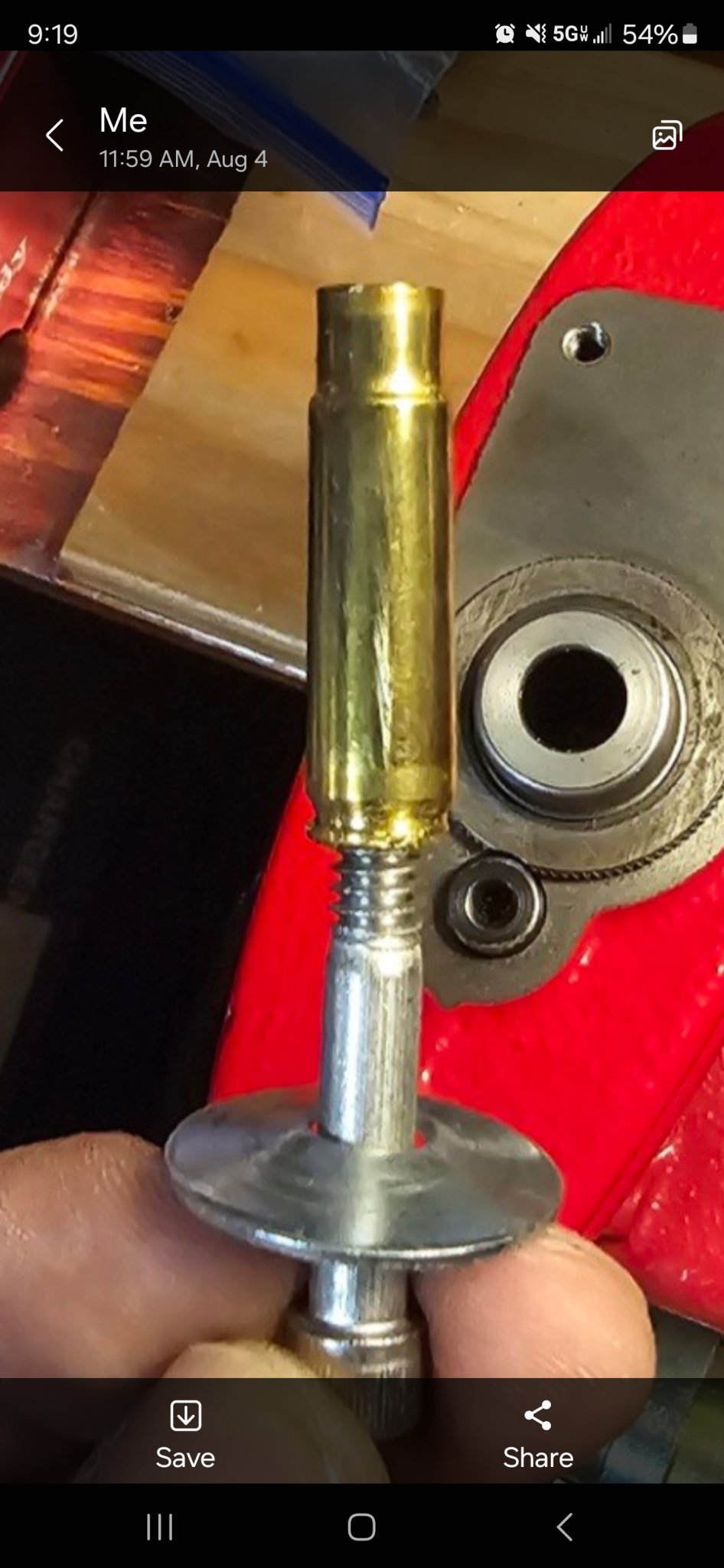

What about hybrid cases? Conventional ways do not work, neither dies the standard RCBS stuck case remover, as the hole left is larger than the 1/4x20 die.
So if That doesn't work with hybrid cases, the SS head breaks off below the die body, as shown. What do ya do?
I use either mill or lathe to center the die and drill the out of round jagged hole round to except a 7/16 × 20 UNF thread, and pull out with a 7/16x 20 bolt over spacers.
As a modified RCBC stuck case remover.
Getting it centered is critical as there is little room for error or the tap could damage the die.

Tried...
It wouldn't budge without excess violence.
Don't want to force it.
Even tried using the press itself, see above - but it seems that there's almost ZERO torque at the beginning of the Forster Co - Ax's downstroke.
Didn't want to fiddle with the lock ring and mess up all those painstakingly set measurements.
Decided to be patient and wait for the tap to come.

I don't see how a Dillon die prevents not using enough lube and sticking a case. I've done it several times, it was always my fault and not the fault of the die.
Who's blaming what?
Total reading comprehension failure with a dash of prejudice :)

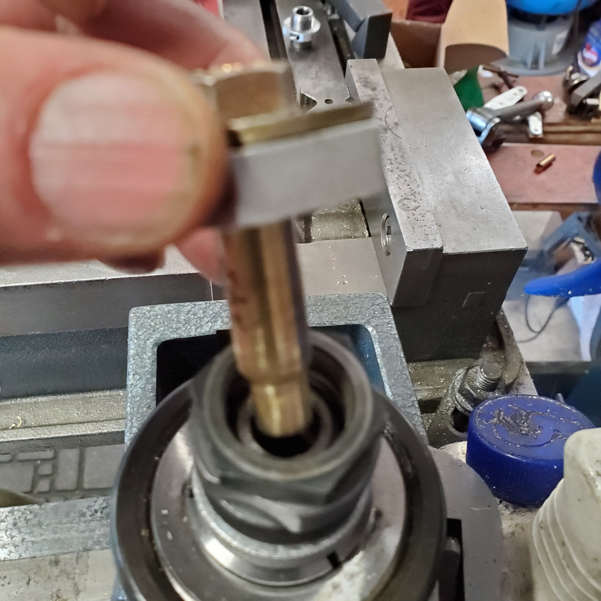

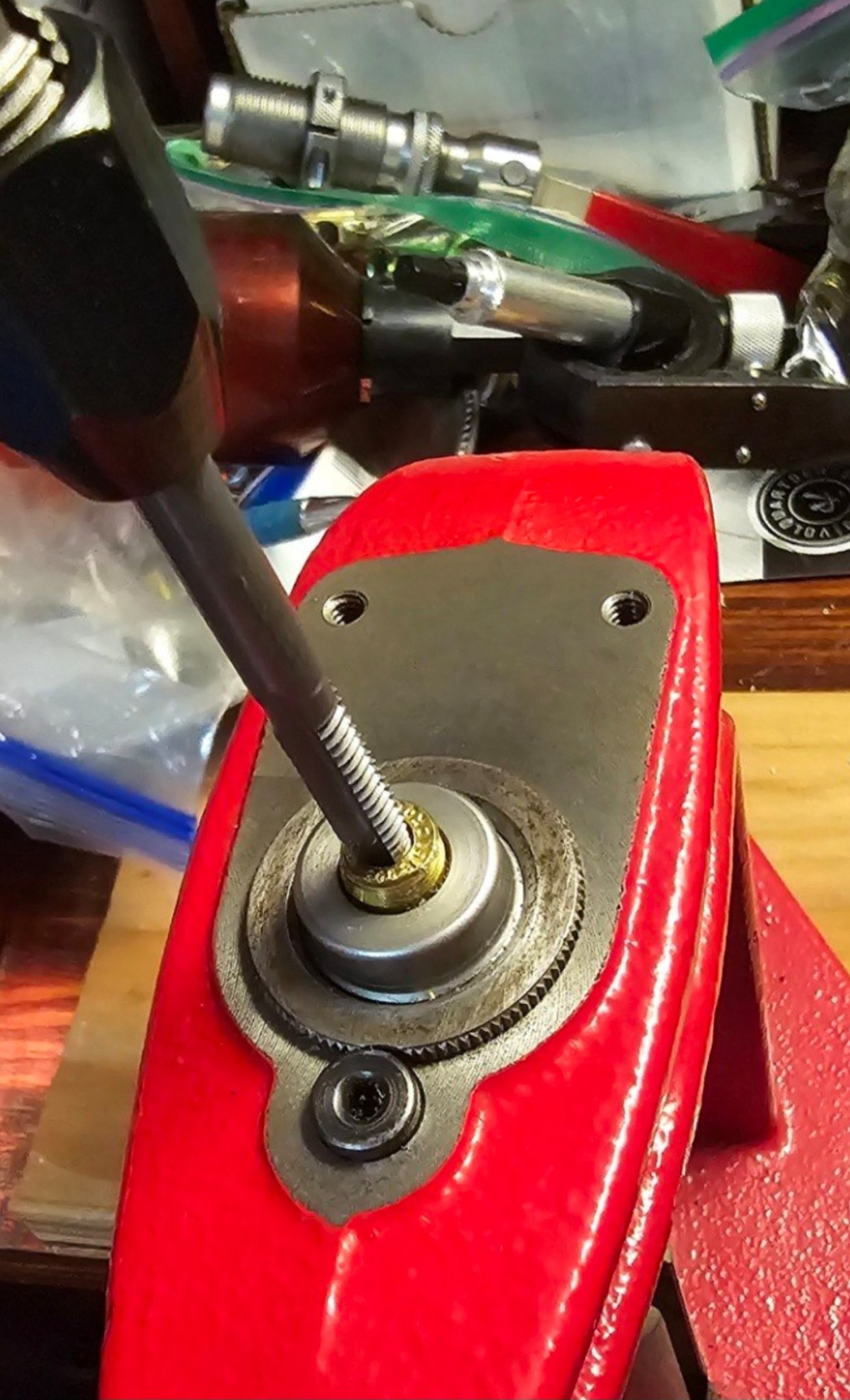

I've used the RCBS stuck case remover for 50 yrs...look at the $3.59 price on the box.
It works, except on the hybrid or case head separation cases. So I made one on the lathe that pulls both types of case problems.

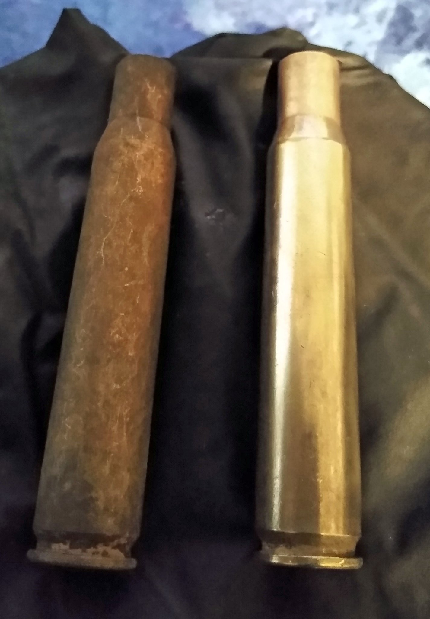

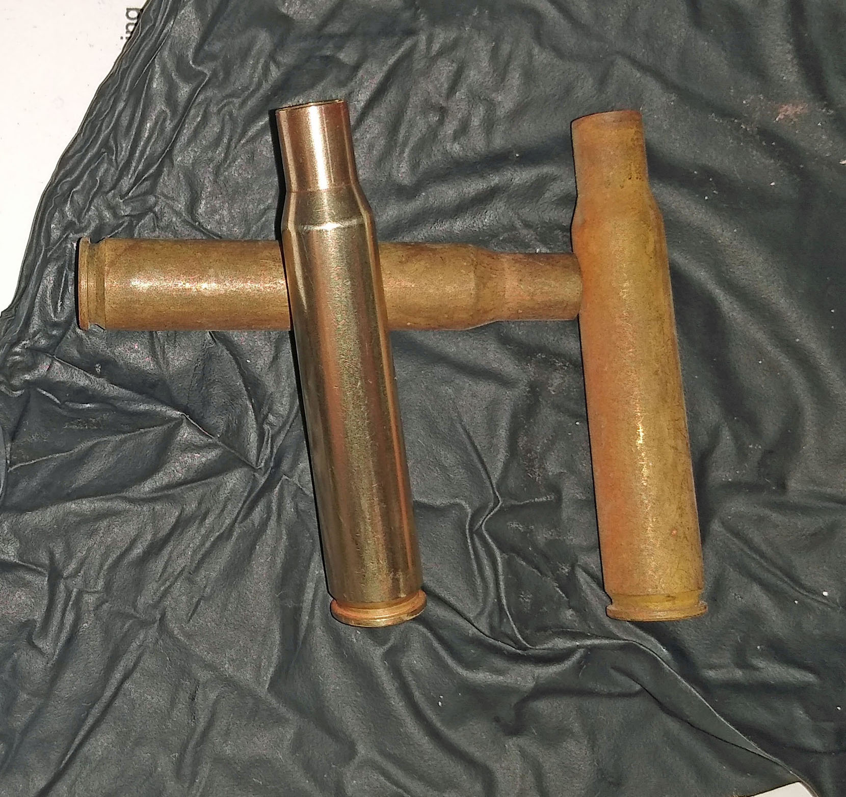

Fyi : I'm on #46 reload 1 grain under max for all reloads with some 1942 ,43 LC & SL M2 .30 Cal. brass ** ,that I reconditioned ( Ultrasonic cleaned prepped partial annealing or ductility restoration ) . I'm firing them out of a couple of My Garands and haven't even lost a rim . I did lose two cases ,due to MY cutting them , so as to properly measure wall thickness . I'm determined to see IF I get #50 reloads on these cases safely . That brass ** was left on a military range for perhaps 40 years ,before a friend acquired it . He in turn left it outside in plastic buckets for another 30 + years , before I finally got hold of it . Then 8-10 years passed Before I did anything with them ,as they were Extremely UGLY in the beginning . Before & After ultrasonic cleaning photos .
There were also 1954-56 , as well as match 1957-68 , 7.62X51 cases mixed through out the lot. Oh what joy separating all of it ,NOT !

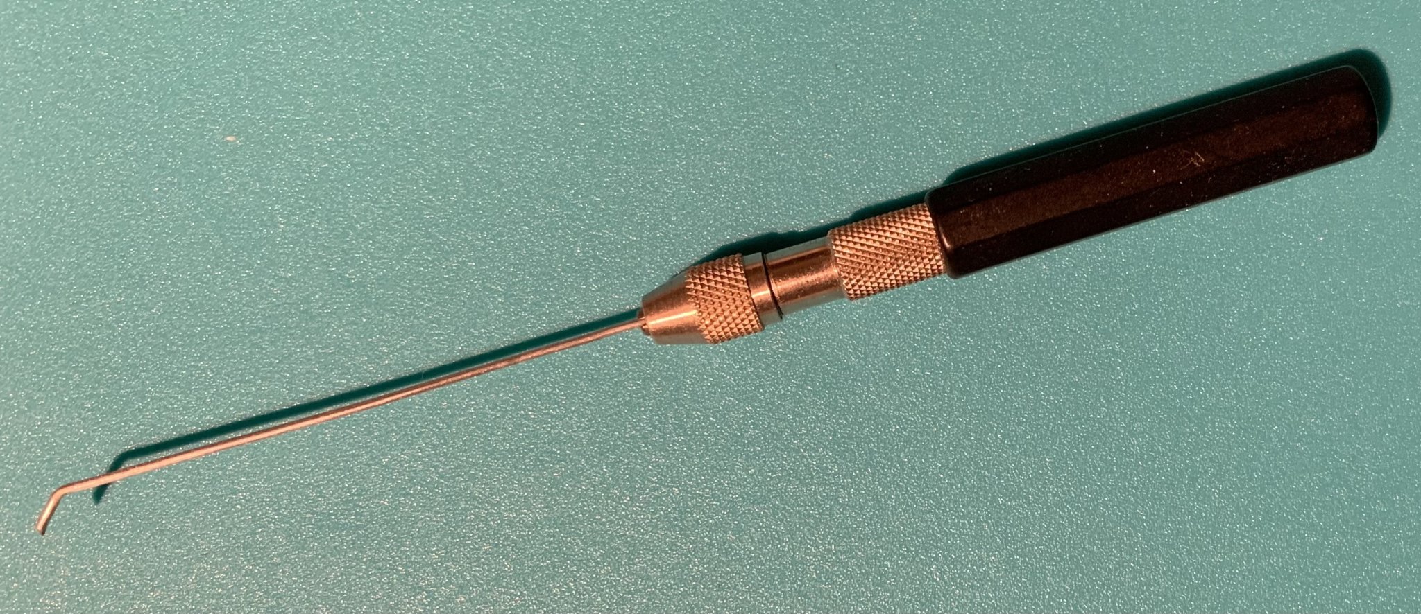

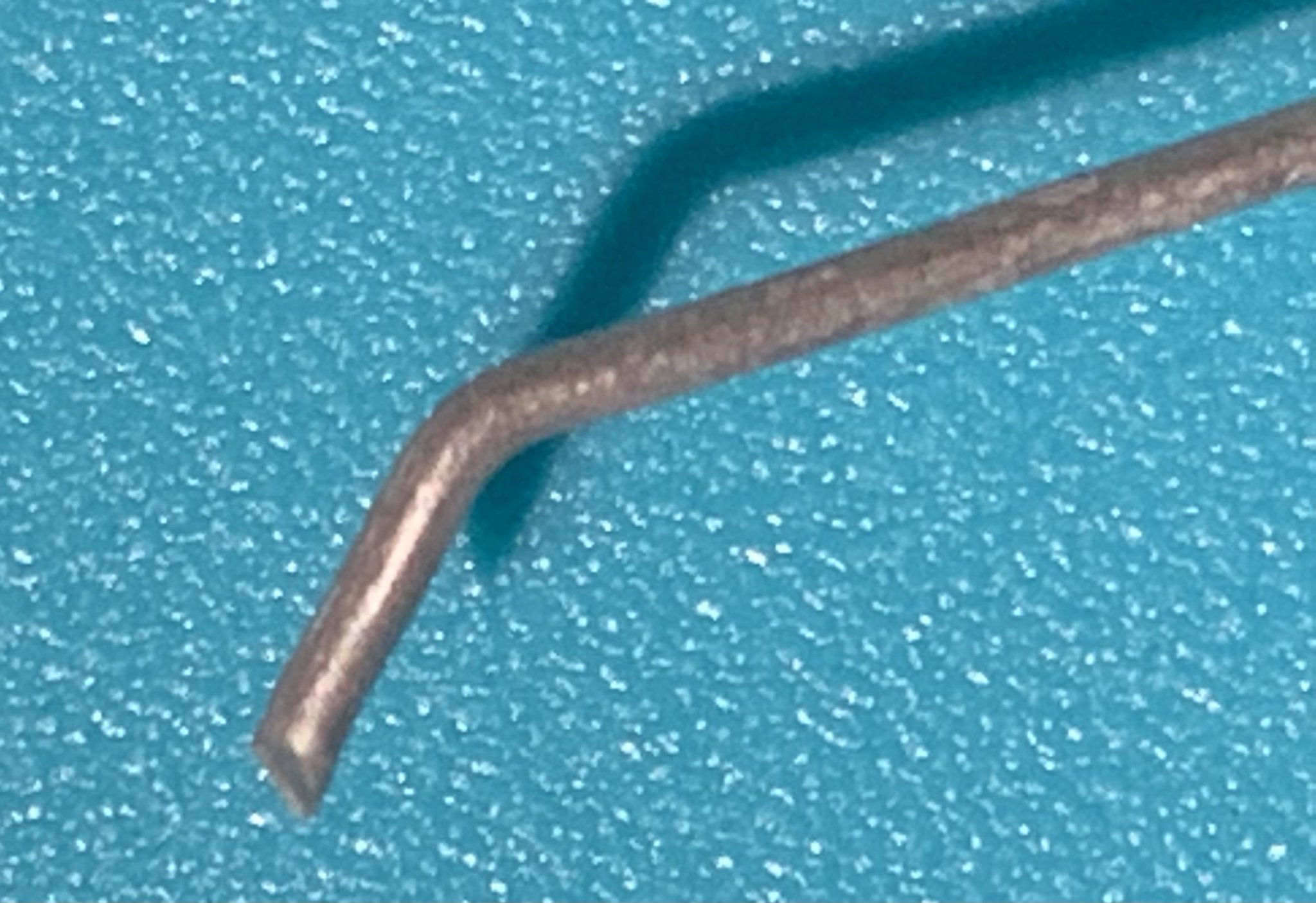

I still use a paper clip inside especially on MY Belted magnums ,the belt can deceive the eye .
I like recycling the wire from those Chinese Takeout rice / noodle boxes.
No need for a “thin gauge paperclip” - what matters is how you snip the wire with your pliers to get that fine point.

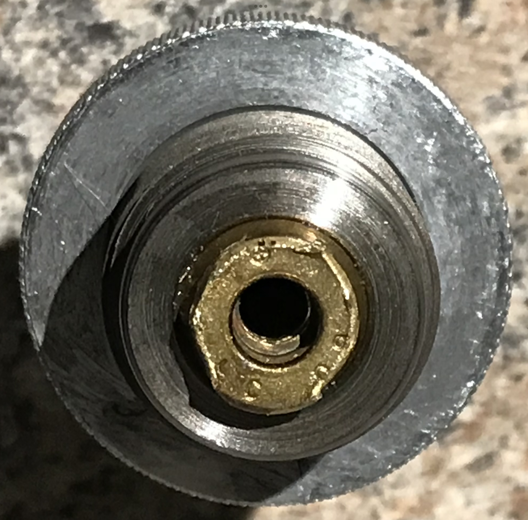

That little bit of Sesame Seed oil helped oodles.
Gotta lube the tap with some sort of cutting oil.
Easy enough, but required far more effort that I thought it would.
Probably because of the bloated Lake City + Small Base Die combination.
Had to break out the ratchet, even needed to extend the handle all the way.

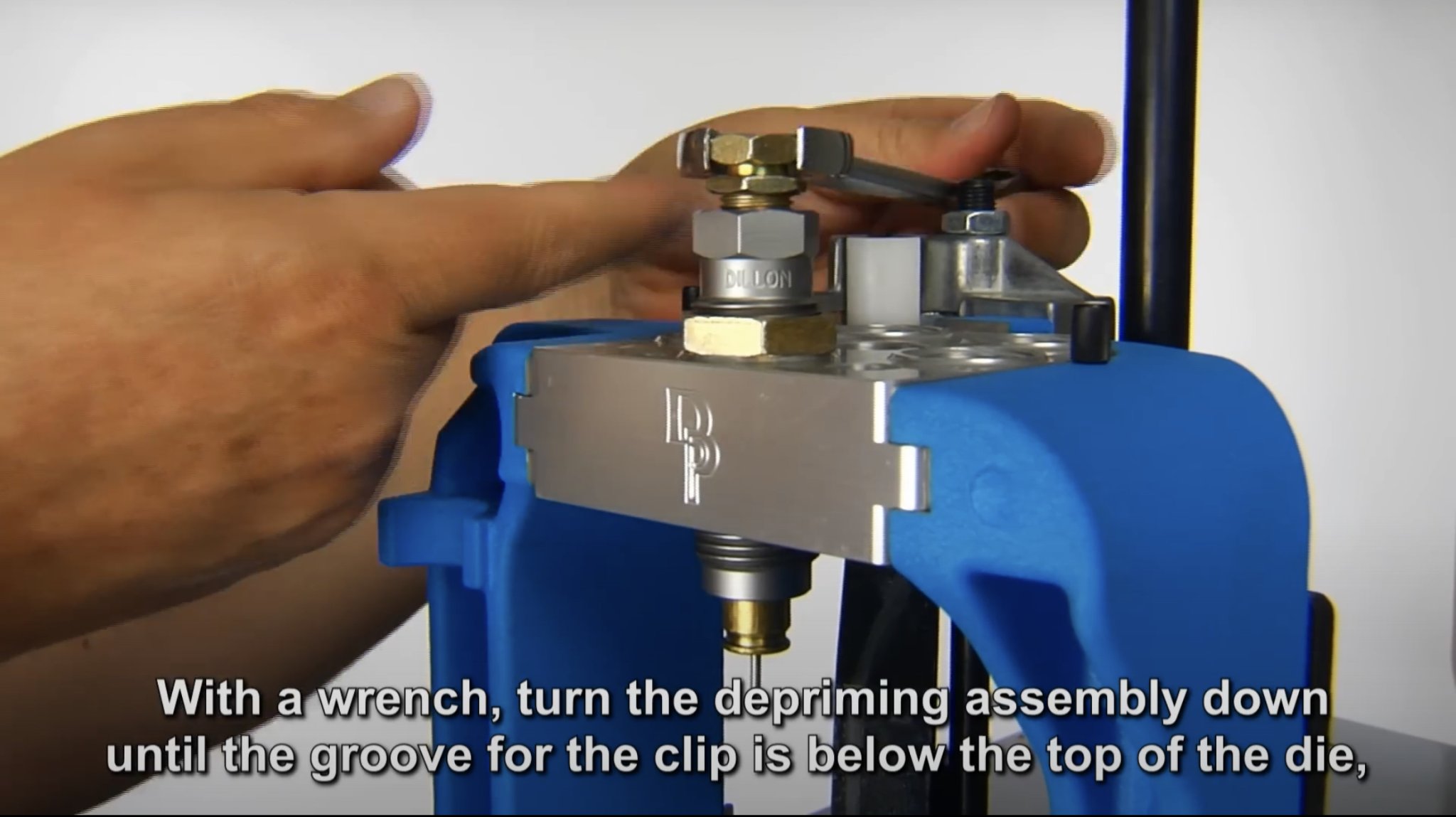

Just to be clear that this isn’t some kind of Ford / Chevy brand loyalty buffoonery…
Those wrench flats are what make the Dillon dies so convenient.
Instead of tapping / threading the case and pulling it out with all those acrobatics…
One simply threads in the rod where the expander normally is, and pushes the stuck case out with a pair of wrenches - one on the flats and another on the depriming assembly - and you can do it on your lap if you wanted to.
I use 60% paint thinner ,25% acetone and 15% hydraulic ISO 15 fluid or sometimes just Boeshield T 9 . First concoction works well on rusty fasteners like trailer lug bolts ,exposed to saltwater corrosion for example .
