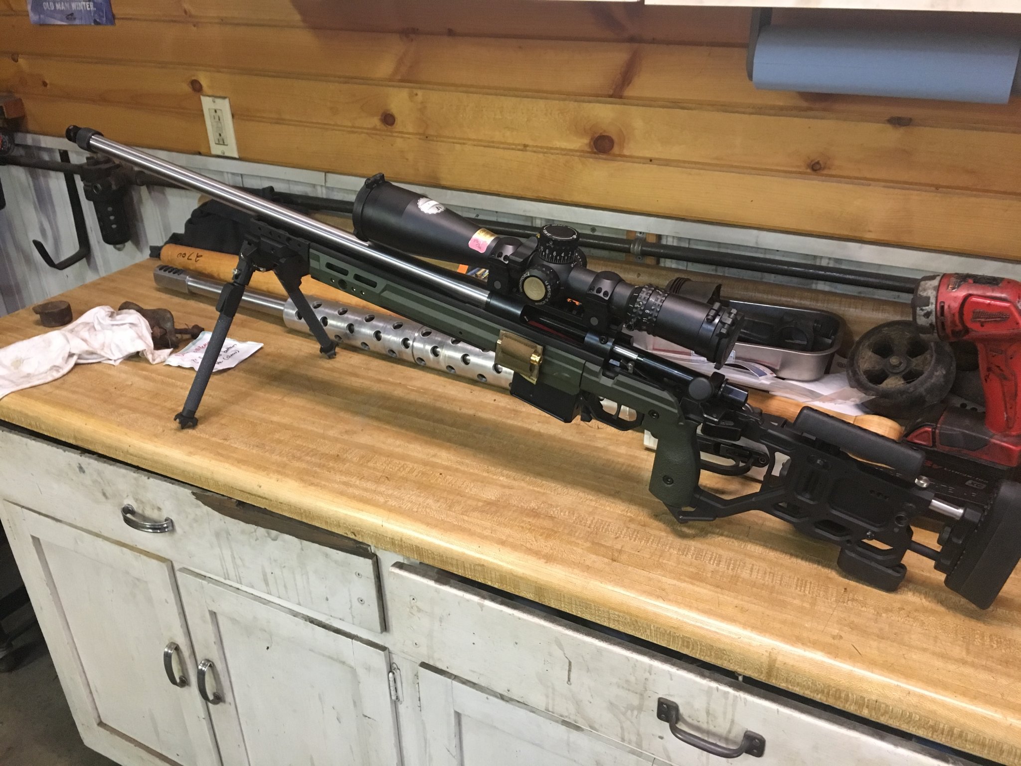

Here's my take. Lefty Nucleus, Tubb T7T trigger, KRG Whiskey 3, ARC mags, K&P barrel I chambered in 260rem. No matter how slow I push the bolt forward it pops the round up into the bolt CRF, it just works at all speeds. Feels like butter, zero issues with misfires, none. And it was 40 degrees and windy this morning. Shots 7-11 on the new barrel shot 1/4 moa group, no load testing. I took the load from my 260 TRG and loaded with new components. I really like this rifle, especially since it's a lefty. It's like a TRG without shitty Beretta to deal with for parts. Also, that ckye-pod is money.
Oh yeah, lapua brass and FGGM large rifle primers.
